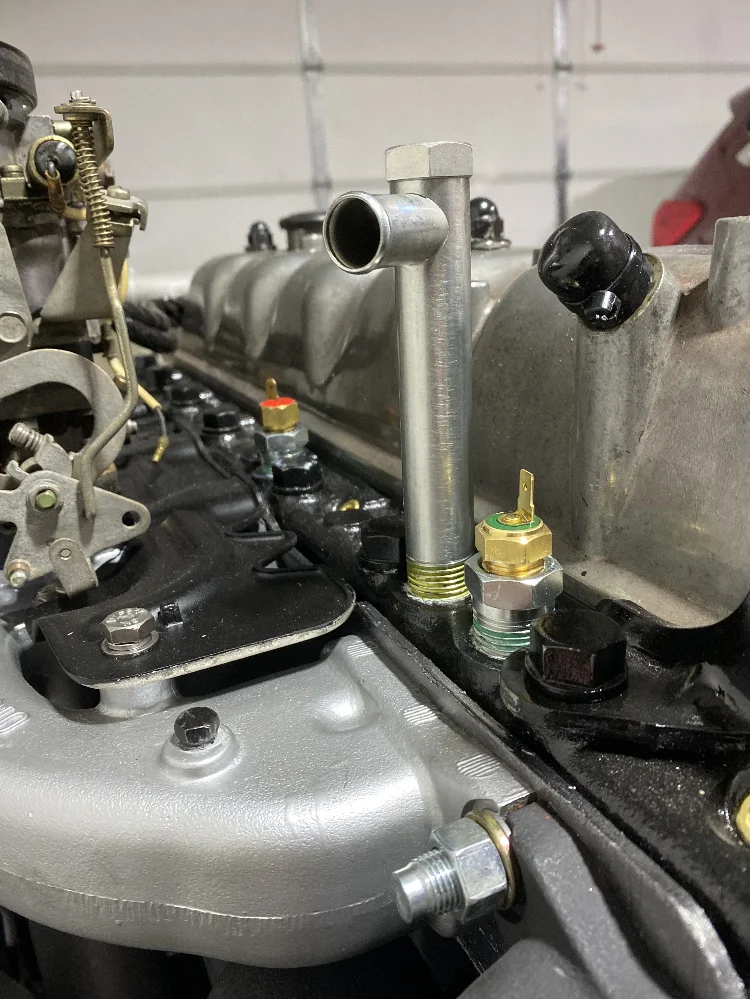

Hey guys,
I'm finishing up this motor before putting it into the truck and forgot to take a pic of where the heater nipple and the two unions for the temperature senders go on the head; could somebody show me with a picture? This is a 1974 F.5.
I replaced the original three-piece heater hose adapter with a simple straight one from @ToyotaMatt, and the two senders are different (I think the resistance is stamped on the hex on each). Got two new unions to replace the old rusty ones, but reusing the senders at this point since I'm on a time crunch.
Thanks in advance.

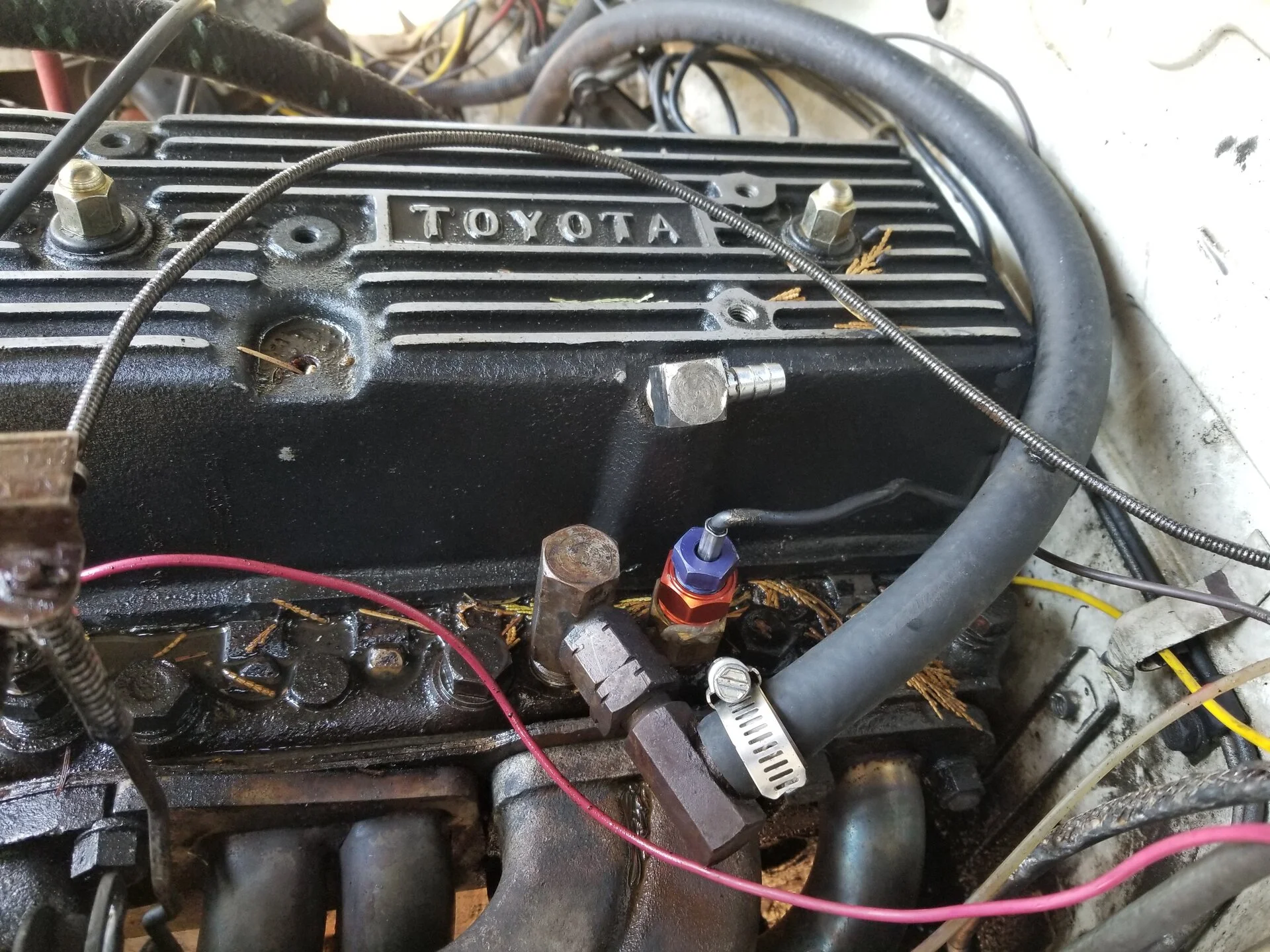

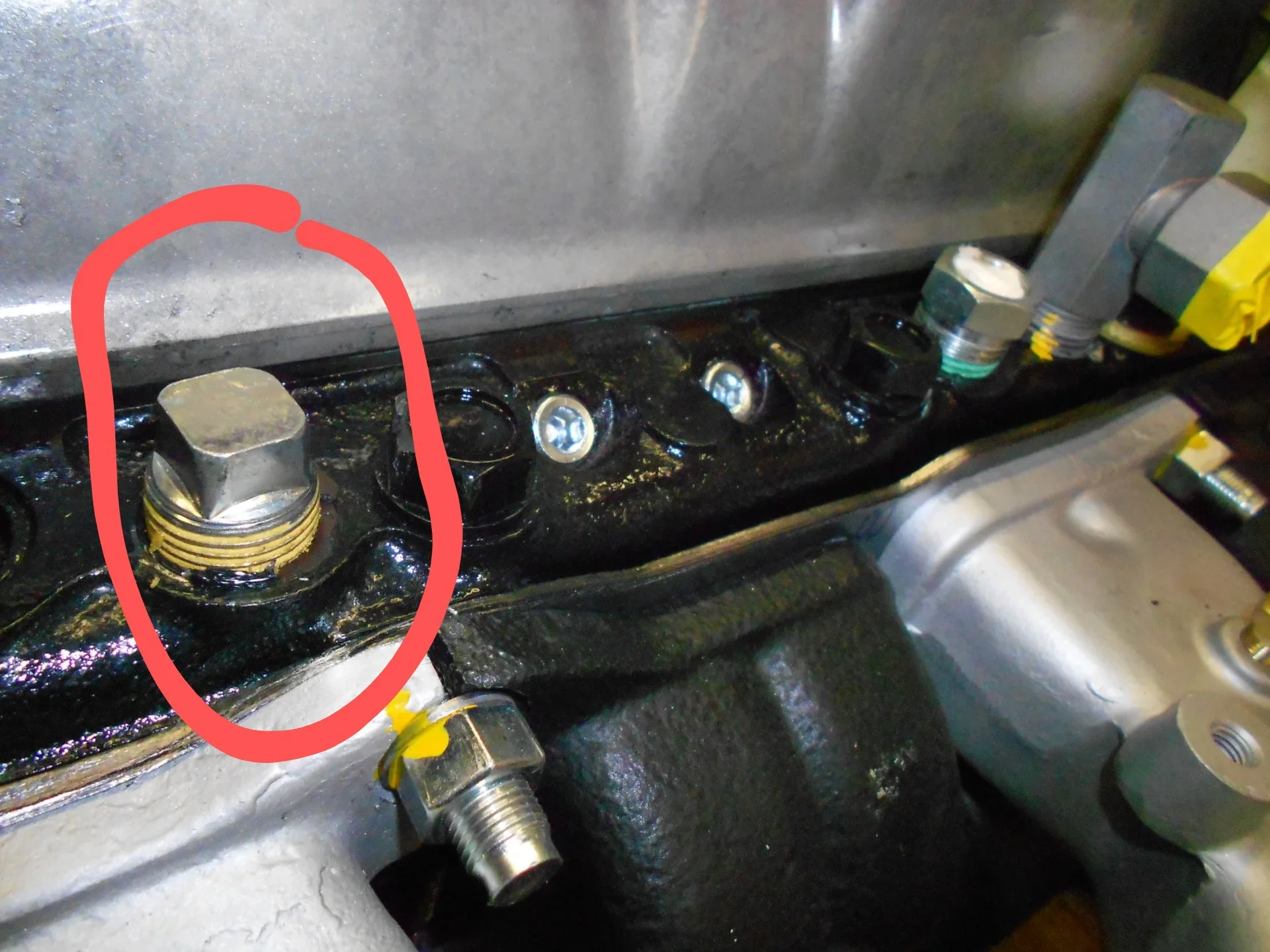

On my 74, with a 2F from an 83 60 series.
My '74 head. Red wire goes to stock sender for stock gauge, rear sender for Autometer gauge.

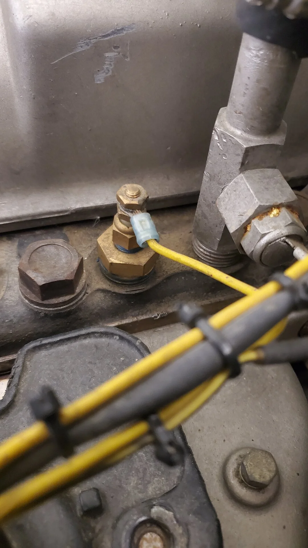

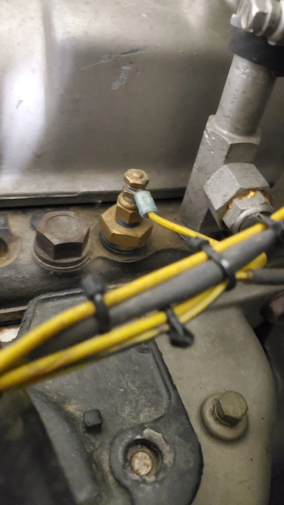

OK here are the pics.
4-K:
8-M:
...both have "teq" stamps on them. Not even sure if they're original, given how trashed and jury-rigged everything on this truck was/is. But there are two spade terminals from the wiring harness which went to them.
In parts diagrams I only found 83420-20011 listed as "gage assembly, water temperature sender" on the head, and Googling for images seems to match the 4-K unit (doesn't have the extra-long tip of the 8-M). Could somebody have swapped the harness on the car for a different model?
4-K:
8-M:

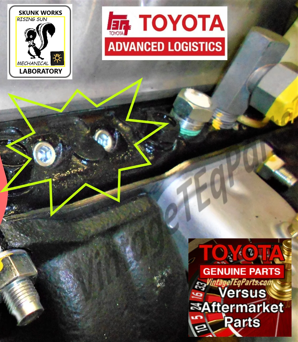

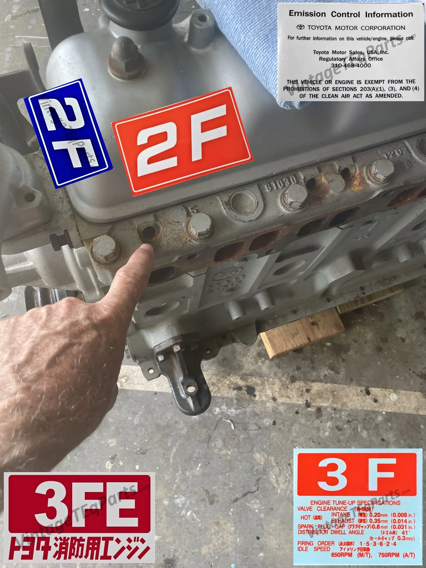

the one with the capsule shaped bottom , your 2nd photo ,,,,
is the Emission smog oil temperature sensor , goes behind carb \
Gotcha, thanks! So this thing currently has a Weber carb on it, and to my knowledge never had EGR or anything. When you say "goes behind carb" do you mean it screws into the original carb?...or where should it go exactly?

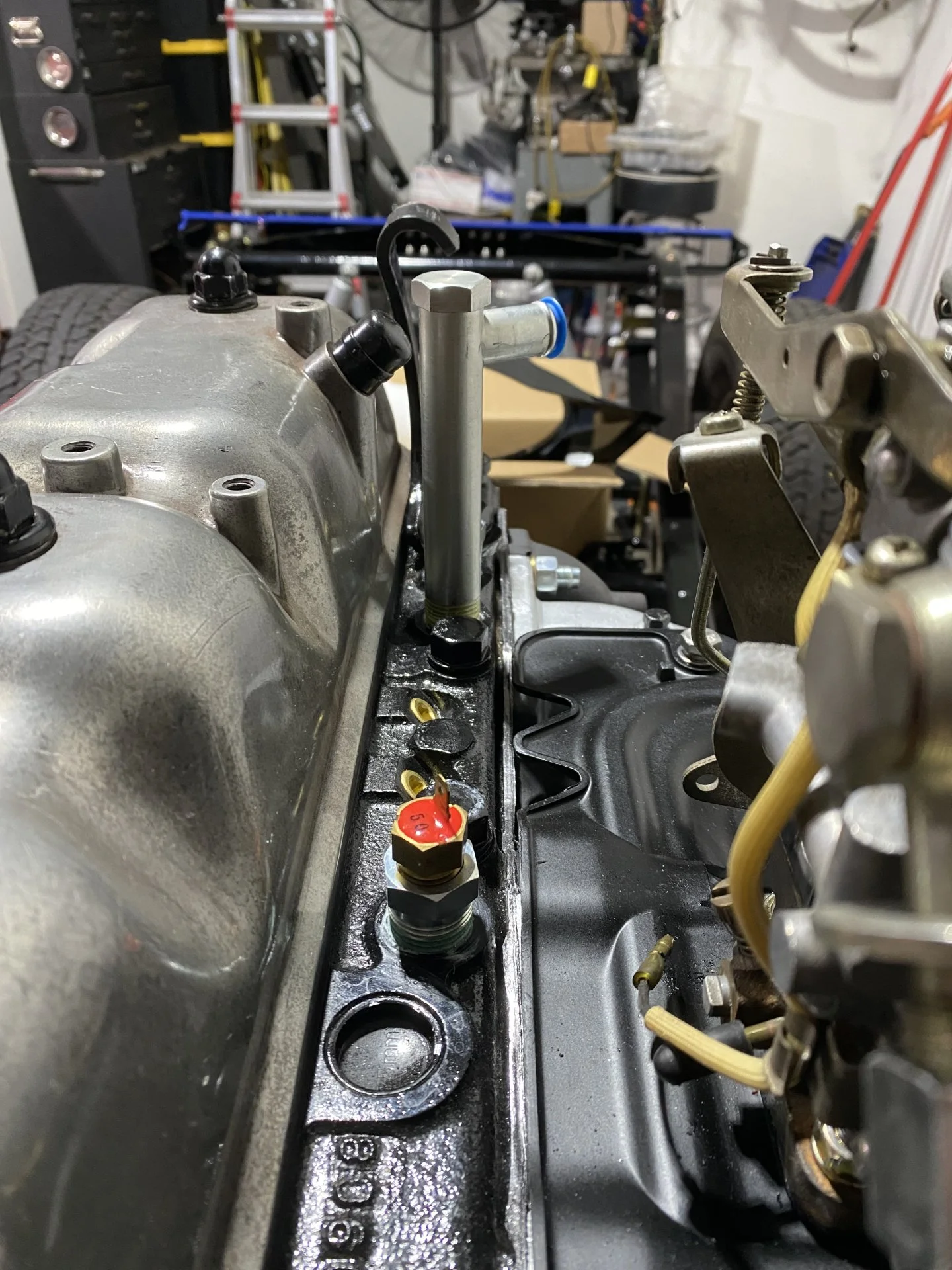

see RED TOP sensor below
yours was RED , now its faded
if u no longer need the RED TOP THERMO SENSOR ?
then below link is your solution
