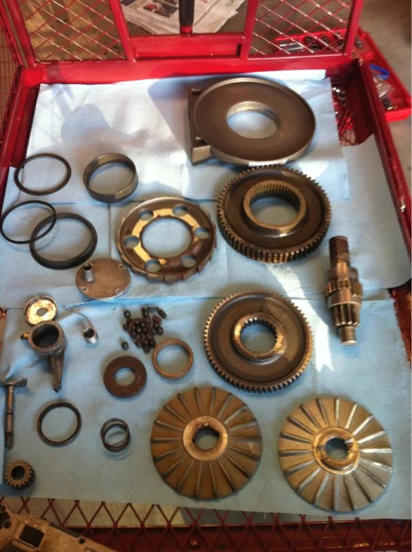

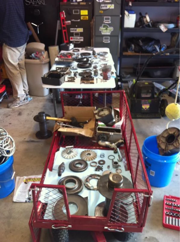

Alright just finished tearing down Chris's winch. Took about an hour to tear down and clean parts. Going to take the pieces to the machine shop to get some stuff removed from the upper and lower housing and onto the blaster

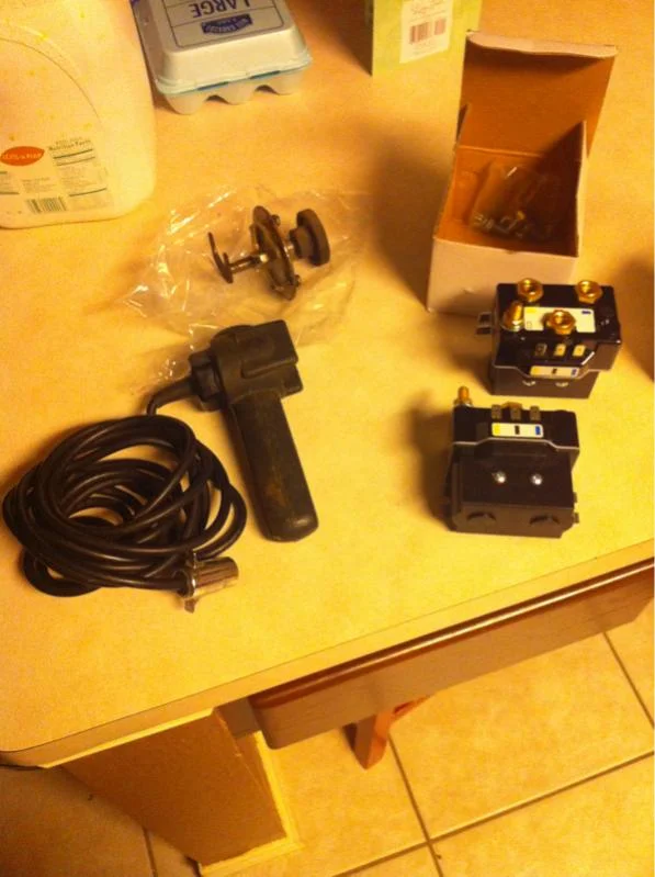

Just picked up another controller on eBay for the one without one. Also picked up a good clutch assembly for the one that is cracked.

Just got my controller and clutch assembly in from the gent off eBay. Also it my Albright contractors in from summit racing. I watches a video of the contractors and a superwinch the other night where they were both submerged in fish tanks for a couple weeks and then they took the winch out of the tank but left the Albright contractor it was wired up to in the tank and it operated flawlessly. Im going to mount them where 1911 has his mounted so I can still put on the warn solenoid cover. Btw the pieces are now at the blaster. I need to research the needle bearings that sit inside the cluster gears as the machine shop guy destroyed them. He did get the larger caged needle bearing out of all three winches that sits in the lower housing without any damage but I ordered new ones. Just need to find the small needle bearings, anyone have a part number?
