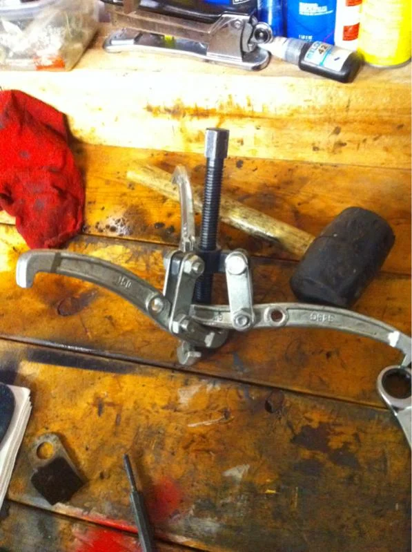

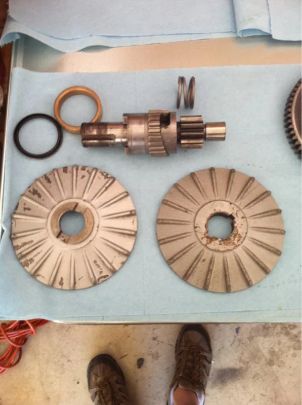

Well I was finally able to get that damn mainshaft out of the winch. Honestly the 3 jaw gear puller made it easy work! I tried to pound the needle bearings out but failed. Also I'm still failing at getting the gears out of the main shaft.
So this is what I still have left to disassemble:
1. Needle Bearings need removed from the Lower housings
2. The seals that go around the hole where the motor goes through the upper housing still needs to be removed. I have tried beating it out, tried using the bolt with washer technique, can't get these guys out.
3. I need to still remove the shaft that is crimped on the ends out of the upper housing in order to remove the upper housing gears. I have tried pounding and tried spreading the crimps but no luck.

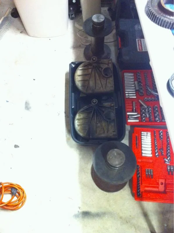

I think my best option is to probably take these pieces to a machine shop and see if their big toys can remove these pieces for me. Once these 3 things are done, I'm planning on cleaning them real well and taking them to the blaster for further clean up and then onto be powdercoated.
Anyways heres some pics, since I love pictures!
By the way the puller is a cheap one from O Reilly's, it was $14.00 and all they had at my local store

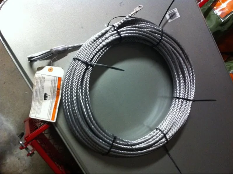

Well one of my new cables came in today for my winch. It's purty... I know guys are wondering why I went with cable instead of synthetic but Tucked brought up a valid point. The heat and Sun down here in San Antonio would most likely degrade the synthetic line pretty fast leading to changing it out often which gets expensive. The cables I removed from both winches were more than likely as old as the winches themselves. I'm not a hardcore off roader but enjoy a nice back country trail to a favorite fishing hole or at least I do in Colorado so the winch will most likely be used maybe once a year.
Still waiting on the other cable to show up. Next is ordering the seals and etc

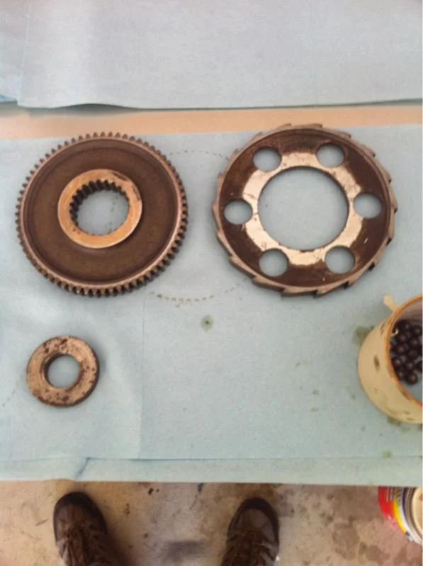

Alright I decided to start cleaning some of the parts I could clean.... Well when I took apart the clutch assembly the ball bearing that was inside the handle shot out. Anyone know where I can get this ball bearing?
LOL - I did that with one of the brake ball bearings :(. I called Warn and they sent me a few for free ;). Let me know if you can't get one, you're welcome to try to get my damaged clutch apart ... can bring to the Roundup.

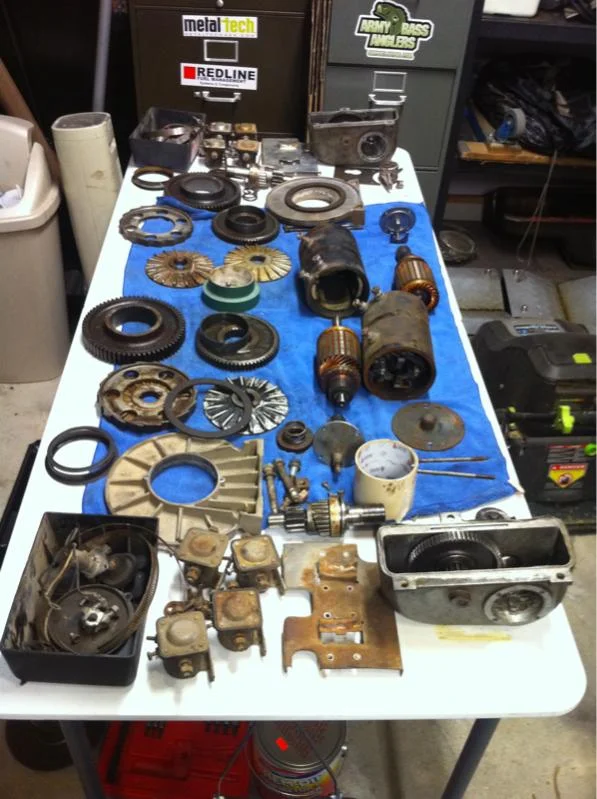

I've got part of the inop winch cleaned up. I'm trying to keep all the pieces together as much as I can in some kind of organized manner. Here is where I'm at now.
Tucker thanks man, i honestly just need the plate that mounts to the assembly. Is that damaged? Thanks for the advice I guess I'll be putting a call into Warn on Monday. The russell guy there seems to be a dick. I spoke to him about a week and half ago and he said the serial numbers do not mean anything and he would send sticker kits but never arrived.
