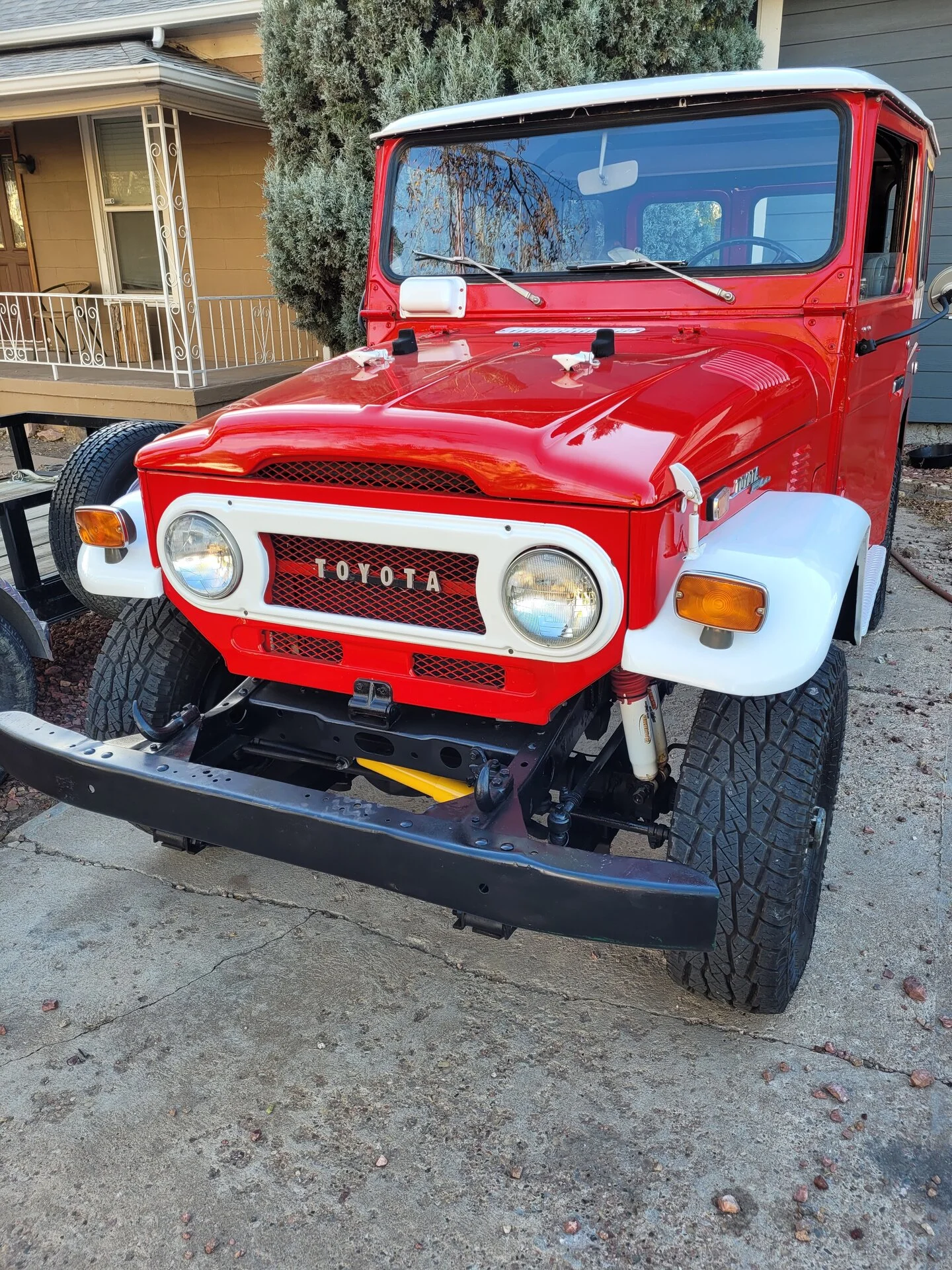

Alright, here we go. Bought this 1973 to be a good little rig to take my daughter on some adventures in Colorado as she grows up. While I thought I did a decent job going through it beforehand I obviously missed quite a few things.
I was hoping to be able to drive it through the winter before tearing into it this spring with some updates, but last week while letting it warm up it started leaking coolant and upon further inspection I found oil in the coolant. So now its looking like an engine swap/rebuild and while I'm at it frame off and fix all the dumb s*** the PO did to it. At least he already put a 4sp tranny in for me, that's a plus. My daughter is only 3 so if I'm going to do a frame off now is the time to do it.
This is not and was never going to be a restoration. I want to be able to ding and scratch this truck up and not cry about it but just have fun getting to some fishing spots. So the questions for you guys are:

Oil in coolant doesn't necessarily mean an engine replacement. Could just be a head gasket.
Determine the cause and extent of damage before jumping off a cliff.

You're correct that it's probably a head gasket but if there's a local running F available why not swap it in and have a spare motor? I've never done an engine rebuild so I'd like to be able to take my time and do it right.
With that being said, looks like replacing a head gasket and seals is fairly simple and can be done in a day or so?

If I could find a decently priced and running F engine, I would do exactly that. Then take my time rebuilding my original(?) F engine.
I haven't done one yet, but these look like old Chevy stovebolts. I'd imagine it's a similar process. You could swap a head gasket before you finished your first beer on one of those.
Well the explanation for the 4 speed is it's not the original F. Looked at the serial number and its a 2F, so looks like I'll just order a gasket set and hope I don't make things worse.

I’d be looking to swap in a know good 2f if you could source one or otherwise tackle the HG and associated bits as you look prepared to do.

Are there 2 shocks on the front ds?
Bought the gasket kit so will do that sometime soon. However, I did find a cheap 2000 4Runner, manual transmission, with only 130K miles but with significant body damage and frame rust, so may be the perfect donor vehicle for a more reliable and fuel efficient rig.
