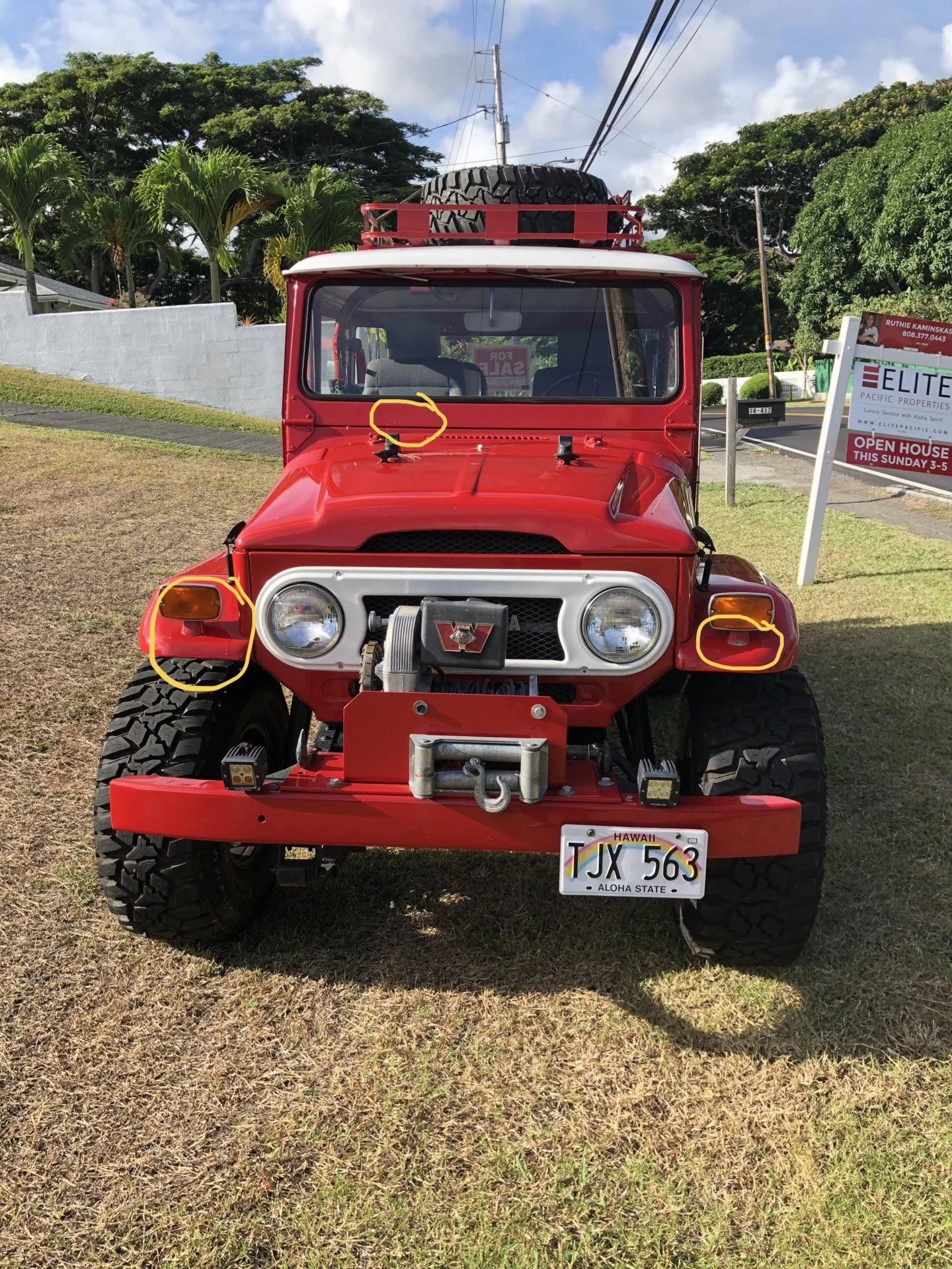

Considering buying a 1972 FJ40 - on Oahu. Asking price is $20+k ... it looks legit with extra original pieces / parts. Looks amazing as restorations go - Appears to be original engine- straight 6/ 3 speed. X-msn -Modification includes disk brakes up front, Webber carb. New distributor/wires/plugs. New gaskets - could not find any leaks!.. question is - is it worth the $20k asking price. And what should I be looking for to avoid getting duped?(screwed)... anyone got any insights? I’ve wanted one f these since I was a teenager.

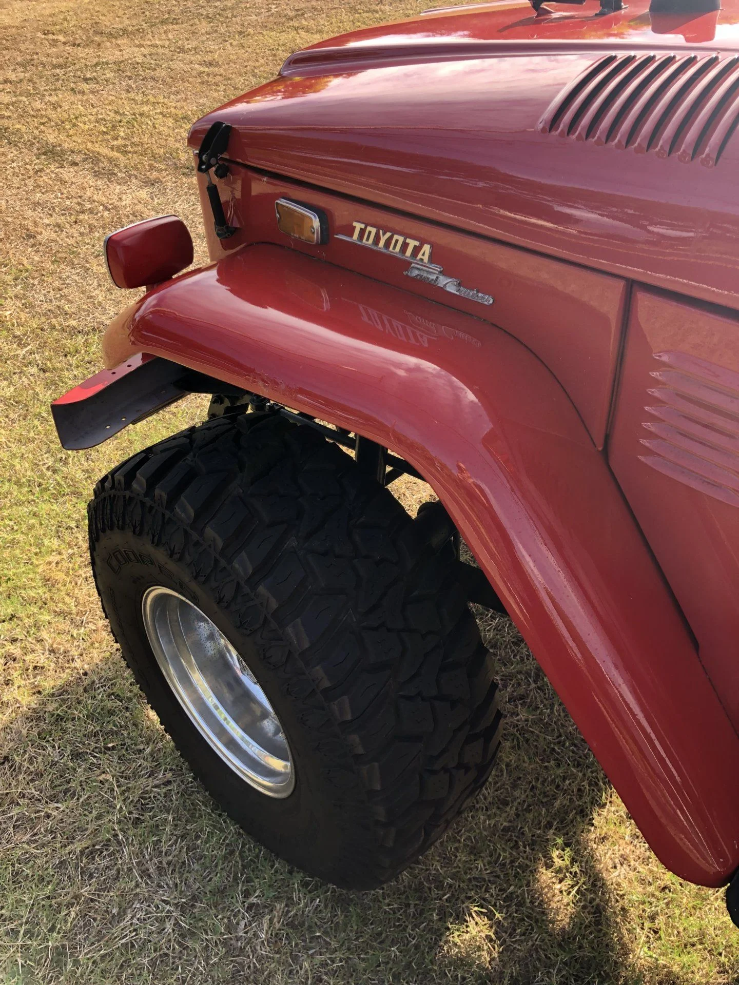

The run on the passenger fender screams run away from this one at 20k.
Added some more pics-rust is inevitable out here (you’re never more than 20 miles from salt water). I did notice the sloppy paint job and some of the chips/paint missing when I first saw it.

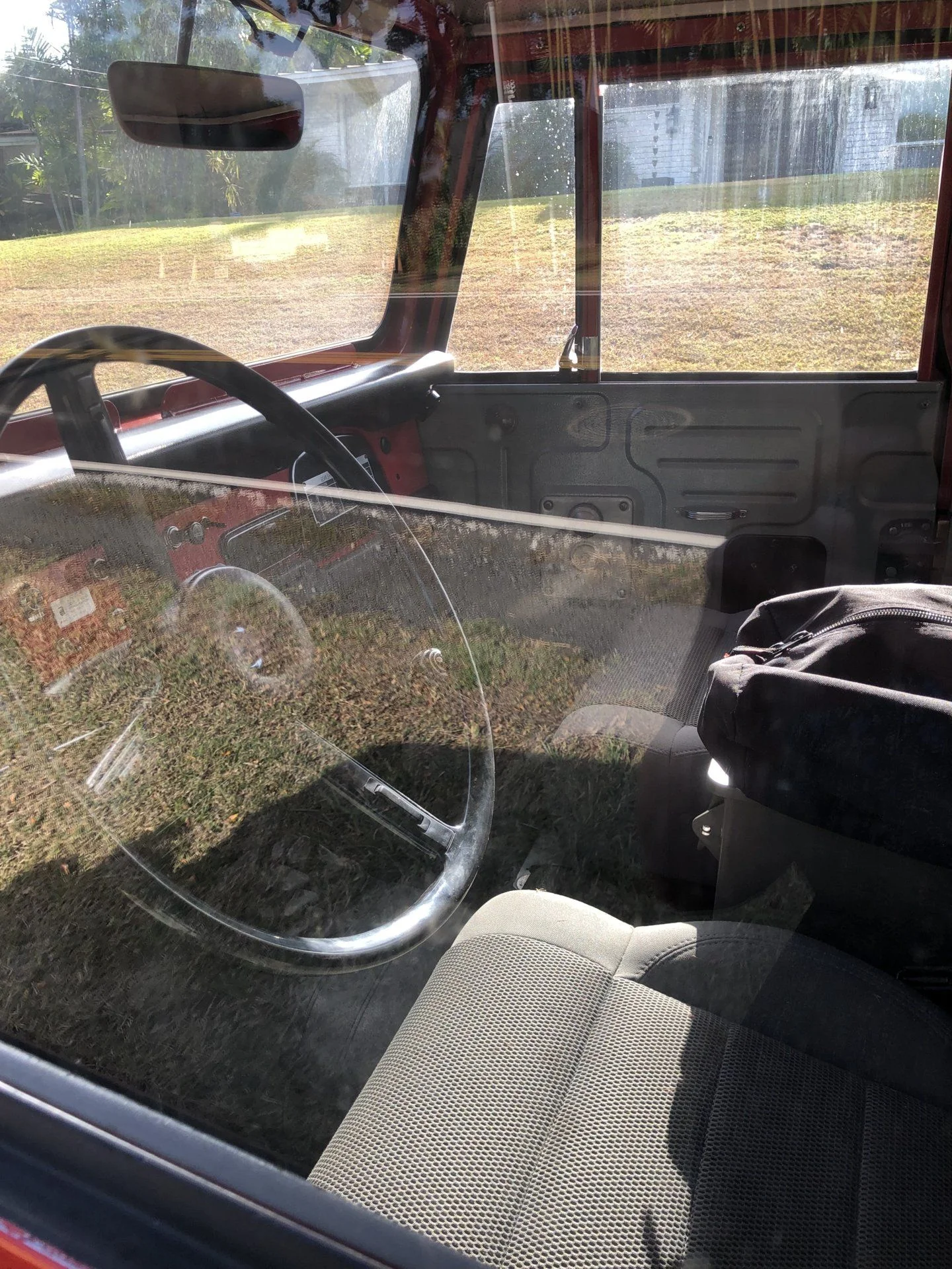

Also the stock seats come with, the installed ones are from a Tacoma. The amount of mods, concerns me— in that it’s not really worth the$20k due to all the modifications and potential issues

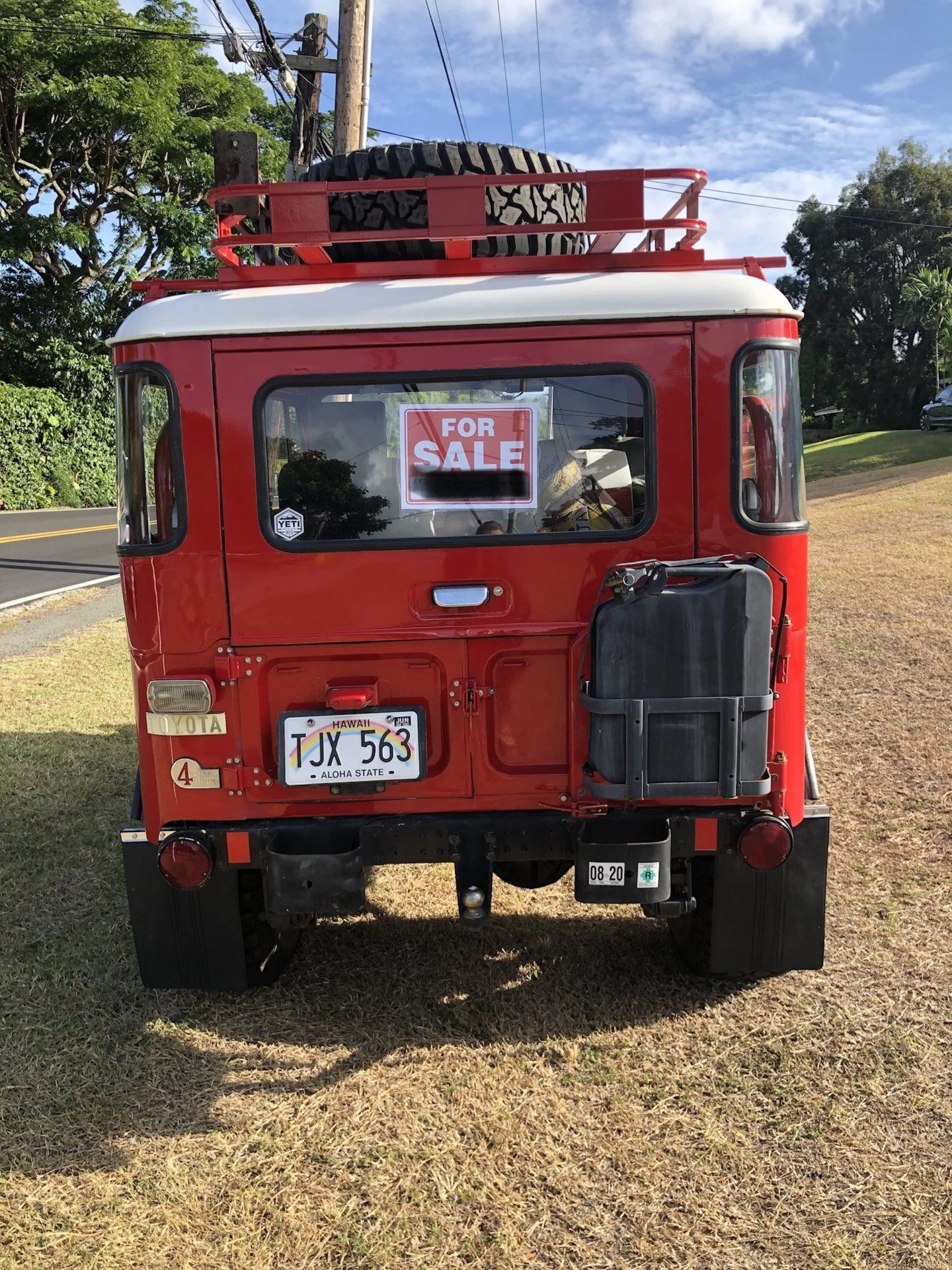

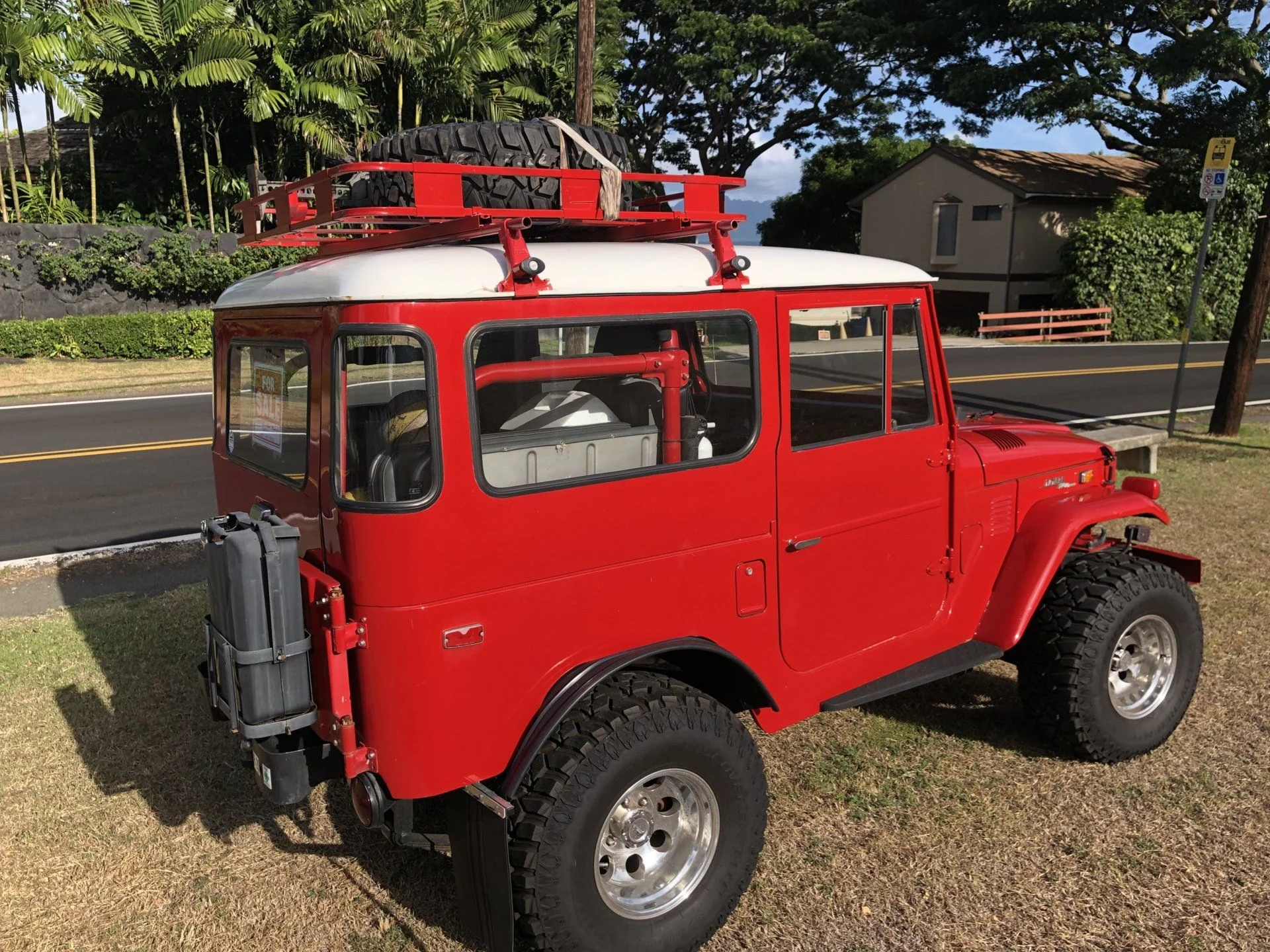

The rear wheel wells are funky. I can’t tell from my phone but looks like the seams under the rear door are full of bondo. Rust isn’t a killer , unless you can’t see it and pay for a clean truck.

LED bumper lights tell ya there's been electrical work. "PO Gremlins" are lurking! Unless you plan on rewiring, which then readdresses the concerns about the price. Just my .04.

The LED lights at least work... as do the standard head lights. It runs well, all accessories work (including the winch)
This vehicle looks very similar to one I considered that was in Colorado two years ago. The front seats are identical. Check the floor in back, if it's flat it's the same vehicle and has a aftermarket tub in back. Ed
One problem is that I'm sure there are not dozens of FJ40s to choose from in Hawaii, but that one is clearly worked over. If you paid more like $14K for it, it'd leave some room for rework and repairs. I understand why the guy is asking 20, but I would want to pay considerably less.
Note: this truck has a later hood than a '72 should have - doesn't really matter in the big picture, unless he claims it's all original.
