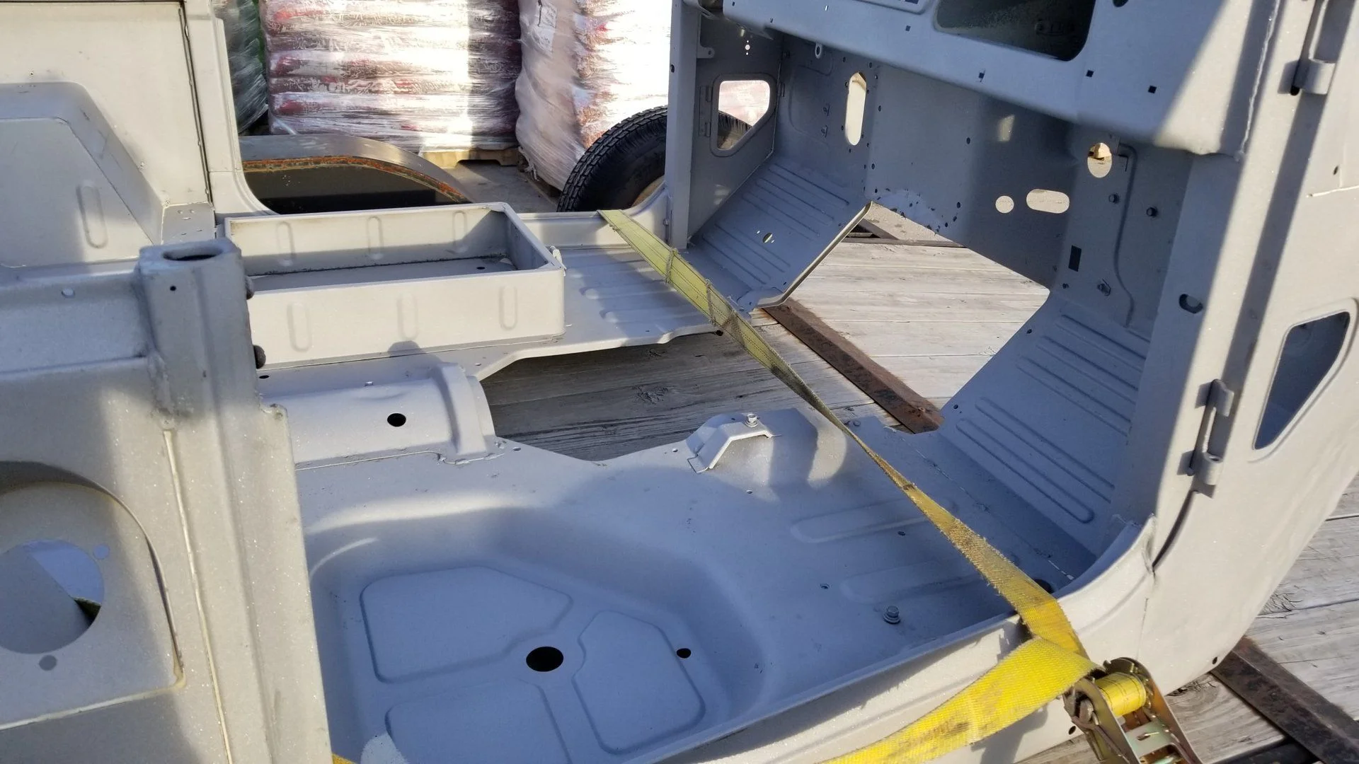

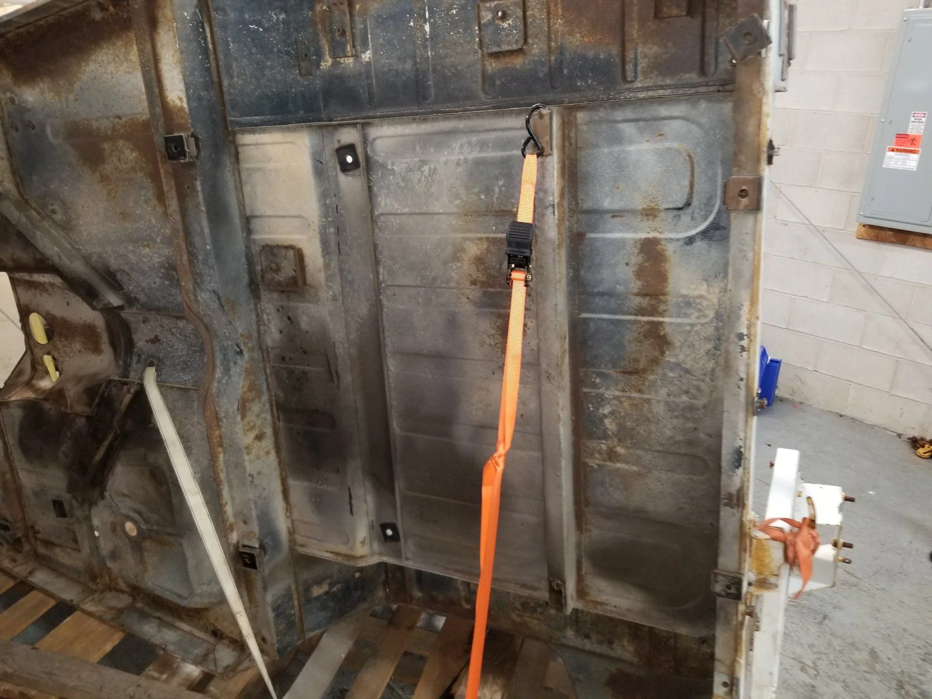

The worst part was he left the tub sor on a dirt barn floor for 30 years and the moisture rotted the tub floor completely out. I luckily found a rust free California tub courtesy of Rob Tygart.

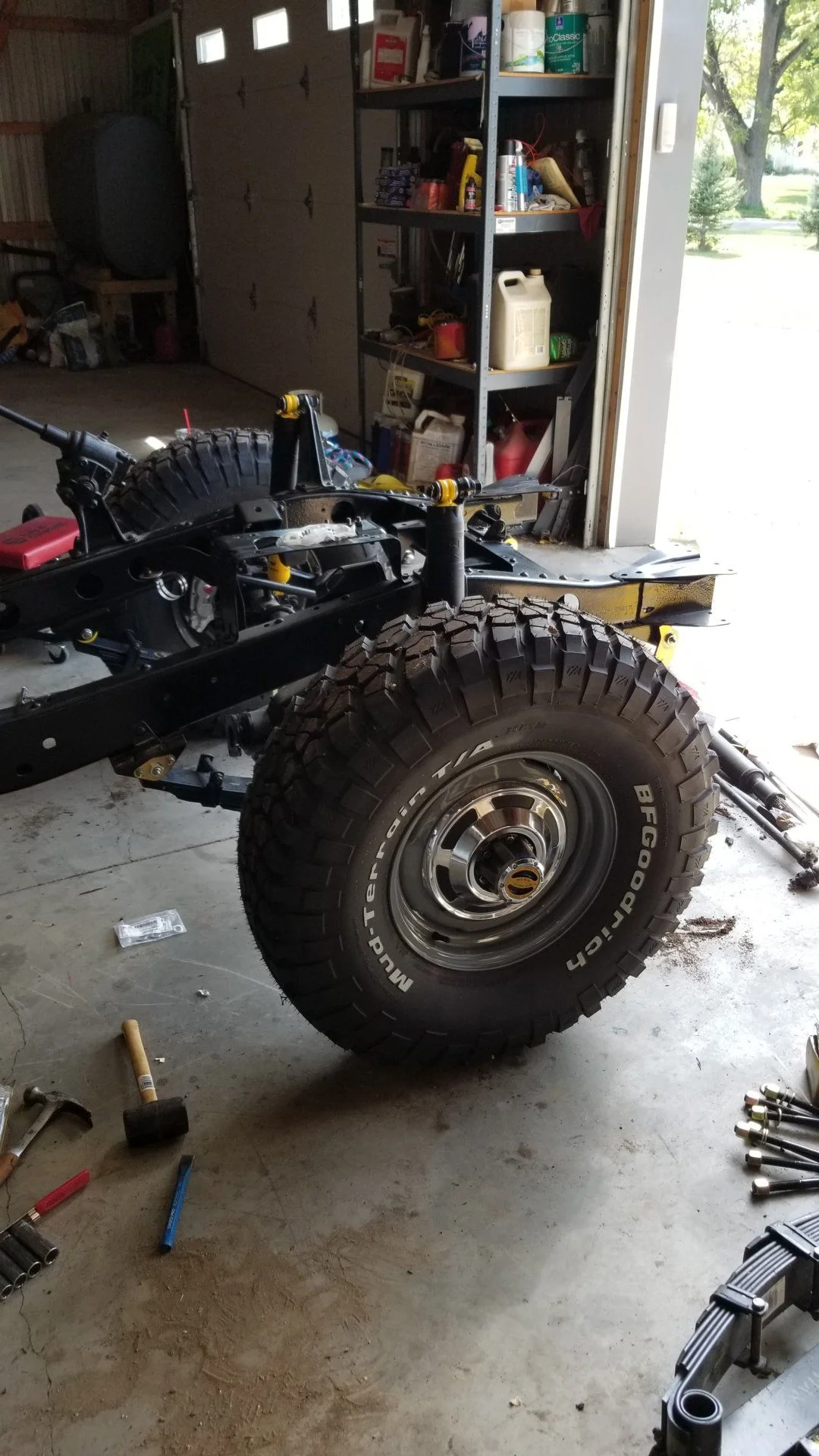

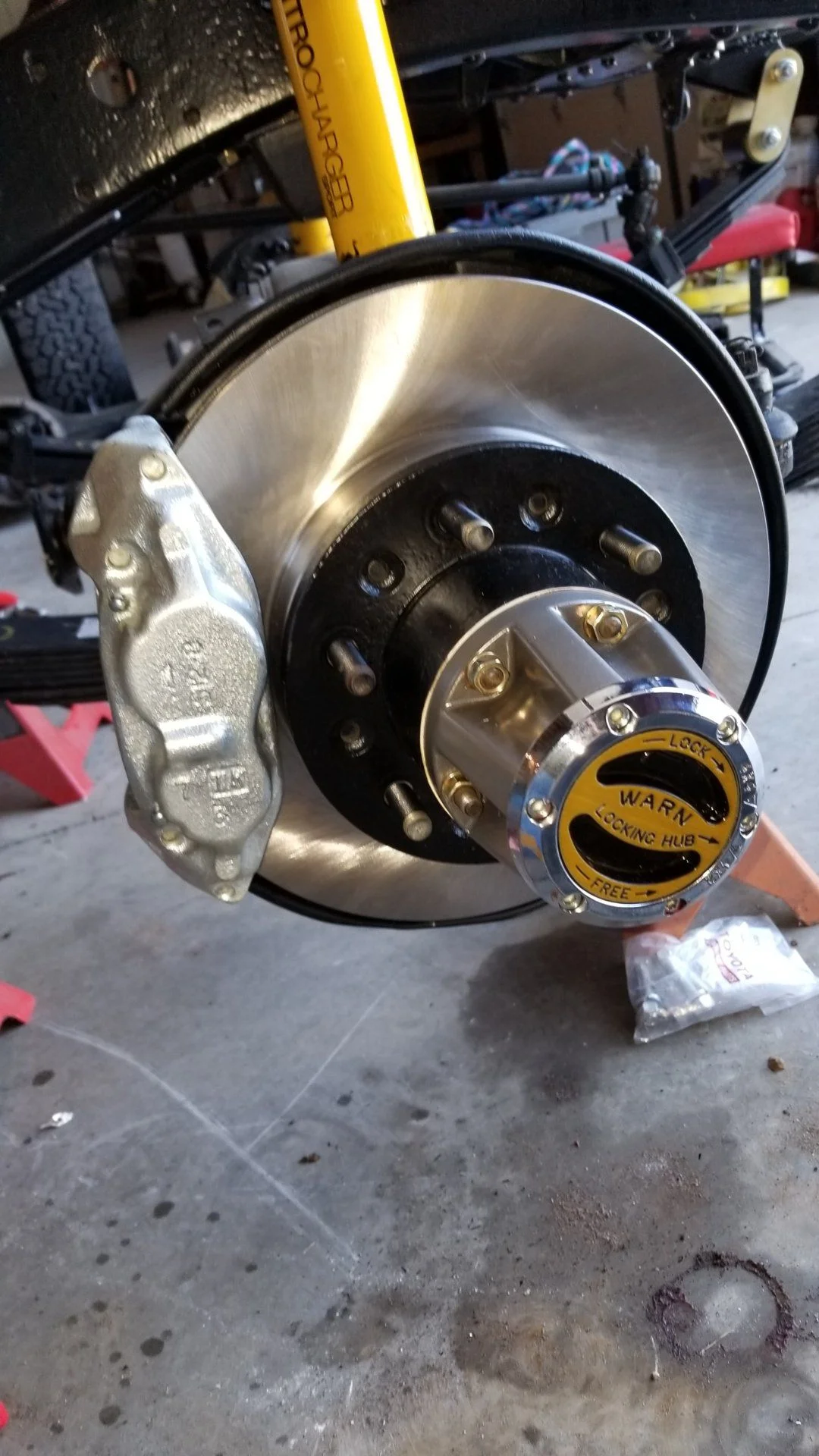

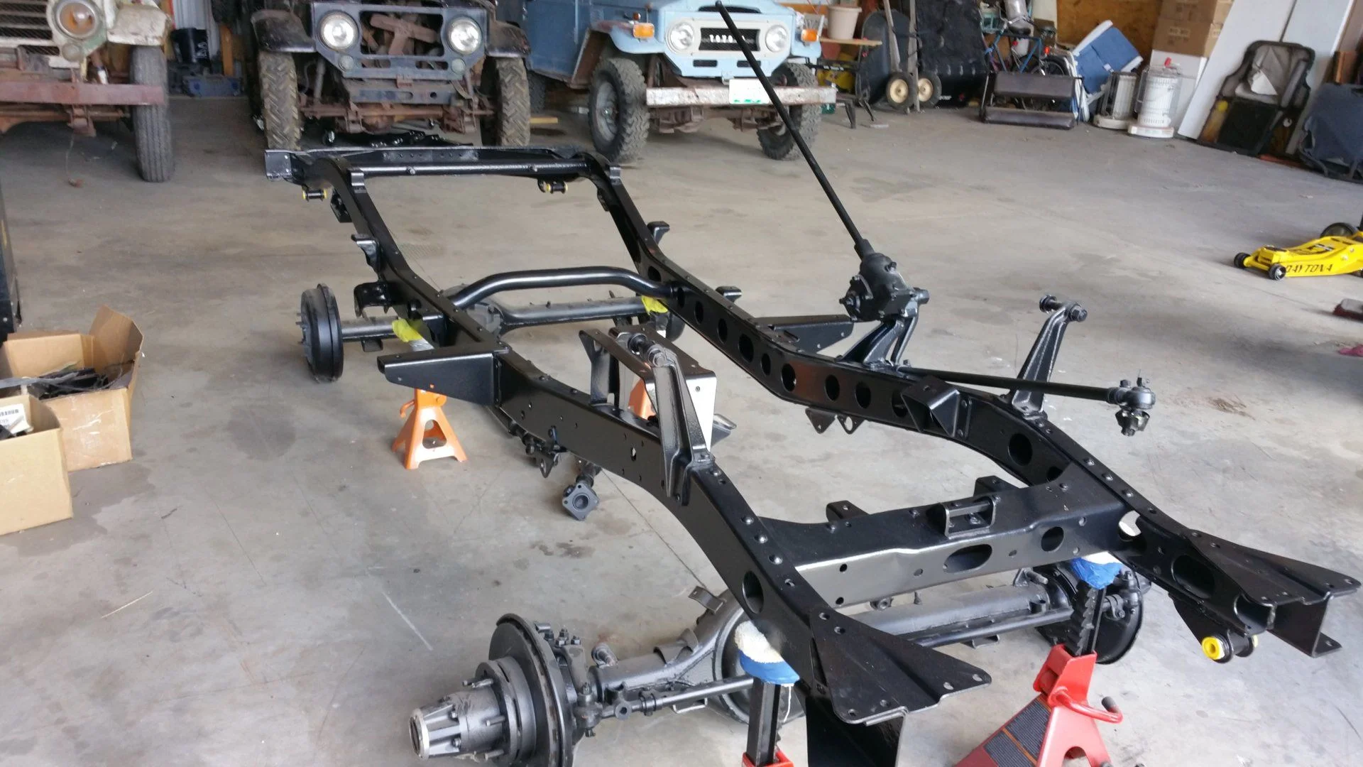

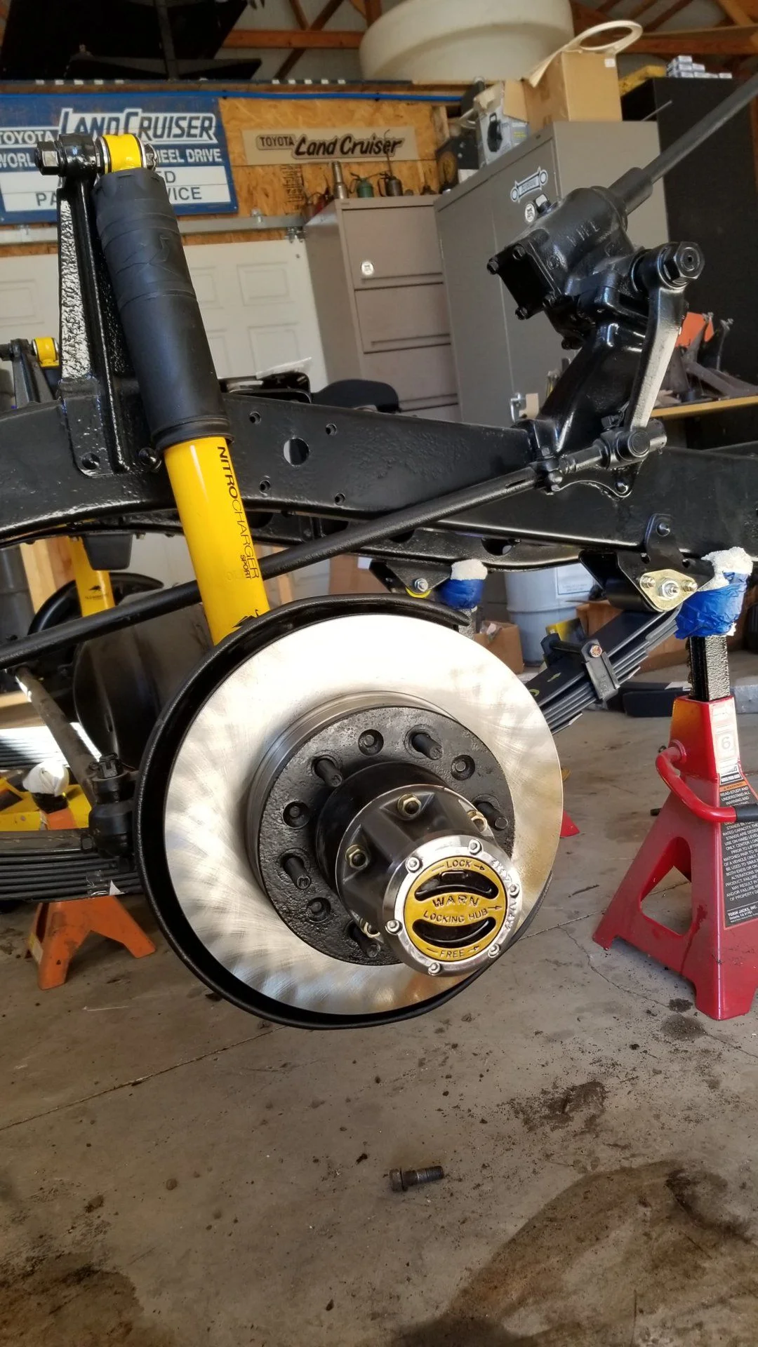

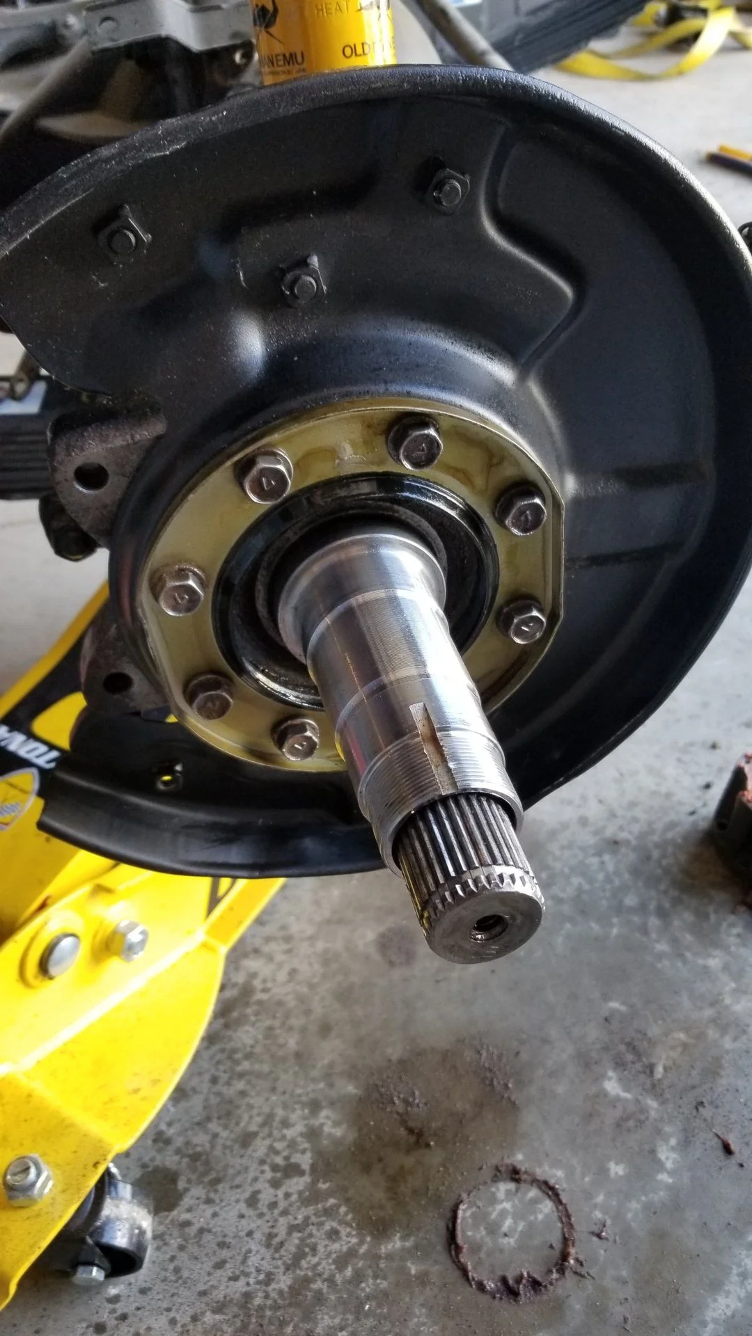

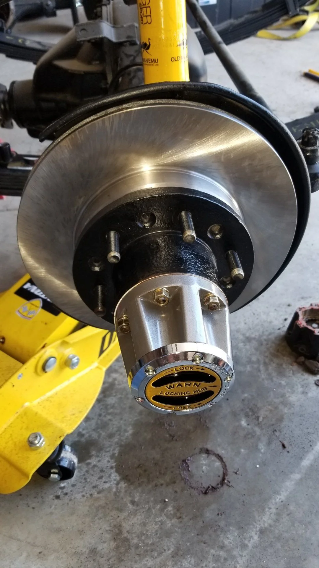

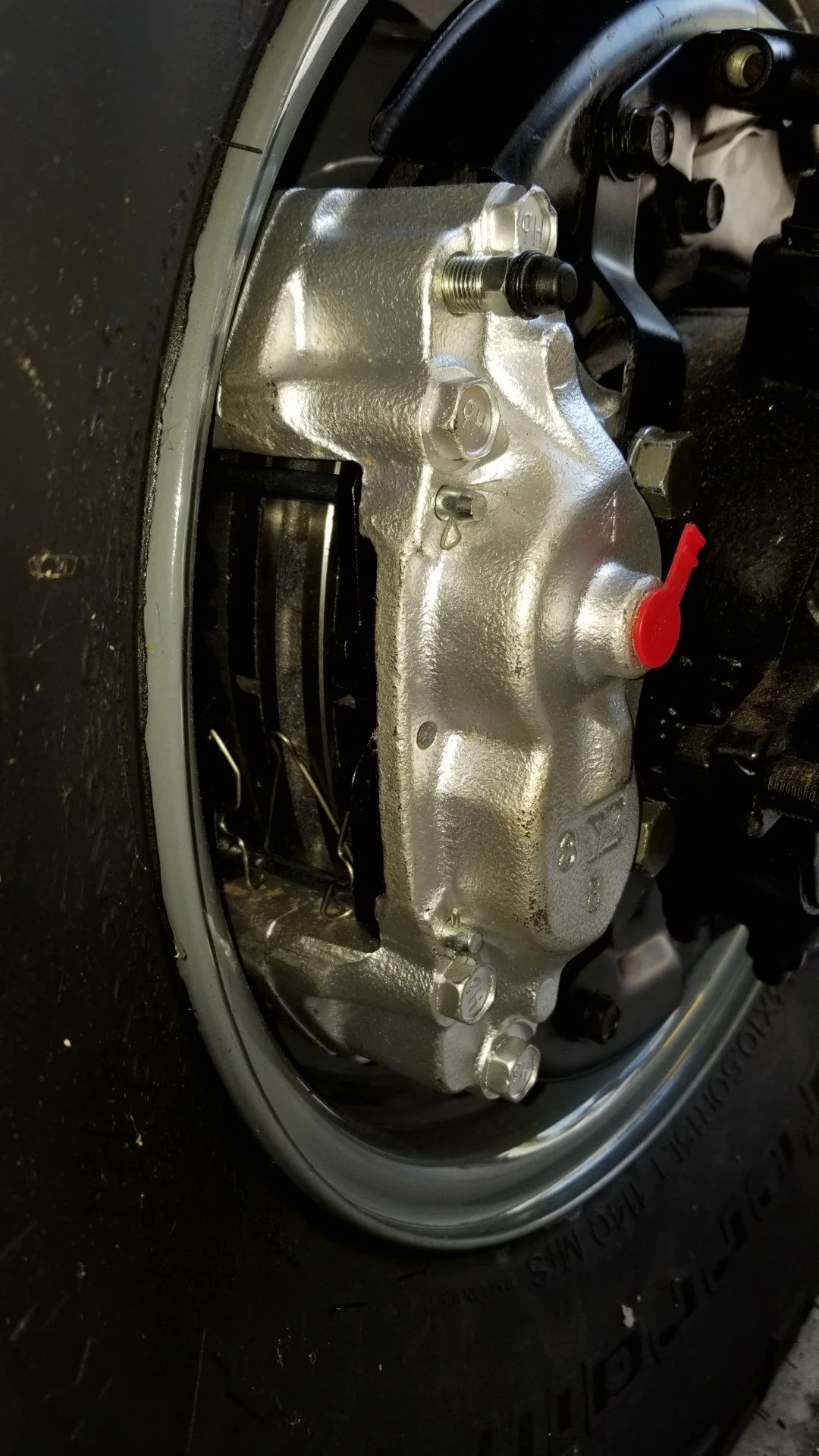

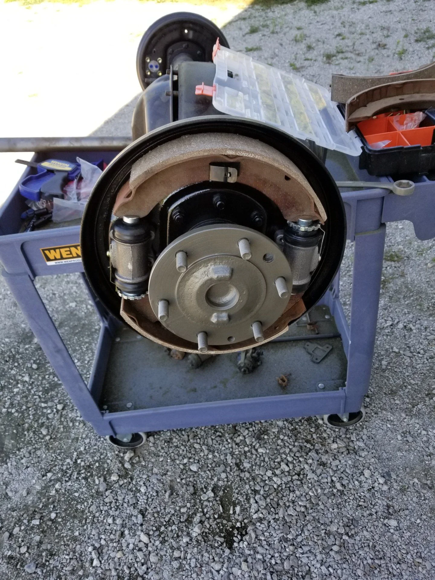

Frame is powder coated with a hammer tone black powder coat. It gives it a rippled effect and hides some midwest pitting. New Old Man Emu installed on the front. I did a front axle swap with disc brakes, rebuilt front axle using all oem parts today. New Toyota brake calipers, new toyota front disc, new toyota rebuild kit.

So that front axle was a direct swap? Everything bolted up and good to go? Thinking about the same for my '72.

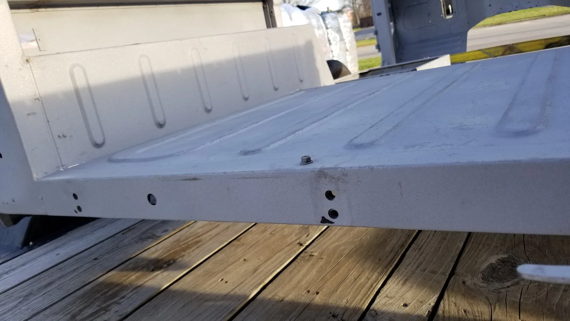

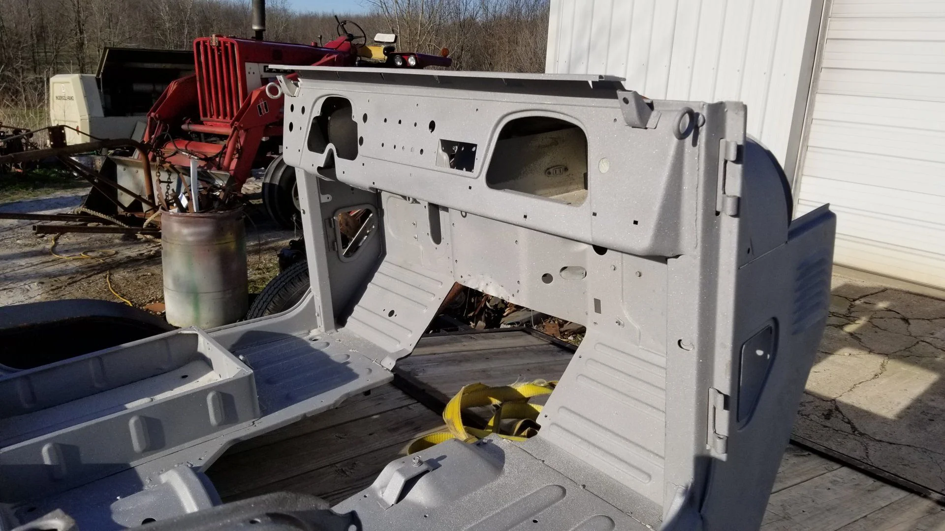

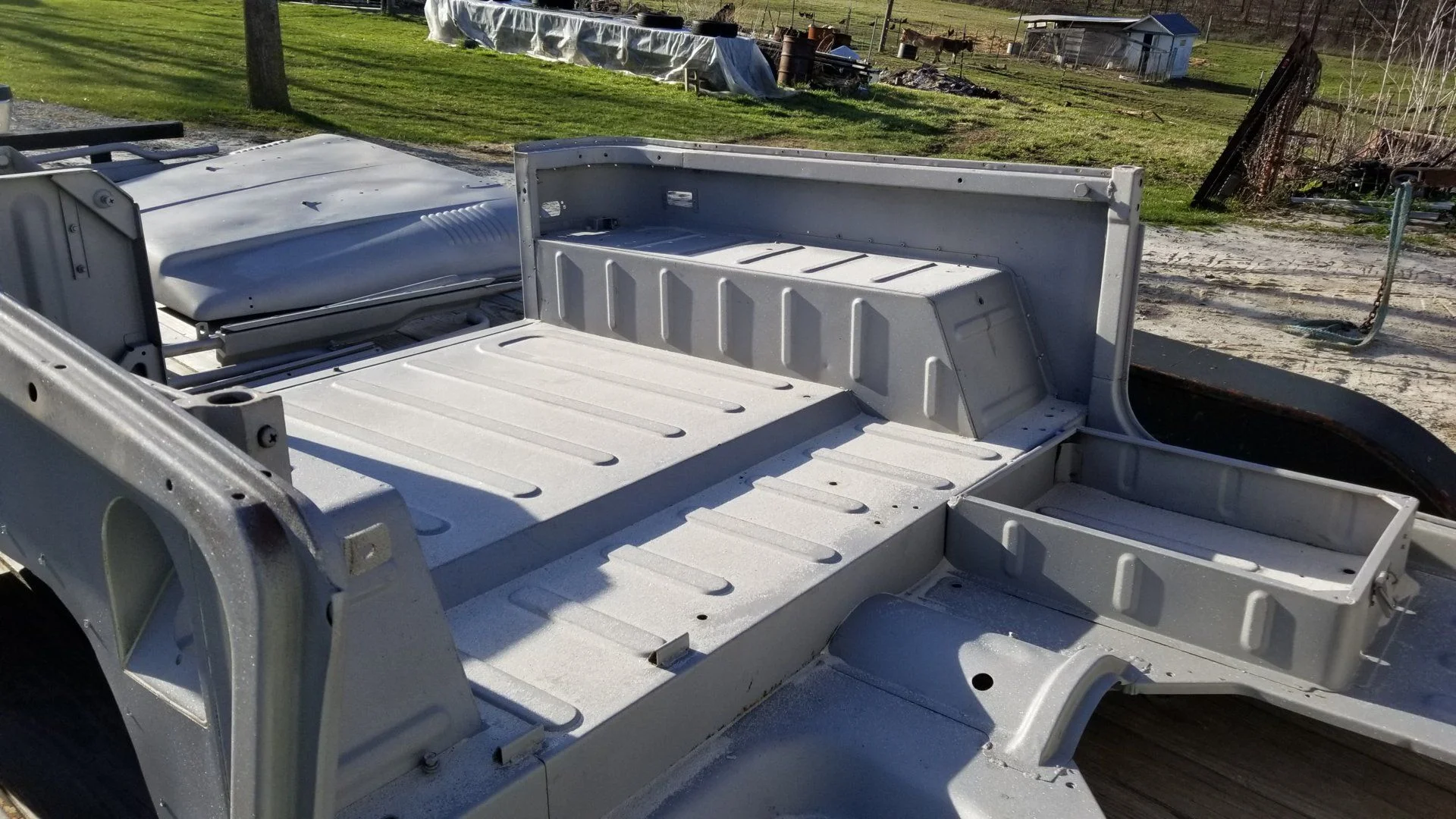

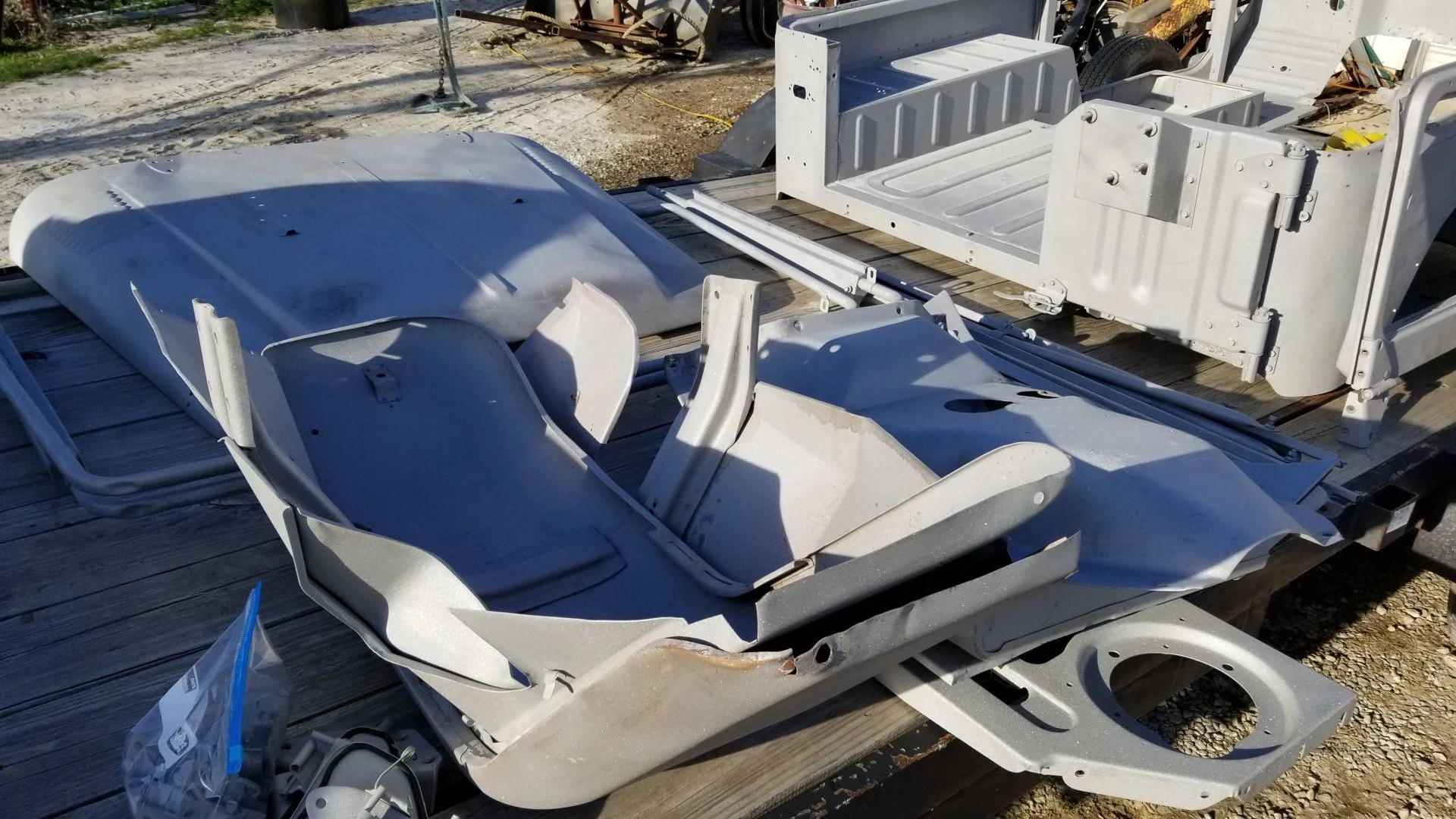

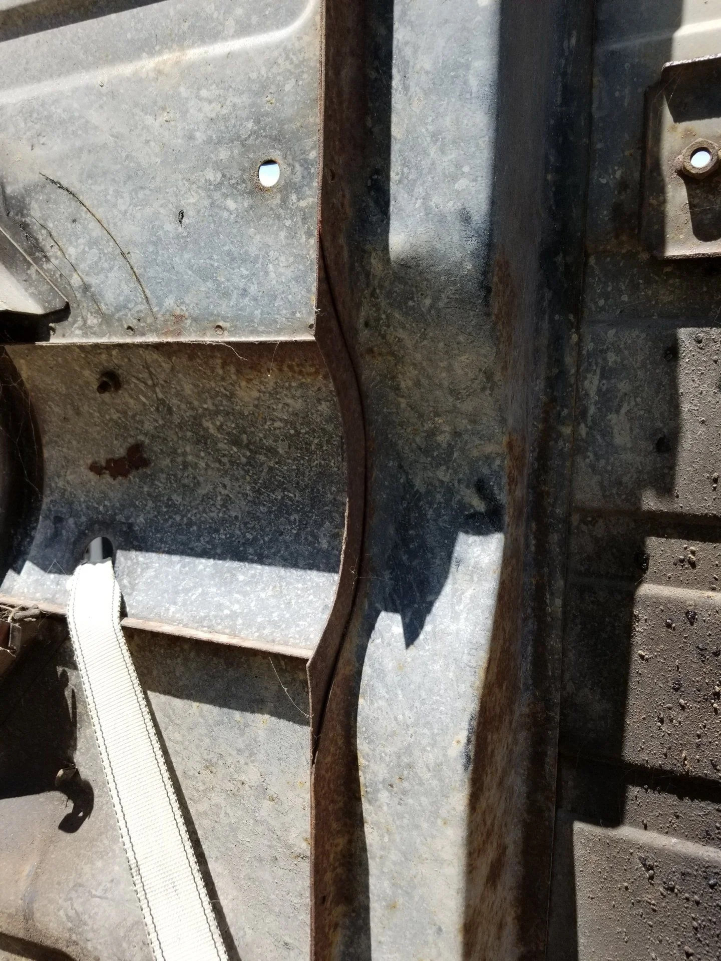

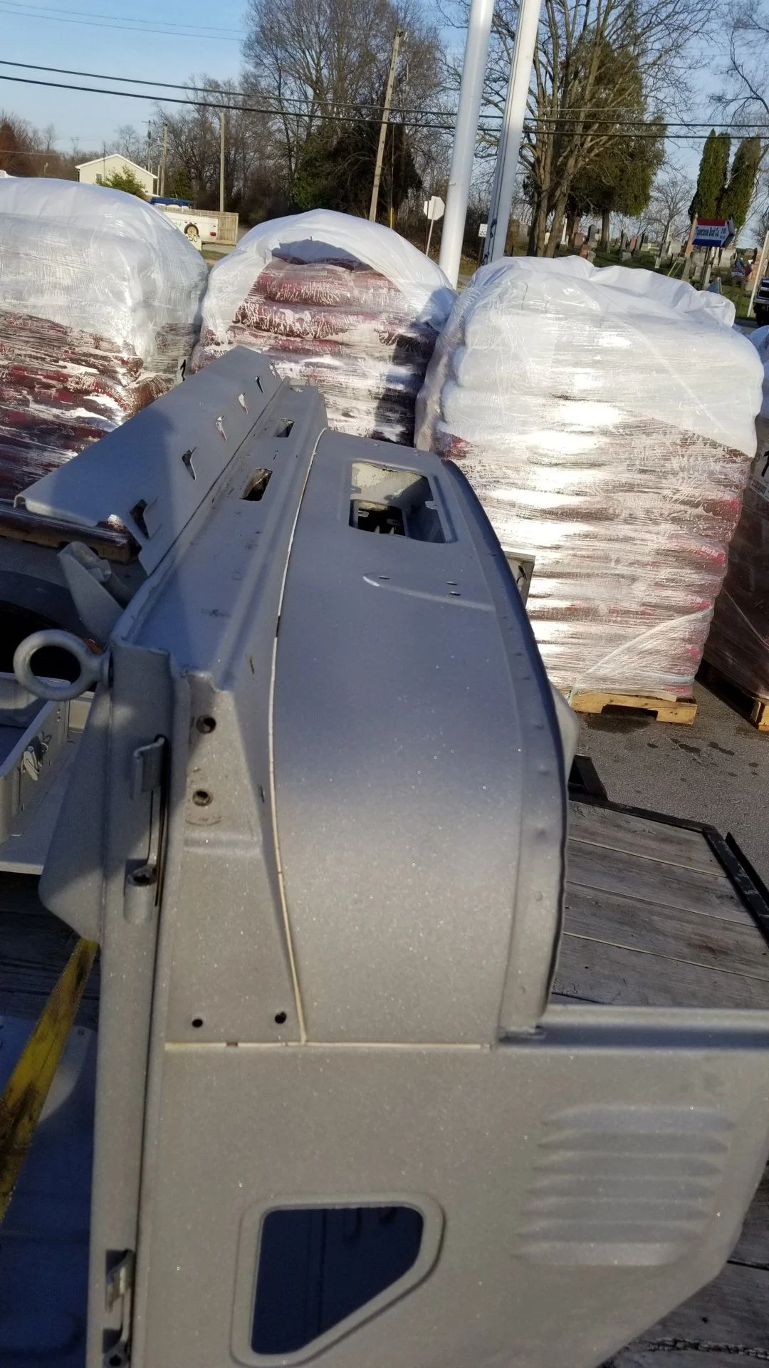

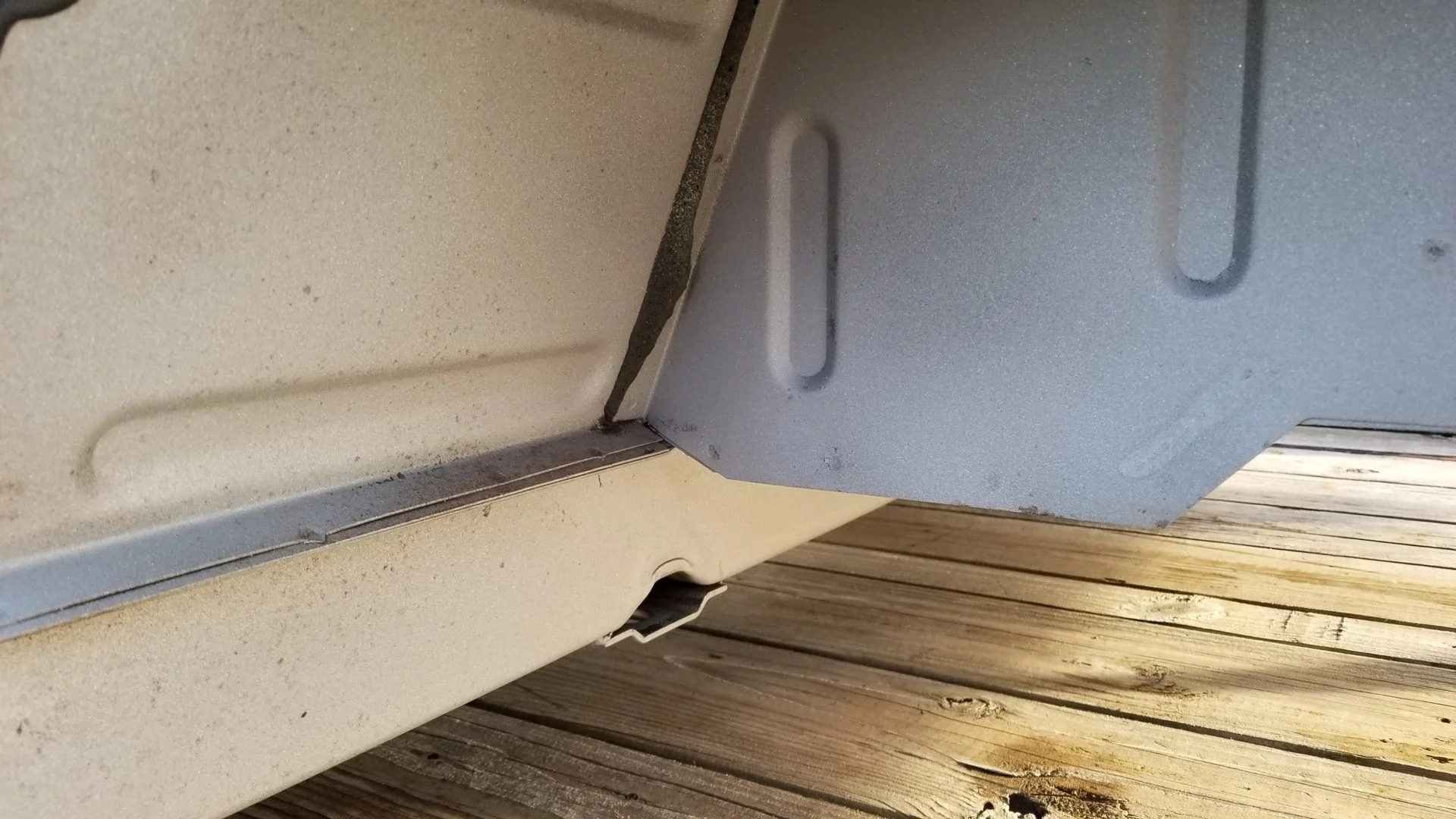

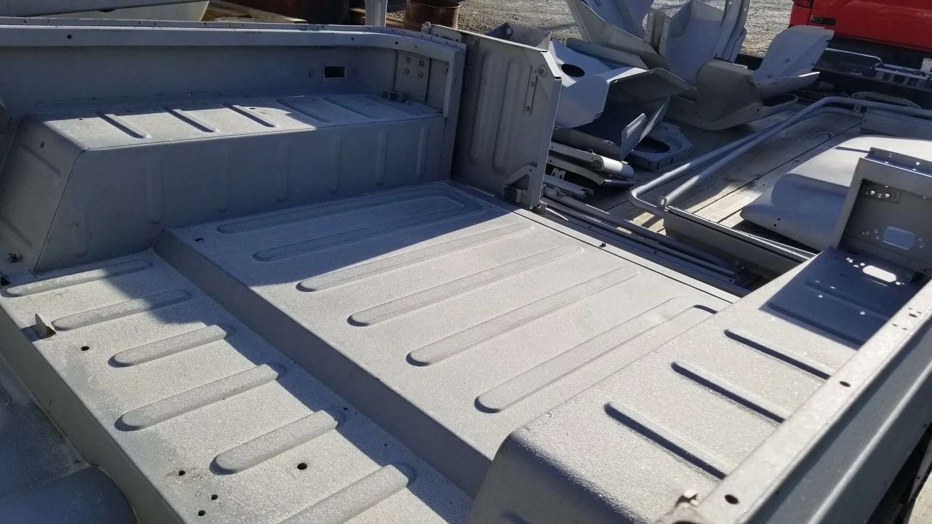

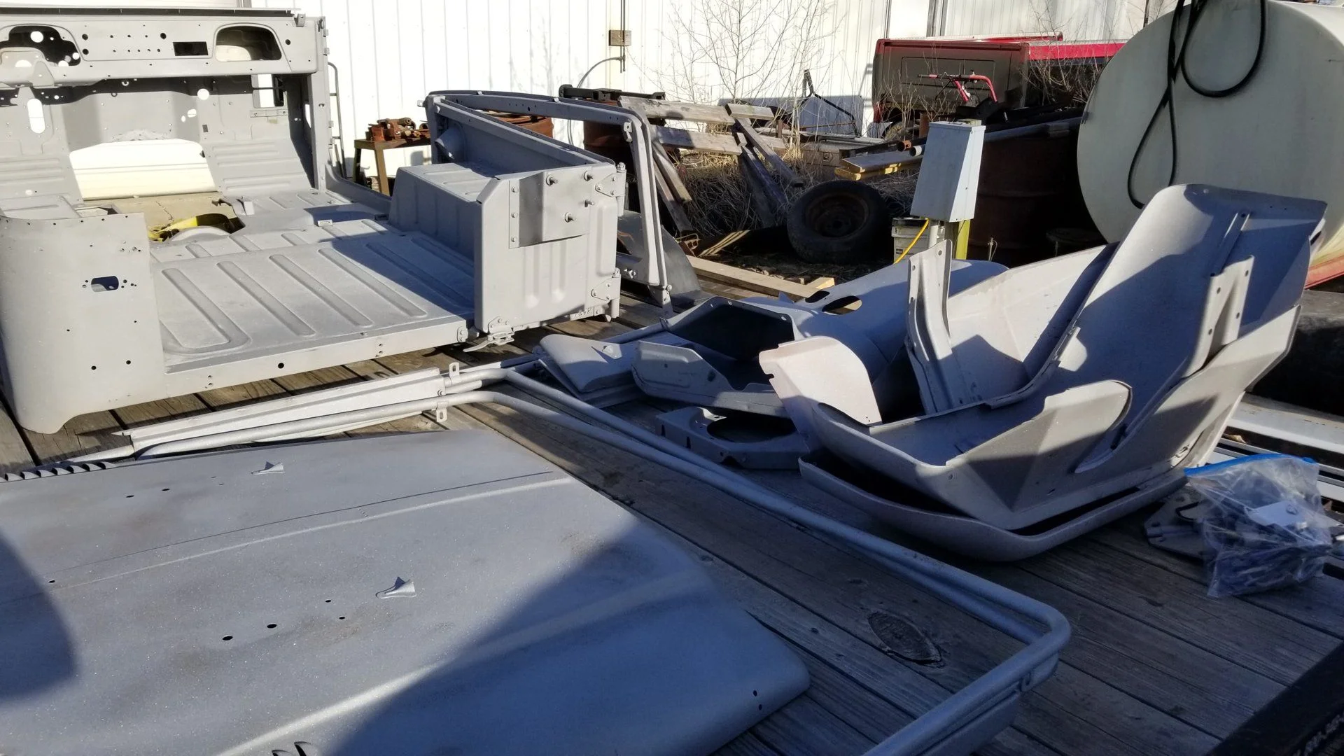

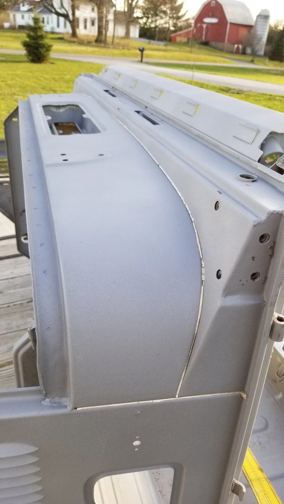

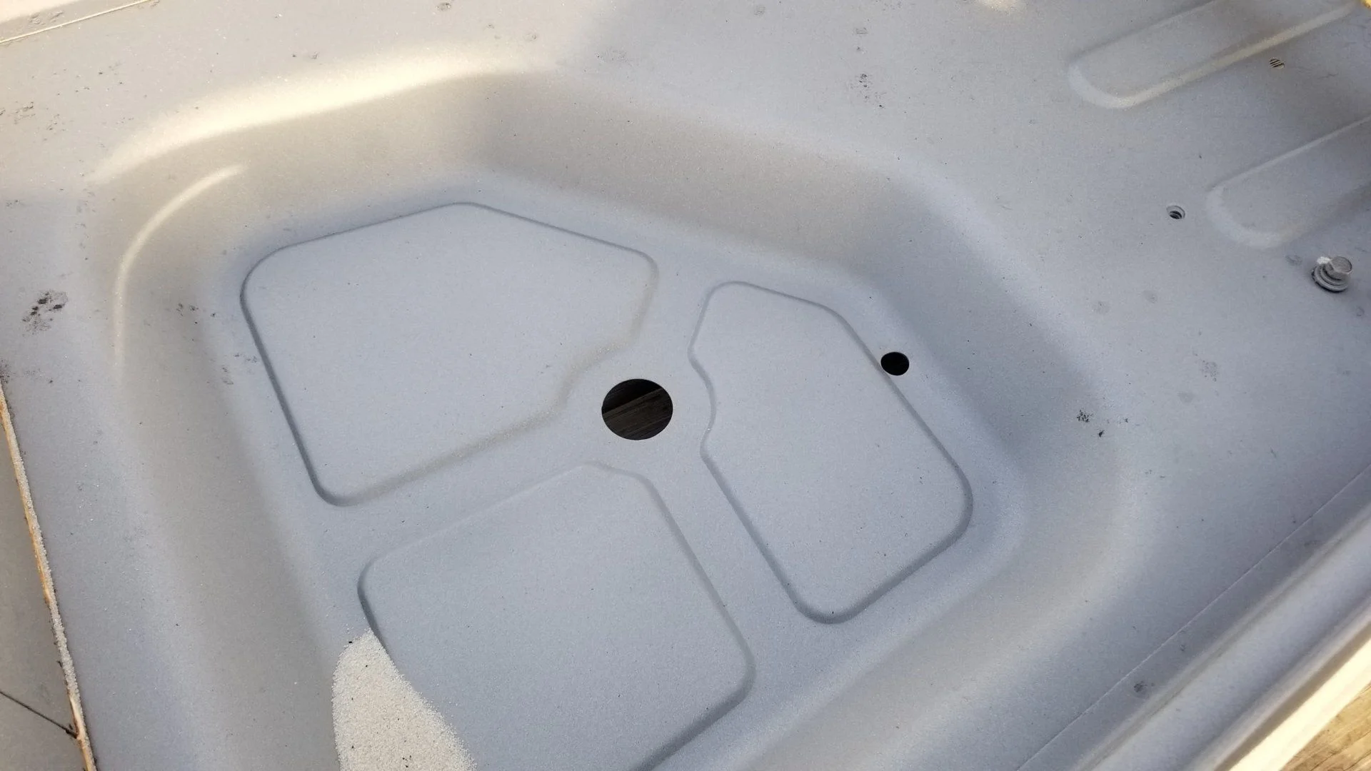

I have been a bit lazy this winter. This project will now be a spring/summer project. I took all the parts to get blasted. Bare steel hides nothing. This fst will be very clean when its done. Here are some photos.
Man oh Man does this look familiar! I'd love to park our two side by side when they're both done. Some of the pictures in our two builds could easily be mistaken for the other thread. I'll be watching...
