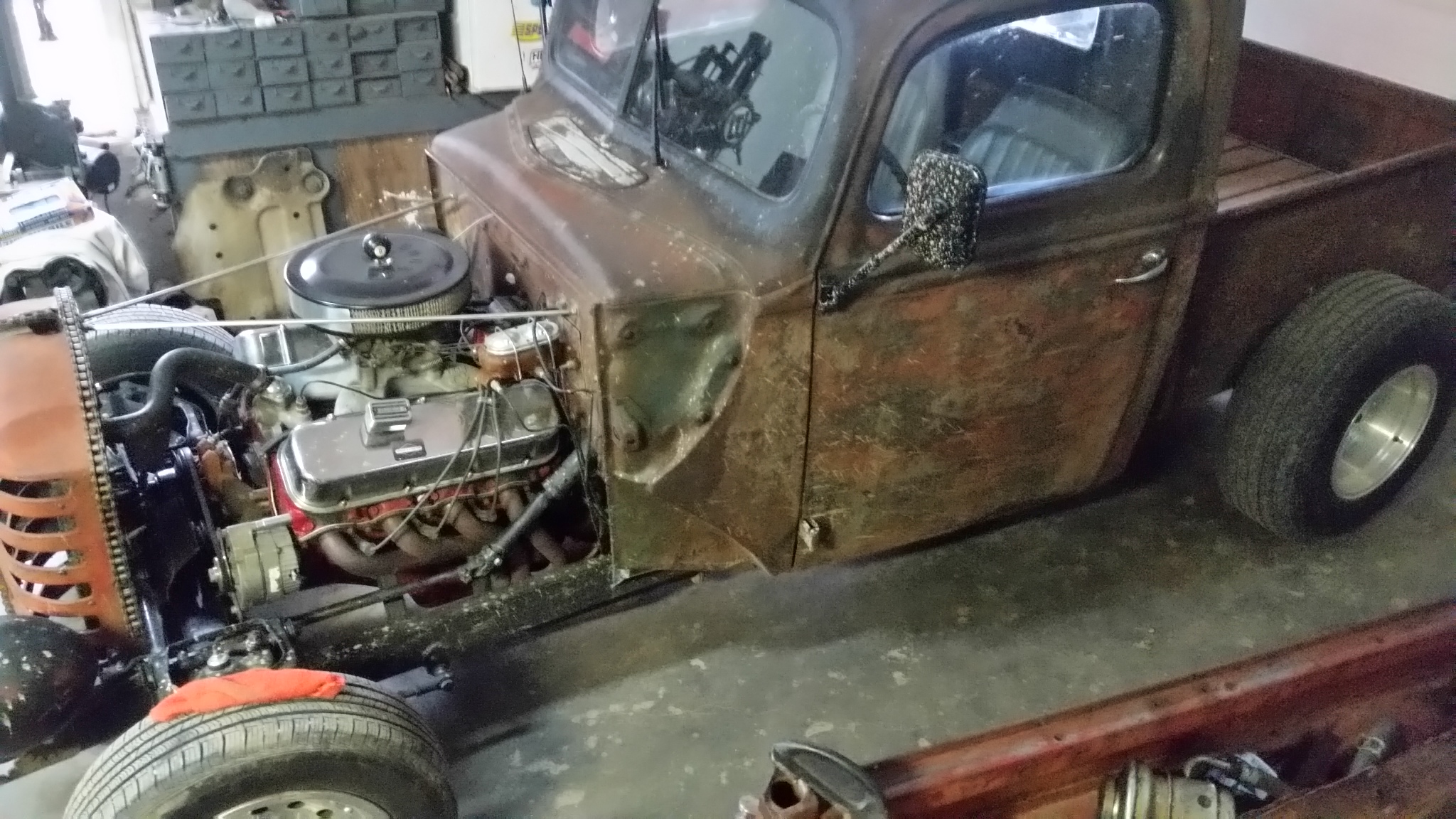

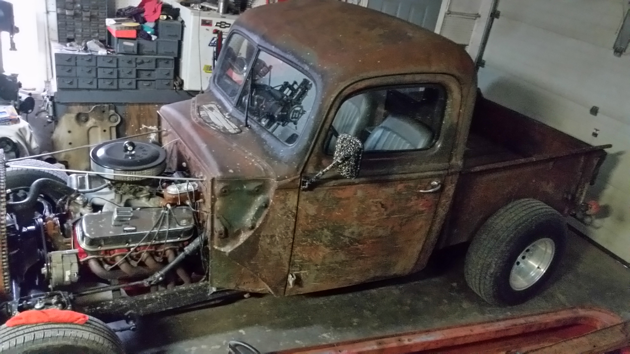

Windshield it self. I know finding a factory one in good shape would be high. But I can't seem to find a replacement. And I am not buildin this to drive to church it will be road hard and put up yet every chance I get. Would u know where to order one aftermarket. Thanks again for parts I am laying on creeper now boltin brake lines together.

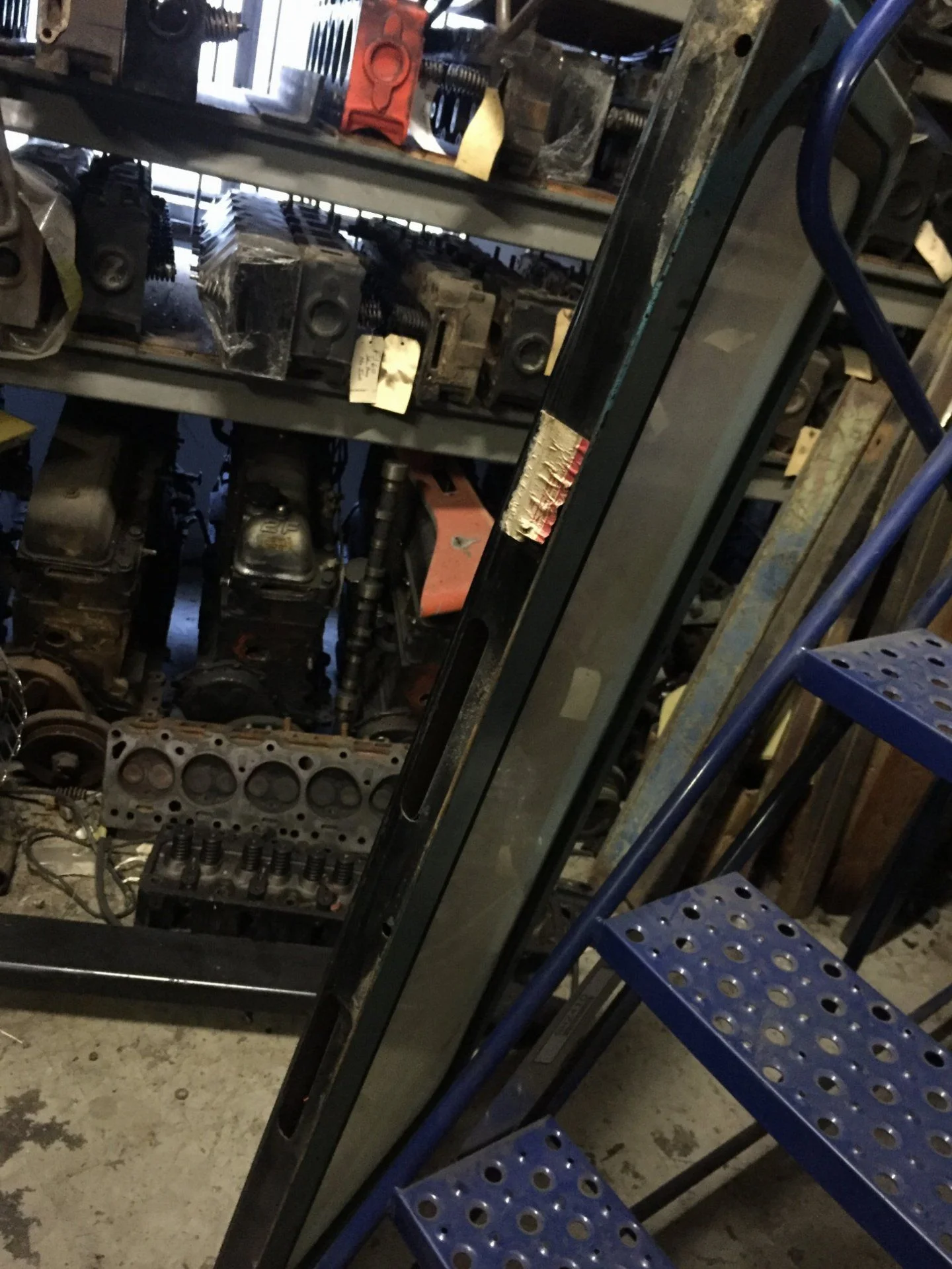

I have an NOS factory glass, and a factory replacement windshield frame. If you are interested, leave a VM at my shop and I will call you at some point in the afternoon tomorrow. Please do not PM me. Mark.

I'll pull one out tomorrow, and get back to you. Thanks, John

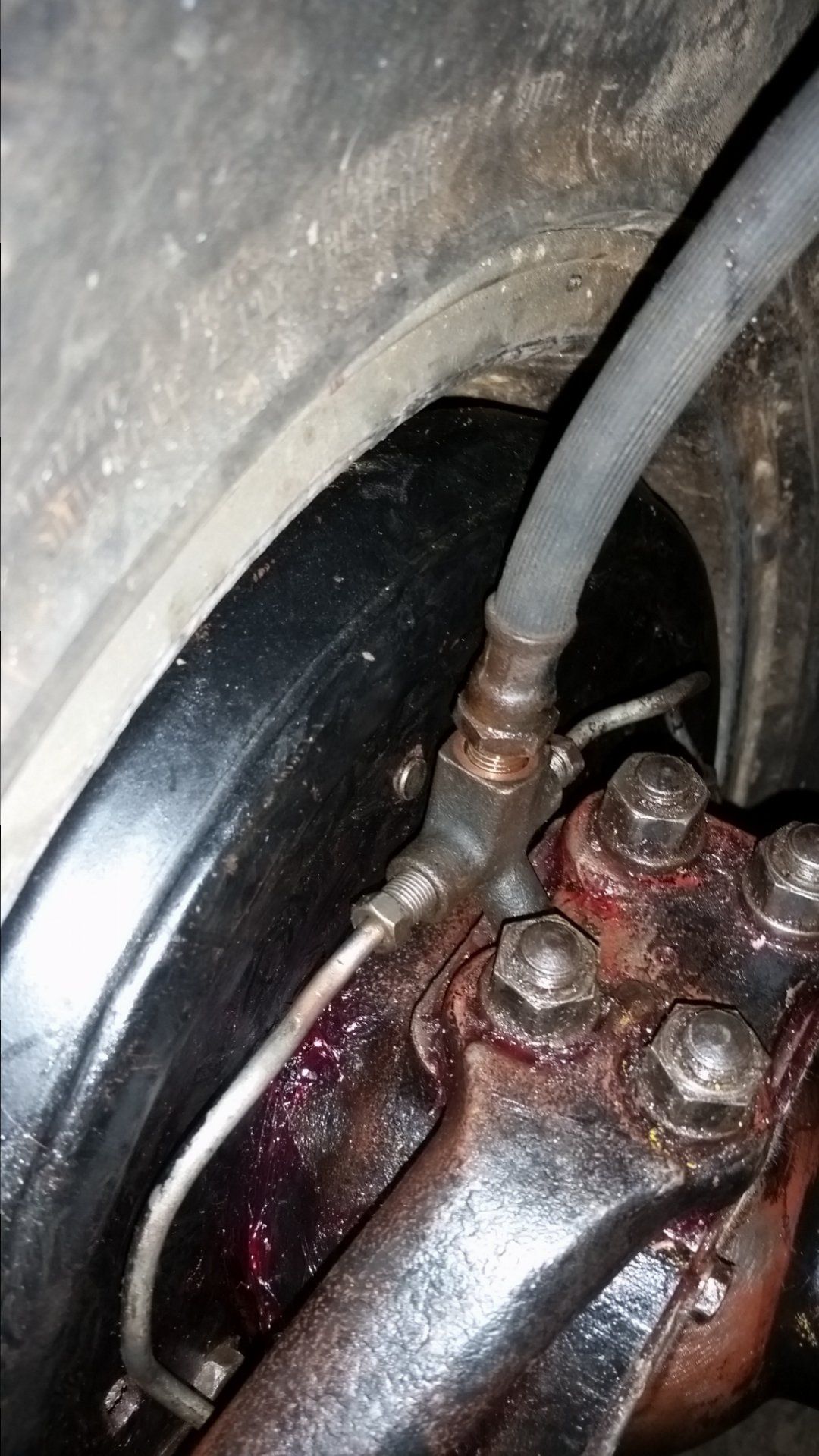

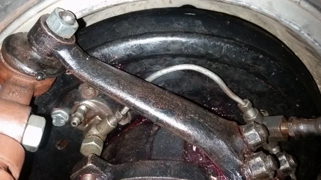

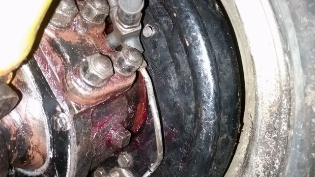

Looks like I am going to have to get some more brake parts. My rig is a 1969 but it was made in 11/1968. I have 2 manuals and a picture off of sor.com and none are the same. So do u know if the brake line itself goes into the wheel. Cylinder directly
drivers side then to a union on back then to rubber hose. Or does it have a single union in front with bango bolt holding it in the wheel cylinder then goes over to a double union with bango bolt and then to rubber line. Or do I have passenger side reght. The pictures I sent were of passenger side please let me know. Thanks john

Looks like you have the T fitting upside down.
Assembly is banjo at both wheel cylinders, tube to the T which should be bolted to the backing plate, then rubber hose going up to the junctions on the frame. HTH, John

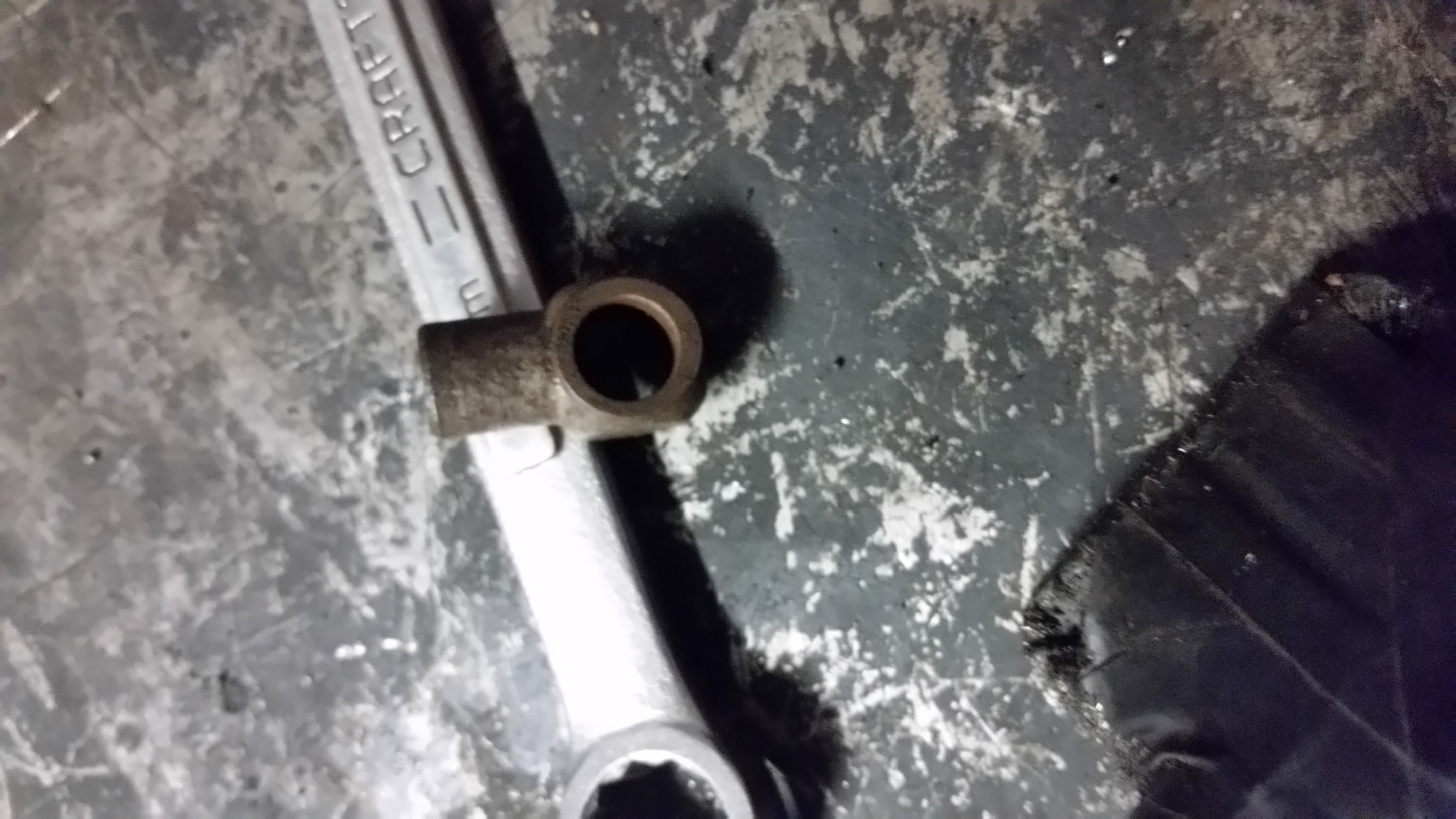

I just got it setting loose in there so I am going to need 1 more of these

And I need 2 of the single bang unions for front. In 30 mins or so I should non what else I need
Yes but I will have to make brackets to put them to backing plate there are none on the T parts

Check with Mark on the glass.
If you're not looking for NOS, somebody told me that cruisercorps sells an aftermarket glass pretty reasonably, and are already set up to ship them.
