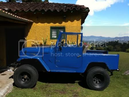

This is what I got
Nice "eyelids"
Looked like a nice beginning, little or no aparent rust, engine working ok, the wife even thought it was a good idea :)

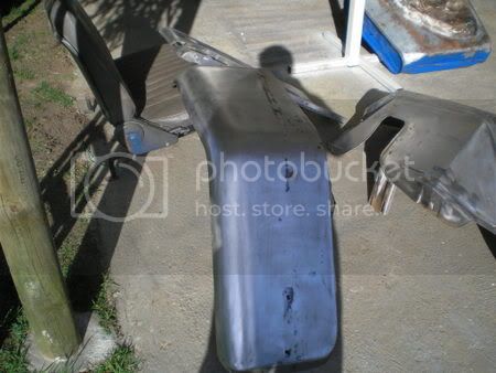

The mudflaps are realatively inexpensive and easy to find here in Colombia, I personally don't like them and removed them asap.
Carpet in the back
Carpet in front
More mudflaps

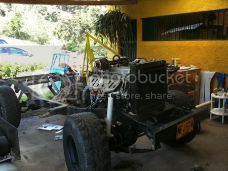

Engine in place
Sounds easy and even though it is not hard, the part that made me doubt the most was the alignment of the engine because I had read a lot on driveshaft problems and vibrations. The most important part, from my point of view, is measuring, measuring and measuring. Be sure that both driveshafts are completely aligned, be sure that the engine will not hit the firewall or the floor (bigger gearbox made it a little troublesome for me) and be sure that you will have space for the fan (mechanical or electric). On my case, the 1FZ-F engine is loooong and I had to use an electrical fan because the oem wouldnt fit and because it is slightly to the right right of the engine and it would not cover the narrow radiator that fits on the oem supports.
In the last pic, you will see that the engine is very close to the third member, in fact, it was less than an inch, that led me to another mod that will be posted later. You can also see that I put two strips of masking tape at perfect 90 degrees with the crossmember to use as a visual guide for centering the engine on the front.

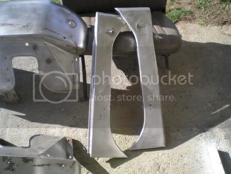

Then, after two days of hitting my knucles against any imaginable part of the frame and body, I had a bunch of parts, a lot of mess and no FJ!!!!
Midway between a car and a pile of stuff., Sometimes I worry if I will remember how to put it back together.

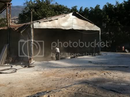

Then, frame goes to the sandblaster
These guys must live short, very little protection, a lot of noise and dust. Third world,

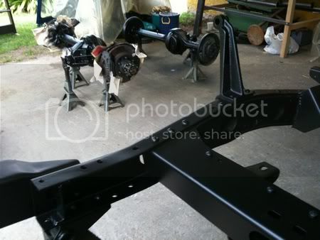

Frame and axles repainted....
Two months later (I only get a chance to work on the truck on weekends), I had a beautiful frame and axles with new springs and all new bolts. Time to start with the body.

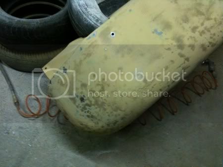

I stripped the old paint with paint remover because I was afraid of warping the metal with our "highly specialized sandblasters". What a pain...
Well, I have an advise for newbies, if you are planning on getting to the bare metal, do take into account flash rust. All these parts were left in the garage for a month or two and when I was going to apply primer, it was all surface rusted, and had to sand for hours. So, if you strip, just before considering it a day, spray some primer on and dont leave the metal unprotected,. it will save you a lot of time.

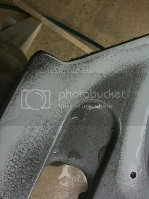

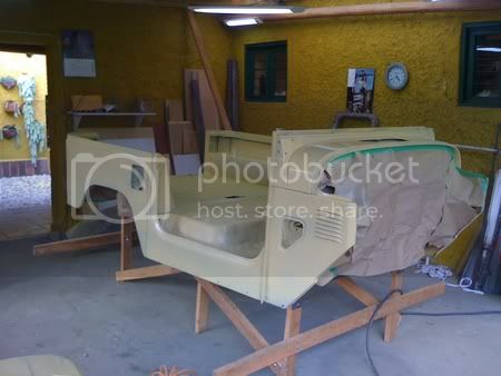

First, clean, clean again and spray primer. In my case, I had to sand everything again. I used 100p grit first and then 220p grit before cleaning and painting.
It looked like this
So you would say, good, you are ready to paint. :)

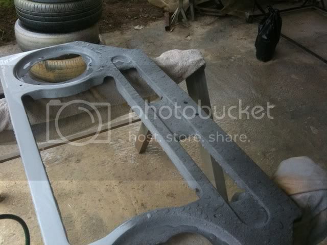

Well, no. After these three layers of epoxy primer, I sanded with 320p grit on a small block after lightly spraying the whole surface with cheap matte black paint (it dries very fast and makes a nice contrast with the yellow primer). Now you start to see that things aren't so cool,
Bare metal looks beautiful

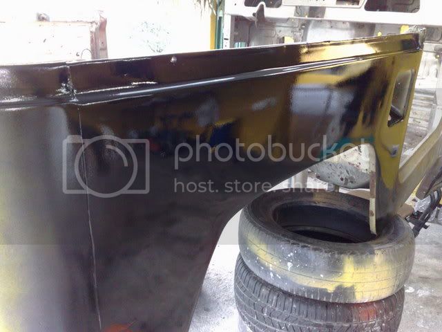

Then you primer and block and find......

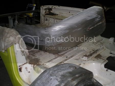

So you say to yourself, this is peanuts, a little bondo here and there and Im ready for paint. But life for a googlexpert isnt as easy as the internet, look what I got after repeating the cycle for three times.
Those parts where you see the bare metal are high spots, the places where you see the black shadow are low spots, so that means you still have a long way to go. It took forever, and when I thought I was finished, I read that for a good flat surface you need to use huge sanding blocks, not the small ones. So I resanded an indicator coat after thinking that I was finished and man, I almost cried.
My humble advise, use huge blocks from the beginning.

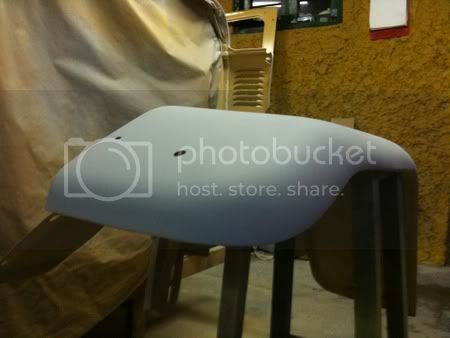

I read a lot on the grits of sanding paper, for me, this is what worked (I hope I didnt make a huge mistake and if someone thinks this is wrong, please correct me so others dont repeat my mistake)
After applying the bondo, I used 100p grit to remove the coarseness, not to get the surface flat because the scratches will keep showing.
Then, with 220p grit, you sand in an X motion, this is very important to avoid digging into the bondo and making waves

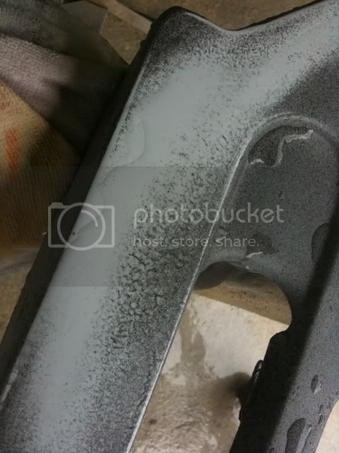

When you think you are ready, spray the indicator coat and use 320p, this will show minor details. I found out that the backing has to be as hard as possible, when I used soft backing on the sanding board, the surface will not be flat because the sandpaper adapts to the imperfections and doesnt flatten them.
When I finished, I repainted everything with primer again (read somewhere that it is better not to paint on top of bondo because the chemicals are sucked by it and it will show in the near future.
When I finished this, I sanded again with 320p and covered all with a high build primer that will cover the inevitable scratches and borders between bondo and metal
So this is how it looks now, just before sanding with 600p
This weekend, a new indicator coat will be applied (I know that expert painters dont do this, but I have found that it is the only way I can be sure that I have sanded enough and everywhere.
After that, clean, clean, clean and paint. I hope I do get a good weather and in such case, I will post pictures of a renewed blue fj40.

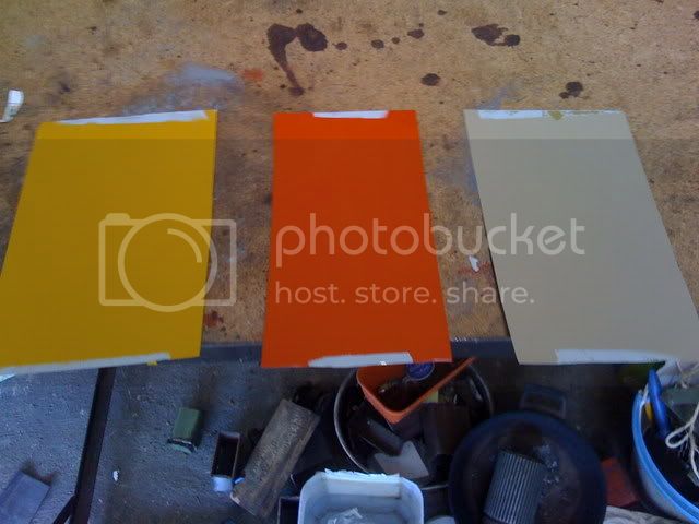

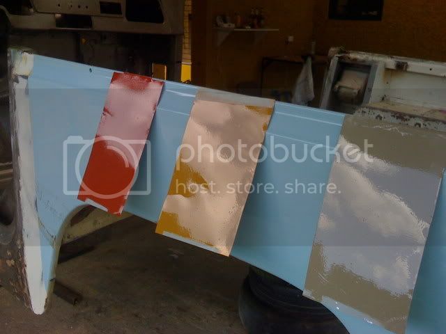

Color
Wow, lots of work. Doing an excellent job !
What color will you go with ?

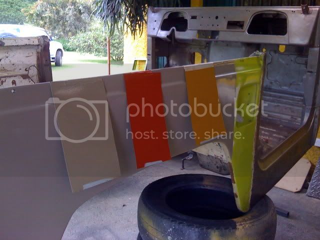

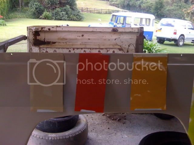

This was one of the most difficult questions I made myself during the last two years!!!
This was the first time in my life that I could have a car with exactly the color I wanted, so this makes things hard. You normally have to adapt to what the dealer has but in this case I could even get a color that no one else had.
I found a place in the web where they have all the formulas for Wanda Paint on the original Toyota colors, so I started testing....
I even tried matte sky blue, looks perfect but once it gets a scratch, nothing besides painting will clear it.
Finally, I decided to go Sky Blue (Color Code T854).

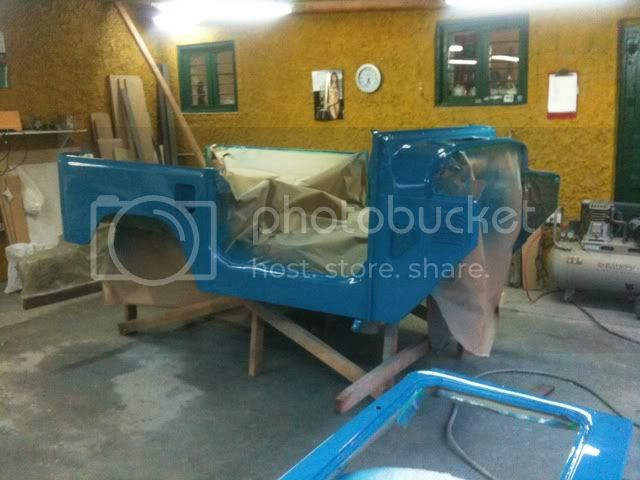

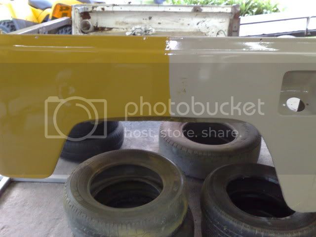

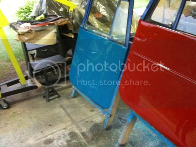

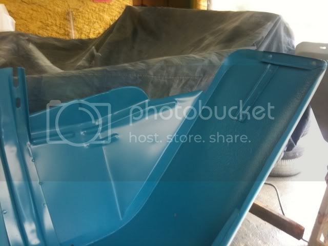

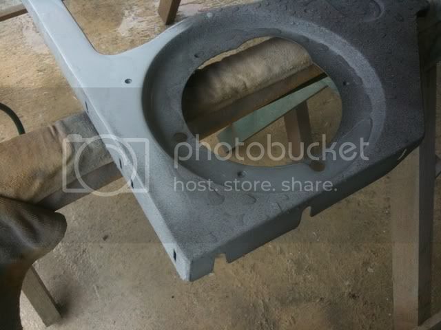

This weekend the weather was average and I got to paint, the whole tub, the back part of the windshield, insides of fenders and doors and some other small parts.

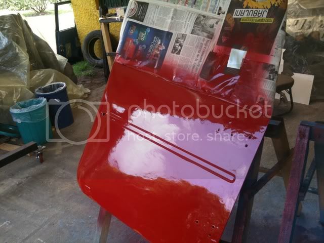

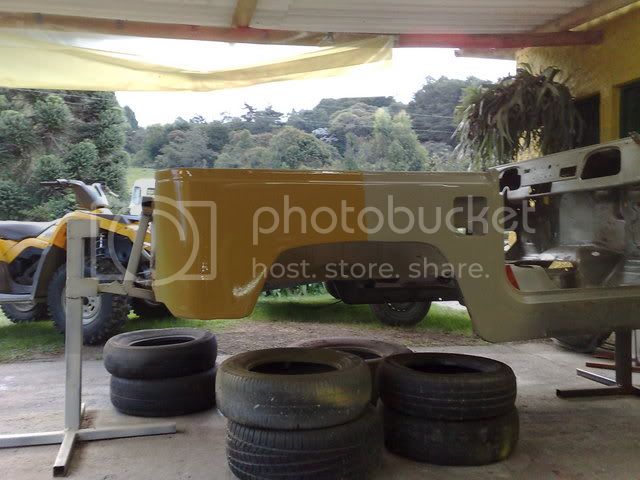

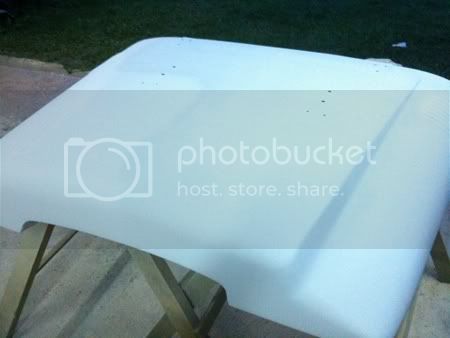

First, I would like to show what the indicator layer does. In the pictures, you can see what seems to be a perfectly smooth surface, to the eye and to the hand. When you start sanding, you see that it really isn´t so smooth. My 2 cents, use the indicator layer, it does mean a lot of work but the smile after the final result will show two more teeth!!!
Hope this gives you an idea.
Thanks for reading.

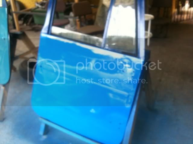

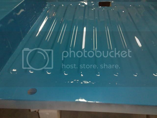

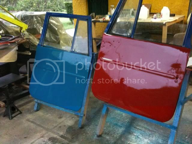

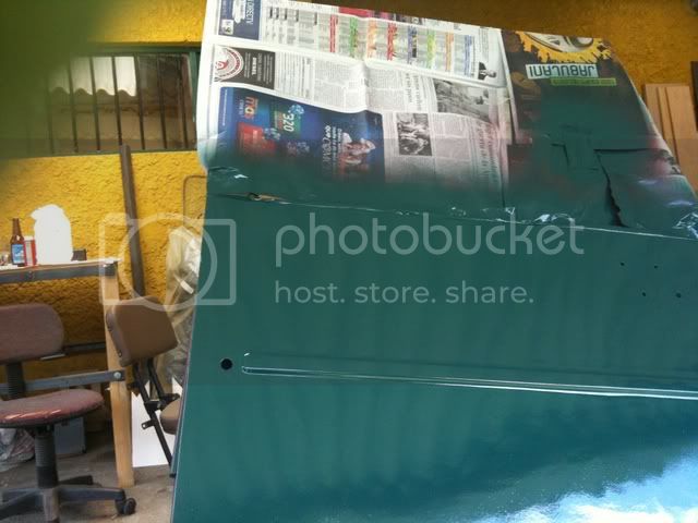

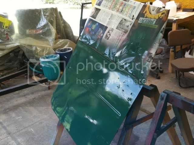

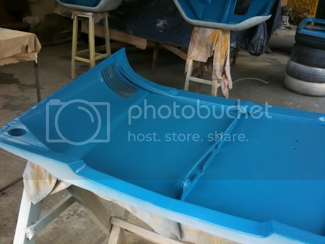

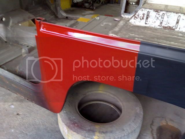

Blue is a hard color to get in a picture, specially if it is a cellphone and the lights are white. All these picutres were taken at the same time, with the same cellphone and all the paint came from the same container, I know the color is exactly the same in all the painted parts, forgive my pictures.

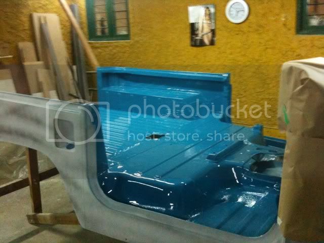

This is what I acomplished this weekend.
These are after applying the first coat (color coat)
No shine, but very easy to apply. Almost impossible to get orange peel or runs at this stage.
Then, 3 layers of clear coat.
Thanks for reading. I still have to paint the fenders, the outside of the hood and all the small pieces. Hopefuly next week.
