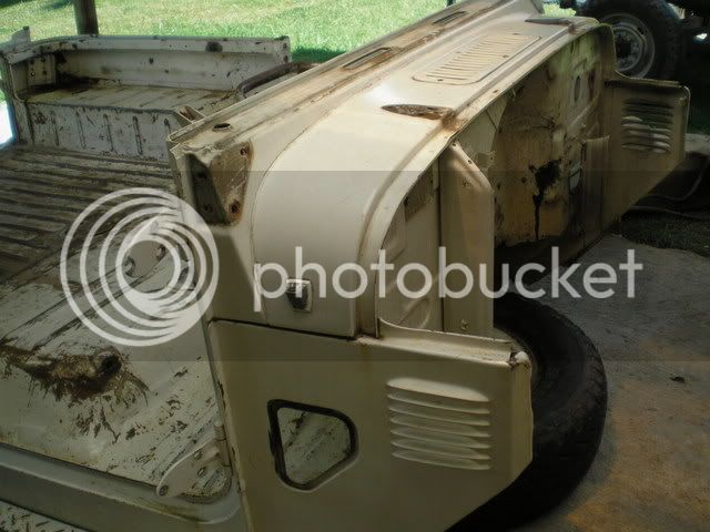

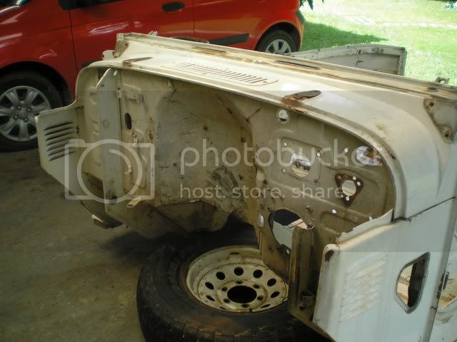

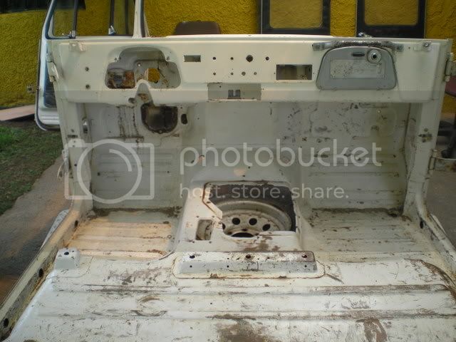

Congrats on your observation skills. The original tub is a 68 but I didn´t like the fact that the fuel tank was inside the cabin and the cowl was in bad shape (on the first pictures you can see that). I got a "new" body from a 79 (the white one you see on the color testing pics) that was used for the build. This got me new style doors, fuel tank outside the passenger compartment and a few "what do you need two old cars for" from the wife :).
I think the horizontal "ornament" is not stock. Probably a PO thought it was cool.

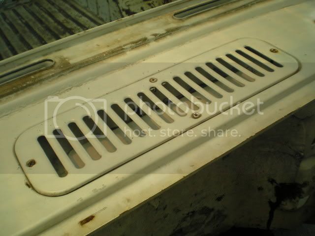

These are some pics of the "new" body when I got it. The whole rear was replaced for a new one which are cheap around here.

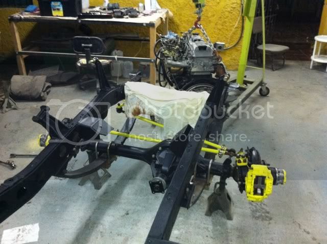

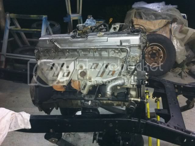

This weekend I got the engine and gearbox back on the frame.

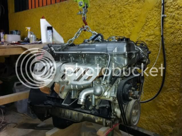

First, I lifted the engine from where it stood for almost a year...
I didn't want any scratches so a t-shirt was placed over the frame
After an hour or so, the engine (1FZ-F) is sitting on the two engine mounts and supported in the back on a jack

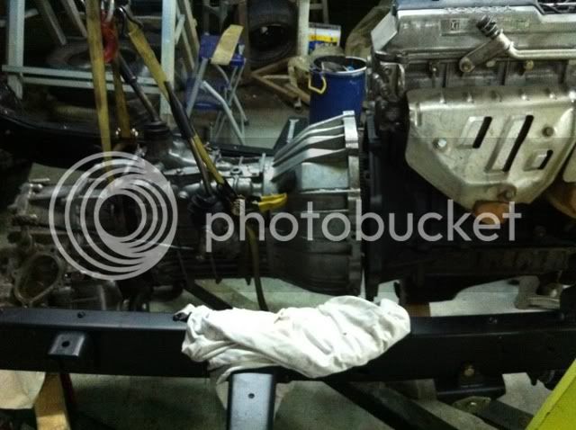

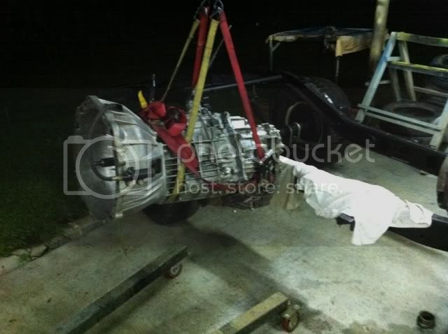

Then comes the gearbox, again, a t-shirt for scratch protection

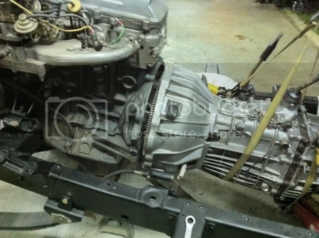

Mating the gearbox with the engine. Easy task when you don't have the body in the way and you are not lying on your back :)
Finished, only missing the gerabox suport.

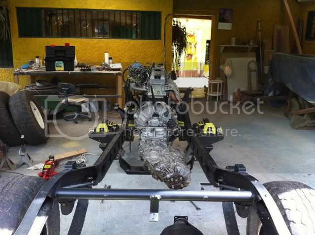

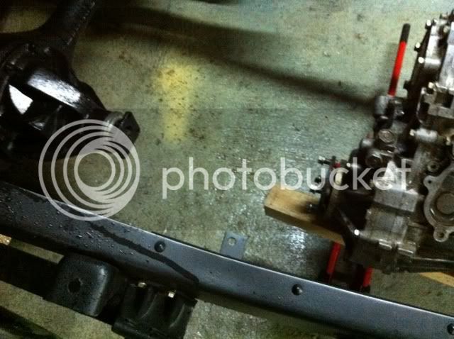

One of the issues that has to be considered when you swap a Series 70 engine-gearbox kit is length. In this pic, you can see how short the distance is between the gearbox and the rear 3rd member. I have made a lot of measuring so the angle is as small as possible, hoping not to have drivetrain vibration.
Rear view of the completed chore...

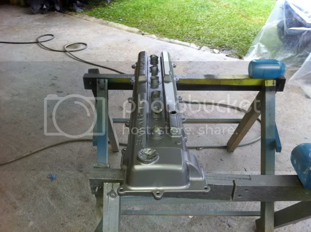

I felt the valve cover was not looking god so I painted it

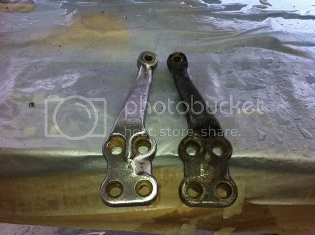

I found this picture where you can see the before and after process that I did to all the parts.
