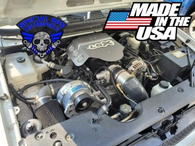

I took all of that into consideration and ordered a loaded trailblazer ss intake that comes with a dbw throttle body, fuel rails and flex fuel injectors. It won't look as cool as some of the other options I was considering but its certainly cheaper and is said to be the best flowing cathedral port intake they made.
I also ordered an engine cover to hide the ugly lol.

Where did you buy the intake cover from? I have an LQ 9 going on my 56’ GMC, and I’m not keen on the stock cover either.
Heres the ebay link. They make 2 versions, a shortie with 3 holes that fits the actual tbss truck and a longer one with 4 holes for swaps with more firewall clearance.
They seem to be on the ball, shipped out 2 days after I ordered with an email asking which version I wanted in between.
