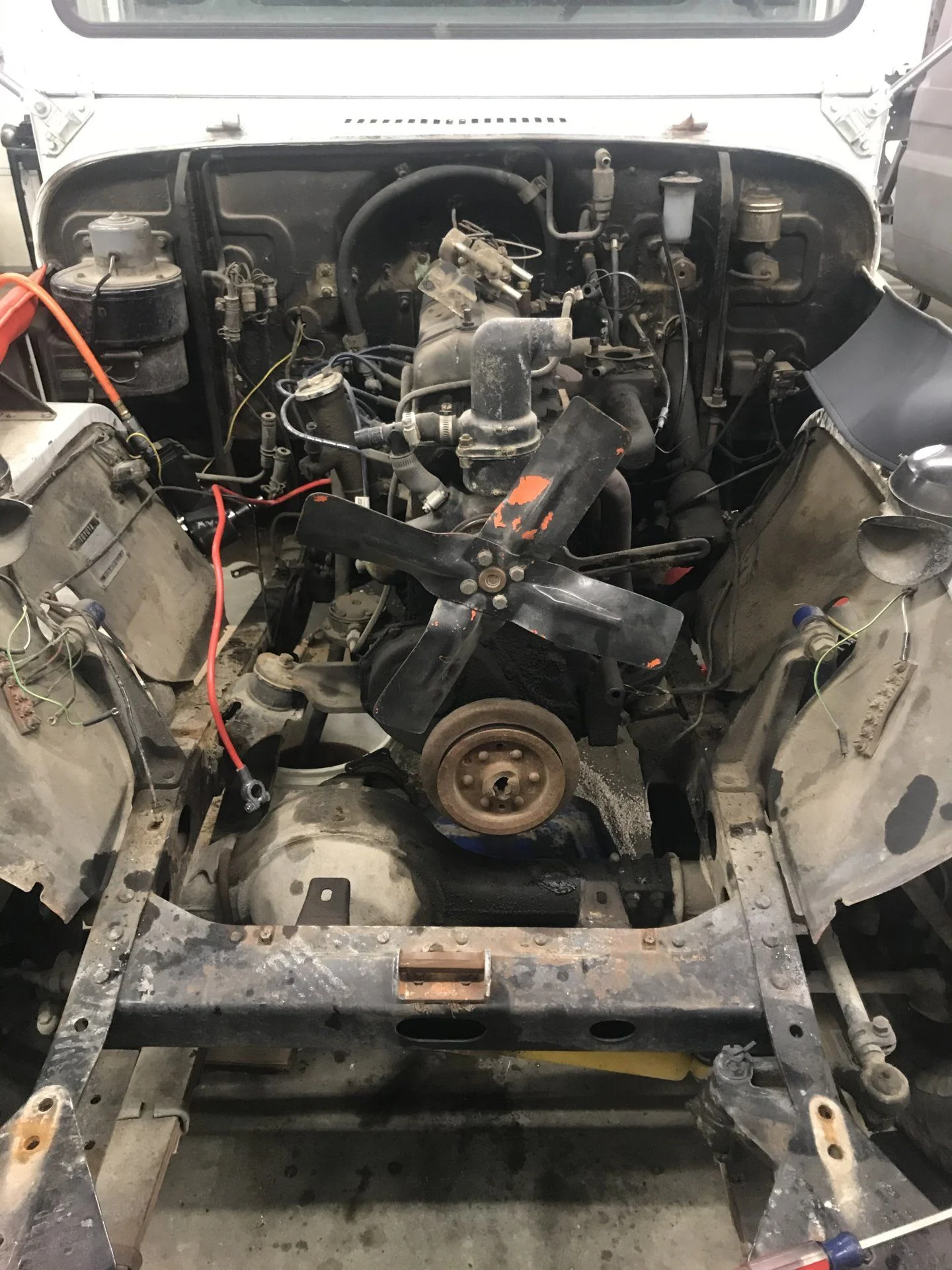

Started in on tear down.
chunks out of the trans

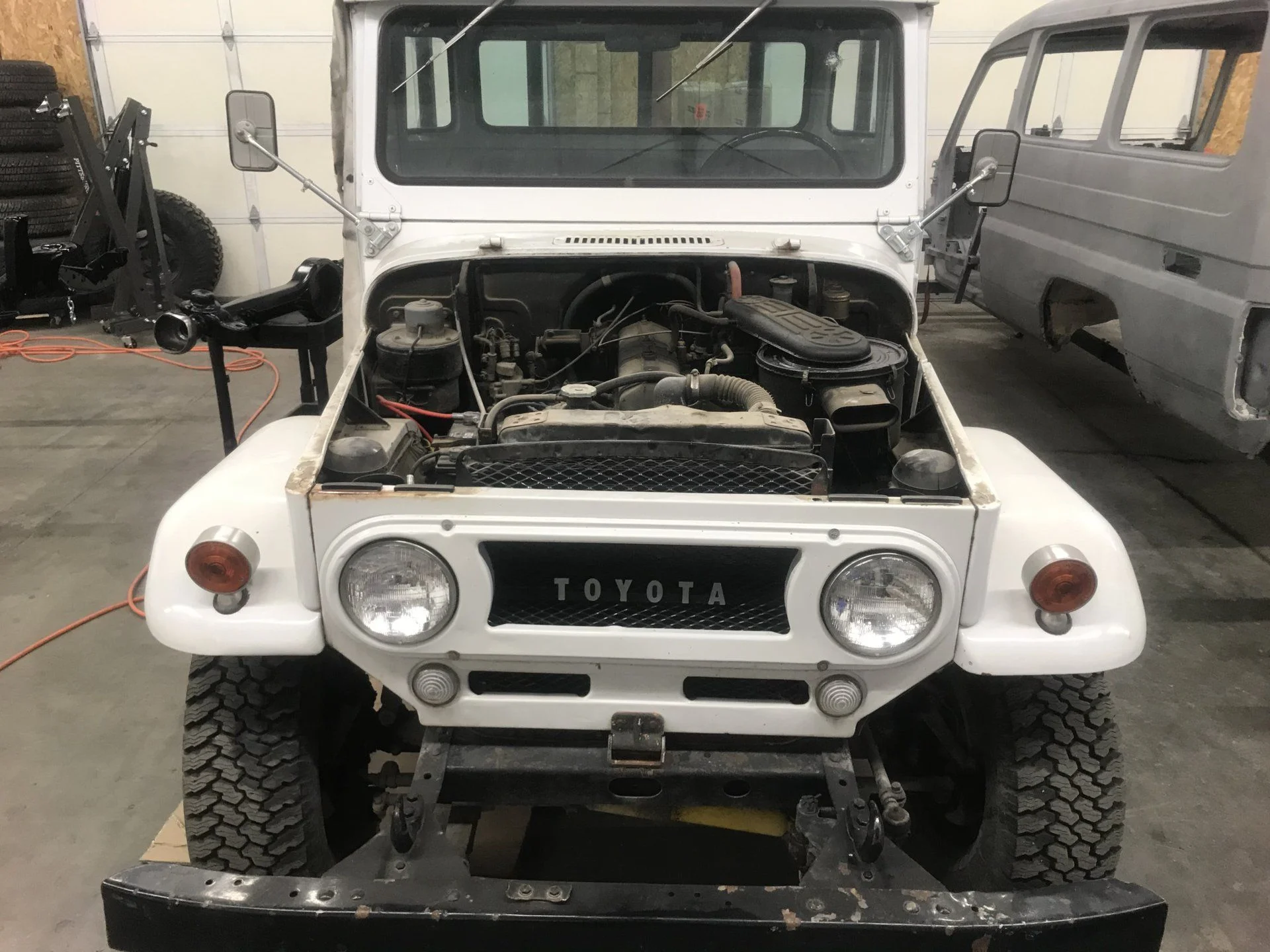

I believe this is the original color.

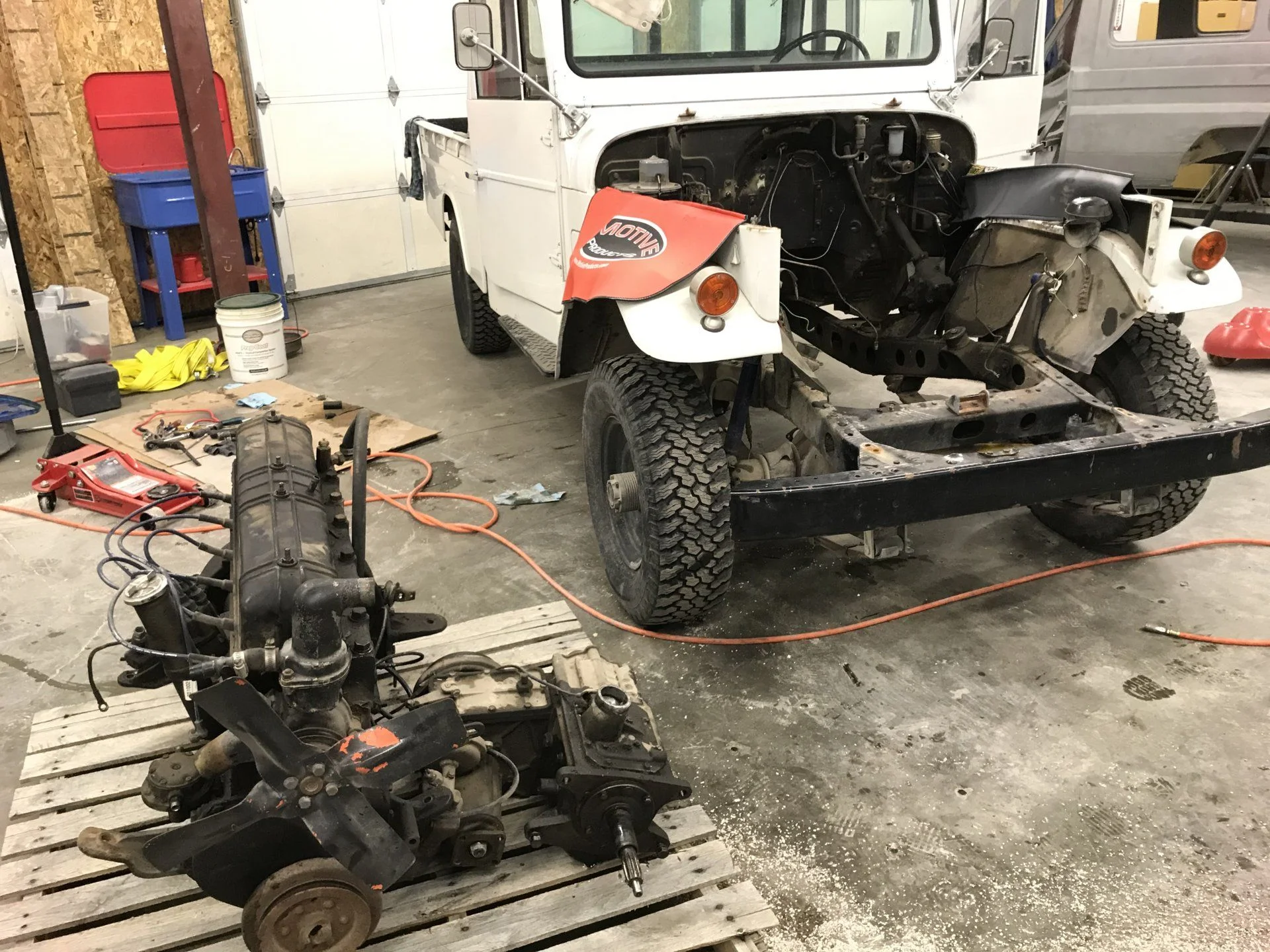

Should have the power train out tomorrow.
Cheers

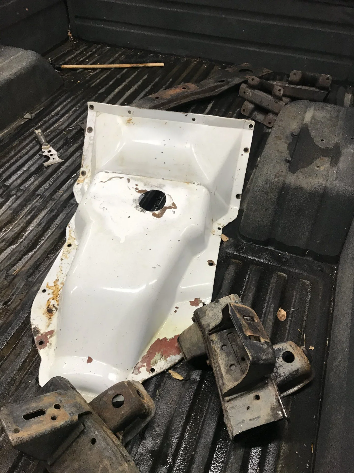

We have stock frame side engine mounts for 1HZ and 1FZ. Going to make one or the other work and utilize stock Toyota rubber mounts. Got an H55 trans cross member from a Troopy in hand along with frame side mounts. Bit of fab work and it will be just like a 60/62 trans cross member.

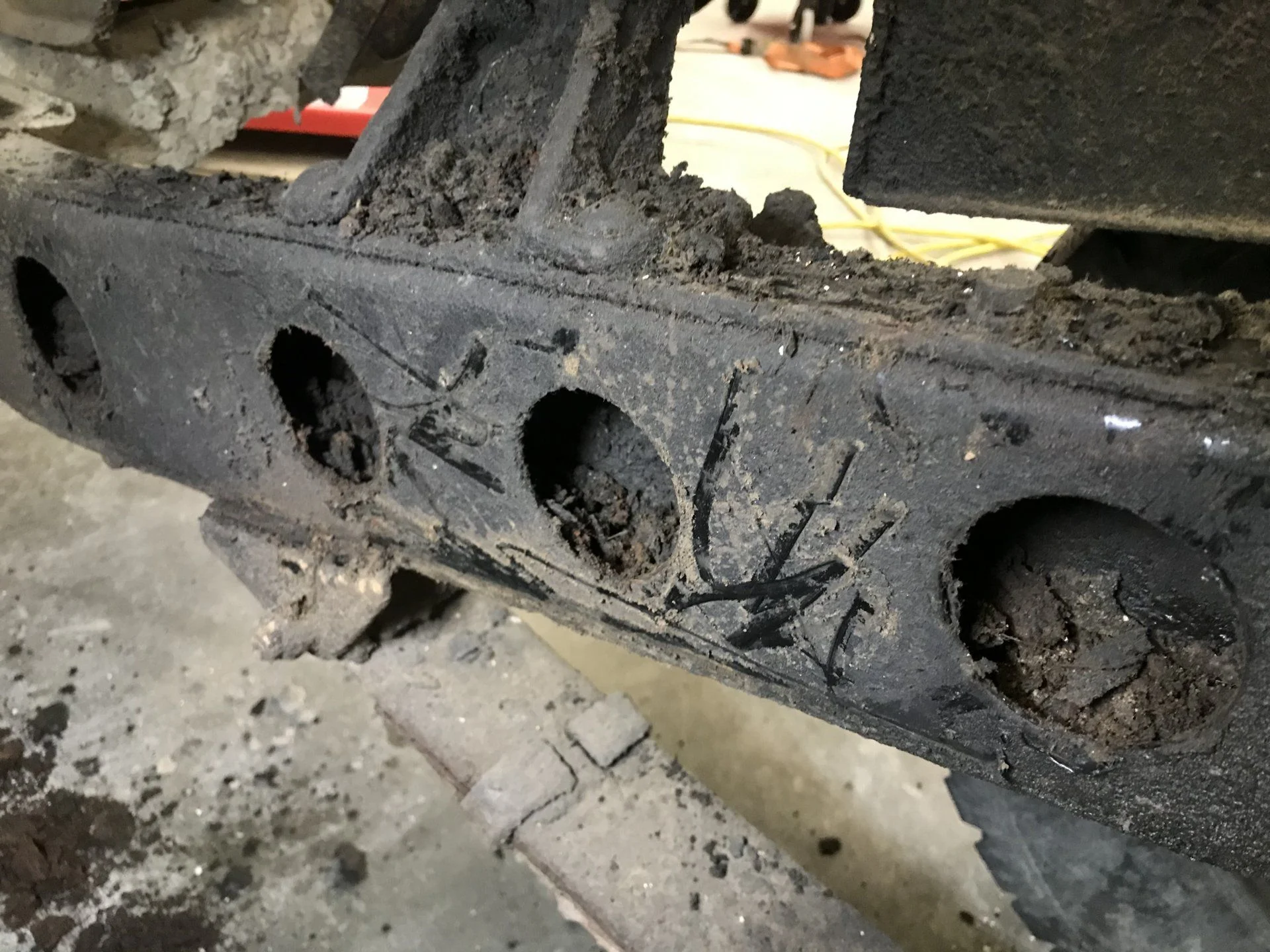

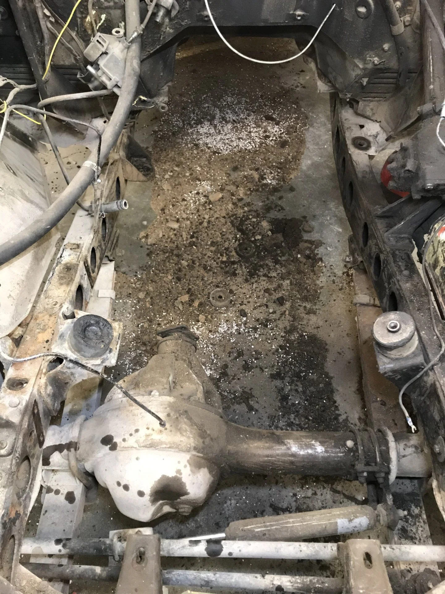

Frame rails full all the way back to the rear leaf hanger.
Got a good start on it, pressure wash tomorrow.
Cheers
Already pulled three out of here buried in funk.

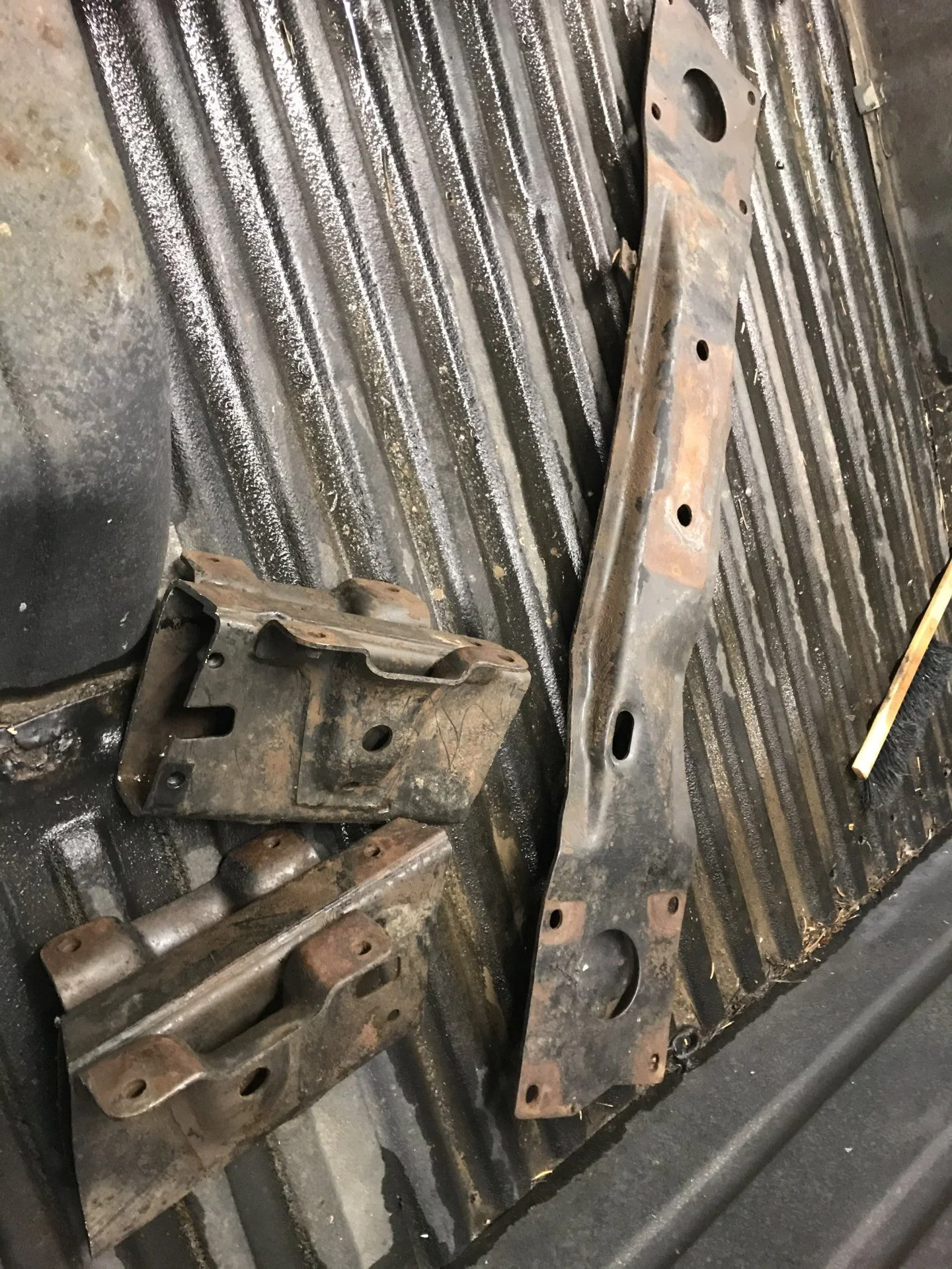

H55 trans cross member, frame side mounts and 1HZ engine mounts from a HZJ75 Troopy. Going to clean them up and cut off the frame rail pieces.

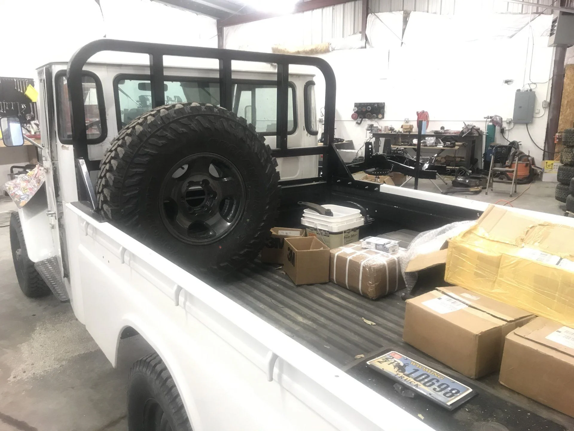

It was decided recently this is how the spare tire will go, only reason this might change would be if it got mounted to a rear bumper.
