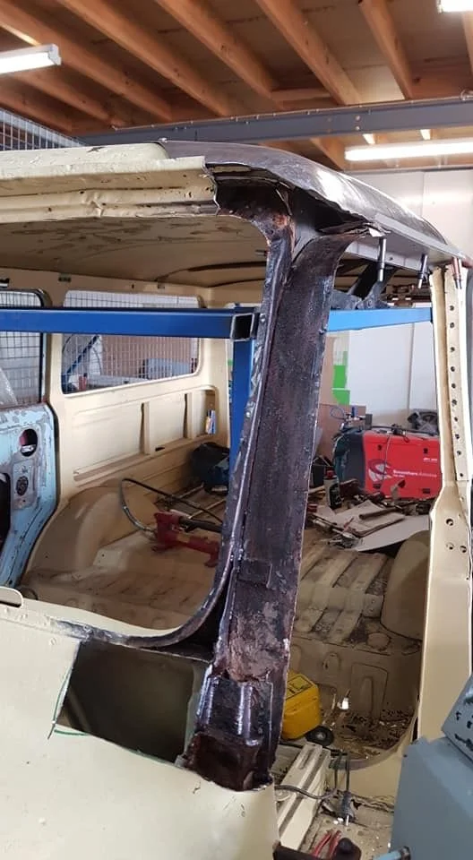

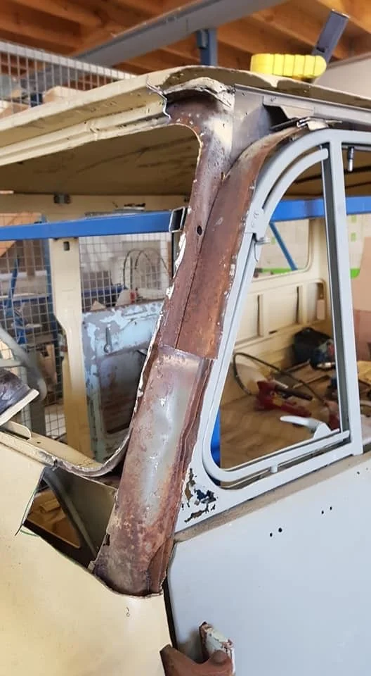

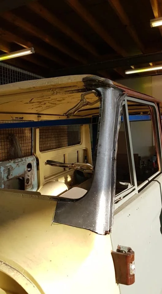

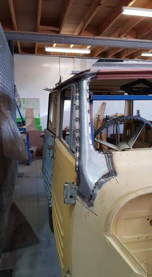

Time for the A Pillars. Another can of worms $. Some strengthening, rustproofing and repairing the left cover piece. (These pics were before the install of the new top of windshield frame) The right hand one will be completely re made with a new pipe for the interior light wiring into the roof
It's great to see this type of work on a wagon. Interesting seeing the different layers and how they are constructed.
thanks, yes have gone all-in on this one. Had to sell my HJ47 Troopy to keep the funds coming in. Rod is building it a bit stronger too. They really are nicely put together; would love to have seen it all in action, back when.

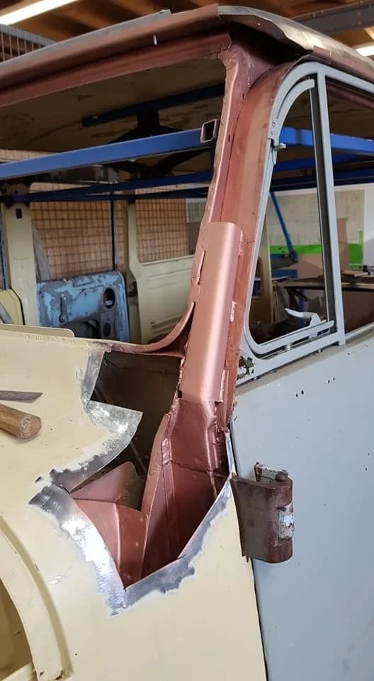

It was a scary look to see the right A pillar gone; very happy with how it came out:) Didnt expect to have to do this much work on the A pillars but it would have been a short cut and a compromise to leave them.

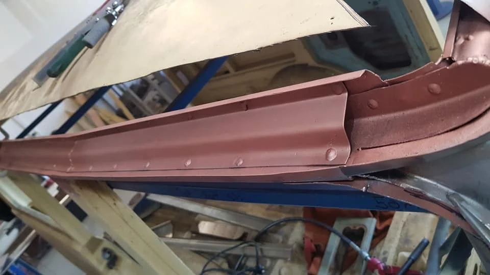

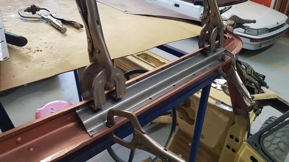

This is simply amazing work. Is it a lot of English wheel work on those contoured pieces or some sort of super-human press thingy?😆
I think its English wheel and different press(s) with various custom dies and by hand. He makes his own custom tools.
This guy is a true artist.

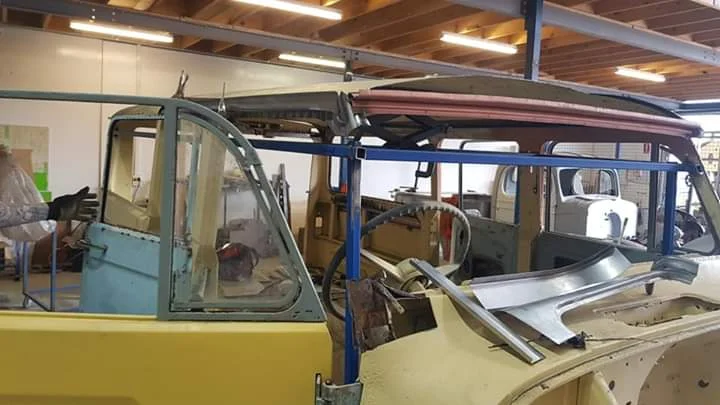

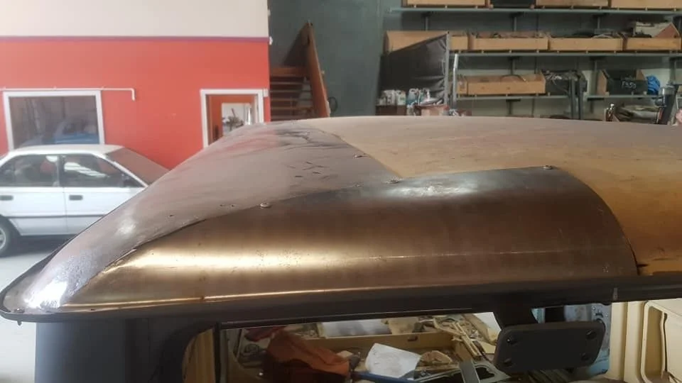

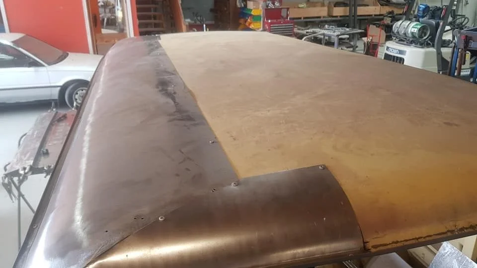

working down the right side now, also a complete new section above cargo side window. Cant wait to see the outer sections of the roof welded to the existing part. Think i will have my own Roof Party when its done; it's going to be a big milestone for this 45V.

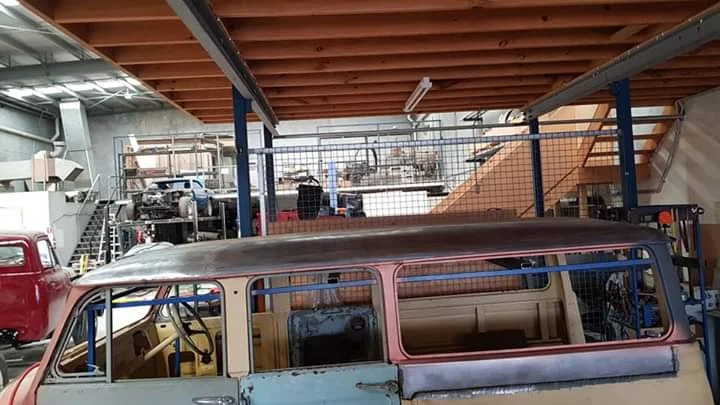

A few shots of the LHS roof skin coming together. First one after welding and shrinking. After the RHS is welded in he will complete any shrinkage required around the whole roof perimeter. Hope to have completed shots of the roof next week.
