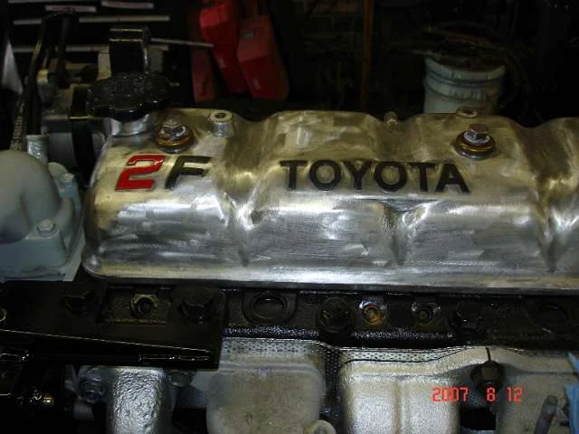

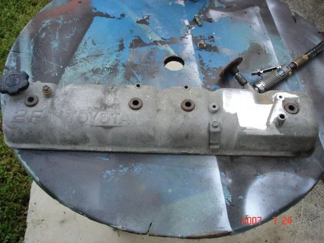

This is going back a page but I like to polish my valve cover and paint the letters using a Q-tip and then clear coating it. Check out the pics. The red is freeborn.
Mike
ok i will hold off on this for now, gladly. just for kicks i think i will winch the rear end down just to see it, then i will sleep at night, ha ha. shackles have been reversed as well. i have located all new JIS bolts which will have to be yellow zinc plated, but my guy will do more than i can thro at him for a $75.00 min. will post that later. thanks for all the help with my suspension stuff. mmcinnis thanks for the valve cover post as well. CCJ, i would not worry too much about me passing you, you are very good at this stuff as evidenced by your work. i am severely handicaped but muddle thru it. ;)

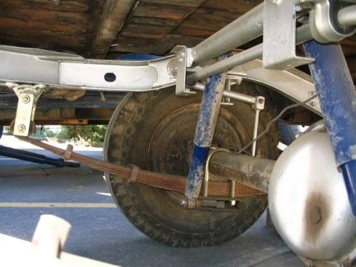

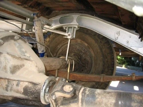

Here's some pictures of the rear suspension of my '67 LV. This is using the stock springs and stock length shackles. The only weight on the springs is the chassis c/w drivetrain (3B engine, H41 tranny and 3 speed transfer case) and the bare body (no doors, glass seats or anything else).
If you need more information just let me know.
