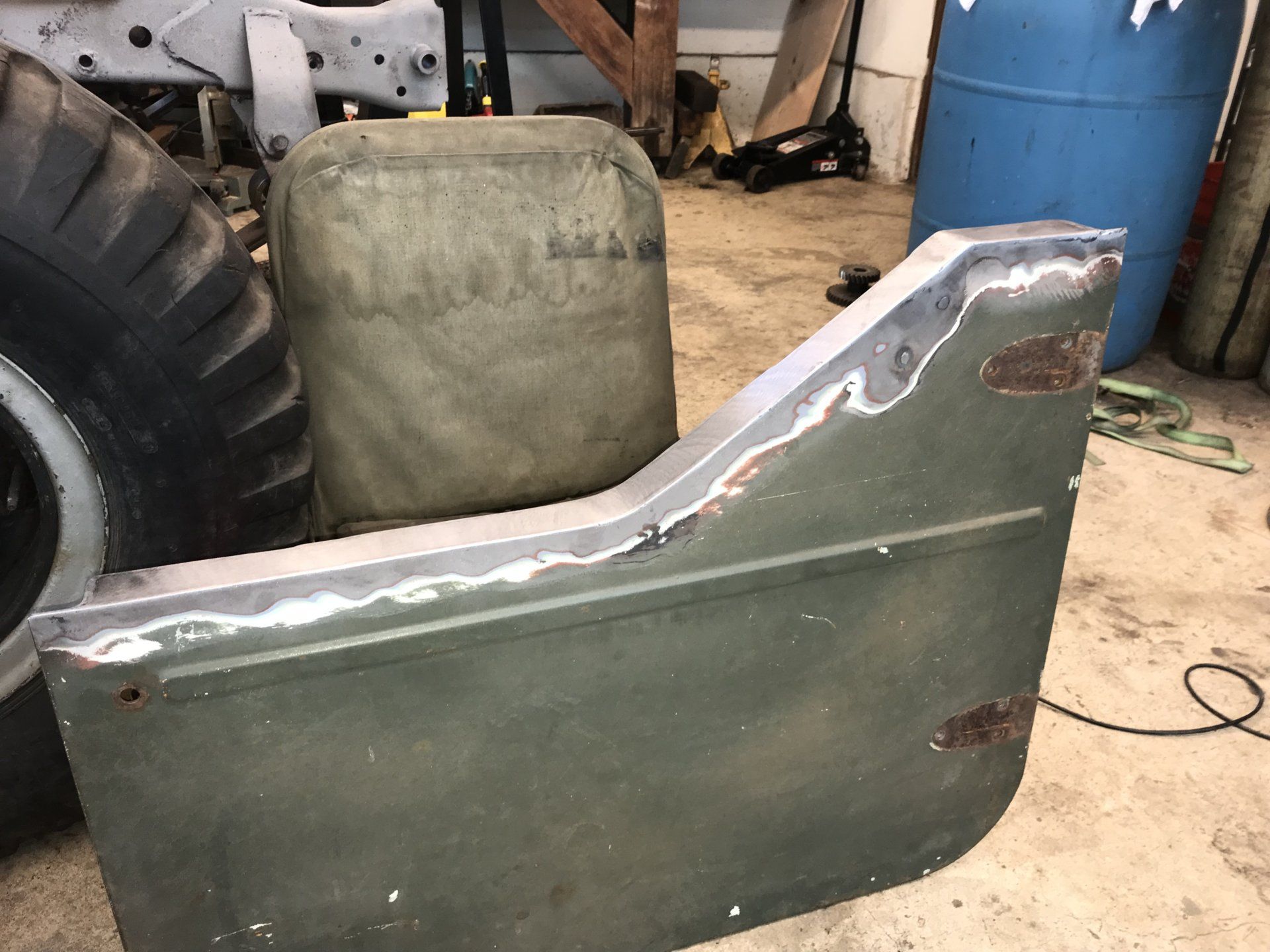

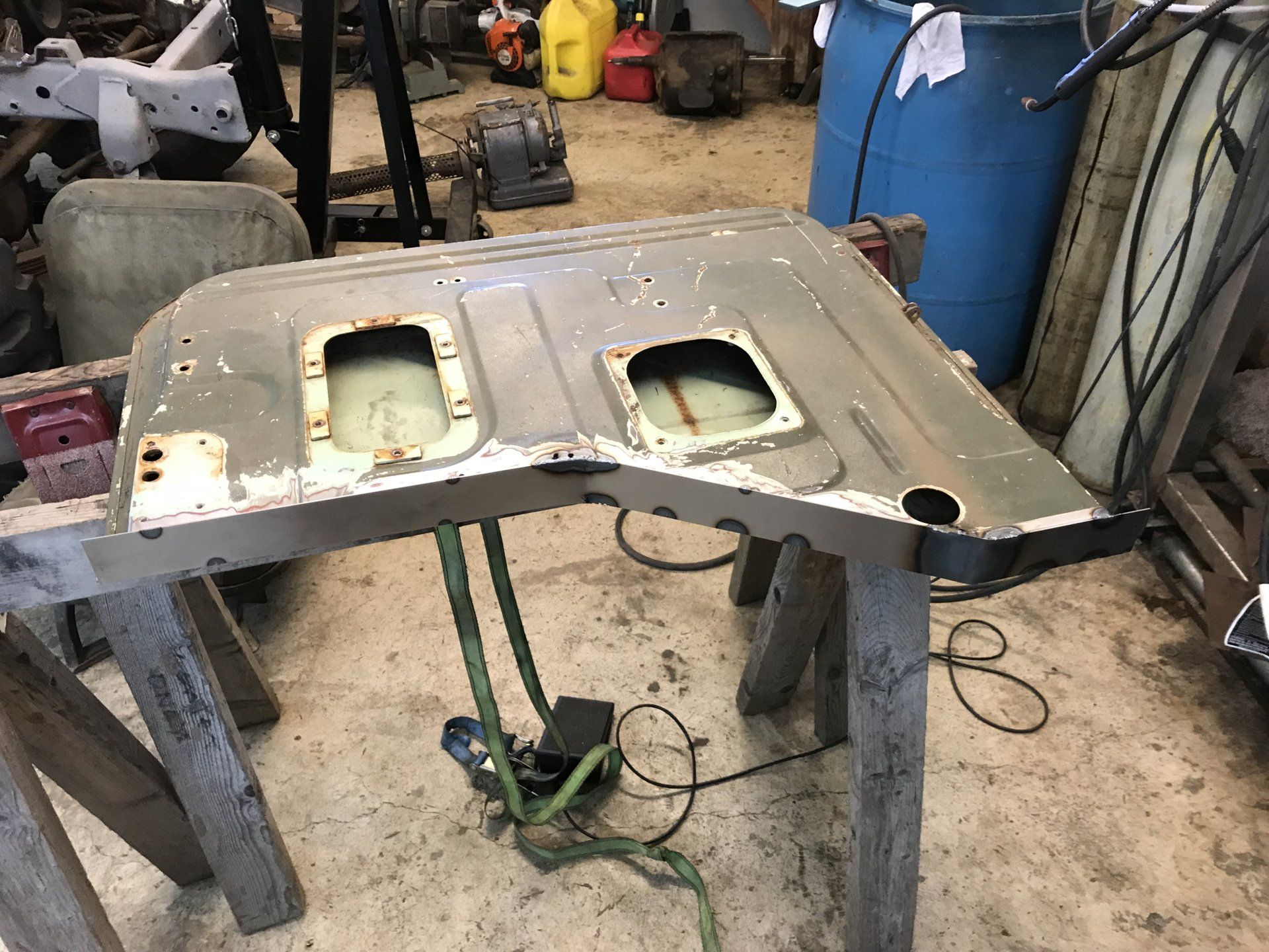

@Rock40 has been working on my OEM half doors that he is building for the restoration. I’ve attached his tutorial here for your view. He did a fantastic job on these.
His tutorial:
“OEM” FJ40 1/2 Door Tutorial

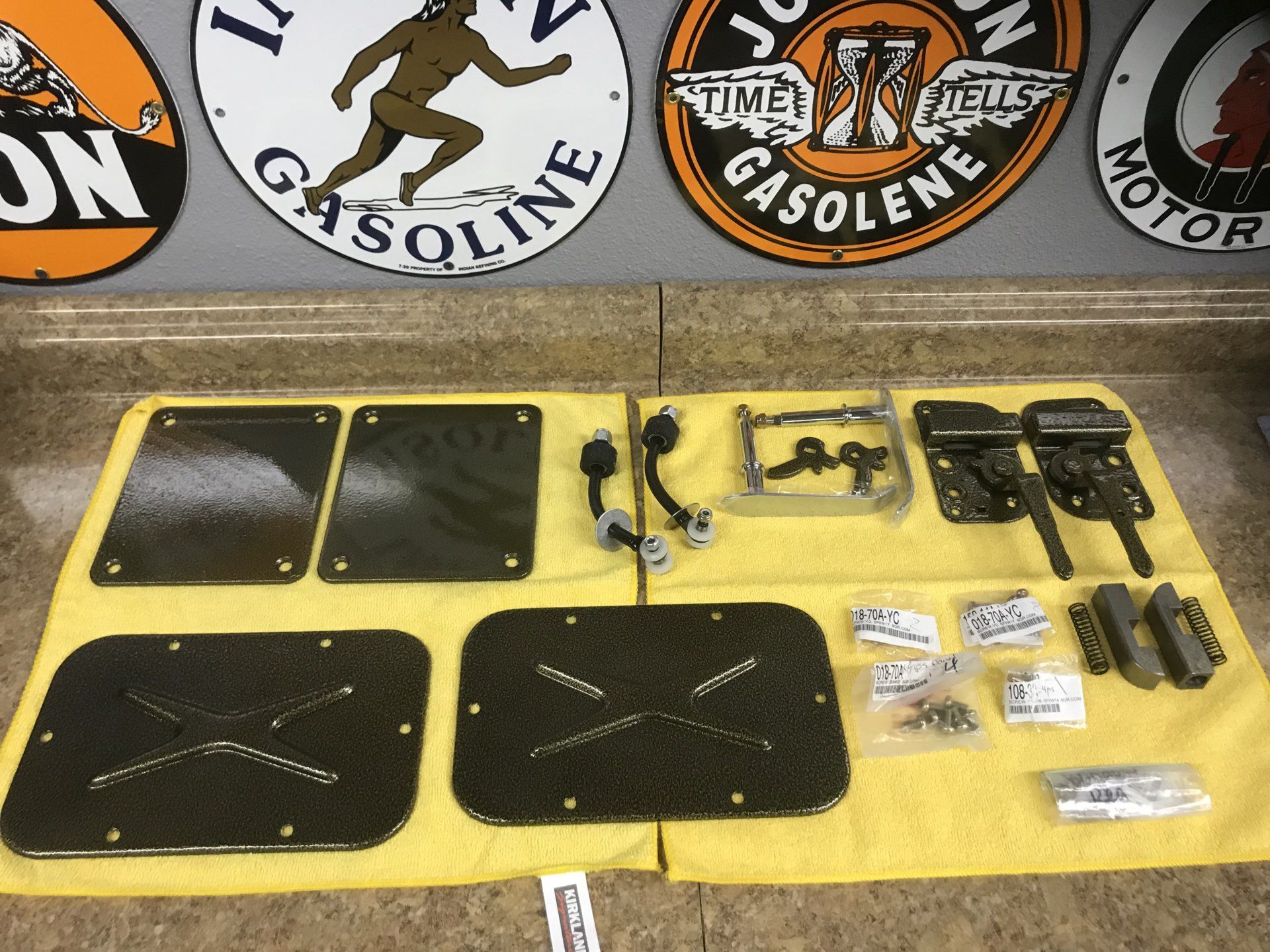

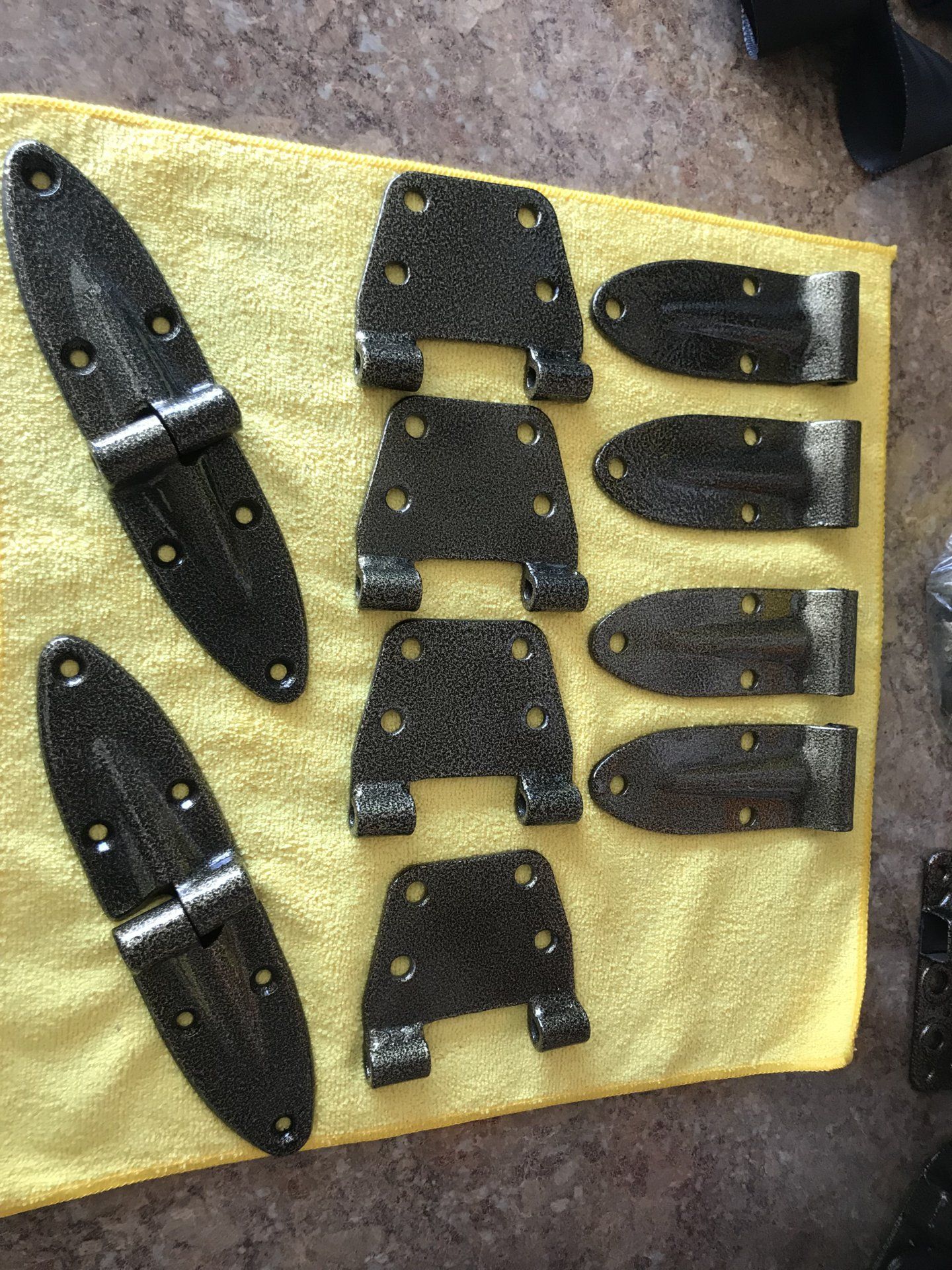

Back here in California, I had all the door hinges, hood hinges powder coated the matching “gold vein” before sending them to @SMG to get bushings and pins. To match the powder coat, I also did the door interior access panels, and regulator/latches. For the window regulator @Rock40 sent me the OEM old window crank plates and I had some made to fit over the holes. Rather than covering I thought these would work good to cover the large area. All bolts are SOR yellow zinc plated. Should look great.
