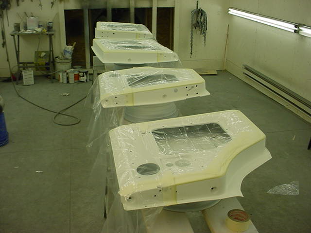

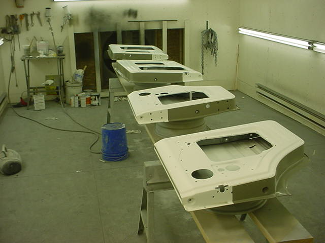

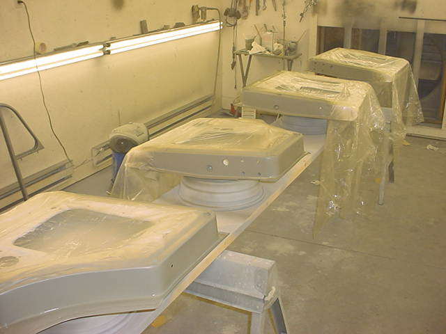

If you look at everything I have been painting you will notice how the base/clear fades onto the outside of all the openings. All the windows and door openings have been painted into the jams and fades onto the outside. In the autobody industry I believe the term is called, "jamming" at least that's what my autobody friend calls it.
The inside, all the doors, tailgate, etc.. will have the inside painted and then faded onto the outside. Now your probably asking, "why don't you just paint each part and then bolt it on?"
About 3 main reason's for this:
1. No matter how careful you are (and maybe some guys can get away with this) you stand a very good chance of barking it up when you re-assemble if the part was completely painted. Then at this point you would have to go back and buff out or possibly even re-paint and blend in a certain area.
2. This is a 2 tone paint job. Everything was marked on the doors and jams prior to removal with a string line.....but, there might be a minor, minor change on one of the doors and then your paint line's would not match up. Panting the exterior all at once ensures the the tape line transfers from each edge perfect and that all lines match up.
3. I don't care if the paint comes out of the same can or not. The exact same paint sprayed on 2 different days can look different. Humidity, temperature, pressure.....many factors can contribute to different drying times and how the color can look. I have personally seen this happen many times, it is almost impossible to get the same color out of the same can to look exactly the same if they have been sprayed at different times.
Essentially you build a complete running/driving vehicle and then backtape everything and shoot your exterior color all at once.
Matt

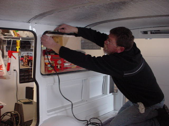

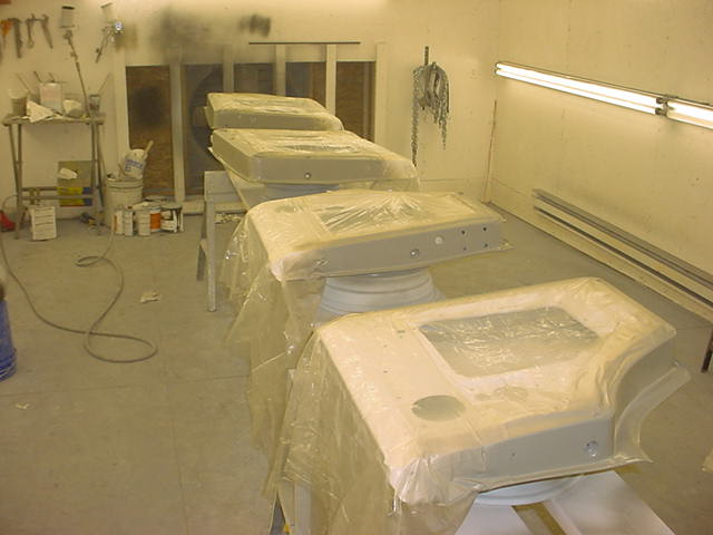

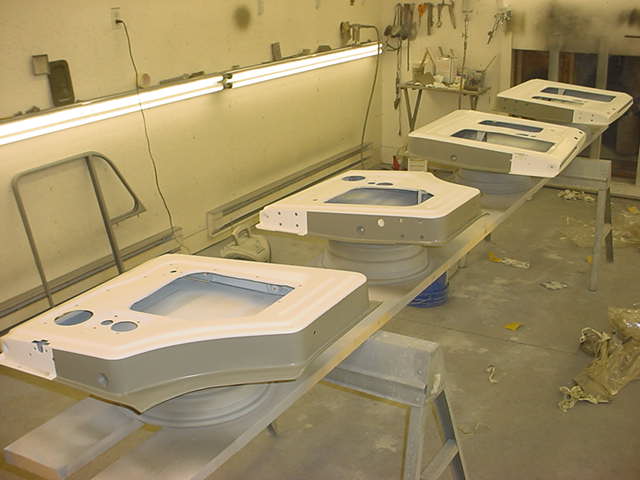

Well one of those days where things just didn't fall into place as planned.
Glass guy showed after lunch as promised but, unfortunetly not one piece of glass fit. The winshield he made was a tad to big so he had to bring it back to the shop to grind it down. The rear hatch window was to big, it was orginal and tempered glass so he will have to make a new one. The side glass was about a 1/4" smaller all the way around the flange opening, but both were way to loose for SOR's windshield gasket, so new ones of those will have to be made also. So, basiclly I get new glass all the way around (except for the doors.....so far). He measured SOR's gaskets I had and said the glass should be about an 1/8" to a 3/16" back from the flange. He made templates of all the openings and is going to cut glass a 1/8" shy, that way he can grind it back if he has to. He took the rear hatch frame with him, I had painted that last week. He called me later in the day to let me know that he had that cut and already in, said it looked pretty good.
When I got home this evening I figured I would try to get something done so I started jamming the doors. Funny how you think you have all the imperfections out and then you shoot some paint :rolleyes: So, I had to let base dry and the dry sand with 400 and re-shoot, took some time. I did manage to get the beige on, but still had to do a little sanding here and there. So what should have taken 2 hours took about 4 and I still didin't get clear on. I had overspray mist in some of my taped edges, so I decided to call it a night.
I've got to head to Dallas tomorrrow afternoon, figured I would let the base dry until I got back on Monday. Good and dry and I can wet sand out the beige overspray, not a big deal, but thought it best to call it a night the way it was going. If I wet sand out on Monday I should be able to shoot some clear next Tuesday.....probably round up the glass guy again next week and give that a try again
Anyway, pics.
Matt

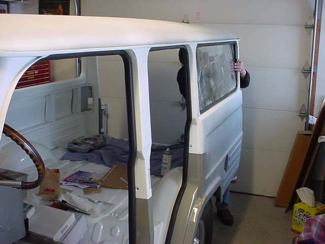

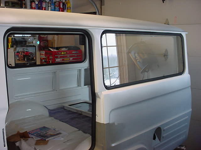

At work this morning, heading to the airport around noon for Dallas.

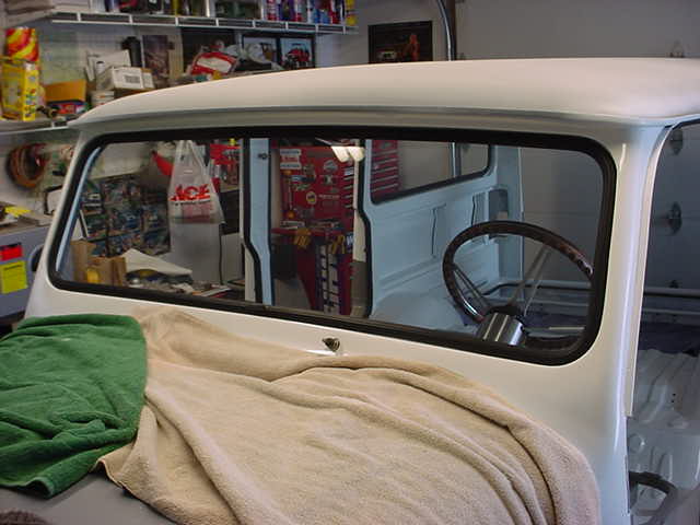

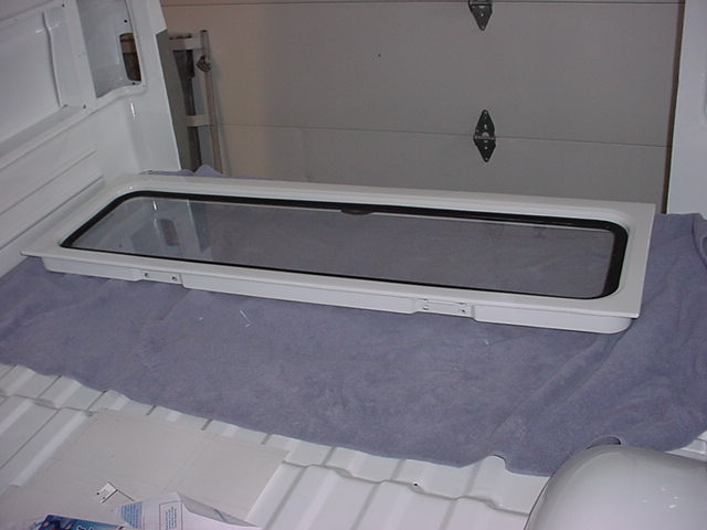

Glass guy shows up this morning and asks if I want to get that taken care of before I leave.......What do you think I said? ;)
Took him an hour and 15 minutes....Pics from about 10 minutes ago :)
Glass he cut fits perfect.
Matt
