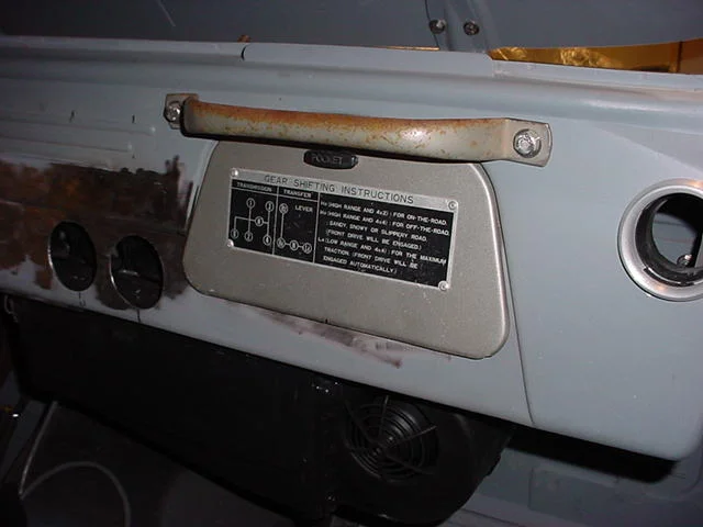

Started off the day by making threaded plates for the neutral saftey relay on the fire wall. Figured if I threaded a plate and welded it on, it would be easier to take on and off. Also made a a reinforcing plate for the middle AC mounts.
Made another decision on the AC area. I decide to pretty much gut the majority of it out. After welding up the ash tray area I realized how I couldn't see anything back there, let alone start pulling wires when that time comes. So, I really opened it up. This way I can at least get my hand back in there through the glove compartment door. Also drilled 4 - 1 1/4" holes in the bottom of the glove compartment for the rubber grommets. The AC lines and heater lines will come down through there and turn into the firewall area, still have to cut those holes in that plate I made.
Figured I would mount up the steering column, just to make sure that fit. Fit pretty decent, except the set screws on the lower U-joint would hit the radiator core support. Looks as though I am going to have to move it about an inch or so to the passenger side. It actually isn't centered right now, it was the core support out of the 79, they must mount different? No big deal.
Wife also wanted a working glove box door, even though it's totally useless. She didn't want 4 bolts holding it on. I couldn't use the original glove box door since it mounted down in the glove box and that couldn't happen anymore. So I used the door out of the 79. I had to weld a 1/2" strip plate to the edge of the dash inside the door area. Then welded 2 captive nuts underneath for it to bolt to. I actually cut the tab out of the 79 that holds the wire and welded that on, since the orginal didn't have that style.

Are you going to fabricate a new shift pattern badge that corresponds with your new trans/diff for the glovebox door as well?
attachment.php
attachment.php
I don't think I'm that good ;p
The one on there might have to do.
