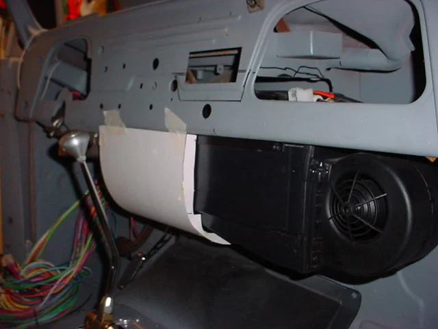

only thing I can think of, is perhaps making it flush to the blower box, and not the dash... might look a little tidier, although, it will be harder to fab ....

I don't think the dual brake pedal is going happen, maybe wider with the single arm that's there, but I won't be adding the clutch pedal back in. I think when I get up tomorrow, plan is to start making that box, probably take several hours. Then I think I'm going to hack into the dash and re-arrange a few body lines, I've been kinda dreading doing that :rolleyes: Just for the fact it's going to be hard and time consuming.

Pretty good day on the lv today, about 9 hours :)
Started off by making that center section, no real problems there. Made the center piece first and then the sides and tacked it together while it was in place. After it was tacked I pulled it out and welded the insided corners sold and then ground down the outside corners so it had a little rounded edge to it.
Started on the dash, kinda a pain in the ass. I wanted to make sure I carried that dash line across so it looked uniform. I think with a couple coats of primer and then sanded out it's going to look real nice. Pretty much got all the dash knobs and vents drilled in, except for the cigerette lighter, should get that done tomorrow.
Took a break from the dash and mounted the mirrors and the antenna, just wanted a change of pace. You can see my template in one of the last pics, thanks pimp :cheers:
Plan is to hit it hard tomorrow, going to grind away underneath the dash a bit, get the AC unit fitting up nice and ready to go. Might start welding some of the extra firewall holes shut tomorrow also.......plenty to do..... ;p

are you going to weld that center cover thing to the dash? it might be a better idea bolt it, cause it would be a PITA to get all the dash knobs in with that there
Already bolted and yes it does come off. I do need to get behind there, lots of stuff ;)
