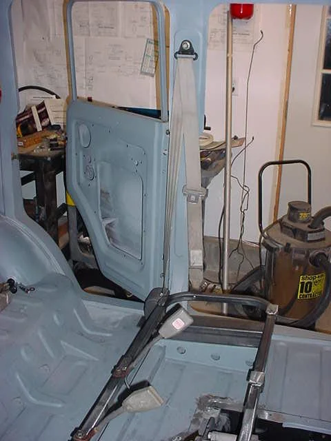

I then went to work on the seat belts. Doesn't look like much, but it took a while. The pics pretty much explain it all. I decided to thread the front seat belt attachment point into the side of the seat frame, that seemed to work well and Poser thought of that one when he was up here.....good idea dude. ;) I made plates for the rewind mech. 1/8" x 1 1/2" x 6" and then welded a 7/16 nut onto the plate. I drilled holes through the floor and spot welded it into place. Essentially sits directly on a rib underneath, the same width as the rib. When the body comes back off, all that will be seamed sealed around it, primed and painted. In the event of an accident, the rewind mech would have to pull that plate through the floor...I don't see that happening. I made L brackets to hold the rewind mech. I welded a nut on the back side and had to drill a hole for the alignment pin. I then had to cut a hole in that triangle piece to relief it for the nut and alignment pin on the back side of the L bracket. Drilled a hole in the bottom of the L bracket and good to go......I guess I don't see it pulling out anywhere???
The L bracket will be painted in contiental beige. You actually won't see it since the carpet is going to go over the top of it also.

I noticed that crack in the picture of your cat. Thought about posting to ask if you were going to beef up that upper seat bracket since they always crack there (weak point of those era seats). Guess I should have posted. Seatbelts look great, as always top notch work.
Yea, I saw the crack weeks ago and had plans on fixing it. Sandblasted it, primed it and never saw it until paint? I'm loosing it, I know that now........:confused:
