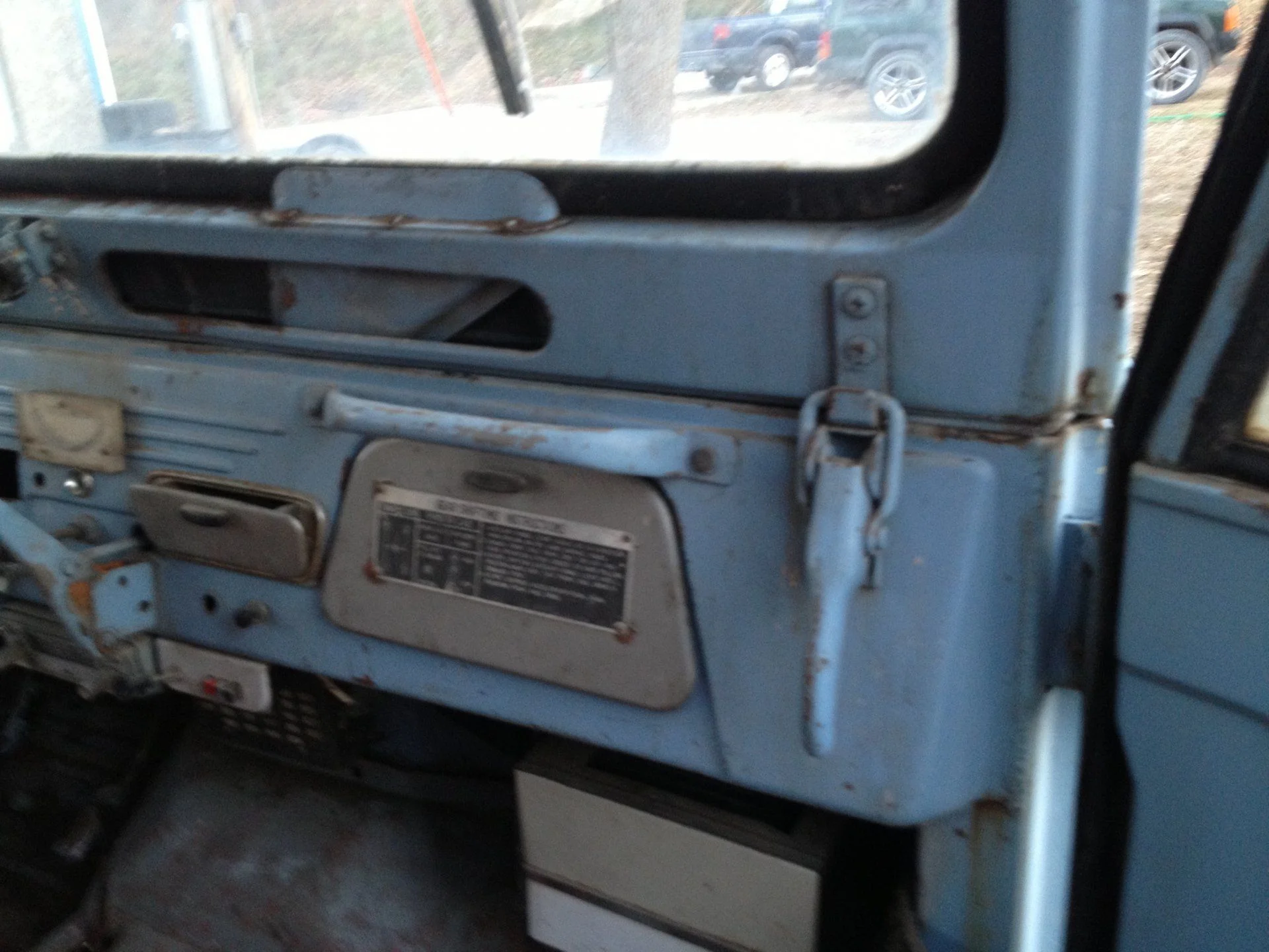

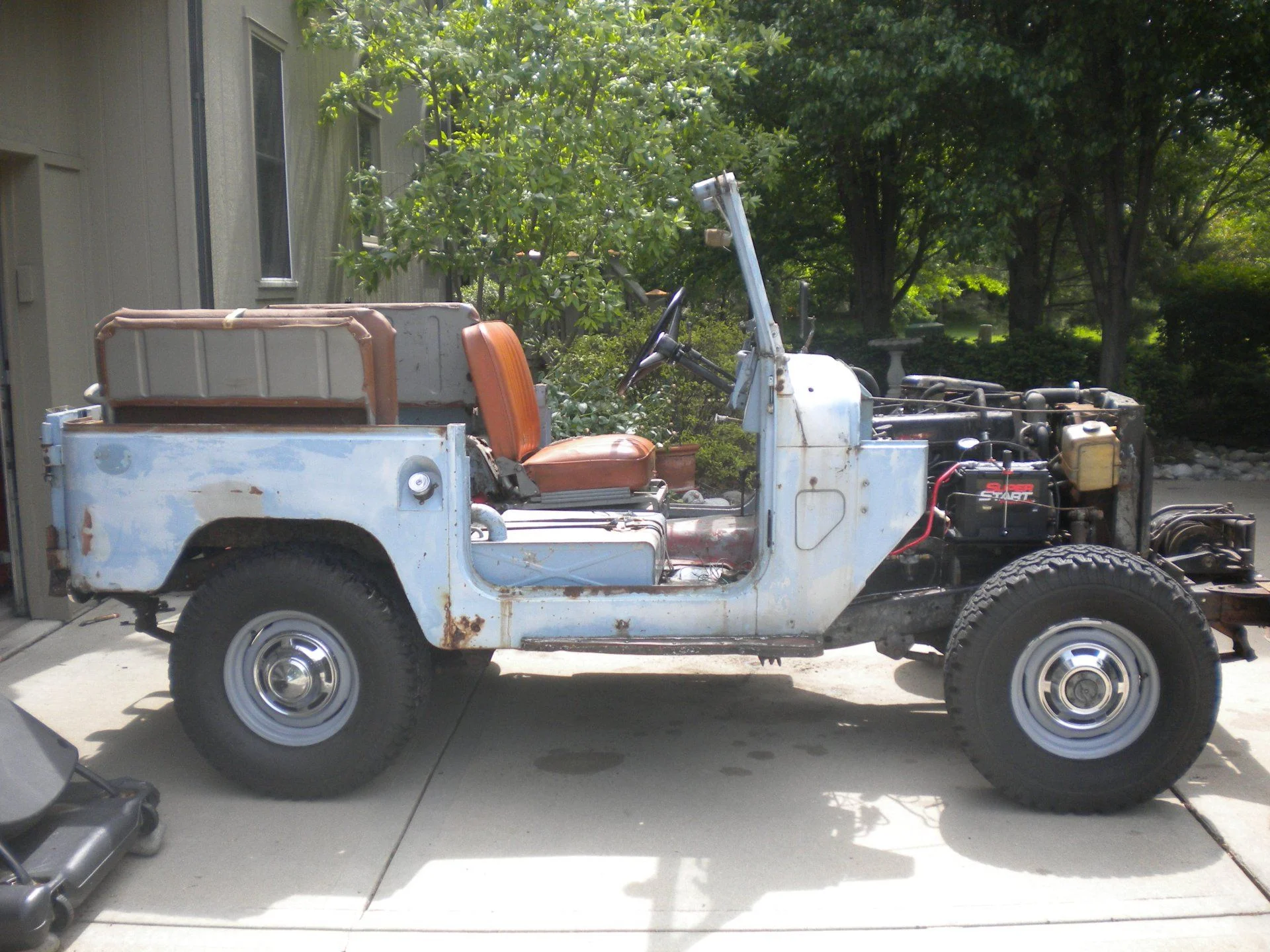

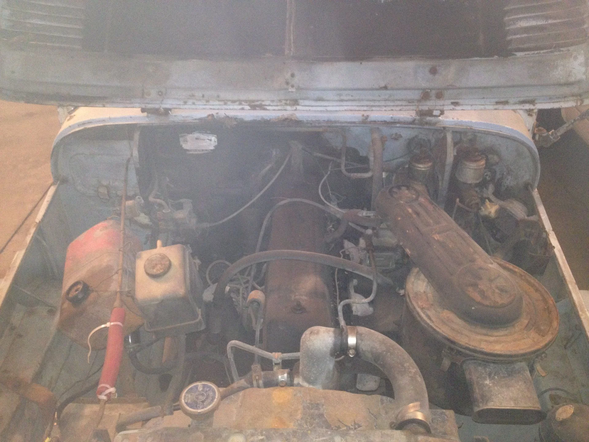

Here are pictures of mine. It's pretty clearly a '65 from the VIN. You can't see the brass tag under the grease and grime that's stamped 66 for the year it was titled. Note the lack of a hole in the side of the cowl and in the firewall. It also had an aftermarket heater when I got it.
65 the heater was a option in the US market. I've had two 65, both 45s (LV&LP-B) neither had the heater. Not sure of the VIN on the LV as I sold it over ten years ago but my LP-B is a early 65. Biggest give away I can think if is it has the longer running boards which was a 65 model change as well as LP-B started with 65 model. 65 was the only year with the diagonal fresh air inlet on the side of the cowl. My guess is Toyota figure this way LHD and RHD could use the same one. Just needed to spot weld the blank off on opposite side for LHD and RHD models.

Wow MAC very cool. I don't know that I've seen a '65 without a factory heater very interesting find. I did go dig out my '64 and '65 parts books and sure enough they both list the heater as optional. But you are certainly the exception to the rule. I've owned 5 '65s all with the heater. Do you know much of the history on your 40 I wonder if it was sold originally in a warm market? Nice build thread BTW.

I knew John would be the man with the answer! I learn something new all the time about early 40s, very cool :beer: And John if you are serious about thinning the heard shoot me a PM I am always interested in rust free early AZ Cruisers :grinpimp: Plus I could use a good road trip!
Wow. I have learned a lot in this thread. I always thought 66 was the first year for the heater. Most of the 65 pictures I've seen don't have the vent in the side for the heater. I don't know where my FJ was originally sold, but before it came to Kansas a few years ago, it lived in Colorado.
