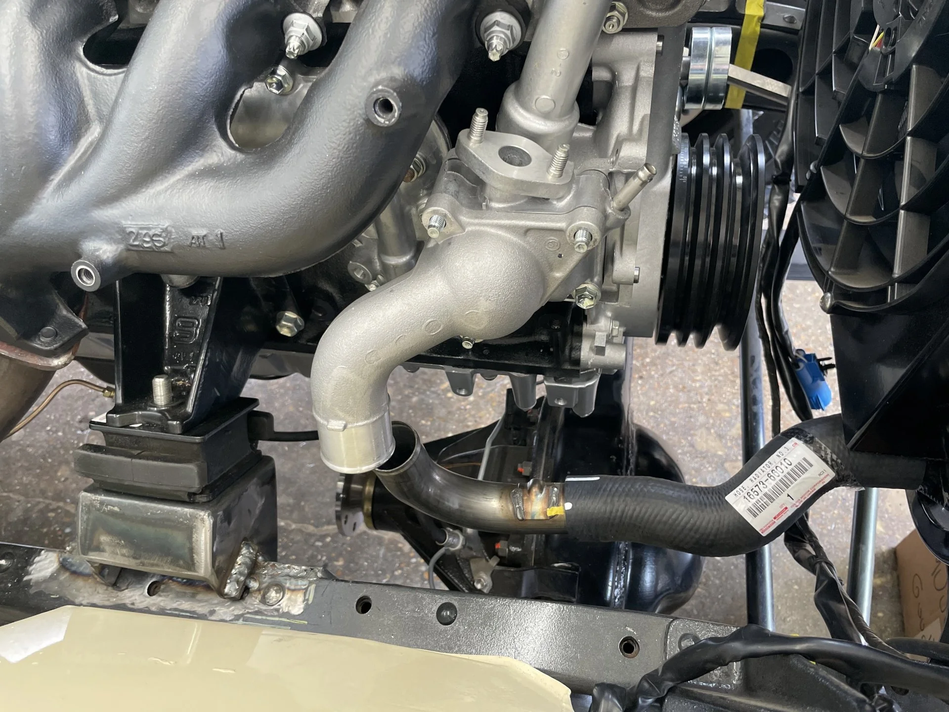

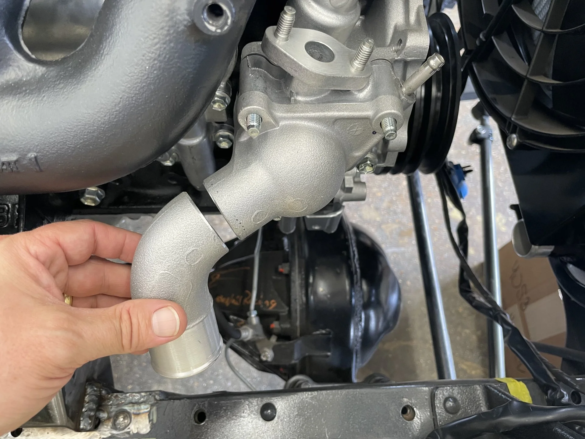

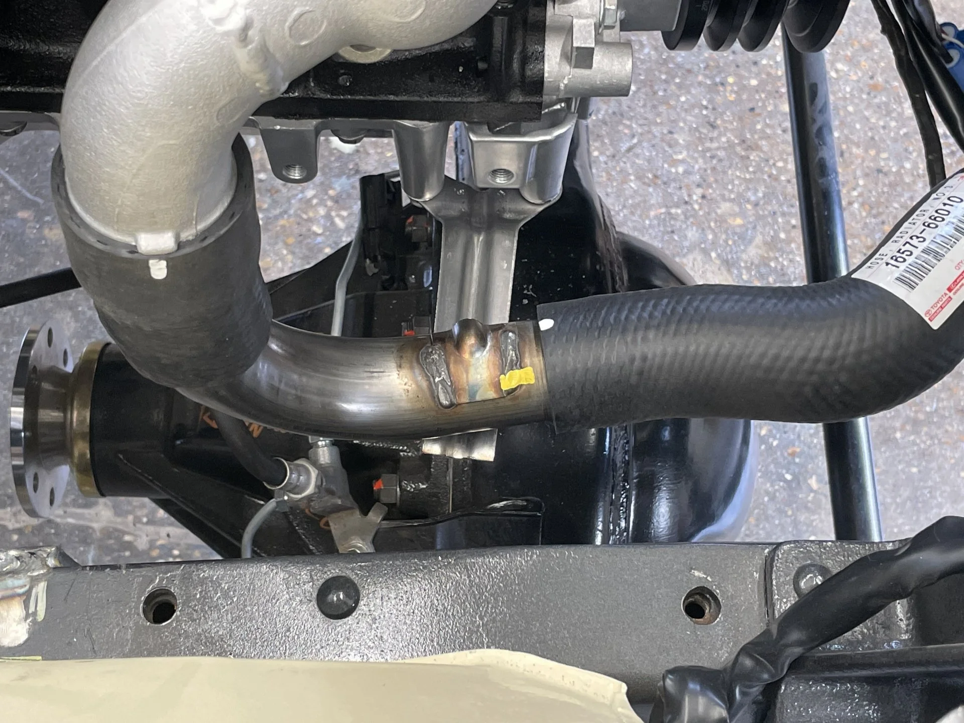

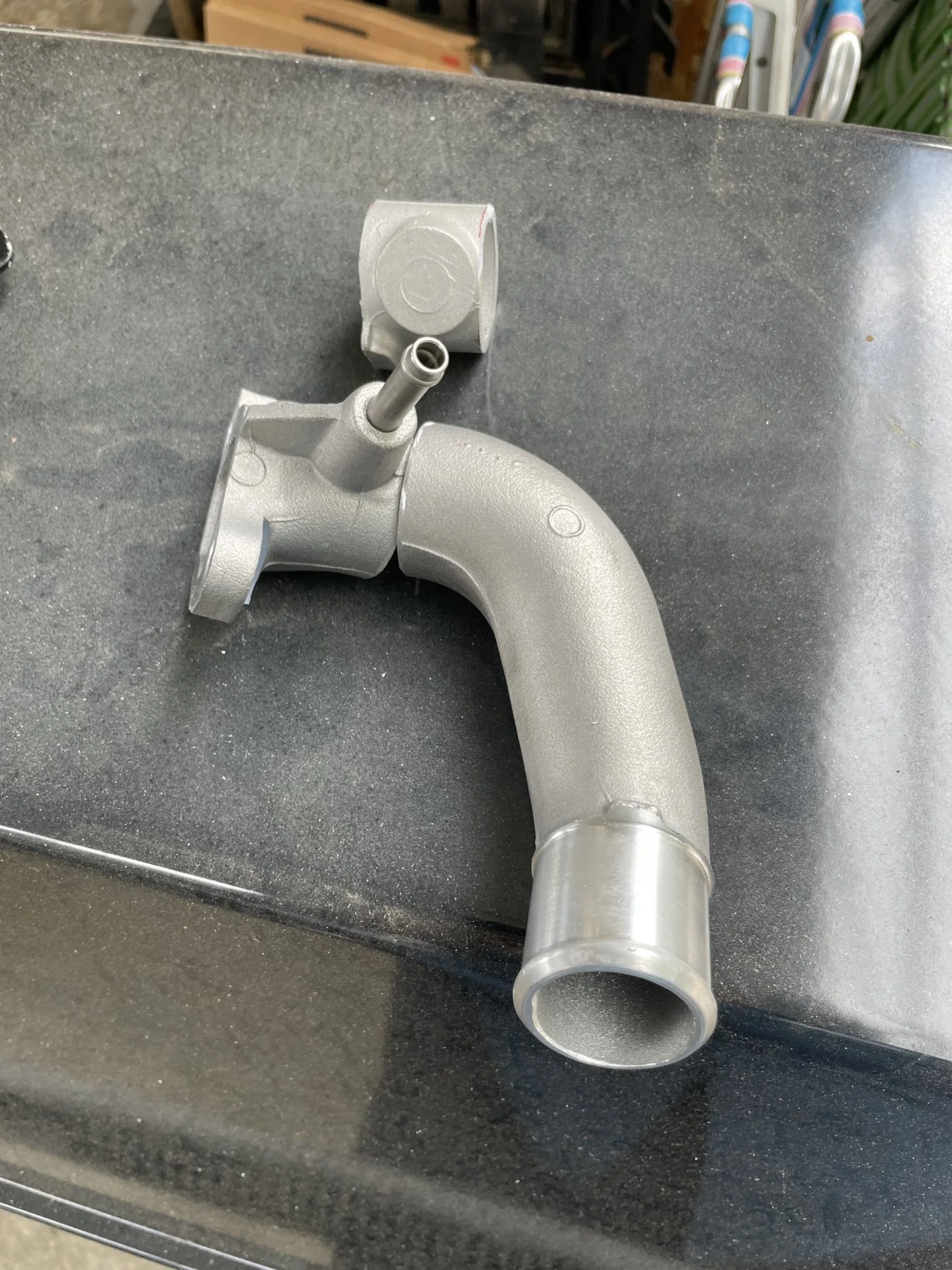

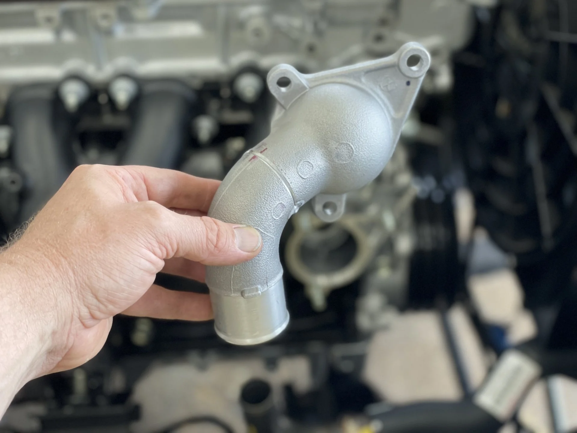

The aluminum outlet looked like that inch could be cut out of it and glued back together:
My five minutes had rapidly turning into ten which turned into thirty without even realizing it, when I thought I could cut it out real quick just see what it would look like
Oblivious to the time, I figured that looks like it will work, might as well tack it together. So I dust out the welder.
Tacks turn to full-on hot glue gun:
Went from this:
To this:

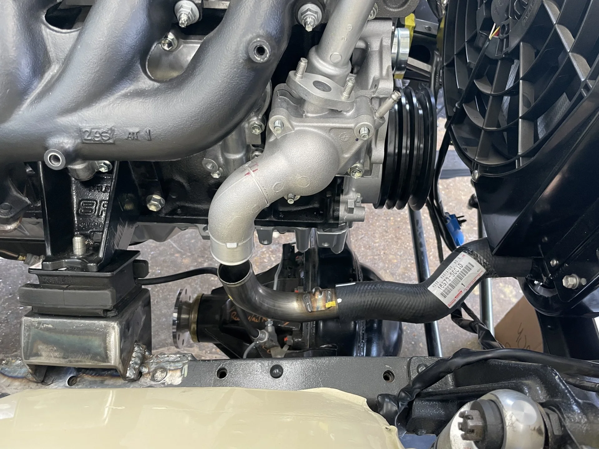

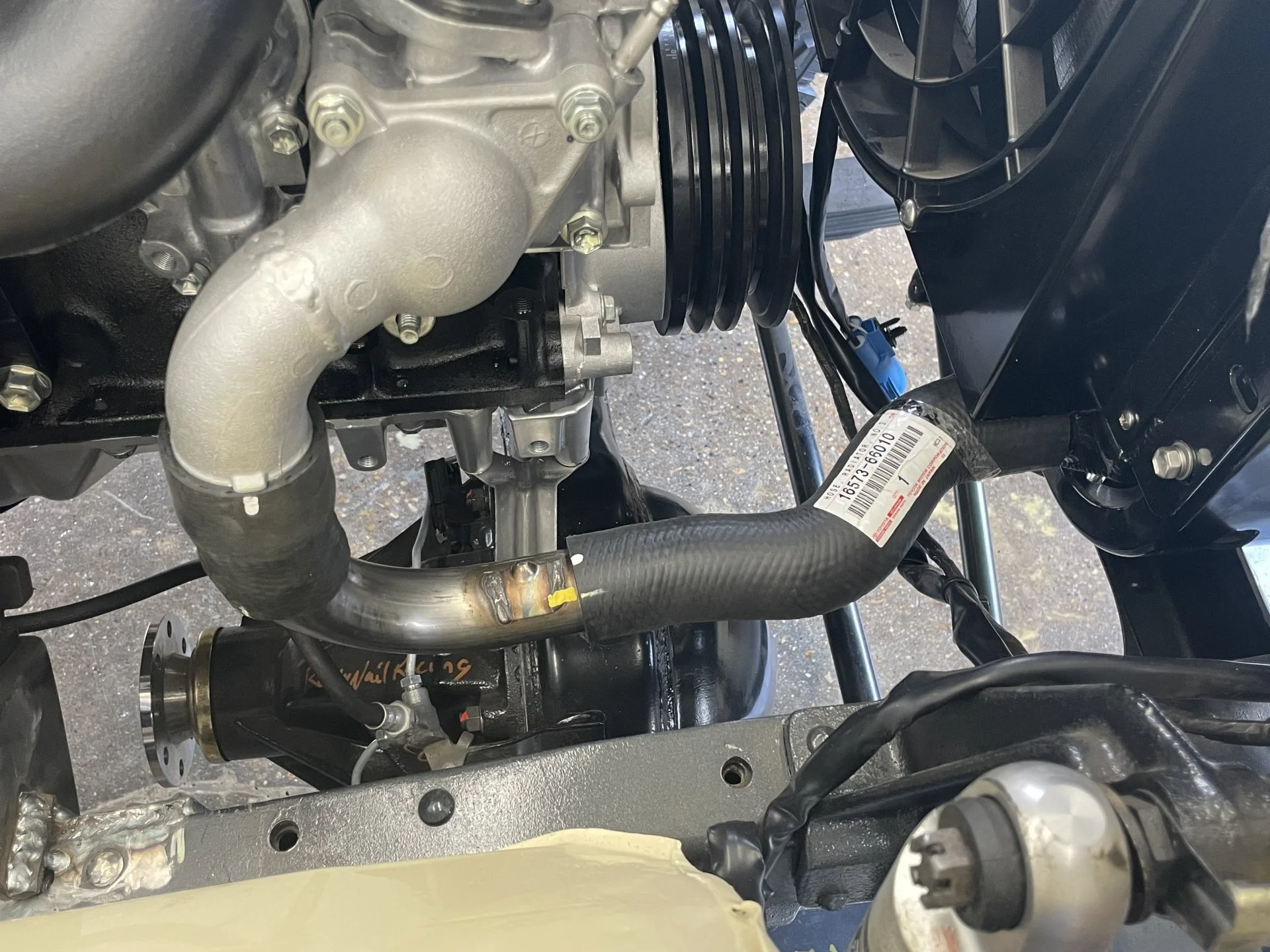

It’s going to work perfect. Now it’s a straight drop. We’ll even be able to use the factory hose, we just need to cut it and add a 3” vertical radiator hose coupler to make up the extra height in the 40.

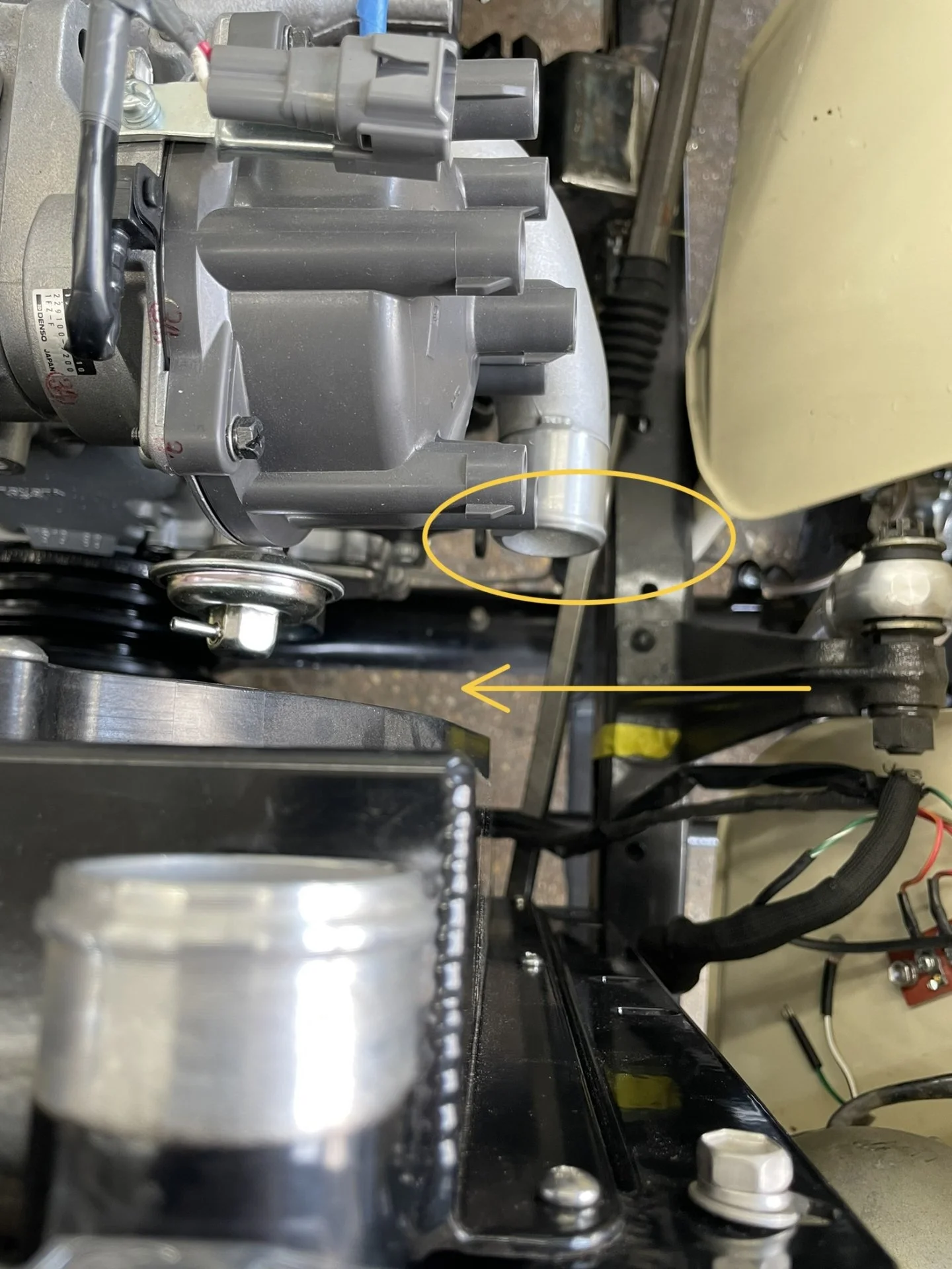

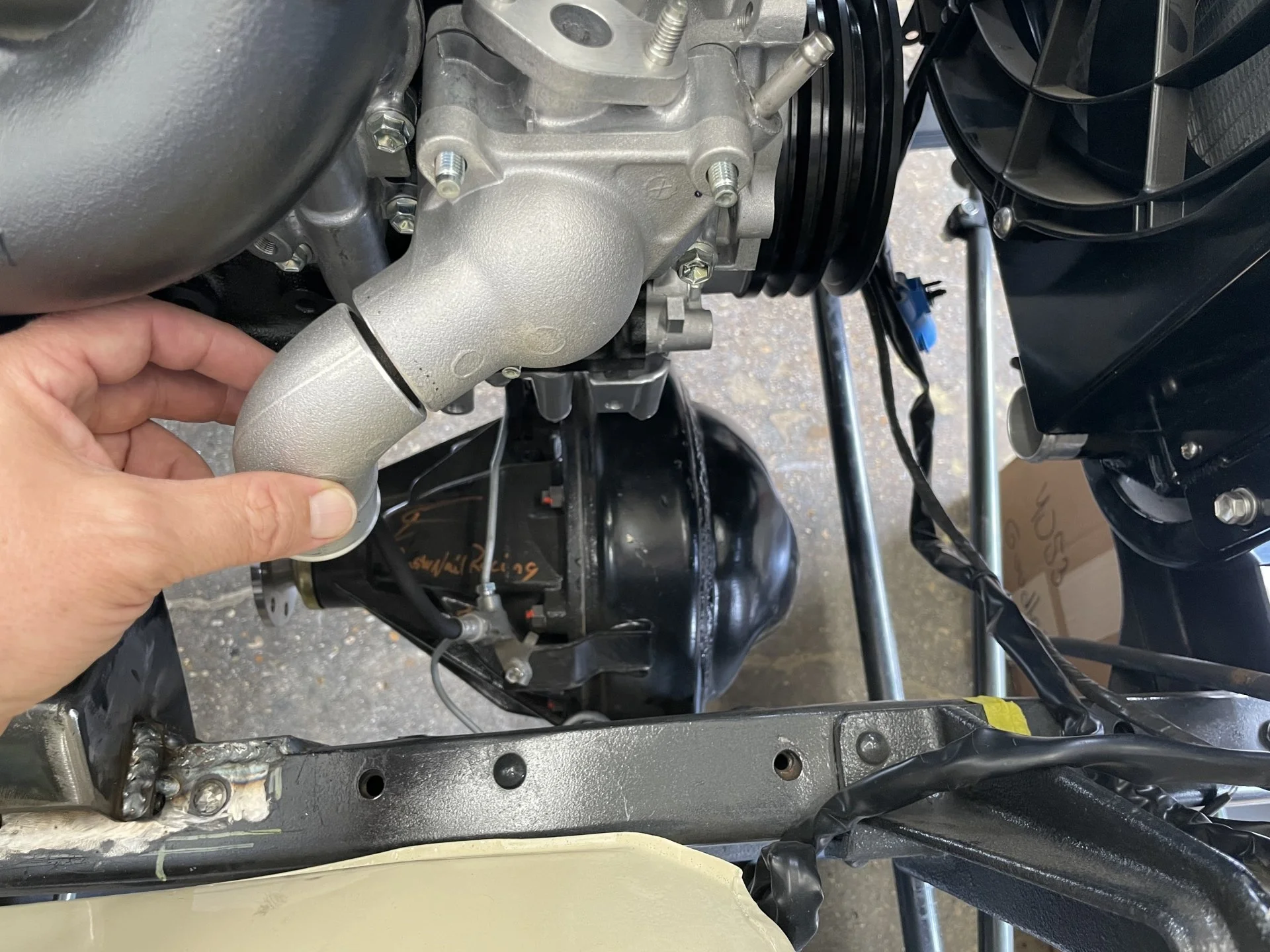

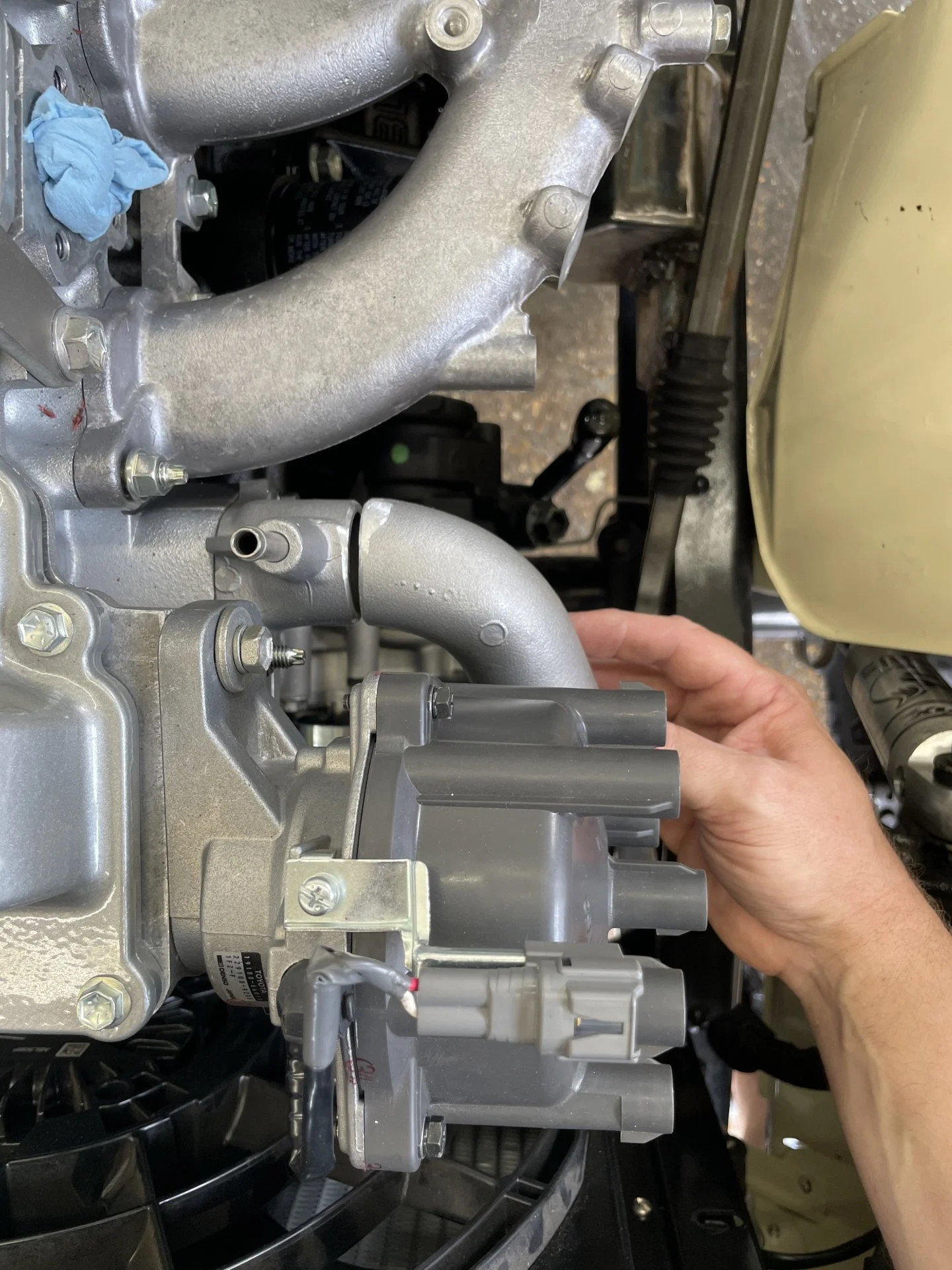

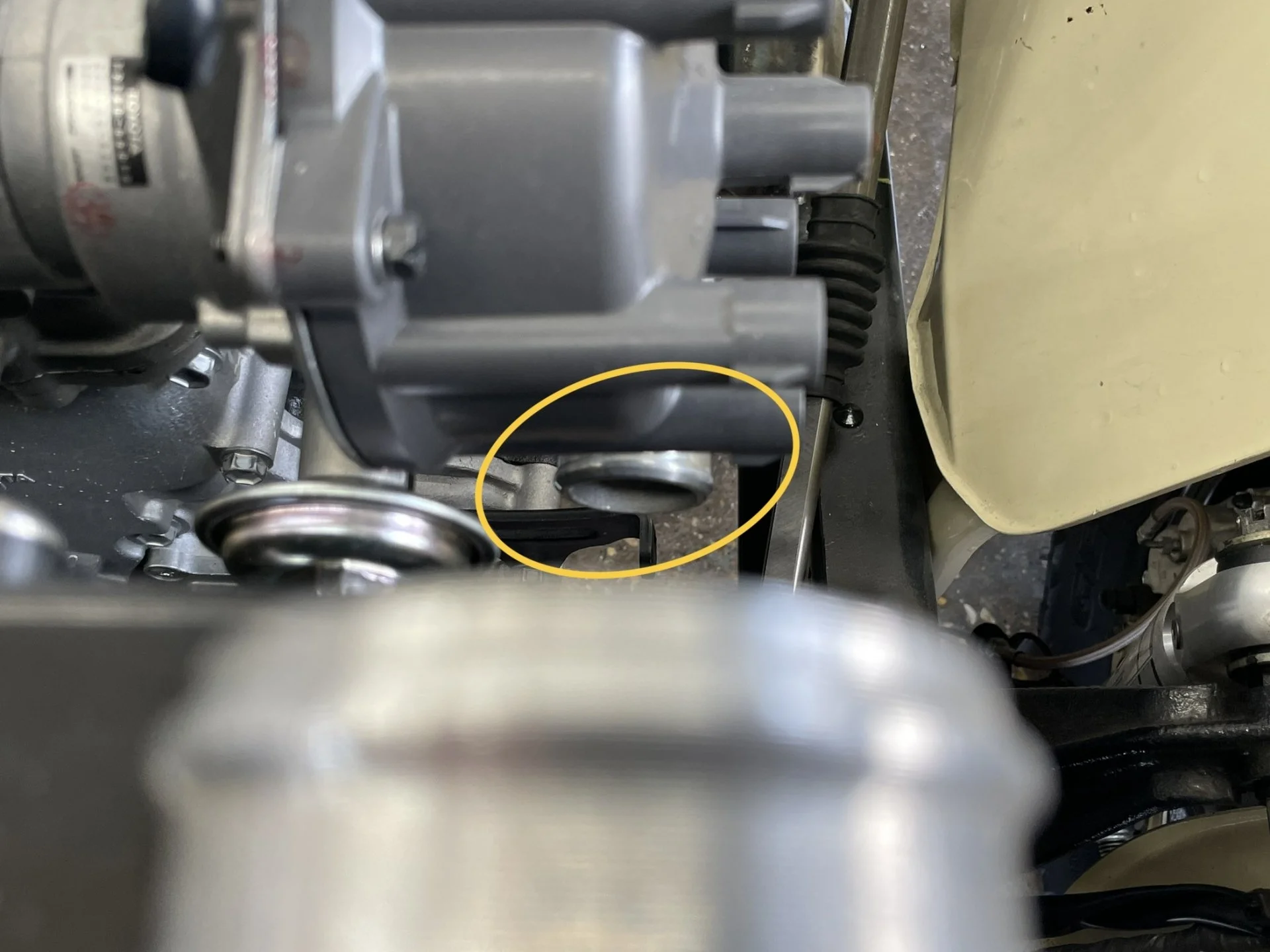

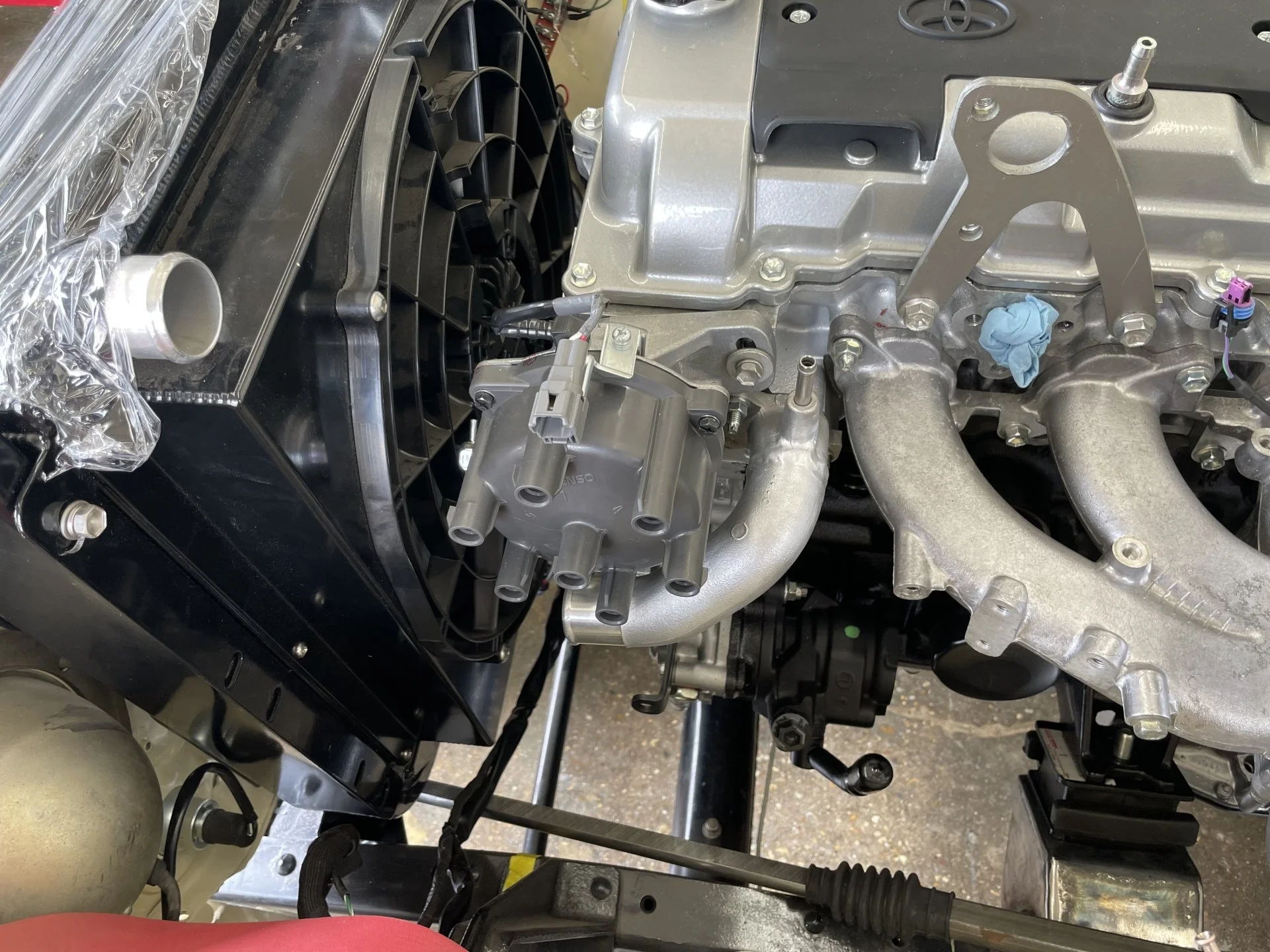

There was a similar problem on the other side, but when you held up all the parts, it looked like there was hope.
The water outlet was pointed in the wrong direction, but looked like that could be fixed with a cut and turn. We could even bolt in the steel 90 section if we cut off the factory bracket and re-welded it.
Five minutes had turned into most of the day, but this was going to work nicely.
The bracket looked like it would work too with a little trimming and bending.
All together, using all factory 80 hoses and parts:

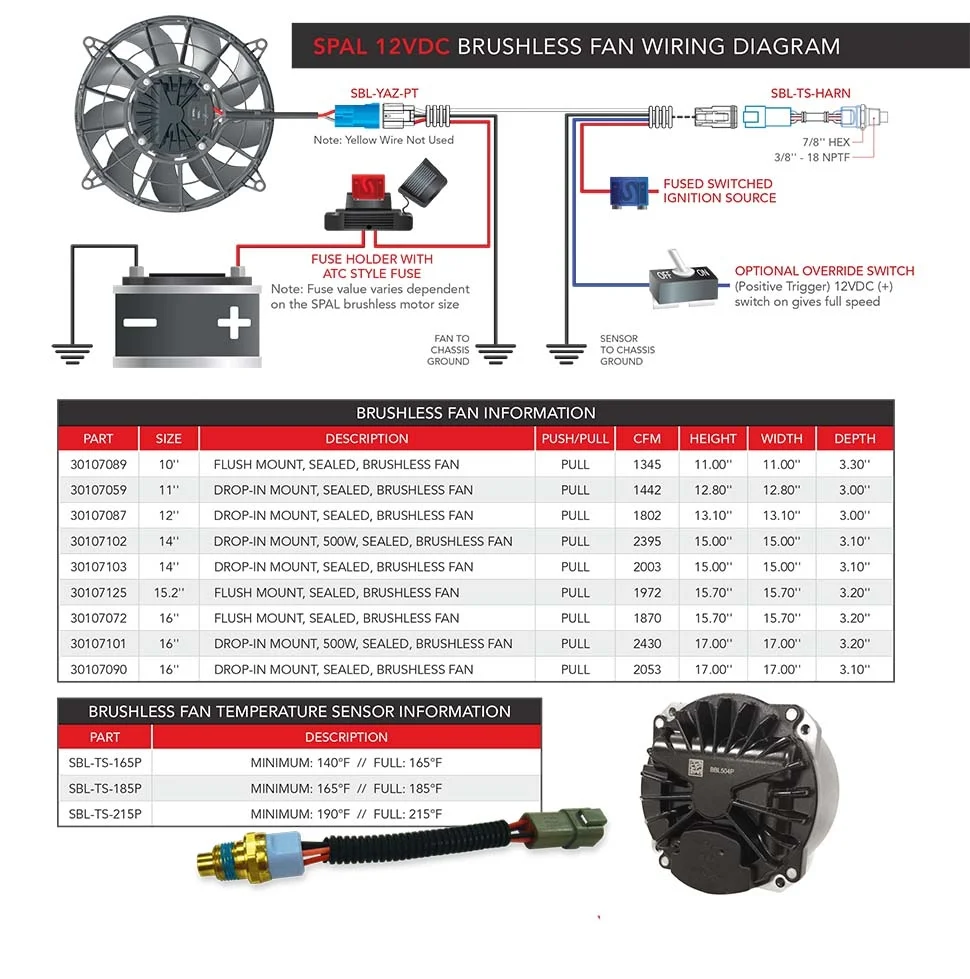

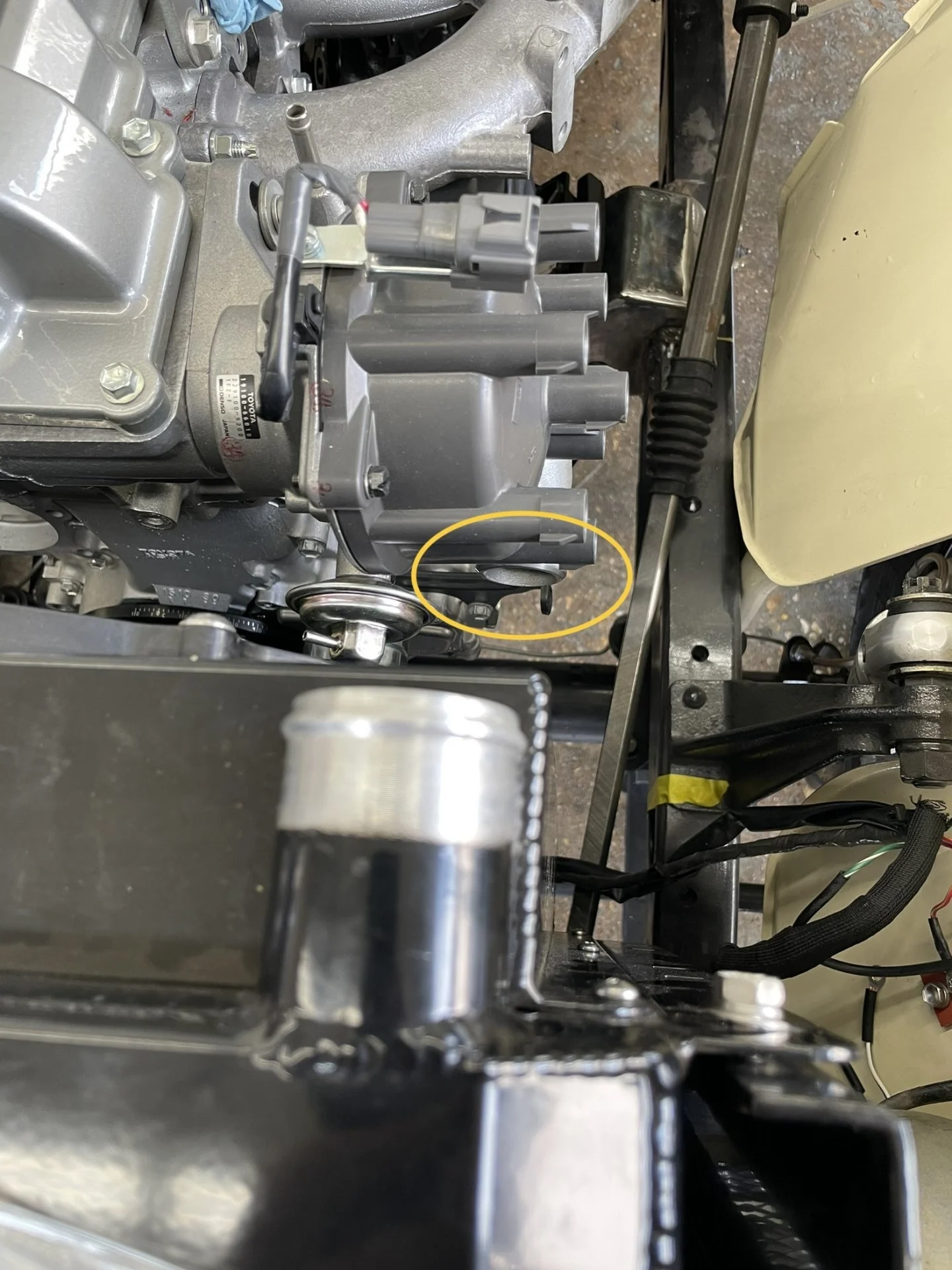

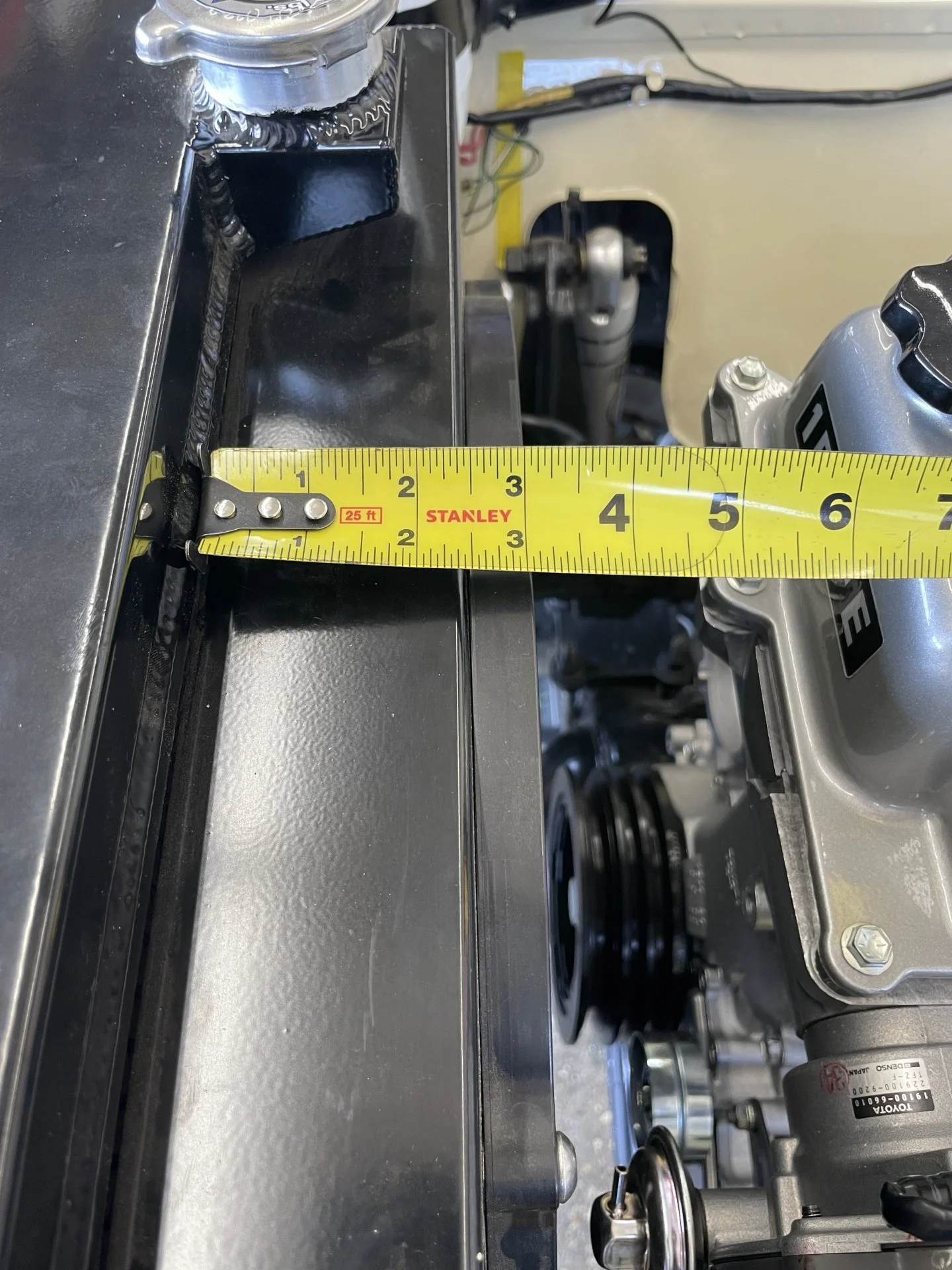

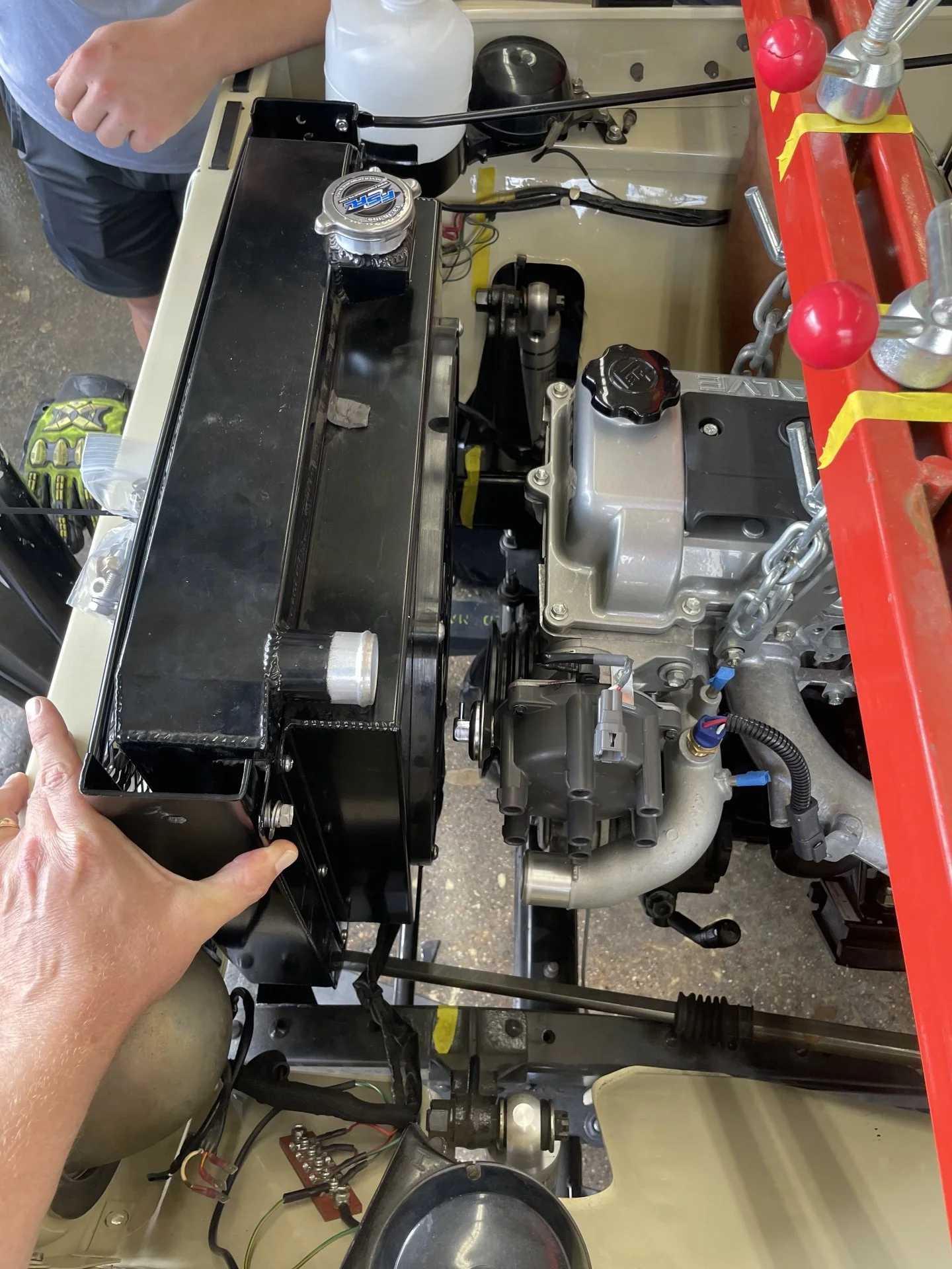

One thing we noticed is that the 1FZ is pretty tight in the 45’s engine bay, front to back. We are running the slick SPAL brushless setup on this, which requires a minimum depth of shroud to work properly. While the motor fit in there physically, we wanted a little more room visually.
First step was to remove this tubular cross brace and and angle channel from the front of the radiator and replace it with a flat bar (not pictred:
After slotting the radiator support mount holes in the frame, we were able to push the radiator forward 1/2-3/4”. Now there’s a little more breathing room visually:
can you give me specifics on that spal fan? i’m needing a low depth fan for my current build. ill have to move my radiator forward a little as well to gain that 3/4 inch if real estate
We use the 500W 16” fans on our radiators:
It looks low-depth, but does need a minimum of 2-1/2” or so of shroud for the motor & fan. Total depth is 3”…
