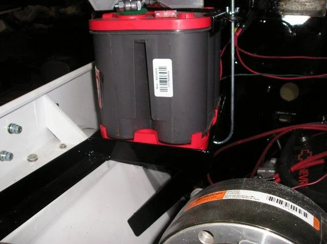

Built a battery tray. I'm really happy with the way it came out. It has one support that bolts to the top of the fender, then the one leg that bolts to the side of the fender, and another support that bolts to the firewall rib. I just need to find a better way to fasten the battery down, what I got now works, but I just don't like the way it looks.

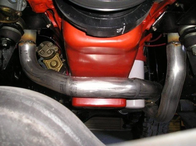

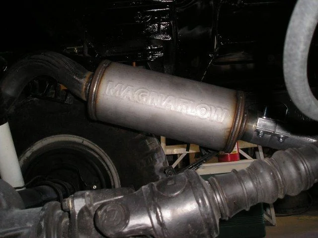

And the exhaust is also done. Finally. It was deafening before, now I can at least here myself think. I need to get yall a new video clip, it's a night and day difference.
It has a custom cross over pipe, then goes out a 3" pipe to a short Magnaflow, straight through design muffler. The tail pipe also came out really good, walking up to it you can't see any dangling pipe.

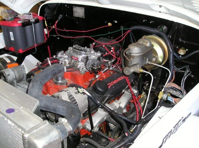

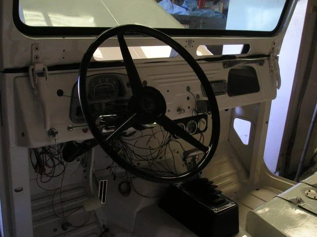

The dash is getting there. Still need to install a few more small things and clean up the wiring.
Also through in a pic of the engine compartment now. It still needs to have the wiring cleaned up also, but should turn out good.
