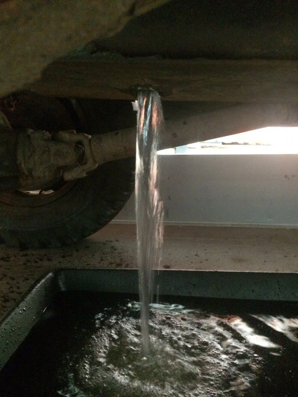

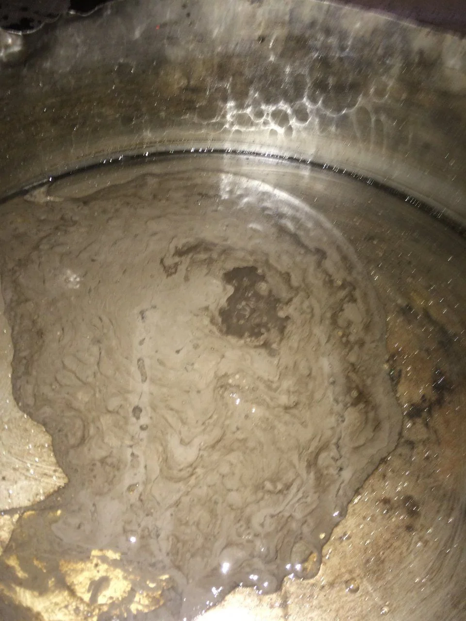

Will have some engine work to do. Drained the oil this morning. First thing I got was about 15 ltr of water:
Followed by a sludgy substance:

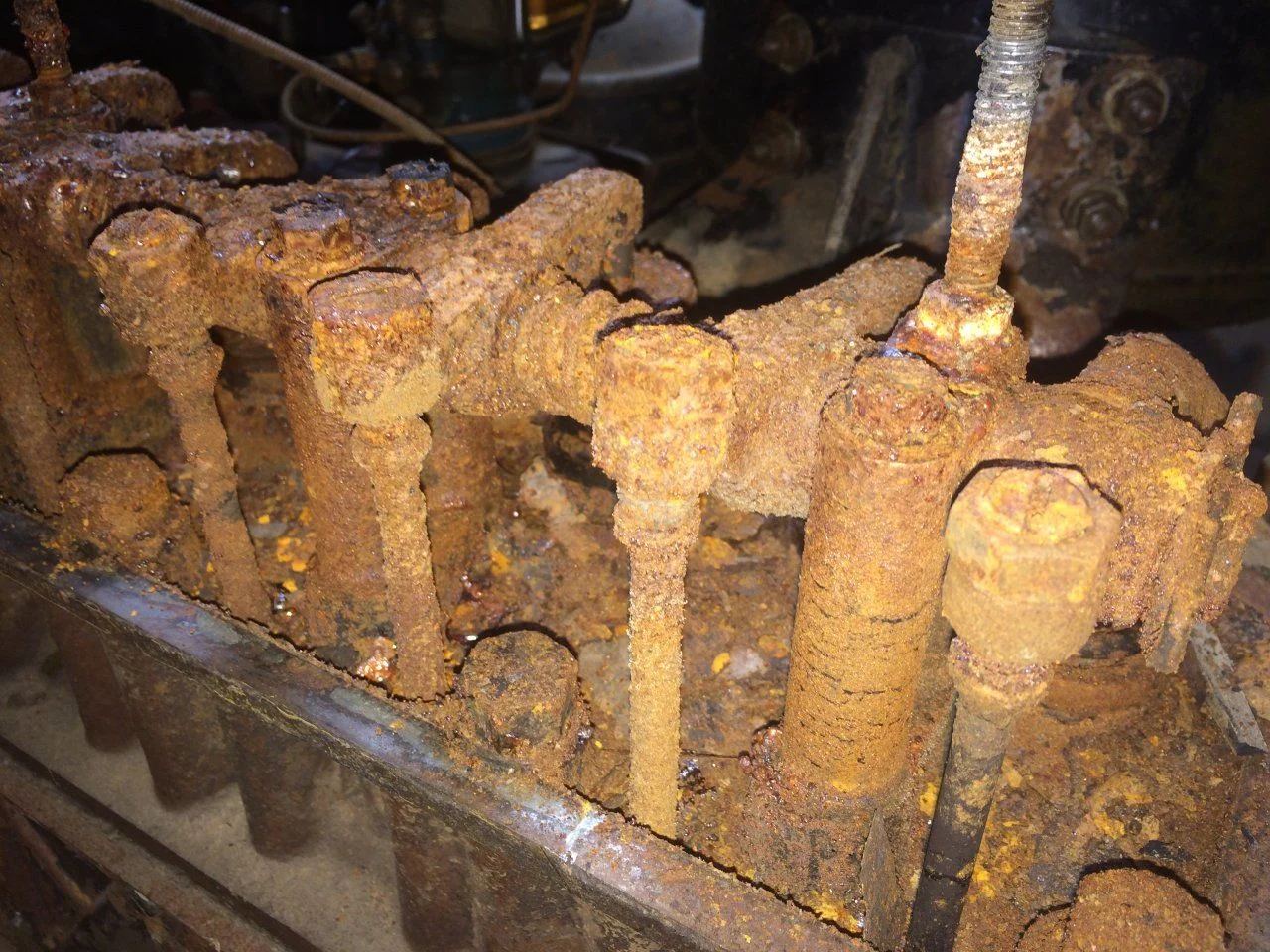

Pulled the valve cover:
Looks like someone found this on the bottom of the ocean. Hope we can get this all loose without breaking things.

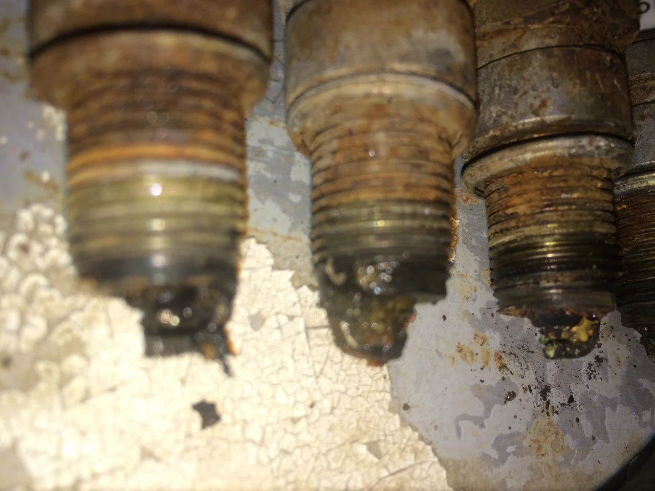

Pulled the spark plugs.
The cilinders had a bit of water and dirt. Left it like this, Maybe the water evapourates.
Looks like someone found on the bottom of the ocean. Hope we can get this all loose without breaking things.
Nasty stuff. You've got some work ahead of you. Hopefully the bottom end and the rest of the power train does'nt look like that!! Was that actually salt water that came out of the oil pan??
No salt water. It smelled a bit like diesel. Was surprised how clean it was. I think that smell came from the oil. Too much water for condens I think, maybe a head gasket problem? But it wasn't cooling liquid either. Saw no water under the rad cap.

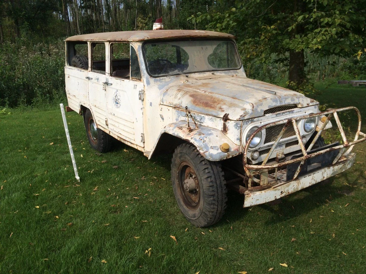

Yes, we're very happy with the 45! As cult said: it is amazing how original it is. The frame is excellent. There is even still paint on it. The body is not that good. Lots of rust repair to do. Floors, doors, rear sill and the roof. Luckily there is enough inspiration for that work here on this 45 forum.
The shift stick is moving again. The drive line must have been under tension. The clutch is stuck and so is the engine. After we drained the engine oil we put the valve cover back on. Through the crankcase ventilation hose we filled the engine with old but clean hydraulic oil we had. We stopped when it came out of the dip stick tube. We also drained the gearbox and also there was a lot of water. We'll fill this with hydraulic oil too. Probably this car has been under water for some time. The door cards look like they've been quite wet and the bottom of the front doors are filled with clay. Guess we'll never know what happened.
First thing to do is getting rid of the water, fill everything with oil so the rust inside the driveline won't get worse then it already is, and the remaining water will sink to the bottom. Then invite the RDW, that is the Dutch registration instance. They will identify the car to be sure it can be registered once it's ready.
