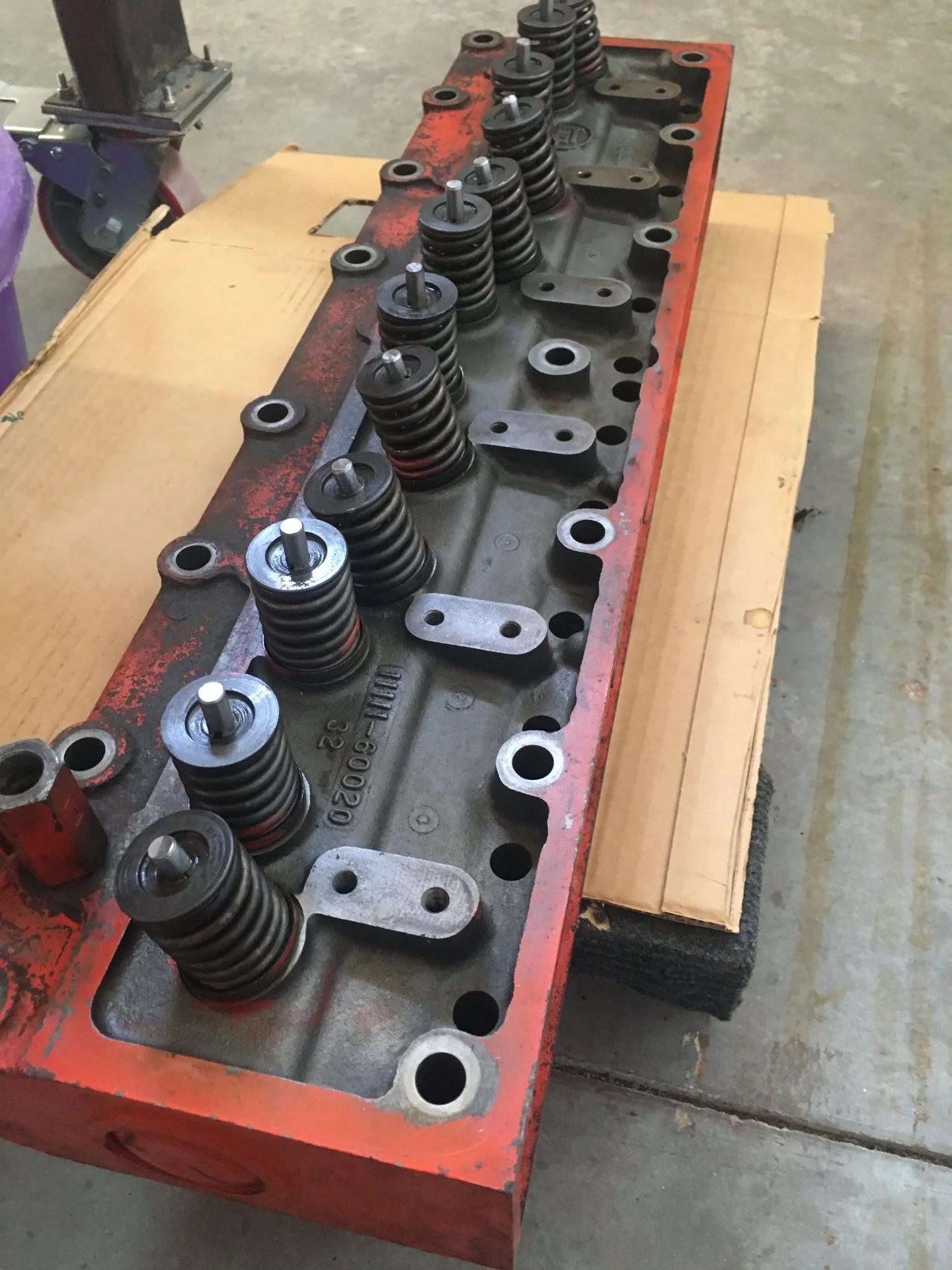

Cleaned up and lapped valves back in head with new umbrella seals (Fel-Pro).

Could you please share the part number of the umbrella seals you used on the valves?

FEL-PRO SS72616 Set
