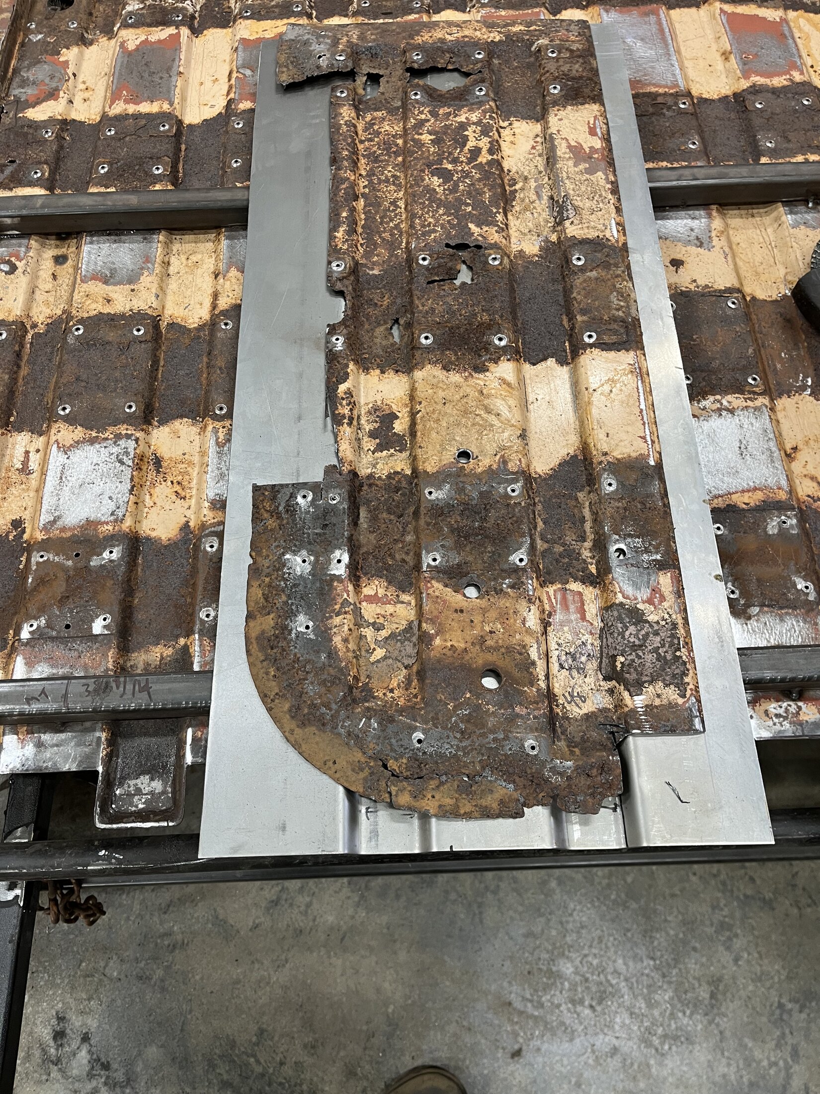

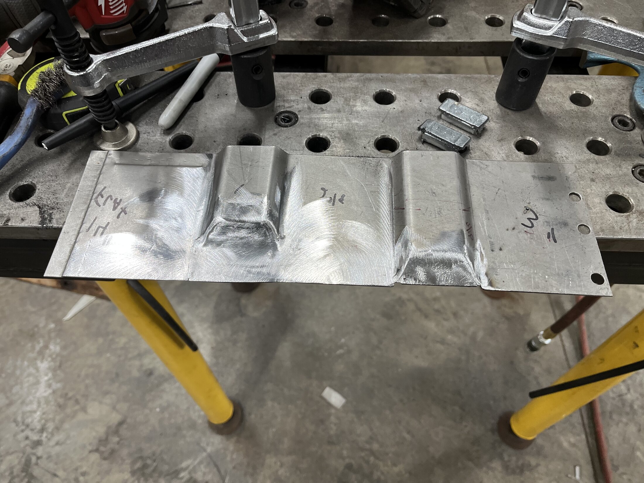

Fabbed up rear bed floor patch.

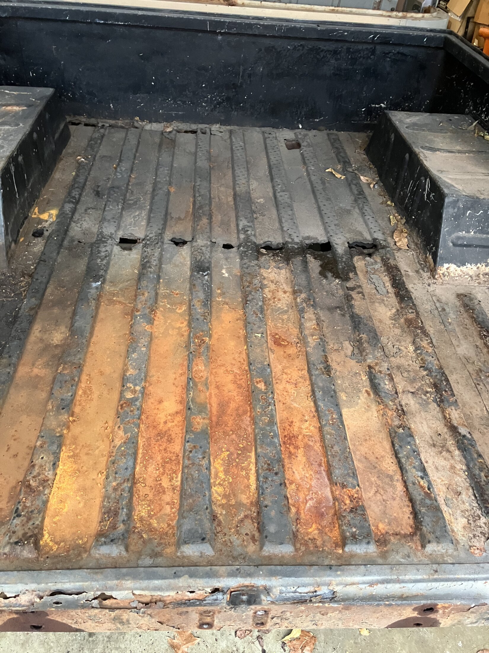

That’s really great work. I’ve got the same work ahead of me. Did you ever check into cutting a 40”x68” rectangular skin from a donor Toyota, chevy, ford, …. and see how well a single piece would fit within front and back and within wheel wells? Just something I was thinking as I worked on the bed today.
I have been looking at bed floors. Seems like an older S-10 bed floor may work. Not sure what gauge it is. I just talked to my metal supplier. He has an 8 foot brake so may try to do a 41”x 6 foot piece next week. My center section is repairable but it will have a bunch of patches.

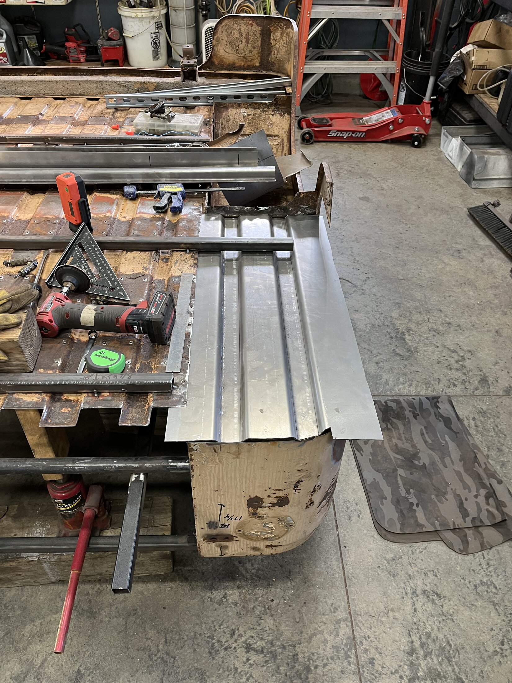

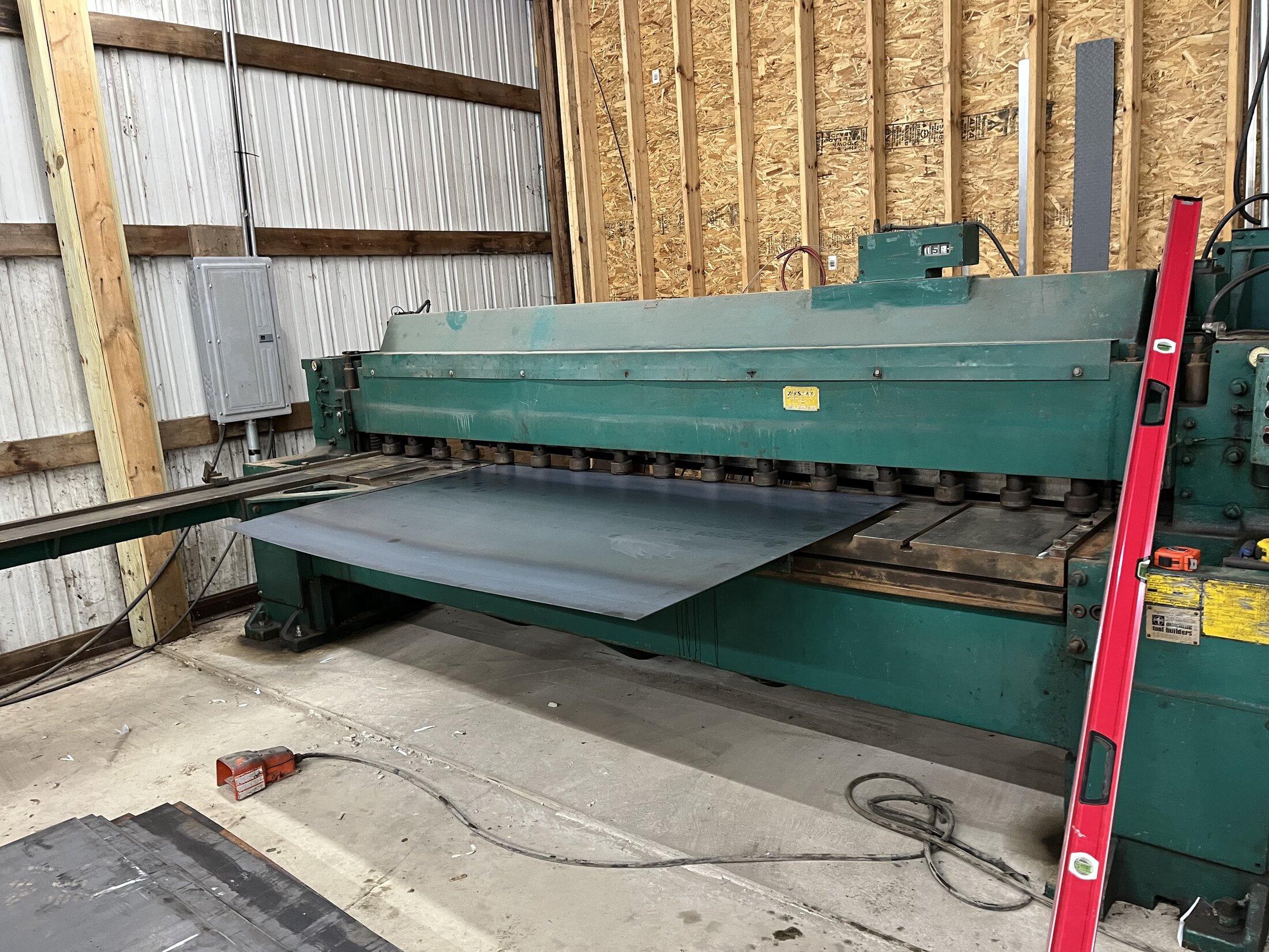

A couple hours. Most of it was layout. You have to layout both sides because the sheet needs to be flipped.
Small I need is to find a new friend with a brake. A really big one…
