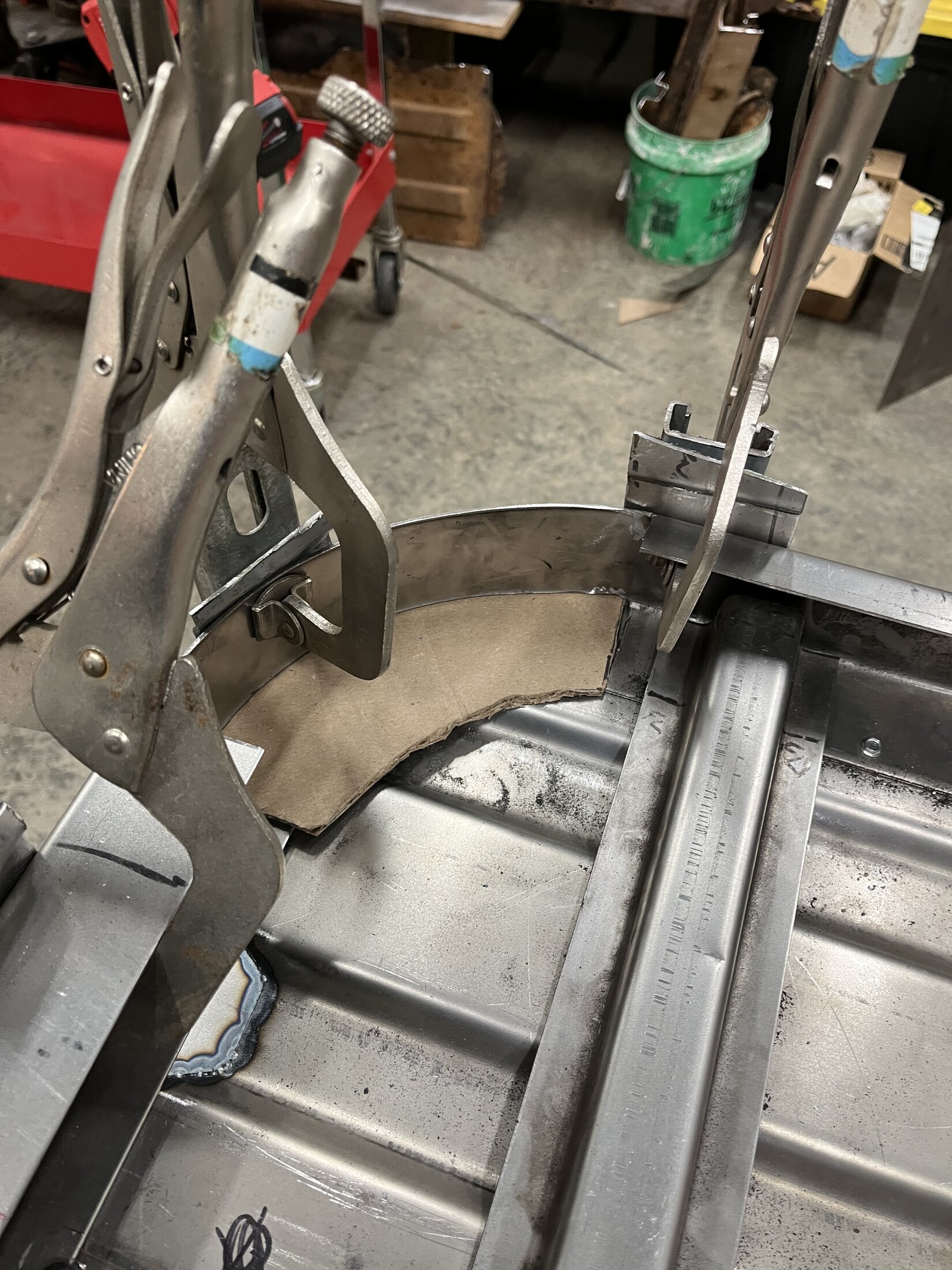

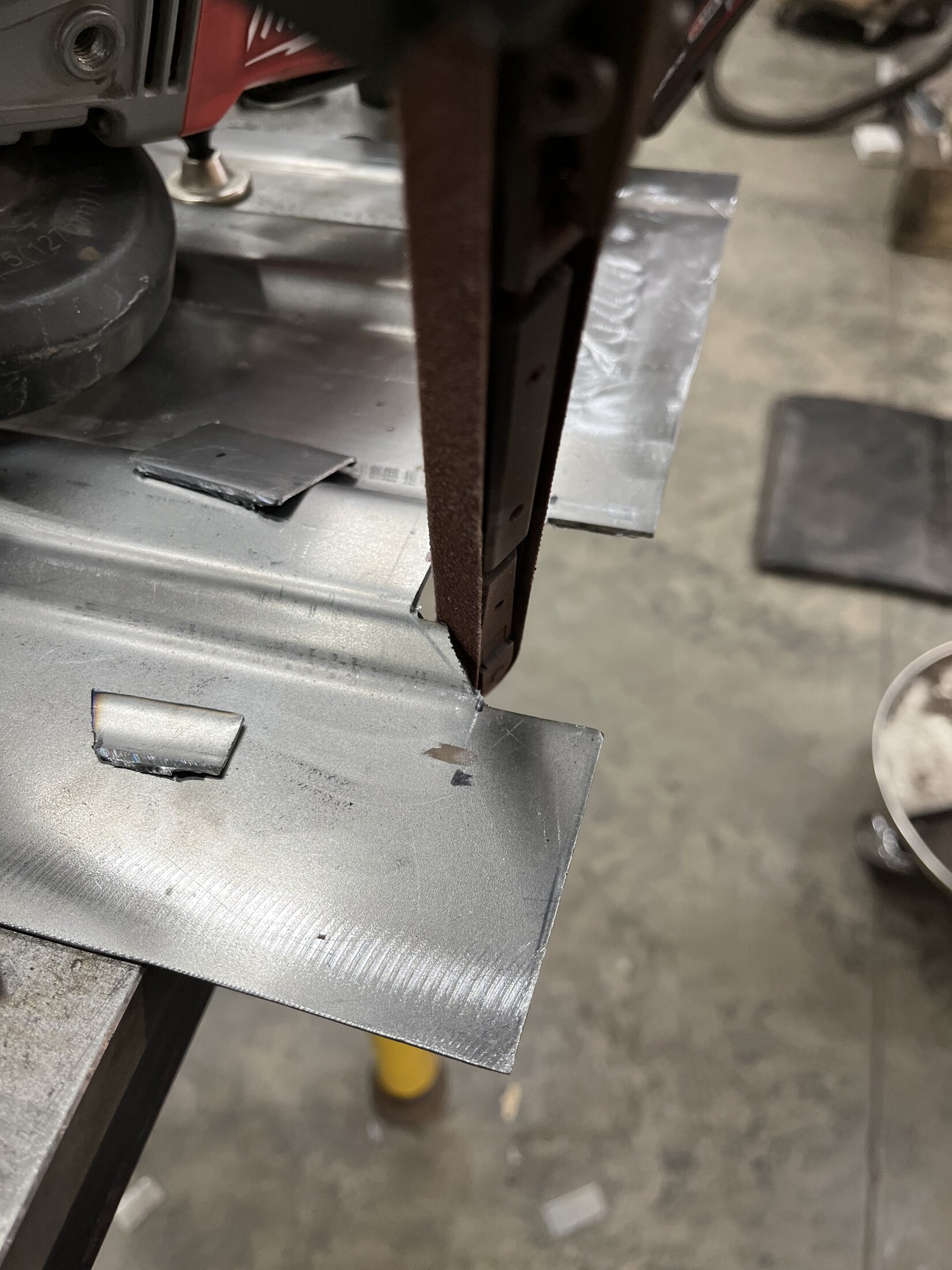

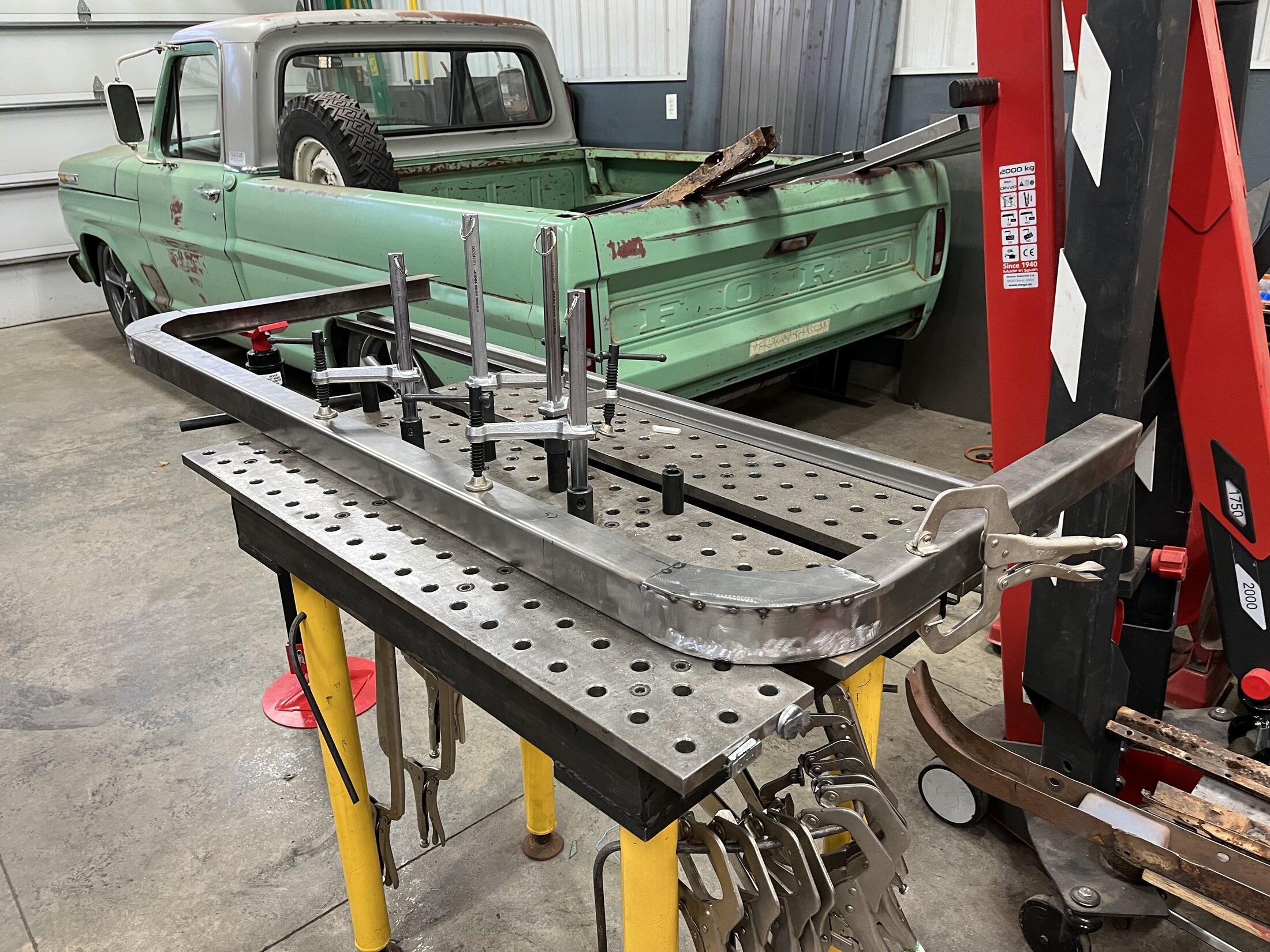

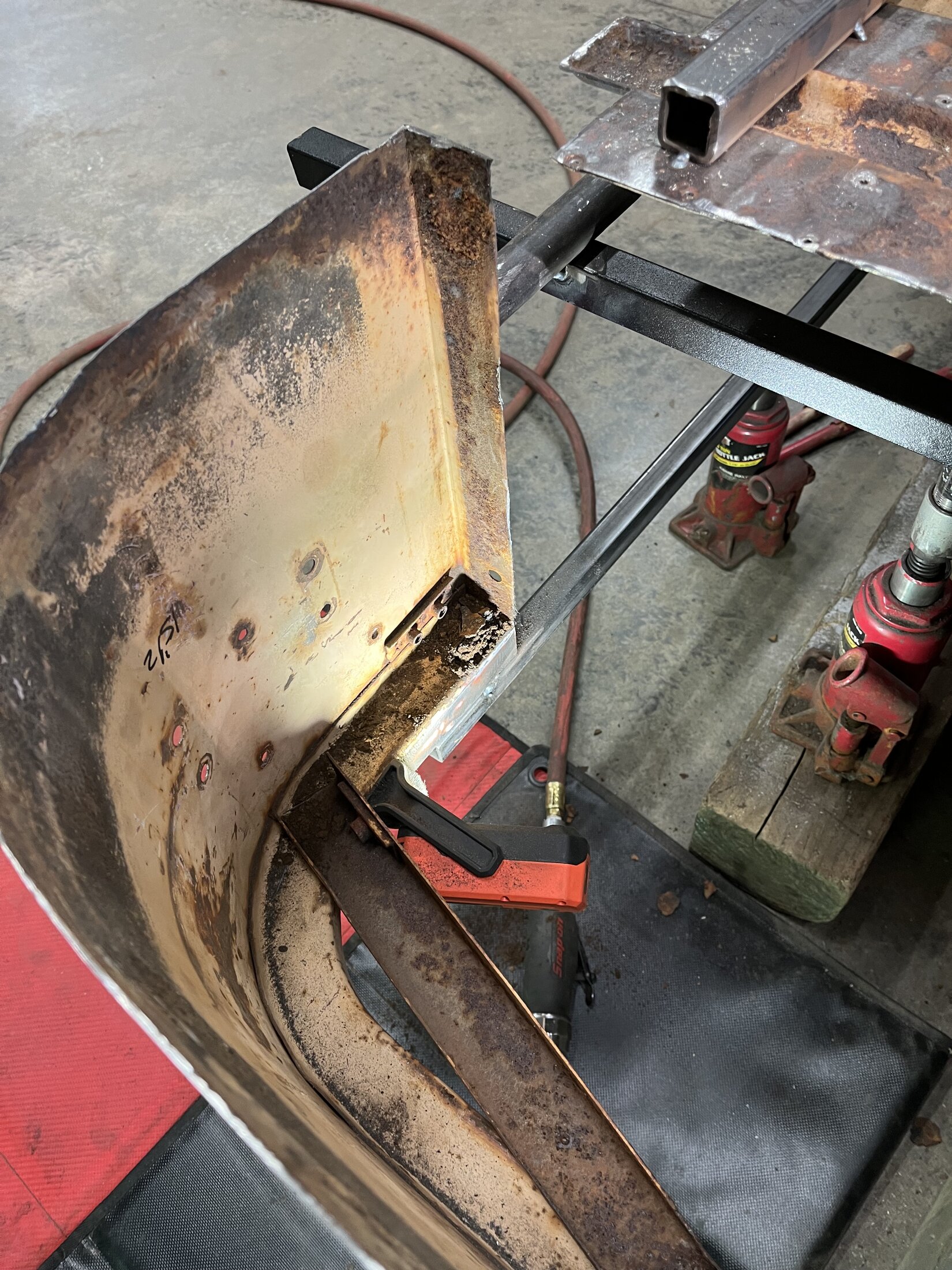

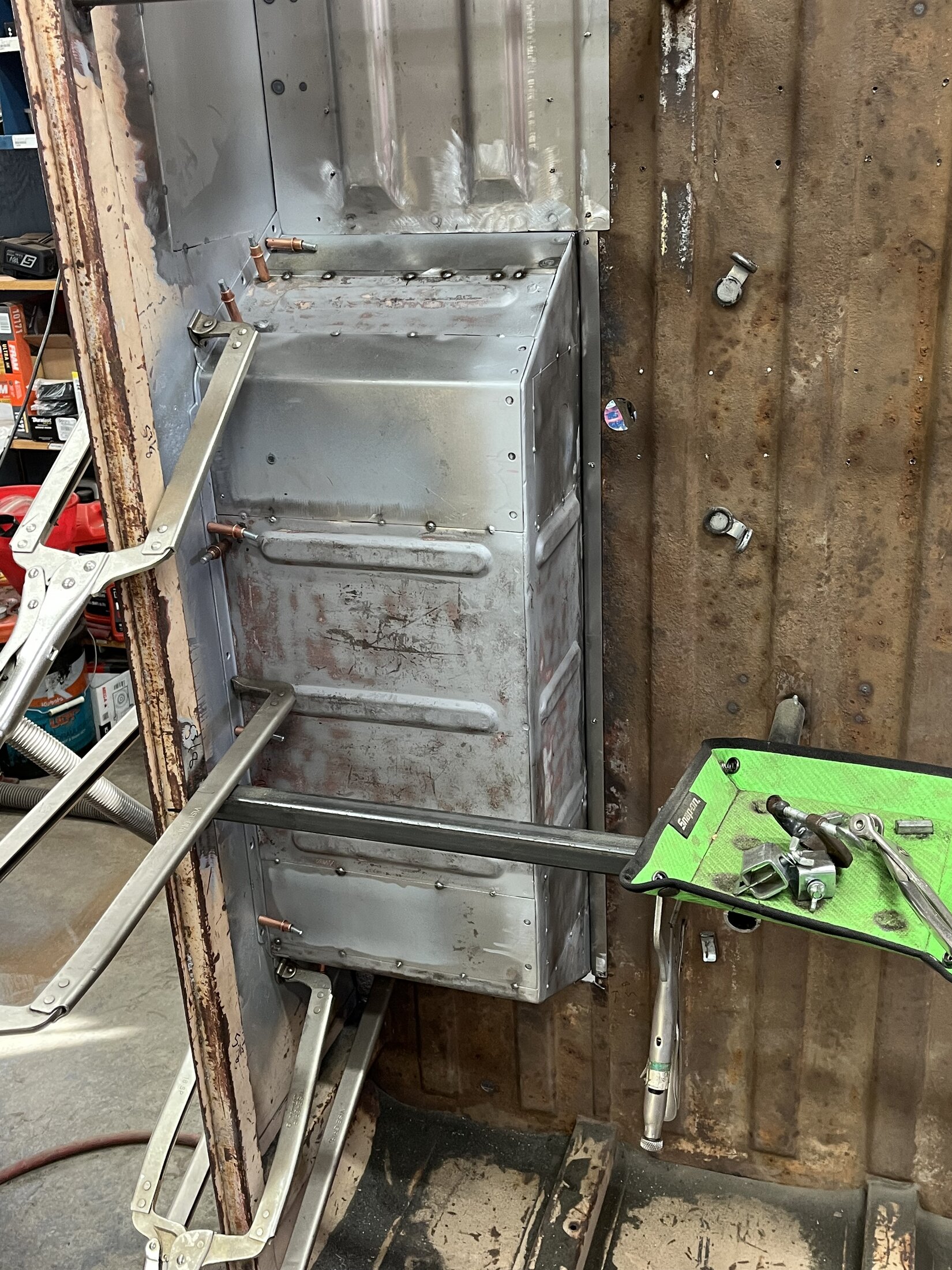

For factory style I cut out the metal and fabbed a piece to install which u can see on back side. The flush one just cut 45s on both sides of rib , straighten metal and hammer to 45. I will post some pics when I start it.

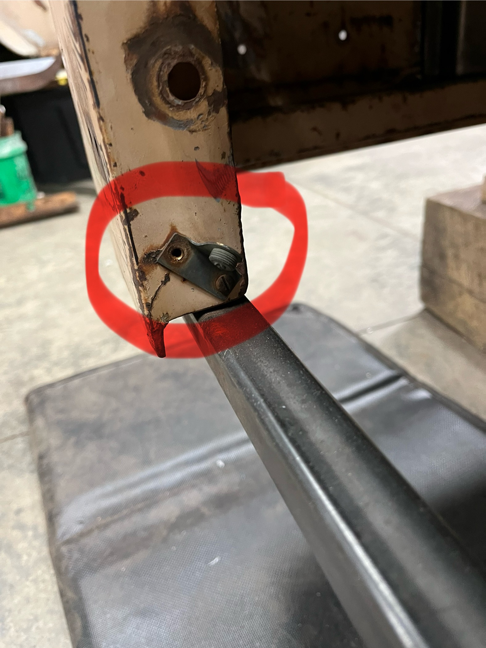

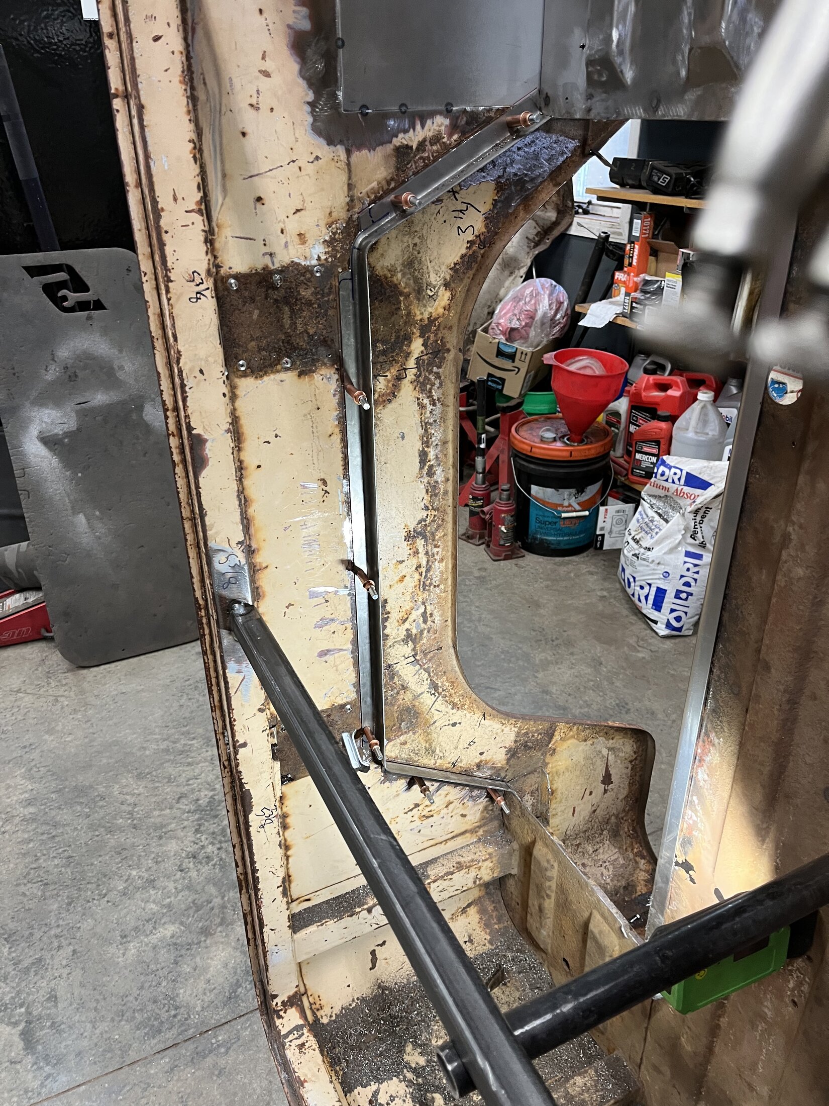

Are these brackets original? Maybe a gate cushion or stop.
Not original, lip on tailgate stops it, rubber strips for cushion.
