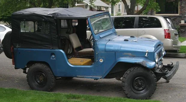

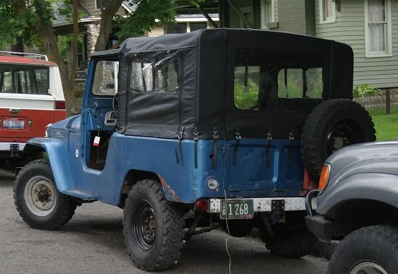

IDave hooked me up with his Paki-top and bows. It’s (obviously) not right for my 1963 FJ40 FST, but it’s as close as I’ll ever get. I’ve owned this 40 for almost 20 years and this is the first time it’s had a top.
I had to cut an inch off the bottom of the B-hoop. (to make it level with the rear hoop) The piece on the b-pillar that the door closes against, on the passenger’s side needed to be repositioned slightly. So the tack weld was grinded off and re-tacked.
The piece that attaches to the windshield and the b-hoop was about 2-inches too long. I cut and re-notched the b-hoop end. I used w/s L-brackets off my 45 for the w/s as the ’63 didn’t have those (I think)
I don’t have any twist-locks yet. The footman loops on the body are missing; Dave gave me the ones that came with the top. I’ll tack those on when I get the twist-locks.
Overall, it fits much better than I expected. It’s a little slack at the B-hoop/top of the door area and that’s it. Everything else is good.
I’ve some later soft-doors that I’ll cut up and re-form to fit the FST door opening. I know this is a bastardized set-up but as I said before, it the best I’ll ever come by.

nice stable you got there... cool bezel, 'land cruiser'
I think it will tighten up when you get the twisters and footmen on there.
Nice license plate! :D

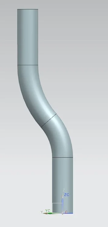

The bottom of the B-hoop I'm using was designed to go straight into the tub, not on the inside like in this photo.
I could pull the boxed piece off the tubing, put a jog in it and modify the boxed piece to come down and go outside the tub...or not.
Dave, that's a 1963 Gem county plate. I'm still looking for an Owyhee County version, they're harder to come by.
Thanks, again.
Dan
:cool: The fit is not too bad, and it has the "look". Play with some padding on top of the bows, it almost looks like it would tighten up if the bows had some lift. :) Did you see my thread on fitting the Bestop? I guess that's a lot more forgiving because of the back bow pushing up and back.
Maybe something like those foam pipe insulators they sell at Lowes?
Nice wood pile!
Thanks. I'm very pleased. I'll try the pipe insulation.

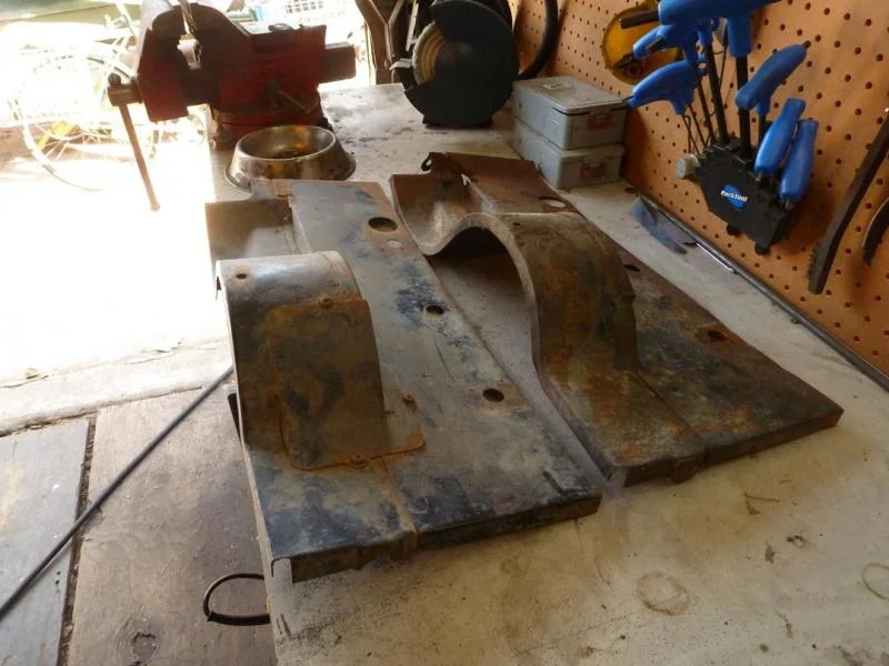

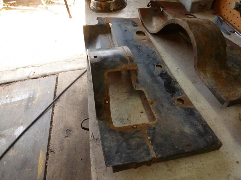

After getting another trans tunnel and it not fitting either. I ended up using my ball-peen hammer and finally got the trans tunnel on. The shiny black paint makes it look worse than it is. The top-shift three-spd linkage hit right in that corner.

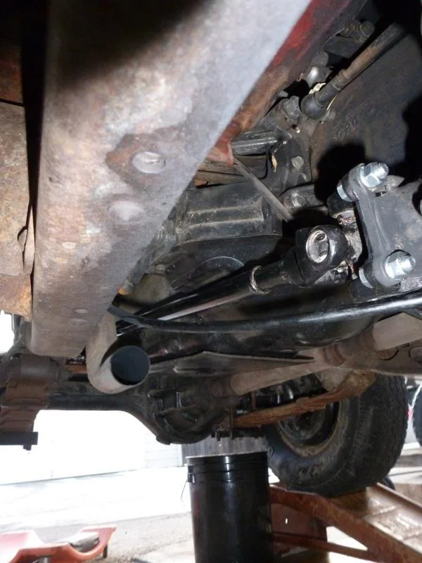

Next I think I'll have to get a muffler on it. I wonder if stock mufflers are still available? I've got all the OEM hanging brackets still.
Were both of these transmission tunnels for the early p(pre 64) cruisers? I had a post 64 set on a early 63 tub and it fit on the driver's side but would have needed work on the passenger's side. It should have work with the top shiftersince that when Toyota went to the Top shifter.
I guess I should compare the early three speed to late three speed transmission covers see the difference. Never thought about the top to side shifter differnce:hhmm:
The one that's on there is the original, '63 tunnel. The other one was a later, un-cut tunnel, but it had the PTO shifter hole...the pto hole was about 4-inches further back on the tunnel though.
I cut the hole out of the other one and put it in this one as the hole on had a nice rolled lip.

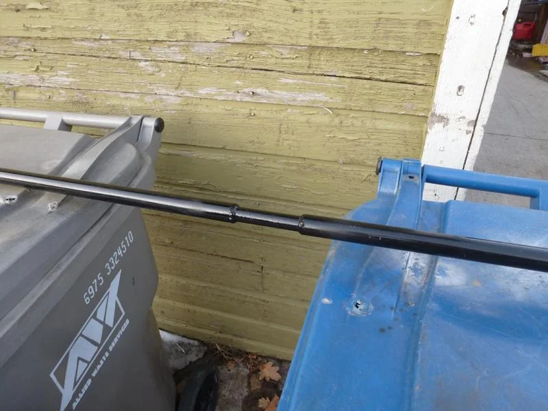

I think I'll use a piece of 3/4" solid bar stock, bend it up to have the right offset (about 1 1/4") and cut the stake off flush with the boxed section, then slip the bar stock inside the tubing and weld it in. The tubing that was used on this top is close to Schedule 5, 3/4" pipe, 1.05 O.D., .065 wall thickness so 3/4 bar stock should fit easily.

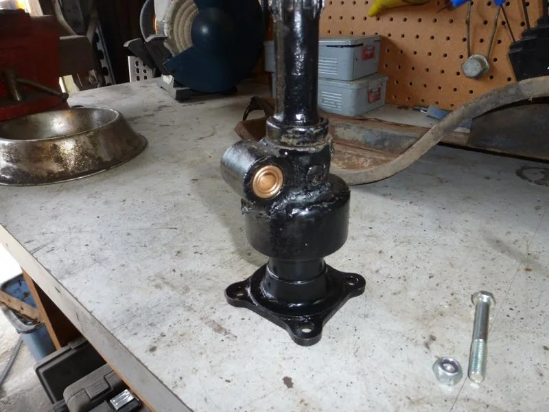

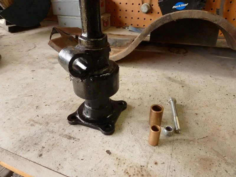

Finally fixed the broken pillowblock. Ordered some brazing rod for aluminum, and brazed the casting back together. Got a new bearing, felt and dust cap from $OR as well as some hardware from the hardware store. installed a couple brass bushings in the carrier hole.
