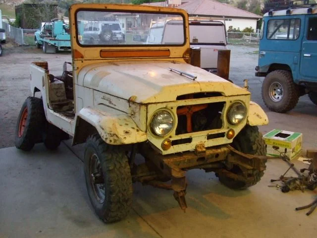

1962 FJ 40 D'animal

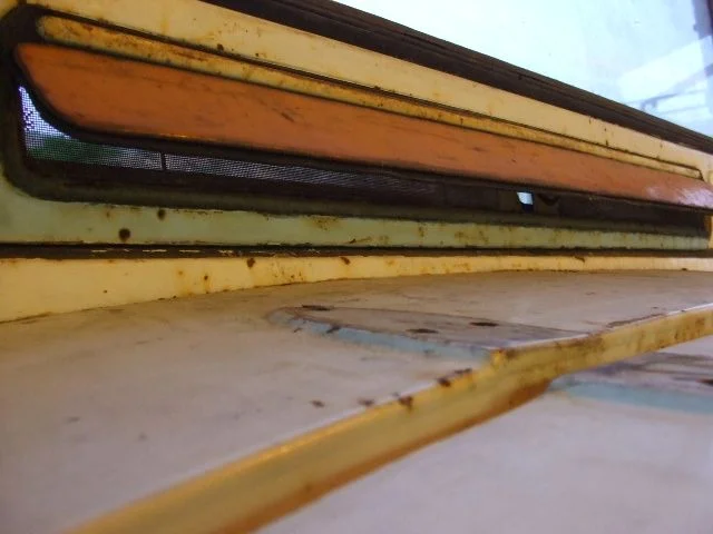

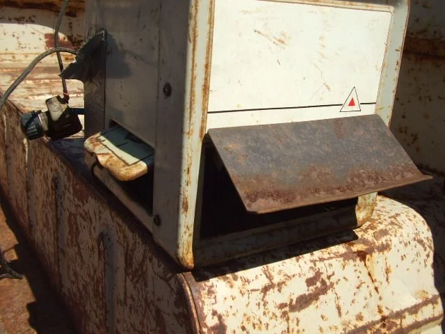

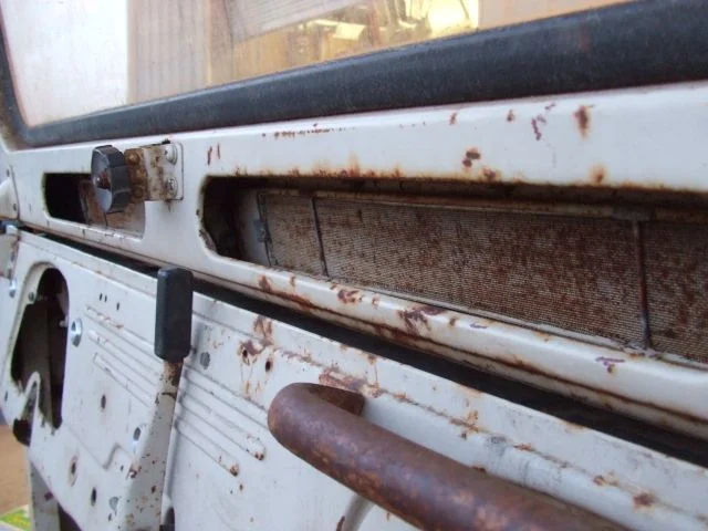

Open and closed mode.

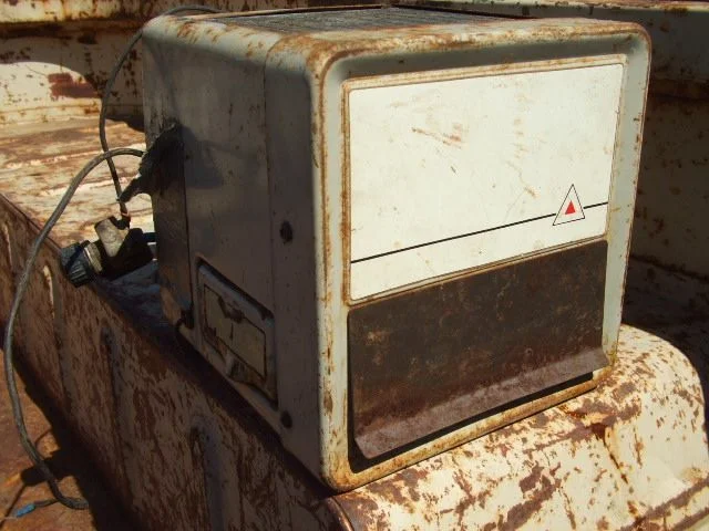

It has two smaller openings on the side and the wide one in front. Heater lines connect to the back and a wire comes out as well.

The mirror and heater are not stock. I've should an a extra stock mirror. I've got a denso heater and Fox has one. Can't remember but Landpimp might too. Bib lights should be clear. Tail lights are the 64 thru early 69. The tail lights on a the pre 64s are smaller. The list of things that are correct is way longer so it's was easier to list what wasn't correct. Are you going to need a hard top and doors?
Nice cruiser. This was on mud? I guess that's why I don't look in the for sale section to often might find something like this that I couldn't pass up.
Like alot of other years with cruisers 63 had some changes during the year. Your could of had a stamped LAND CRUISER bezel. The transmissiom and transfer also changed during the year. By the looks of it yours has the later three speed. Did it come with a bezel? How about running boards? As far as I know all 63s had the short running boards. Spare tire carrier?

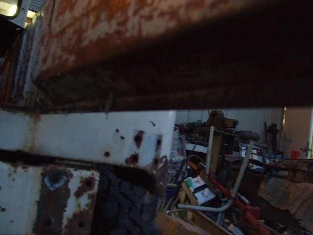

What does the top of the tub look where the hard top fits just behind the door? Does if look like it been cut? 63 I've seen had the high B pillar. Then it ended in 64:confused: The tool box is that of a 63 and earlier 64 had the square tool box.
I have the correct Bezel for it.
I need the shorty running boards, spare tire carrier and seats.
