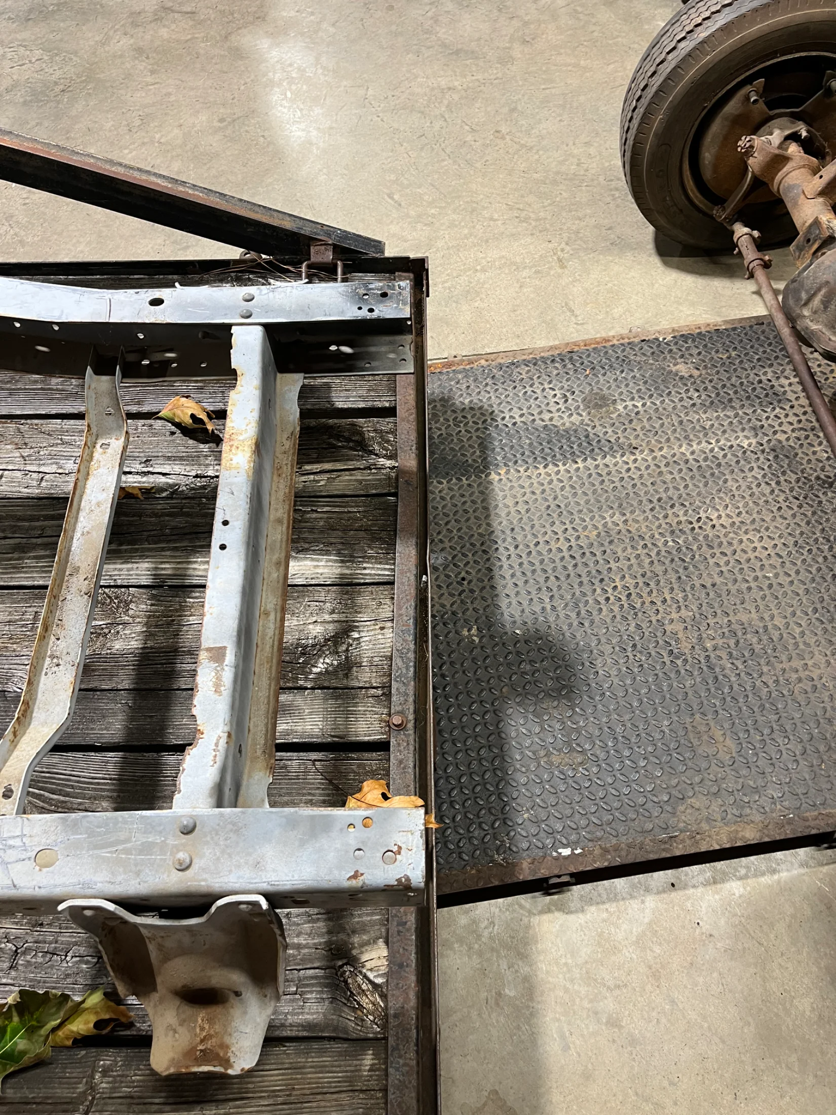

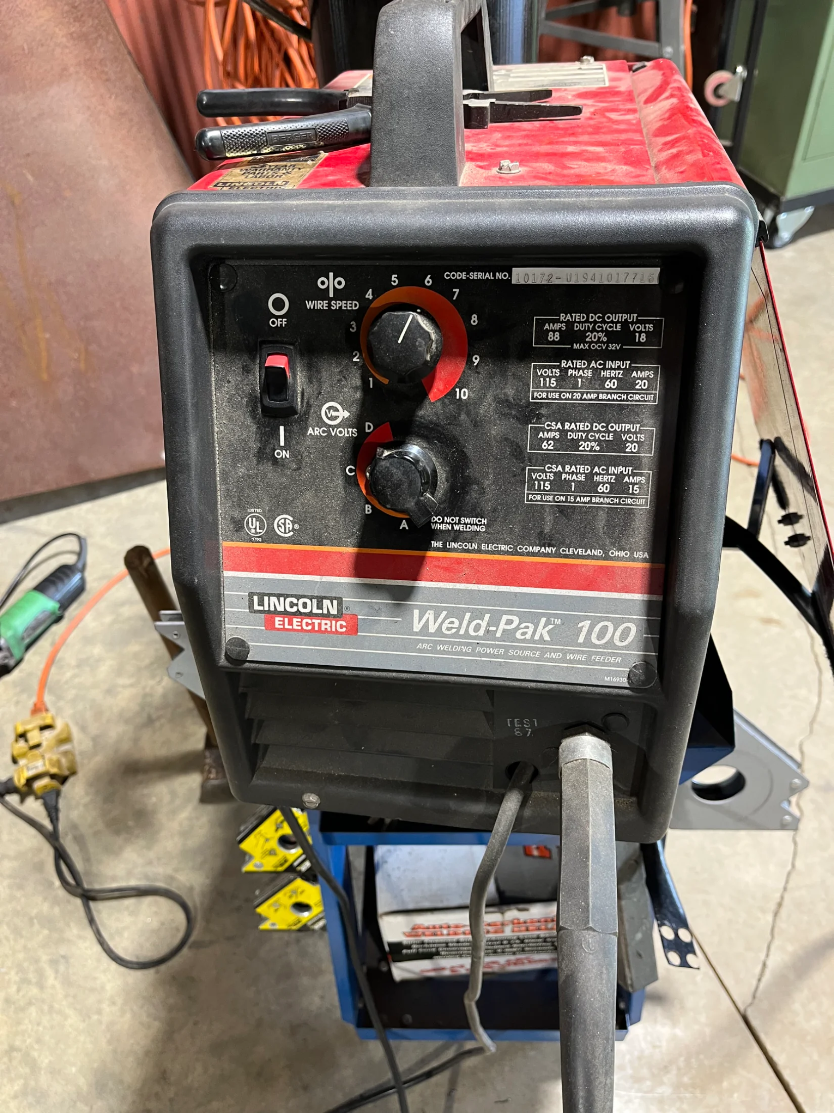

Last week I thought the frame was ready for blasting and paint. Sunday evening I remembered I had purchased some frame strengthening plates for the steering gear box area. These frames are notorious for cracking in this area and my frame was no exception. I couldn’t get time to weld them in during the week, so I spent this morning and afternoon burning them in. Considering my welder is probably on the edge of its capabilities and I am not well practiced at in the art of hot glueing metal, it turned out okay 🤷🏻‍♂️
Now it’s ready for blasting and paint. I almost didn’t borrow enough trailer. The frame is 16’ 1”.
Not an extremely productive weekend. But progress was made.
Tomorrow evening I will deliver the frame for blasting and paint.
