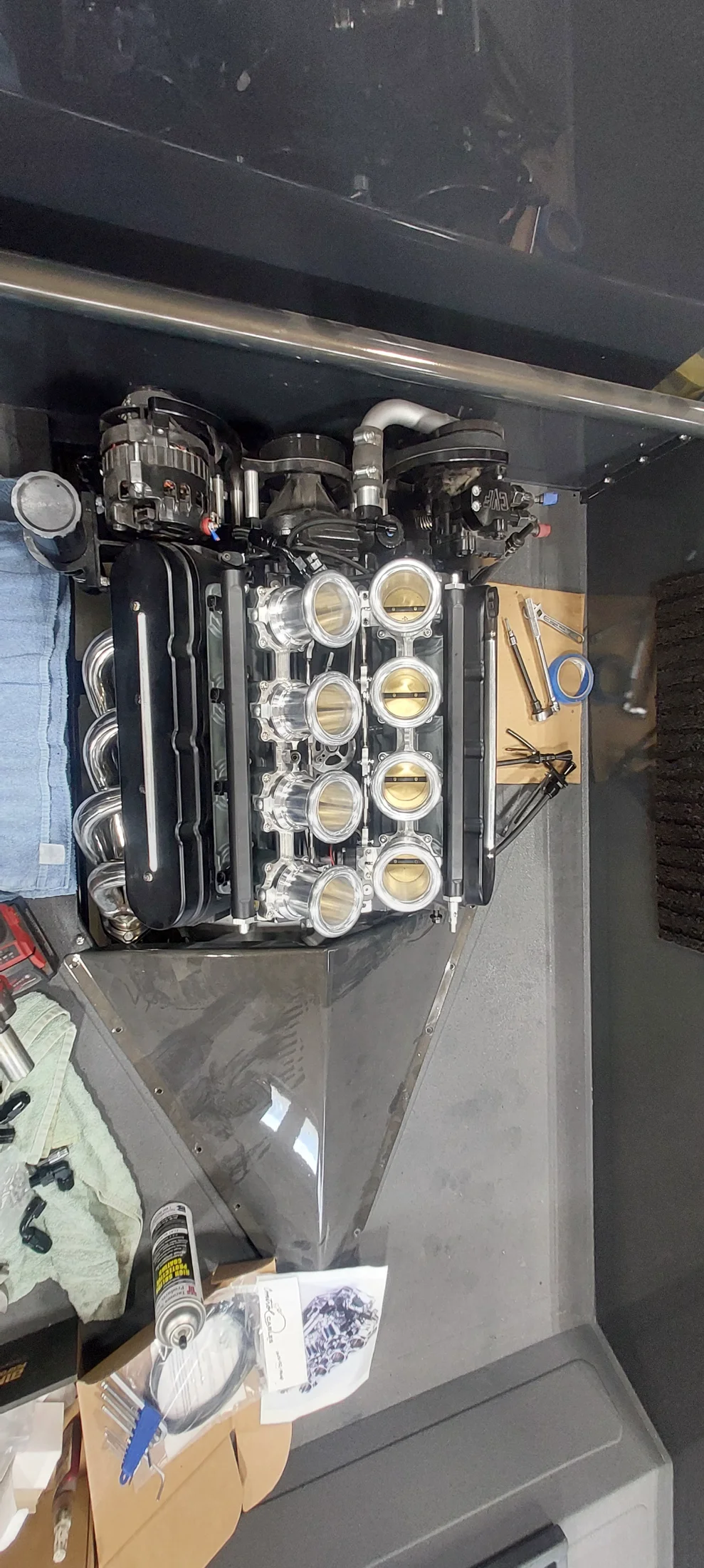

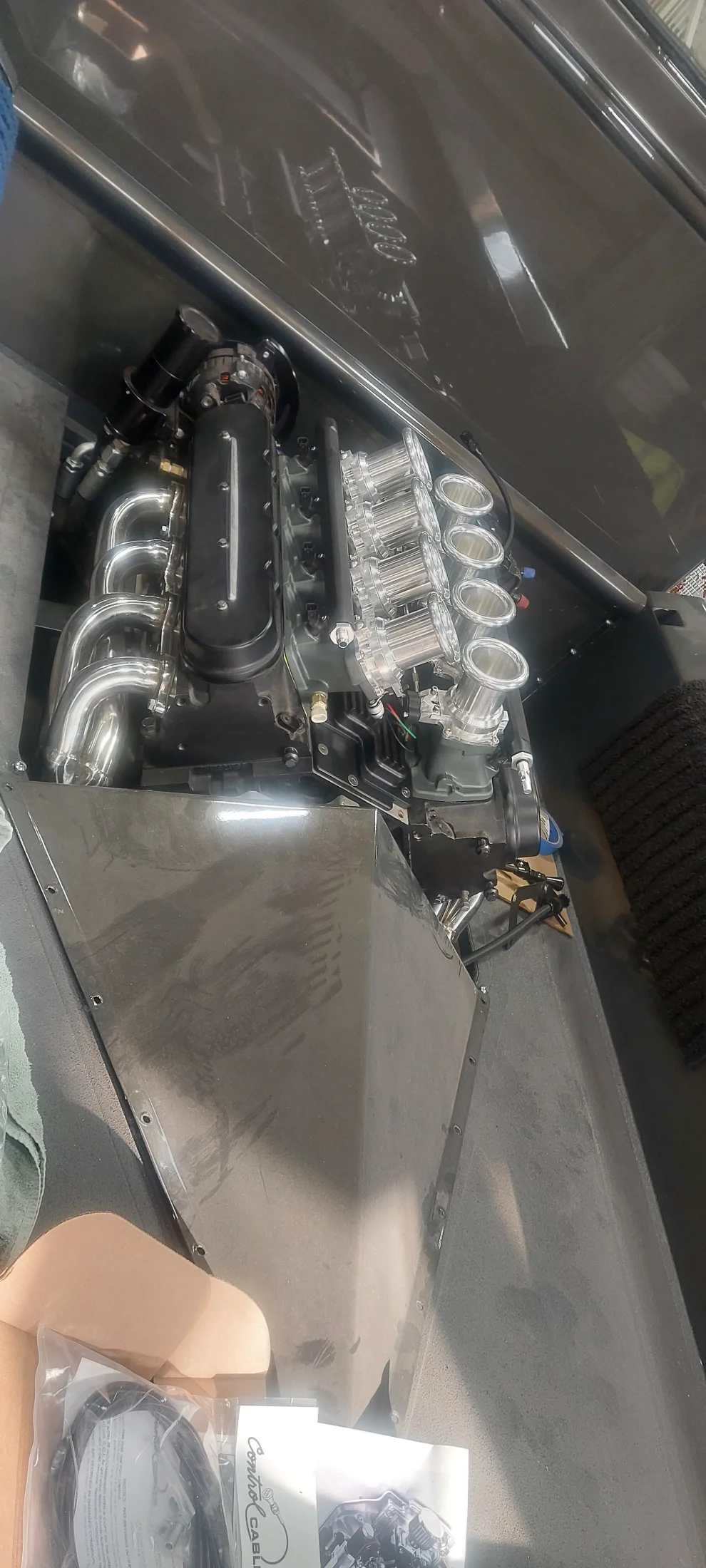

Hydraulic cover that flips towards cab 🧐🤔😘
^^^^ Or maybe Lexan?

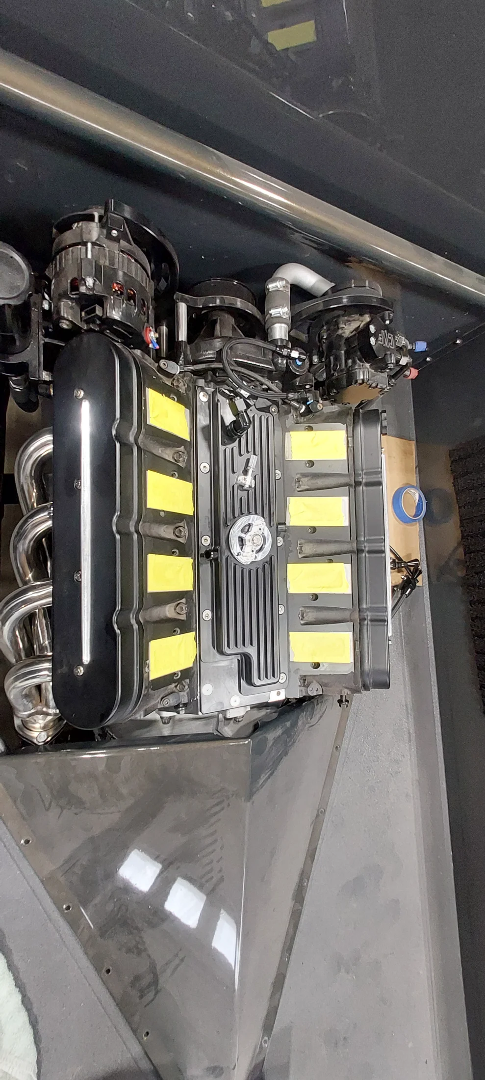

Engine will stay exposed, that's the entire reason for the stack fuel injection.. I was telling the owner the engine looked like a turd in a punch bowl and if he was going to stay with the low-pro intake I should cut six feet out of the bed and put the engine back under the cab..

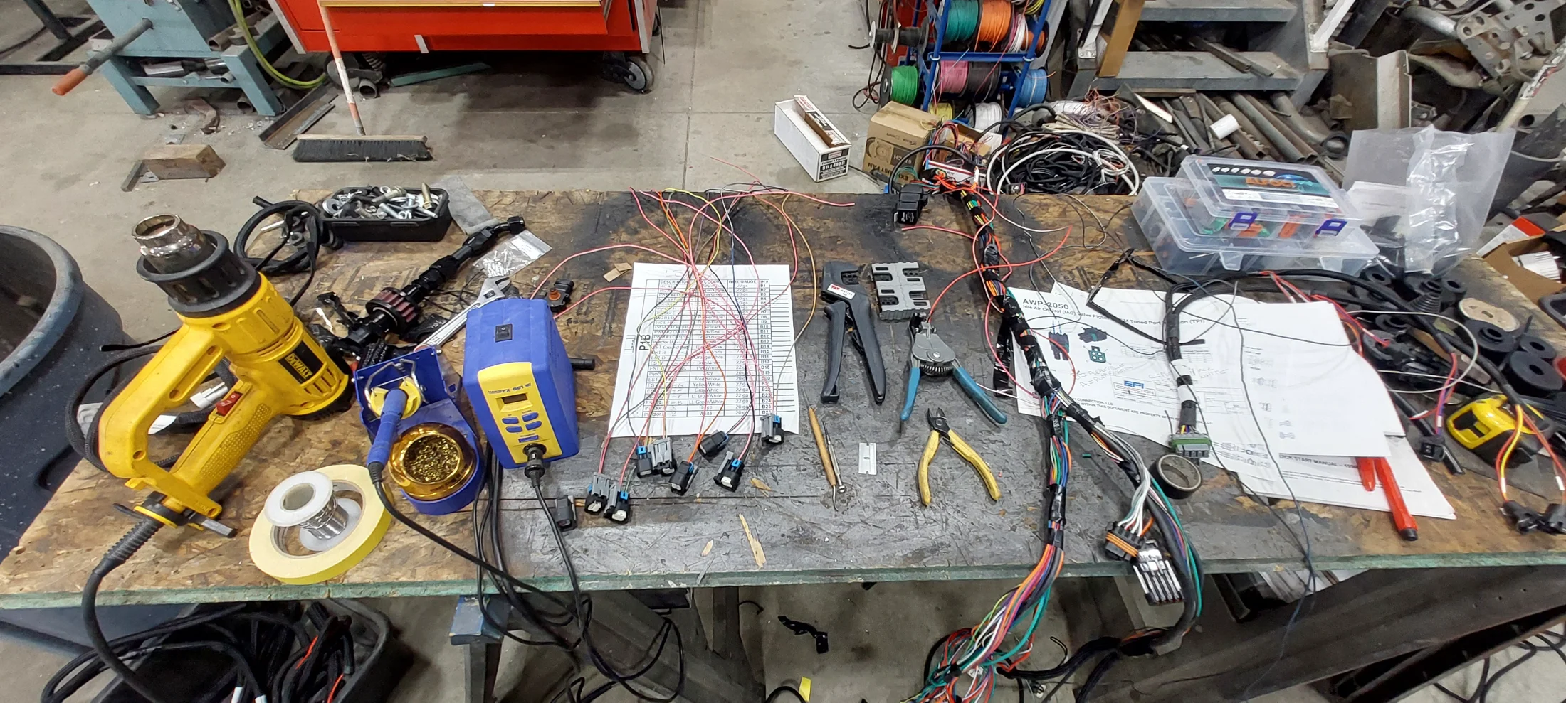

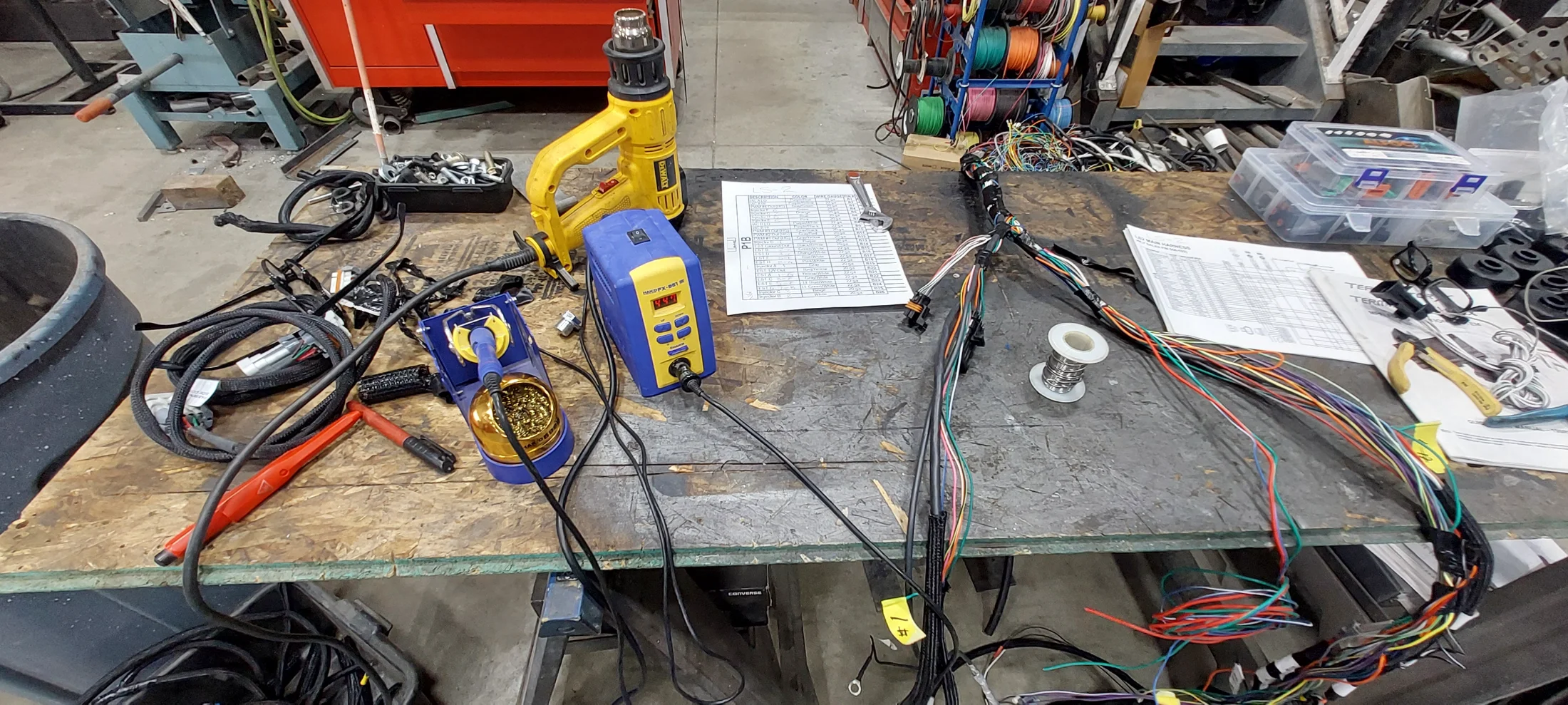

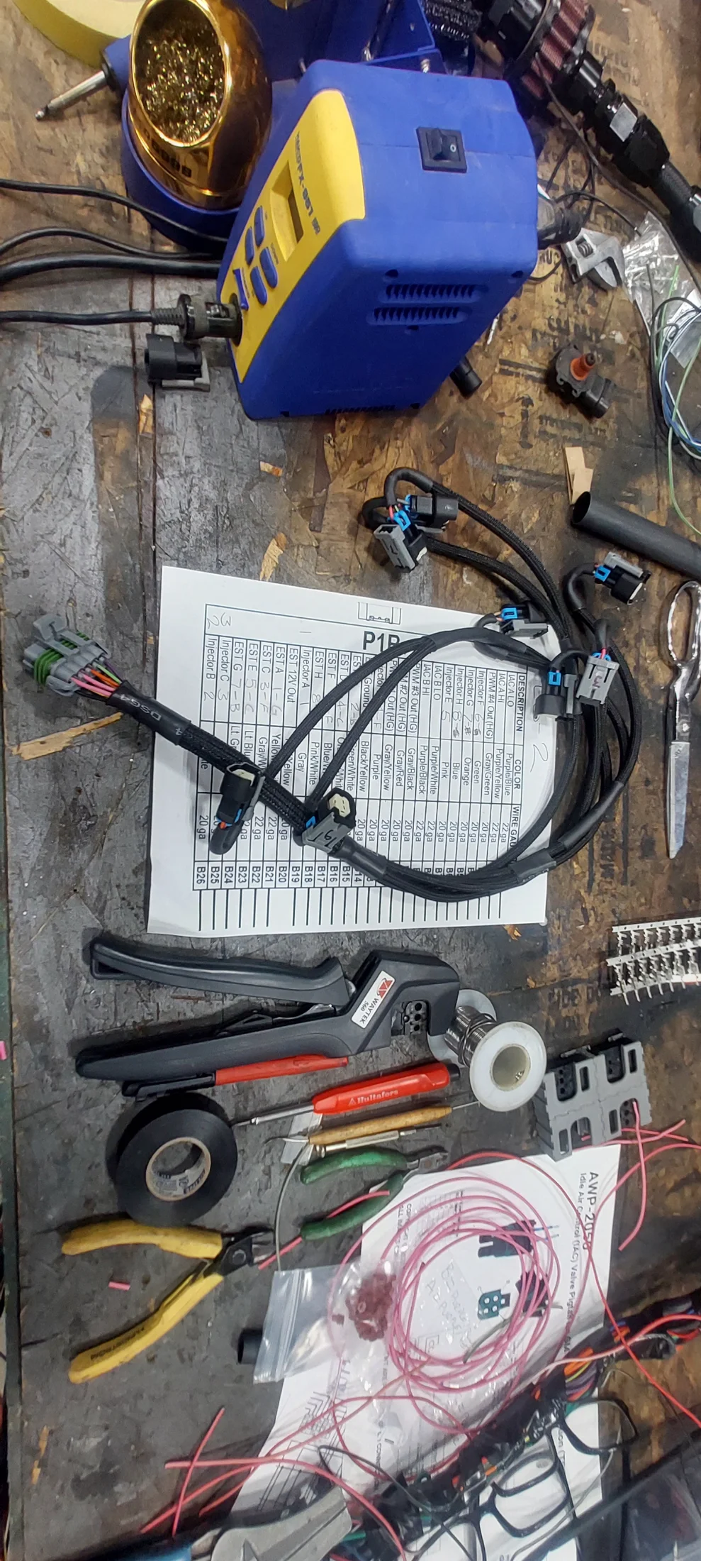

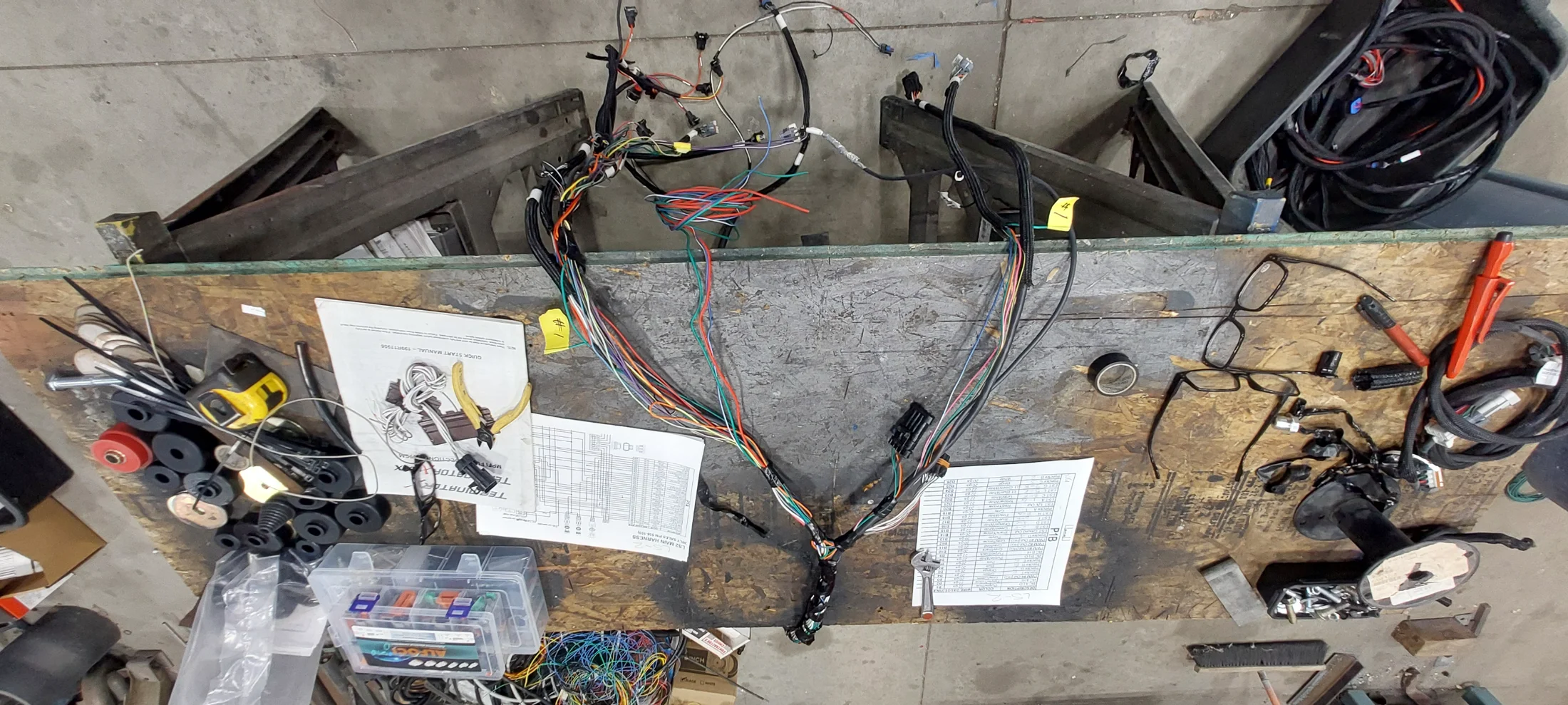

Engine wire harness is done and I'll start snaking in in tomorrow. With the computer mounted 3' in front of the engine all the leaghts were wrong and lefts and rights were flipped..
