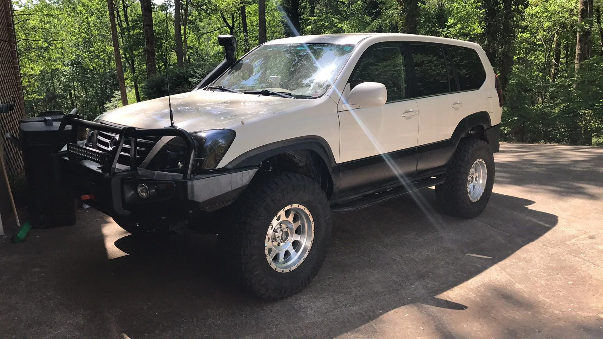

That +10 offset is going to make things a bit more difficult than it could be. You should really have -10 offset for 18's and OME 2.5 lift to put a nice meaty tire on. Something more like this set up will be what you want. GX470 - OME lift, wheels and tires
Ha, thanks. I love that thing, I've drooled over it before and is much of the reason I'd like to go wider than 285.

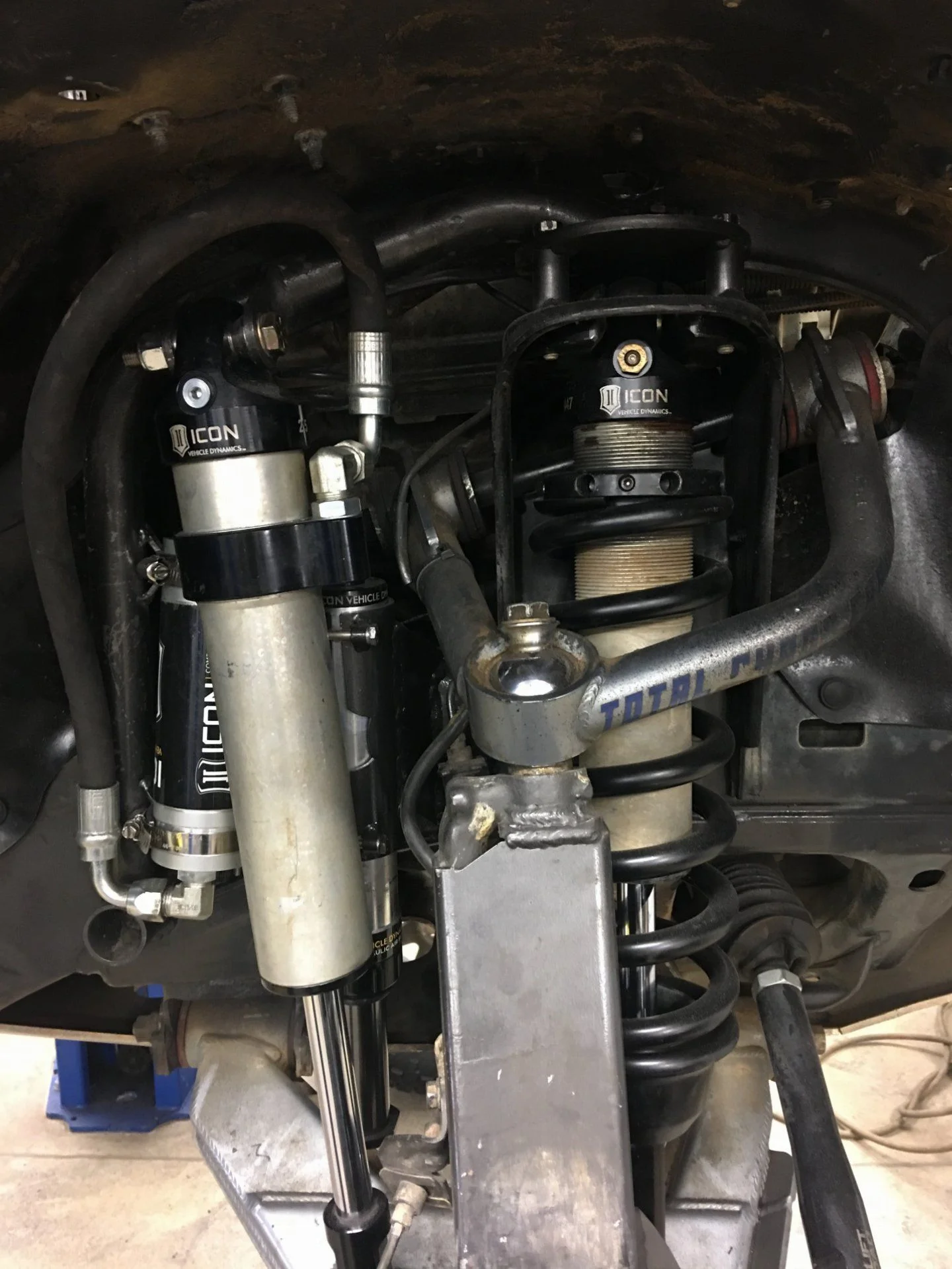

I did 0 offset, 3" of lift, and some saw time Got 35s on there!
Hot damn. And I thought I was pushing it with the desire for 33x12.5's. I assume you've got UCA's on there? Looks great Dan!
Also, what are you running for spacers (if any). Thanks!
