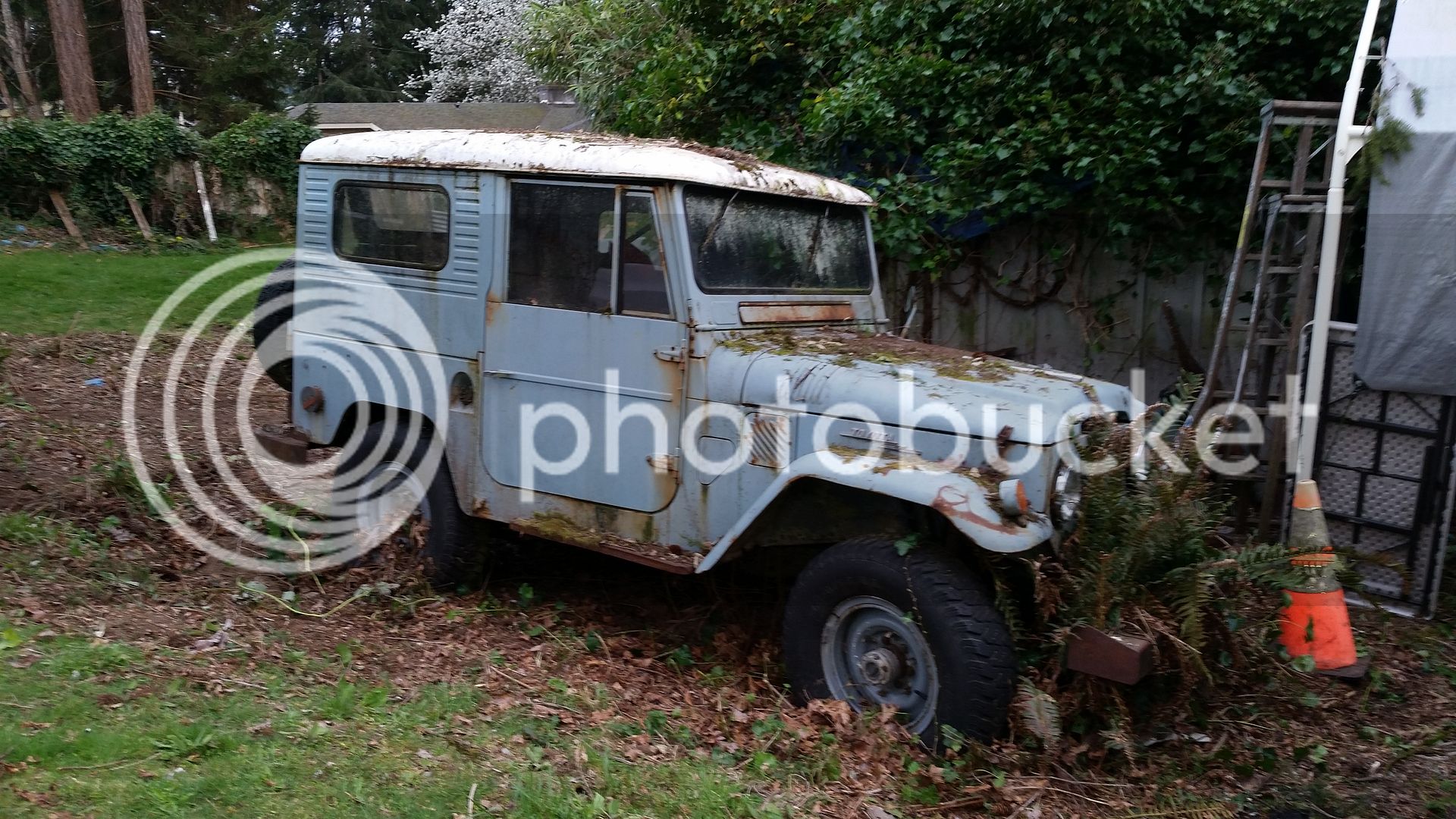

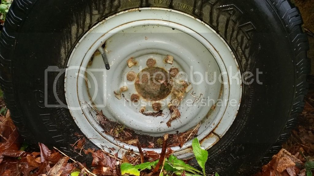

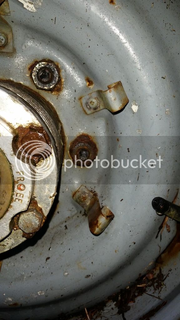

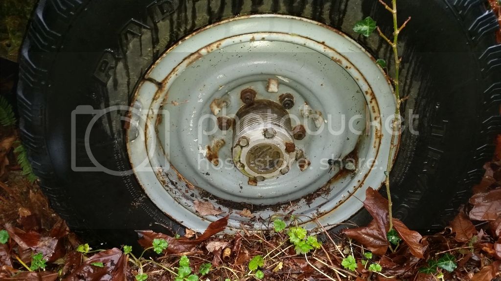

My 45 truck came with 16" splits(maybe from canada) with hub cap clips, they are on another 40 now but always assumed they took the 40 series caps, because why have the clips.....but I never tried putting a cap on
Only pic I hAve handy. Try to get one latter......
But some markets did get 16 splist and clips.

Never looked close till today.
So I won't promise these were not home made, I say thst because the clips are not welded or rivited, they are screwed on.
