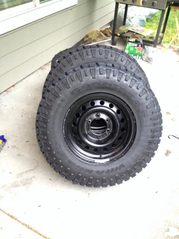

I now have my new 16" steel wheels & tires mounted and installed!!
Feels great to have straight and true rims. No more wobbly steering wheel.

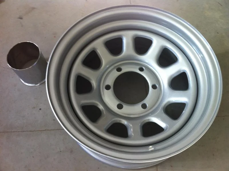

Finally!
Following 1967 TLC's lead, I ordered new 16's from Summit. I ordered raw steelies (PN: USW-84-7760LSPEC) w/ custom 3.5" backspacing and had them powder-coated grey. The grey is similar to what was on 80's IROC Camaros. Total cost w/ shipping was $432 to my door and $50 per wheel for the powder coating. The pics show my before (rusty chrome) and after, I couldn't be happier the way they turned out. Thanks to all who posted their info to help with my decision. :D

So last week I pulled the trigger on that first craigslist ad. 80$ for all four rims, $100 in gas down to portland and back, plus $10 for lunch. Only $190 for the rims I've been wanting since I bought my first cruiser back in 2010.
Now I'm waiting on spidertrax wheel spacers to show up and I'll have them mounted. Pictures to follow.
Also, I had heard that you can source these rims from discount tire. Well the one I went to couldn't. Showed up as out of stock. I do have to say though that the guys at my local discount tire are awesome. I've dealt with them twice now and each time they've been really helpful and saved me money. Four 235/85 Goodyear duratracs with warranty was $907 mounted and balanced, plus a got a $60 mail in rebate.
I'm a happy dude right now! :)
Little teaser picture for now. Hopefully the pic works from my iPhone.
