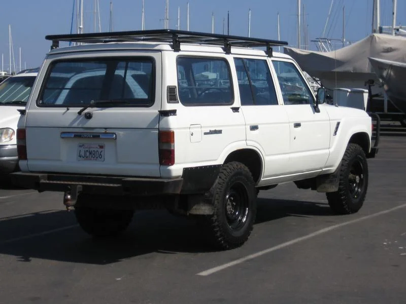

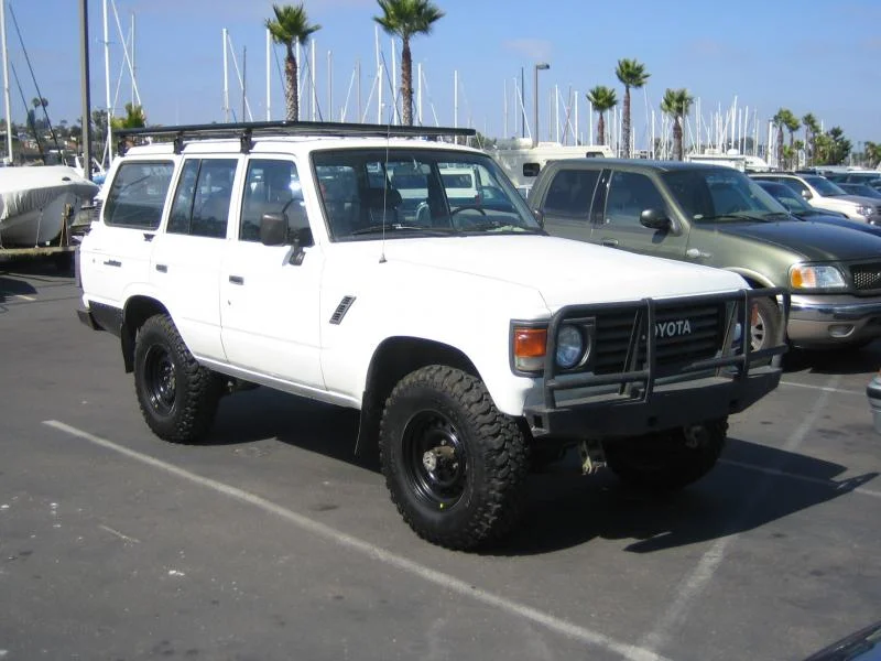

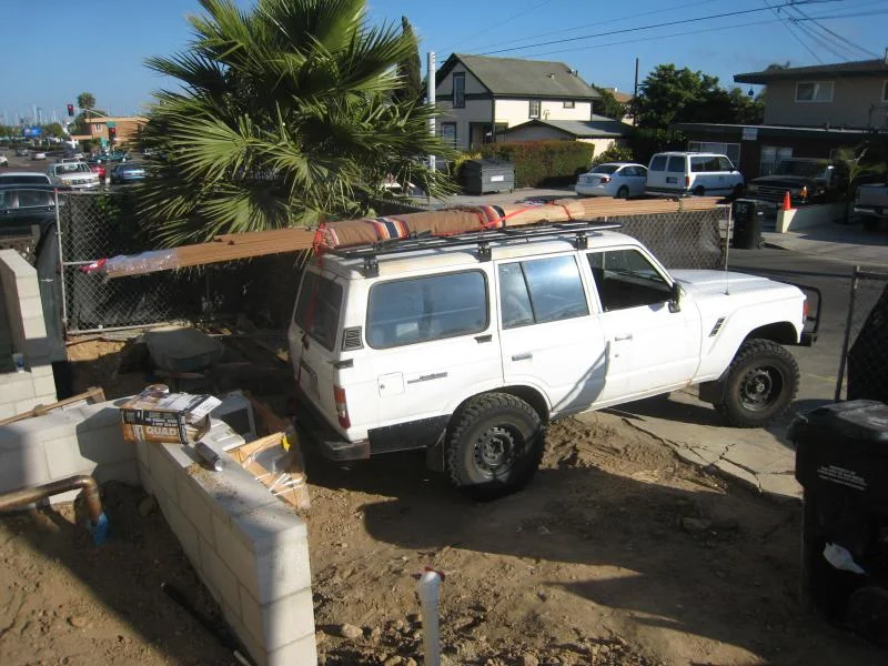

Here is are a few pics of toyota 16" rims without spacers, I think they are tundra take offs. They rubbed just slightly on the tre's with hammer on weights. One thing to remember is the up size in diameter helps the clearance issue. the tires are r16 255 85 BFG MT's. I added 1.5" spacers and then found some 70 series rims to run without spacers. The first picture is with the spacers and the second two are without.
