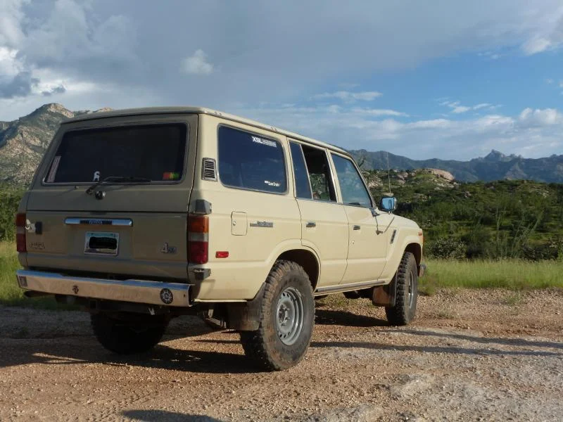

I installed 16 inch Tacoma Wheels last month - they look pretty good, no issues so far - other than minor rubbing on the front mud flap at full flex.
They are take offs from 2000-2004 4wd Tacomas. Back spacing is about 4.75 in.
Had to use 1.25 spacers. Mounted 5 Maaxis Bighorns 255/85-16.
I found 3 locally for 30 bucks each (CJ tire and wheel) , bought 2 over the phone for 50 bucks plus shipping (20 bucks) here:
http://www.andysautosport.com/toyot...ctory_wheels/capital_wheels/capt00231304.html
Considered powder coating but was pretty pricey so I just cleaned them up and painted with Rustoleum (Primer and Paint) dark machine grey. Easy to touch up later.
Cheers

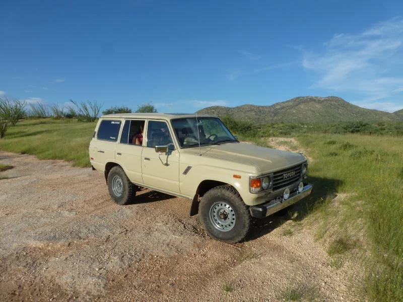

here's my 60. I just put this tire wheel combo on 2 weeks ago. The tires are BFG KM2 255/85x16 on Tacoma spare wheels that I sand blasted and painted. I got them at a wrecking yard for $25 each.
