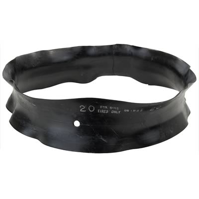

The tires on my FZJ75 and my FJ45 say “Tube Type”. I have read that you shouldn’t run radials with tubes as the sidewall is too thin and you could possibly get differential movement between the tire and the tube which could weaken the tire. I have also read that is total BS so apologies but I can’t answer your question definitively. Yes, you need rim liners to protect the tube from the rim.
Edit: apparently it’s the tube that’s in danger and not the tire.
Thanks @WarDamnEagle Can liners be reused? Or need a new set at tire change?
I don't know. I assume they can, if they are not worn, torn, etc., but I also think they are relatively cheap. I guess if I was buying new tires I would want new tubes so I'm thinking I would probably just go ahead and buy new liners.......but I'm not saying you have to.
Edit: You need to be aware that there are different valve stem orientations on tubes and liners so make sure you get the correct ones to match your rims. I'm not an expert on the subject but I think they are either centered in the rim (like the liner below) or they are offset. I would have to go look at my Troopy to know which one it takes.
In doing 5 minutes of poking around the internet, apparently there are radial tire tubes available. So maybe that’s the answer if you want to safely run radial tires with tubes.
