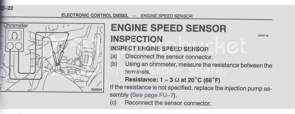

-Refer from EPC 99/08-01/08 15B FTE use pump P/N 22100-5C610. and 01/08 15b FTE use pump P/N 22100-5C700.I own newer 15B FTE repair manual that speed sensor is 1-3 ohm, but my old 15B FTE is measure 220 ohm, can you help me to chek your manual to comfrim the number ?
-also , is splil valve have polality ? cause I use newer 15B FTE cabel to old 15 B FTE, but cabel connector is not match to spill valve connector

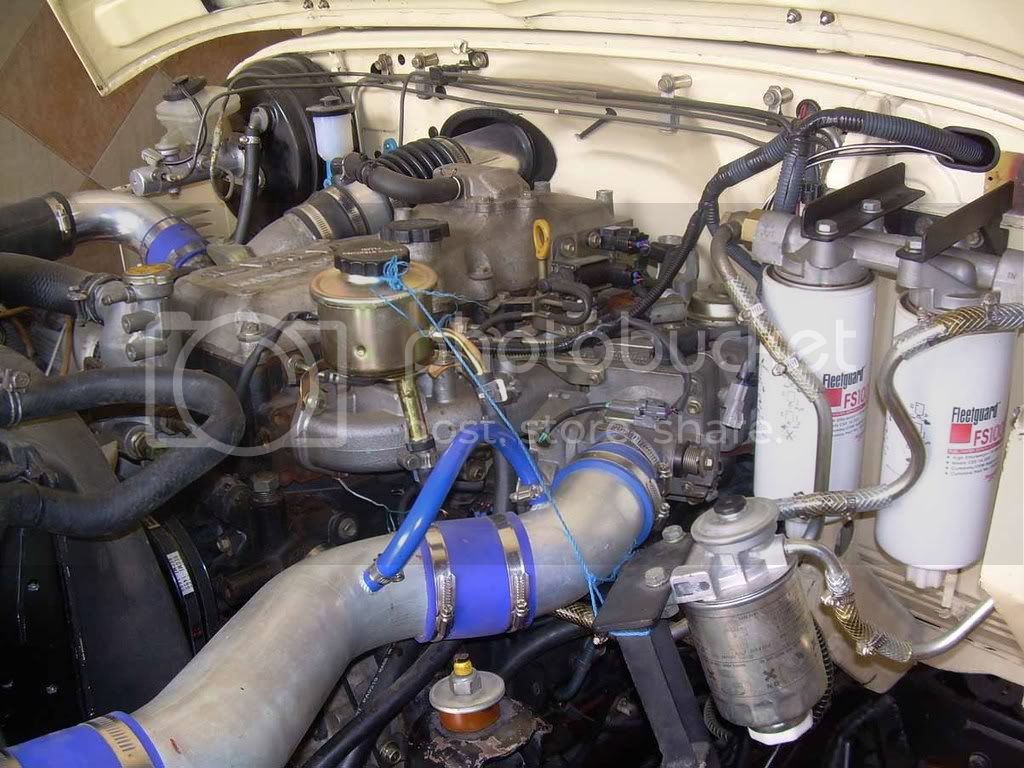

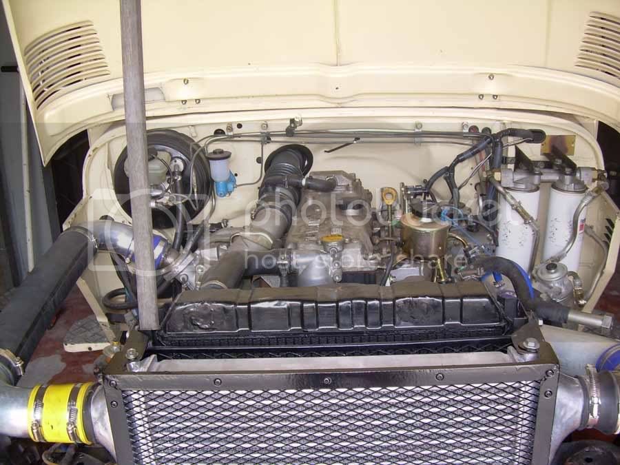

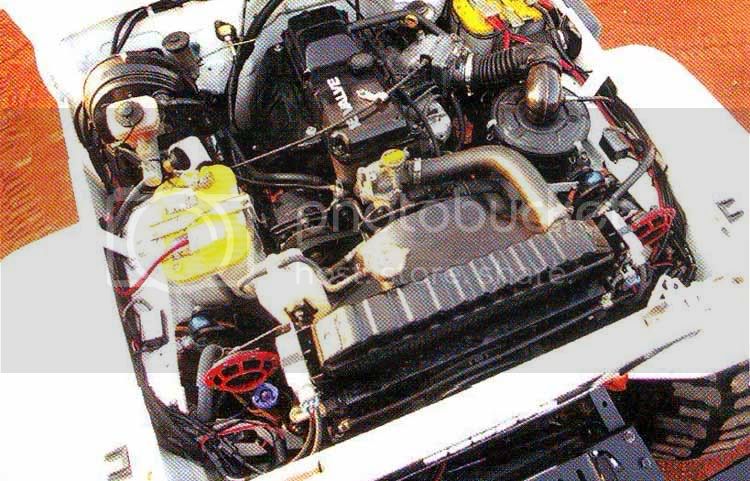

I see you posted a picture in another thread of a 15B-FTE fitted into a 40. Is that the project your talking about? If so, is there any chance you could post some more pictures up - im sure there would be quite a few people interested in seeing more of this toy!:smokin:

x2 on more pics of the 15B and where you sourced it.:cheers:

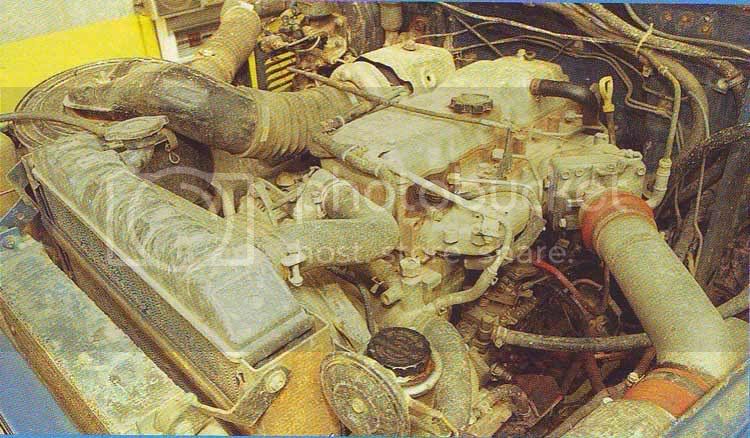

actualy, 15 B conversion is quite simple . use 13 or 14 B flywheel & use OEM B engine transmision & bellhousing( 4 or 5 speed ) , 4.11 diff & 35 inch tire. perfect fit & run like came from factory.

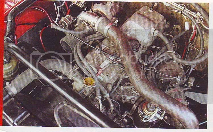

engine is so compact , even Hilux LN 106 use it.I have pic that 15B install at BJ or LN

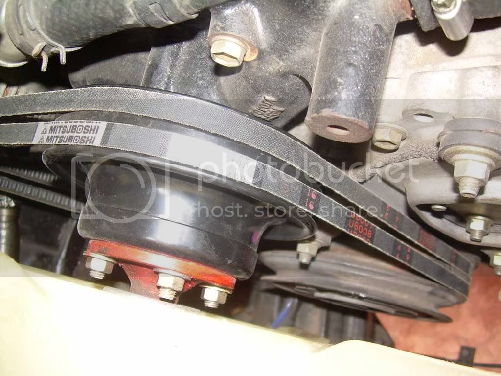

This engine is new from hino dealer , at 2003 it dump to my junk yard cause no want can use it, we canibal the powerstering pump & starter & fan belt pully.2005 I found complete Repair manual & EPC from Hino dealer, so I start to use this engine. New item is :Power stering pump, pulley fan, ECD ( ECU, driver injektor, all new conector ), 10 pcs oem oli filter, new OEM Toyota fuel filter used item : only starter is used, 5 speed transmition with bellhousing , TPO 2 speed gear box, used coaster wiring.OEM dinamo charge braket is low mount, I change with 15B braket , that hight mount. till this day never run.all item I want to sell it for 24.000 US$

do you have more pictures of a 15B-FT fited on a FJ40???
I have noticed that in some pics, they are using the FJ40/BJ40 OEM radiator. Is there any problem using it? Should´t we use the 15B-FT OEM radiator?
Onother question is about the chassi motor mounts, i think we need to realocate them, how?

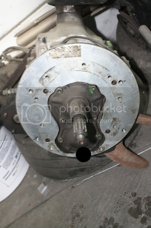

I purchase the original bellhousing because i wanted to use the original 15B-FT flywheel!
Since the original clutch disk haves 14 splines with 300mm diameter, and i will use the h55 (21 plines), i have found an ISUZU clutch disk with 300mm and 21 splines:
NW-2262 IZUZU
8-94462-789-2
8-94462-789-3
NIPPON CLUTCH CO LTD
unless the truck you got the bell housing from had the 2wd version of the h55 (h51?) that bellhousing probably won't mate up to a h55. apparently the h55 bellhousing behind the 3b and 13bt bolt straight up to the back of the 15bft. if the 15bft flywheel is bigger however you might not be able to use a bellhousing from a cruiser motor. also the isuzu input shaft might have a different diameter to the h55 one. if you haven't got the disc already i can get you the diameter of a dummy shaft at work tomorrow.
"There is a 2WD H55F .. ? I never saw it .. as same as H150 .. or H151"
just what i've heard, h50 or h51 rings a bell-obviously no x-fer case. the OD of the only dummy shaft i could find at work (isuzu dealership) that had 21 splines was 28mm. agian, whether the bigger clutch that you've got will fit a bellhousing from a 3b/13bt i wouldn't have a clue. would be great if you could but.
