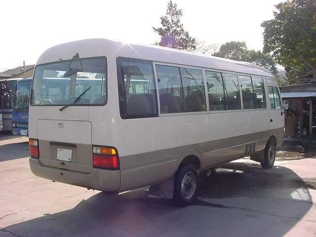

I've got this Toyota Coaster 4x4, it's a BB58, and it's got the 15B in it. Totally gutless in a bus this size. I know a bloke who got a later model BB58 with a 15B-FTE in it. Now that goes!!!!

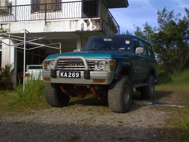

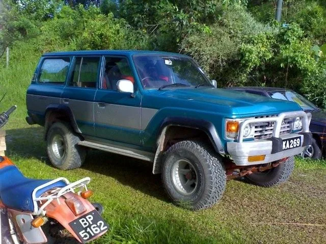

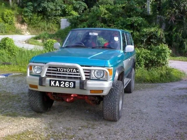

Hi guys, I recently bought an FJ60, original 2f has been swap out for a 15bf-t. It is mated to a 5 speed manual tranny. I believe this is the only 60 in my country with this setup as most of 60 owners here i have met have 1hd-t/fte in theirs.
Performance wise i can only relay through on the road seat of the pants experience. Acceleration is good for the 60 but wont catch another 60 with the 1hd-t/fte in them. Handling is great as the engine is smaller, weighs less and sits further back to the firewall that weight distribution contributes to the almost sports car handling when going on the blacktop. I will post up some pics of my 60 soon.
Hi Tapage, i am big fan of Tencha and Marilu. I also have an 80 with 1hd-t/A442F. I will take some pics of my 60 and 80 tomorrow to post up. Both are in pretty rough shape at the moment but hope to get them the way i want bit by bit as soon as funds permit.
