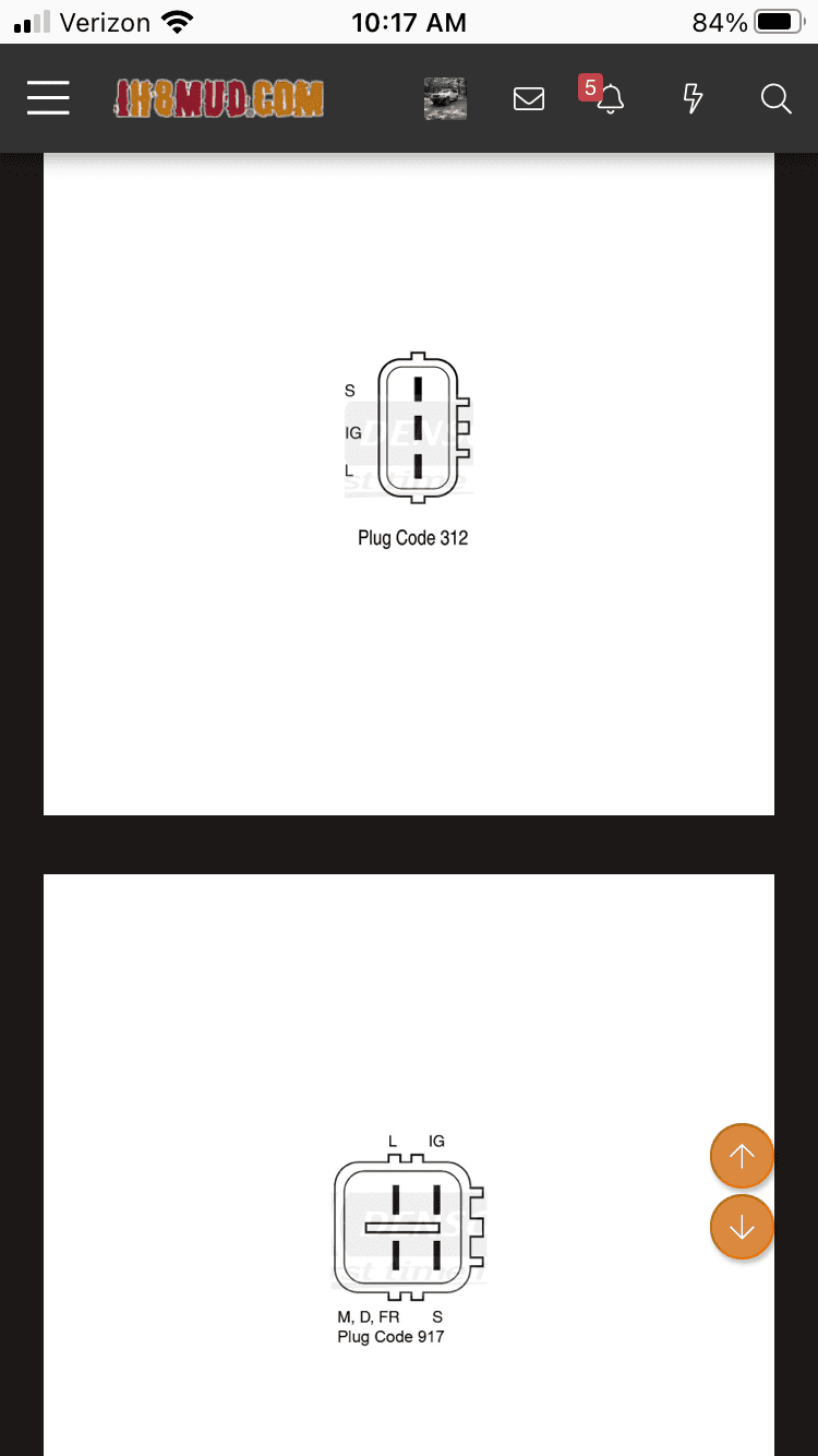

All you have to do is change the 100amp 3 pin to 4 pin of the 130-150amp alternator. You use the same battery terminal.

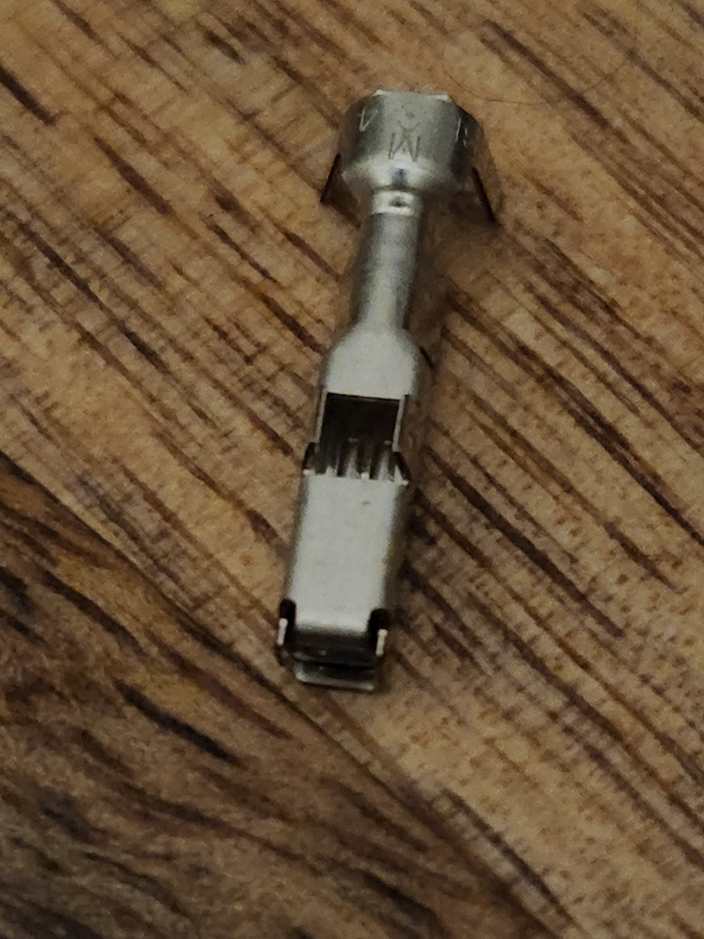

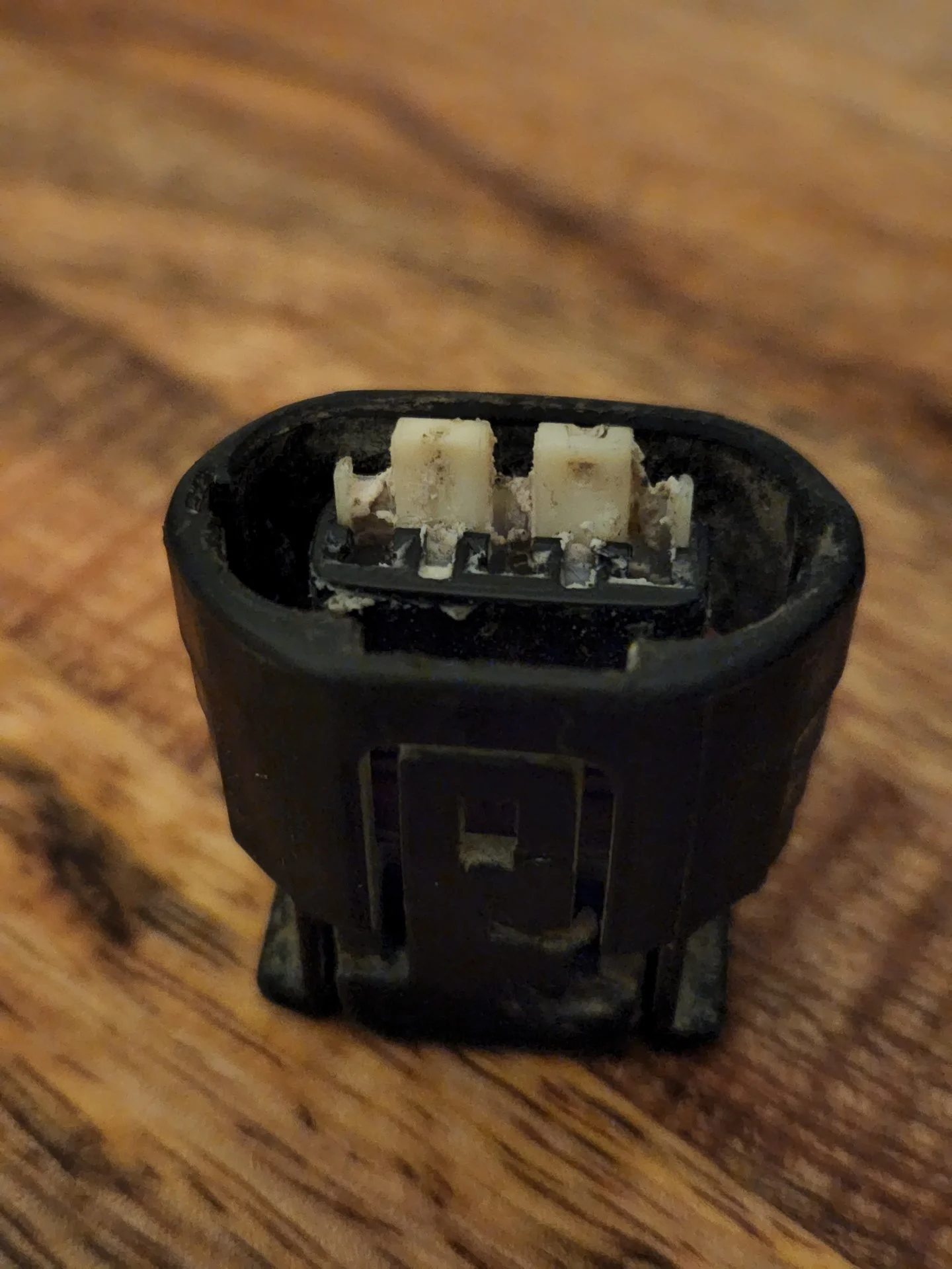

I did want to add a couple pictures to maybe help some folks with de-pinning the connector.
Note that there is a secondary retention mechanism that you slide out by prying in the little divot with a tiny screwdriver or something similar. Your pins won't release without unlatching this! It's pretty common on the Sumitomo/Toyota connectors that if there's a different color piece that it may be a secondary retention mechanism:
Once that piece is released, you can slide your pry device of choice (dedicated pin tool, tiny thin screwdriver, etc) along the face of the pin to release the little black plastic lever. If you completely remove the white piece you can see the little levers. You're prying it away from the pin to release it from these ears:

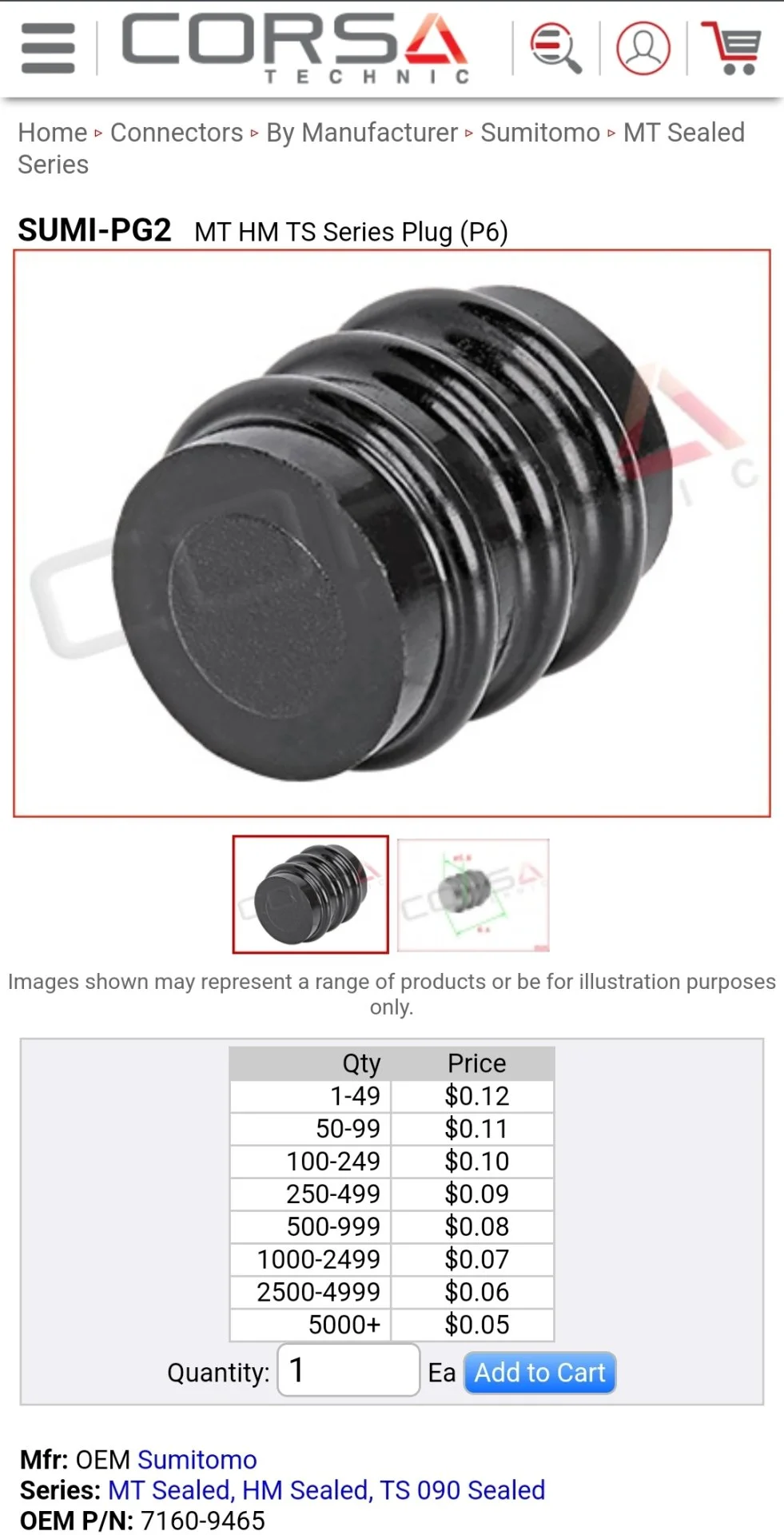

Also, Sumitomo does make plugs for unused holes for the TS 090 series connectors (for the extra pin location):

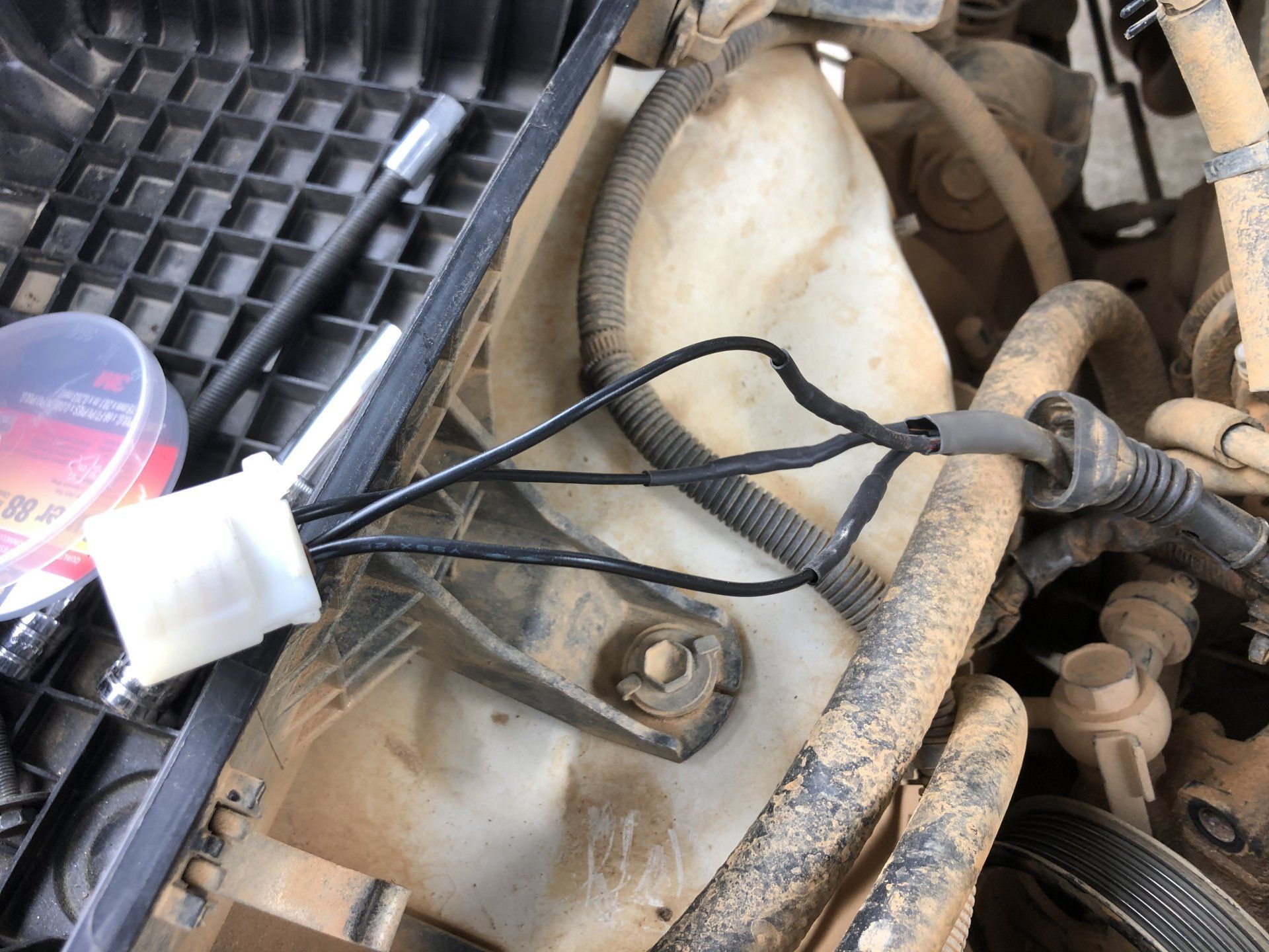

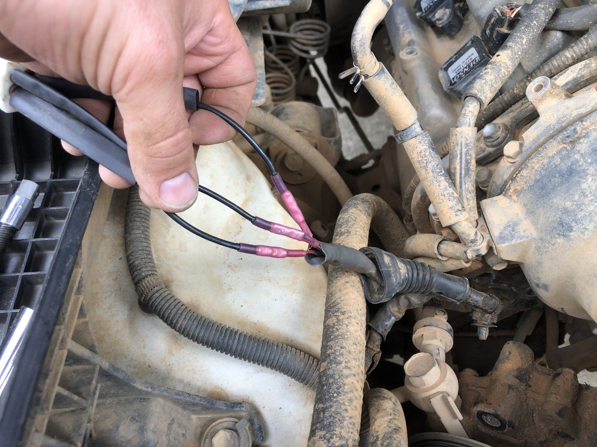

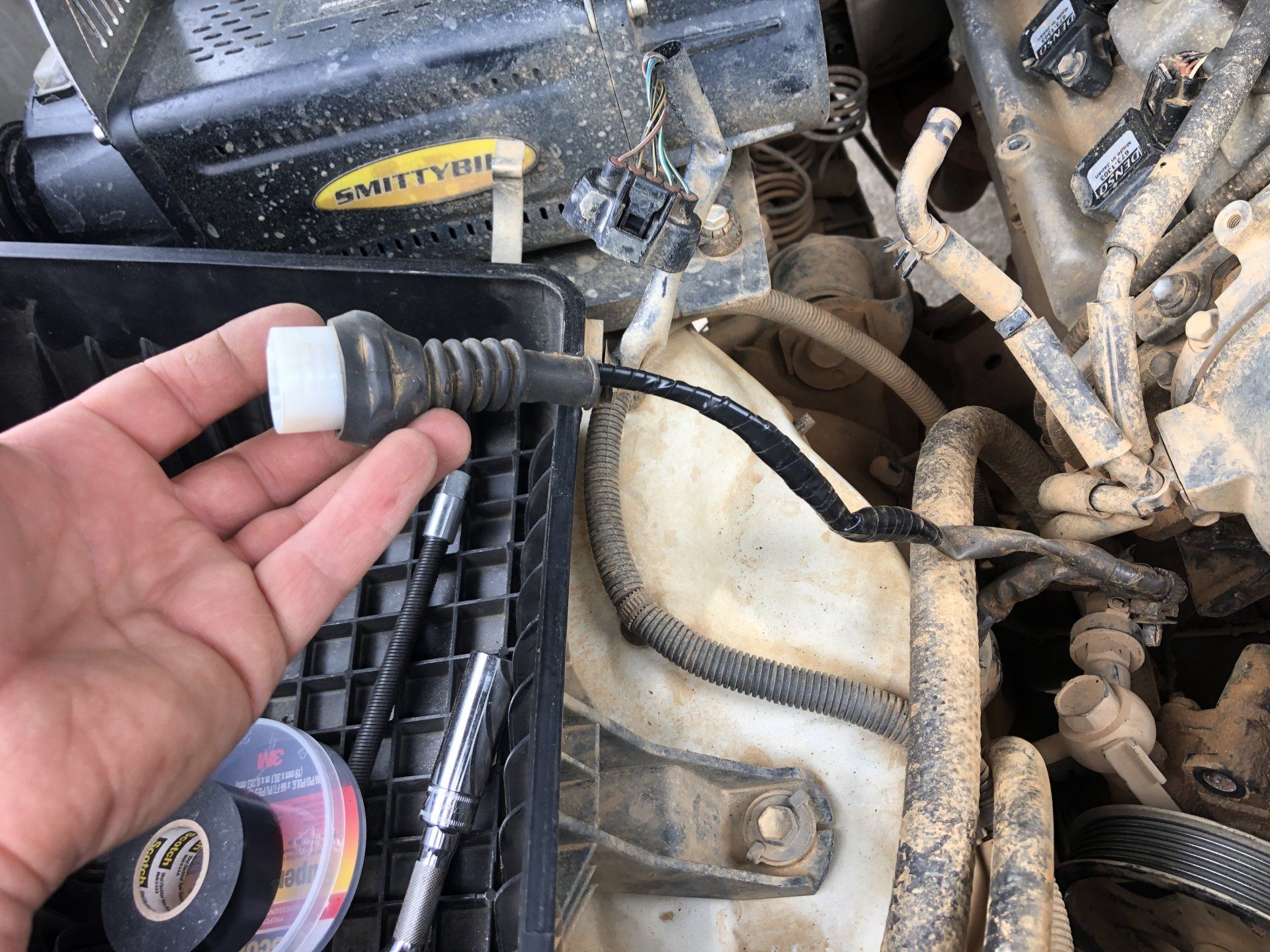

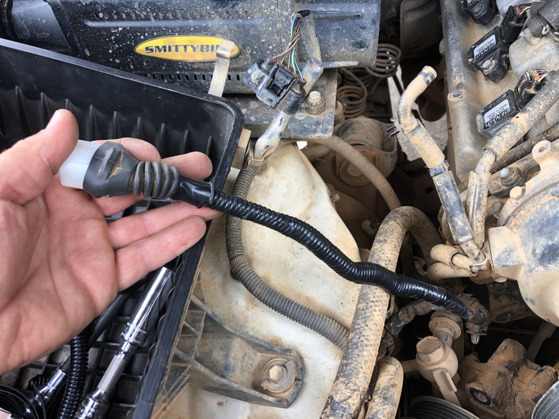

Next up wiring. I pulled the wires up into the engine bay and unwrapped the stock electrical tape. Then cut off the plug close to the connector so you don’t loose length but DO leave enough to be able to identify your wires. I then cut back the sheath the wires are in roughly 3/4-1 inch for working room. Then make your connections. You can solder but I just used butt connectors that double as heat shrink. I have no qualms using these vs solder whatsoever. I then heat shrunk again over those. I then fully taped over the wires and then placed them in split conduit. I then fully wrapped this again! You will see a place on the rubber boot where it’s designed to be taped over to hold it in place. Do it.
Note: The new pigtails are a larger gauge than the wires they connect to. They will not fit in the red 18-22g butt connectors. You will need to separate and cut roughly 1/3 of the strands.
Also: Don’t buy cheap tape, heat shrink, conduit, etc. it really makes a difference past about a year! Try to terminate all tape/heat shrink in such a way as to prevent water/oil intrusion. I’m not certain if this is the proper way but that’s how I do it. Pin out diagram provided by other Mudders. THANK YOU!!!

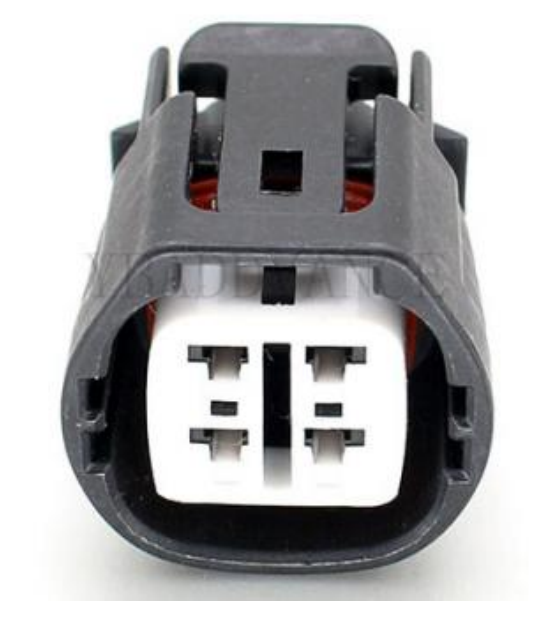

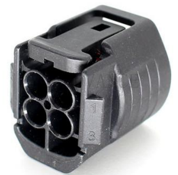

Bro, the 4 pin connector as @hoser mentioned is not specific to Toyo.... its the following part number from Female Sumitomo part number - 6189-0694 I am sure other OE manufactures will have similar part. Also look for my post if you are doing from 3 pin to 4 pin and how your wiring attaches to the 4 pin connector.
BTW to replace it.. the whole white face of the plug comes out and then you take the individual pins out one by one. I did the 3-4pin connector swap from under the car. Once you know how to take the pins out and how that works its pretty easy to swap it out.
