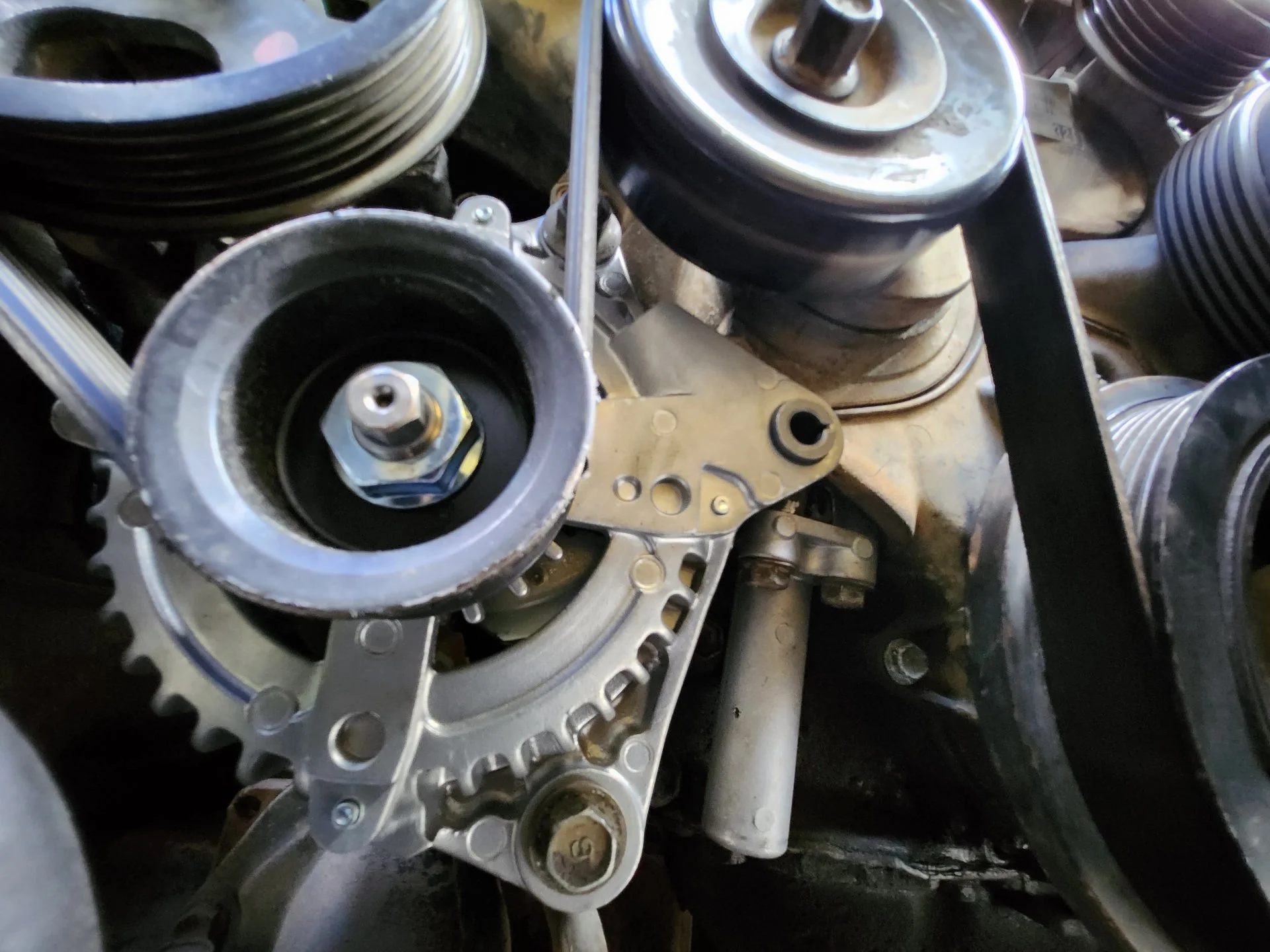

Next you’ll need to remove the third mounting tab. Tape the alternator well to prevent scratches and debris from cutting. Again tape it very well! Then cut, smooth and polish. It’s aluminum so it cuts very easy. A hacksaw and a file will do just fine if that all you got.
The 3rd mounting tab can stay without any issue. Picture proof...

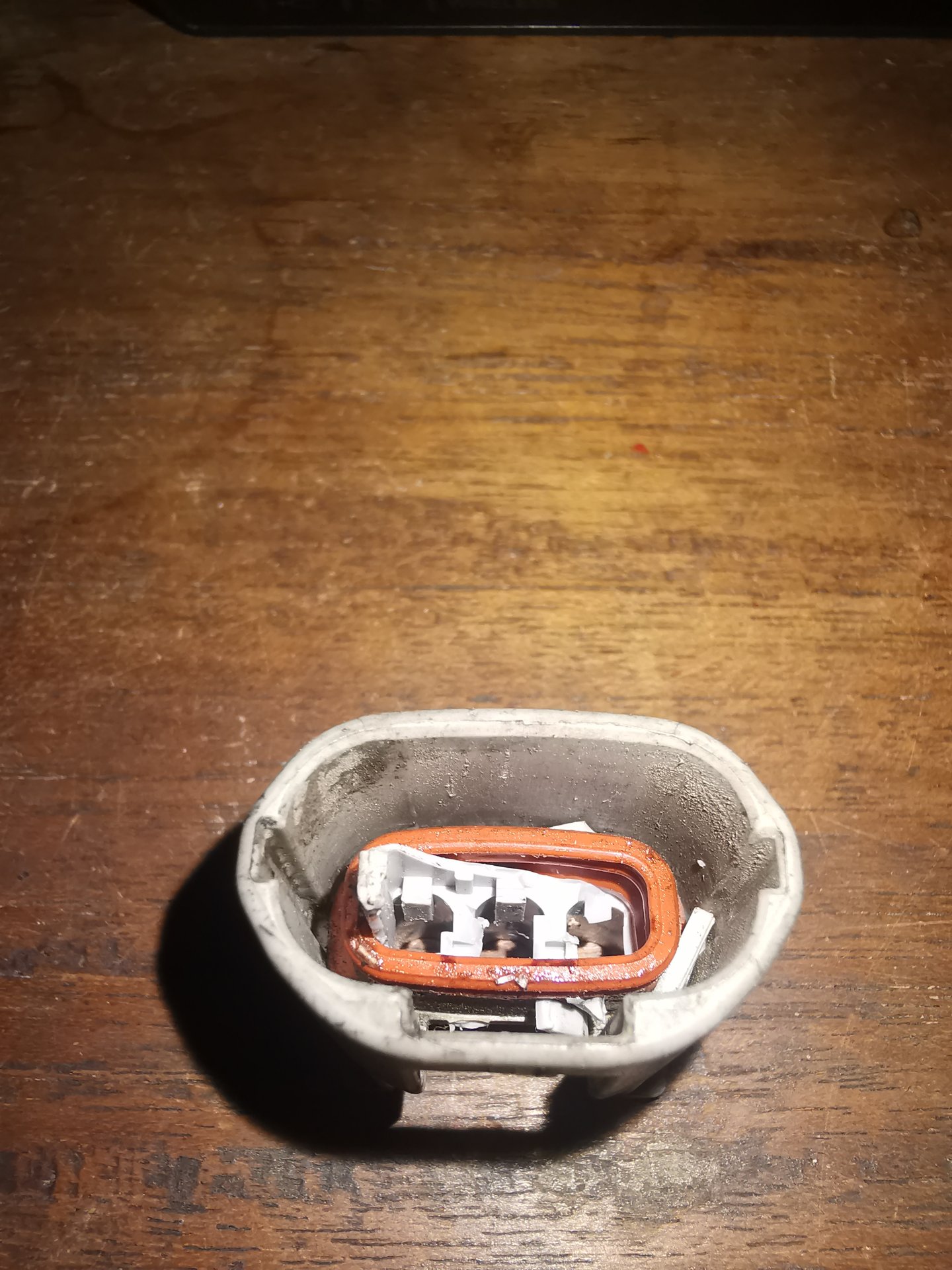

Ok good folks, mystery solved. The 19 years old female alternator connector crumbled on the inside while the external looked perfectly good! I pulled the 3 wires out and then individually heat shranked them, and gingerly stuck them into the male counterparts. Insulation taped them and will wait for another day to rewire with new connectors. I'm now getting 13.6A at the battery when engine running. 😅
So, please check your connector innards
condition carefully!

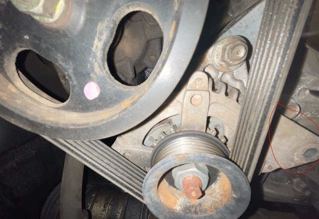

1. There are two threaded studs in post #1. The one on the right is for the charge cable. The one on the left is not normally present, I believe. Perhaps it came on an aftermarket alternator. It’s not needed for the 100.

BTW here's the pic of the installed alternator.. no alteration is needed on the alternator housing.. Just the 3-4 pin plug if you have a LC/LC from 1998-2002 maybe 2003.
