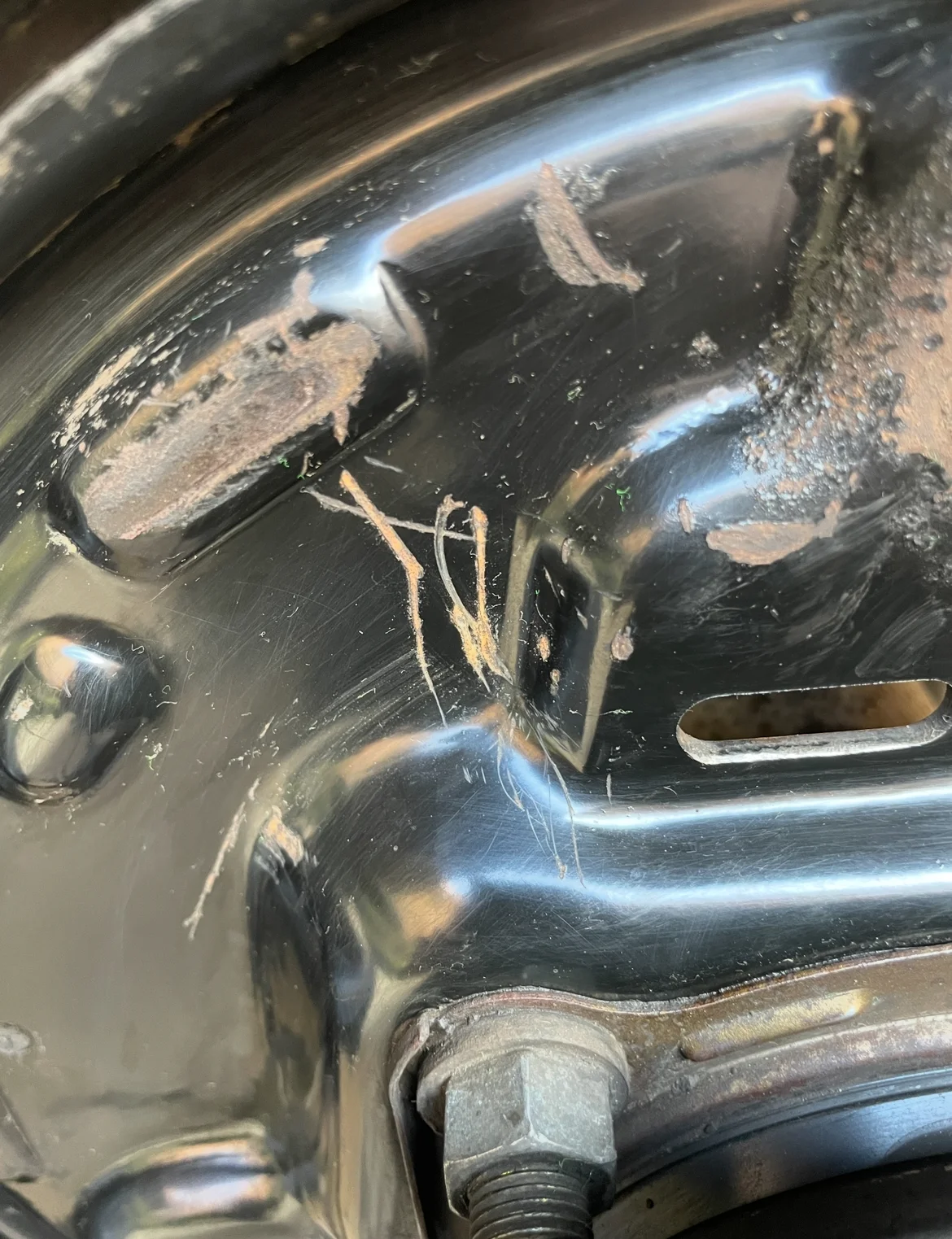

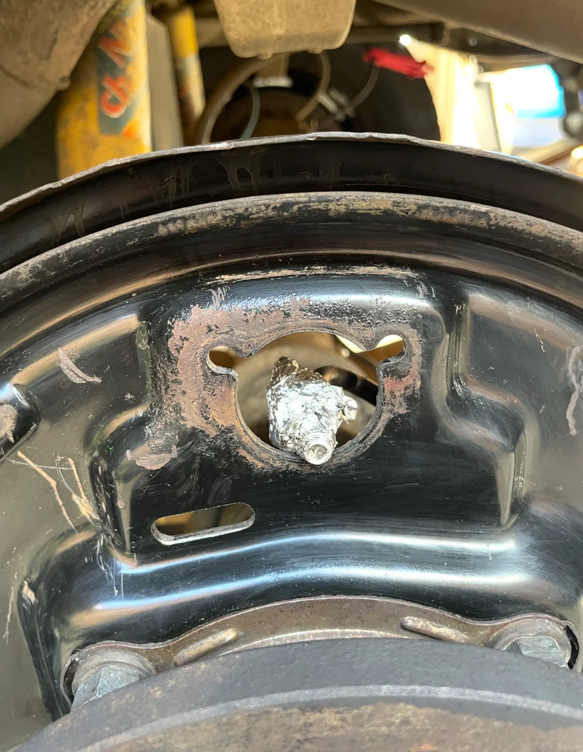

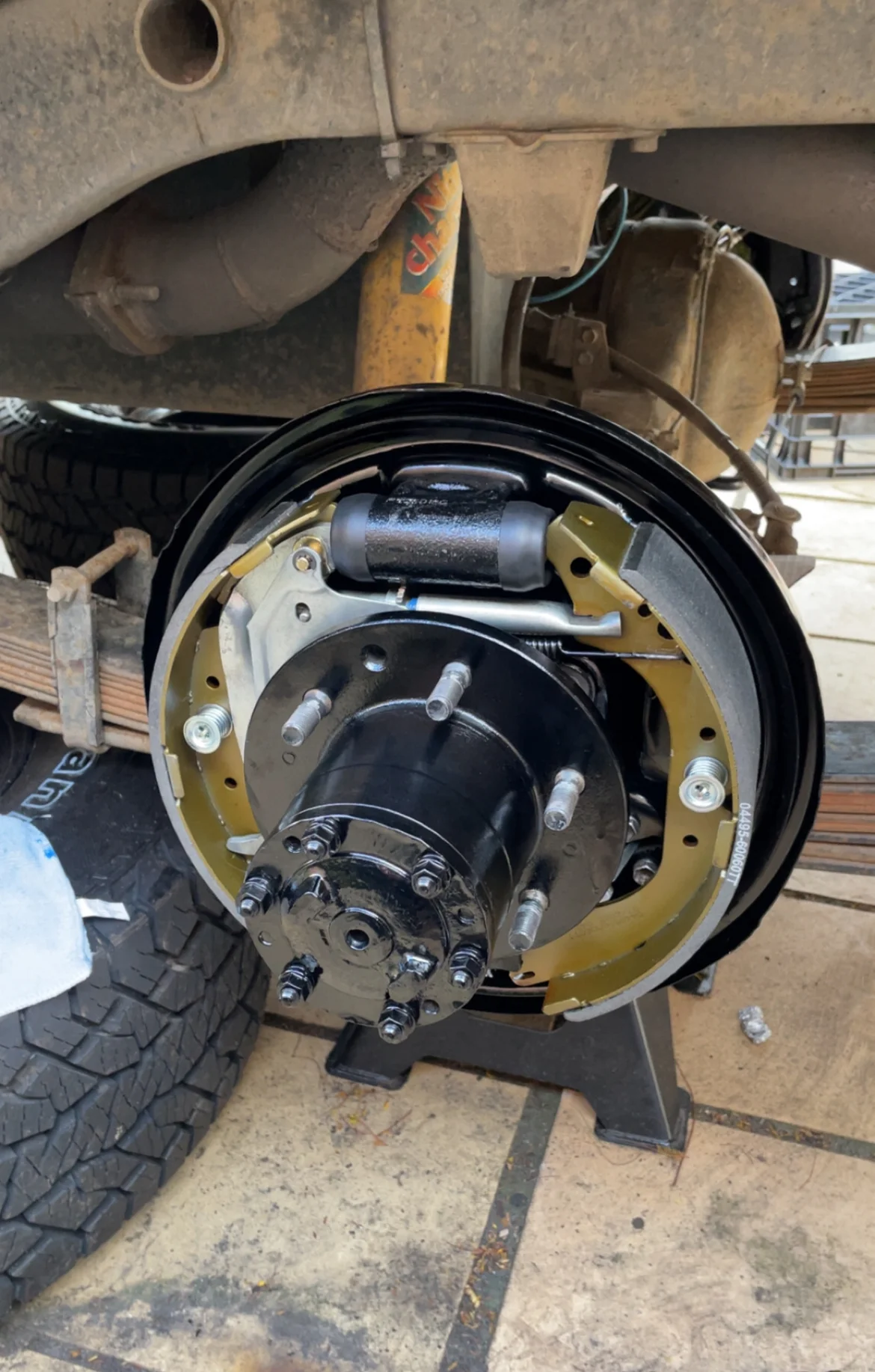

First major thing I’ve done was a rebuild of the rear brakes. Have never worked on drum brakes before, but I figured you have to start somewhere!
The backing plates were a bit rough, so I cleaned them up, treated the rust, and re-painted
Cleaned up the existing hardware where I could, and replaced anything that was too far gone, along with shoes and drums, with new stuff from Terrain Tamer.
Altogether an easier job than I was dreading, once I got the hang of it. The second side was much quicker than the first!
Also adjusted all the brake components per the FSM to make sure everything is working properly.

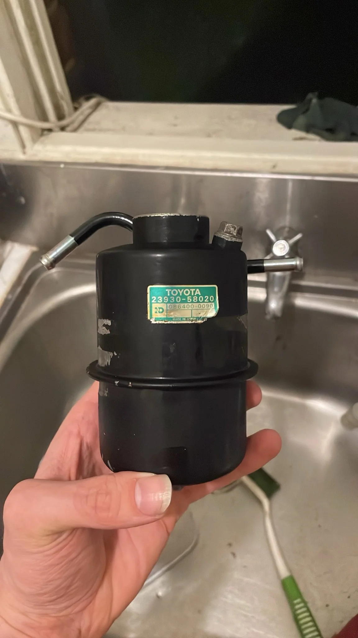

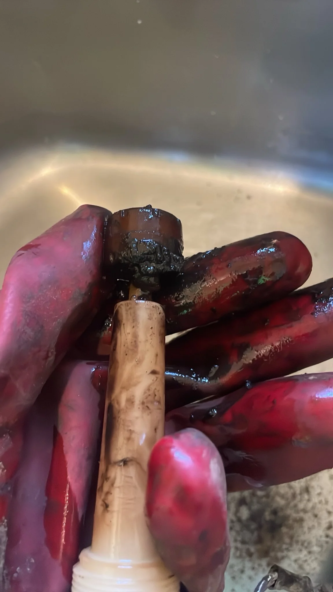

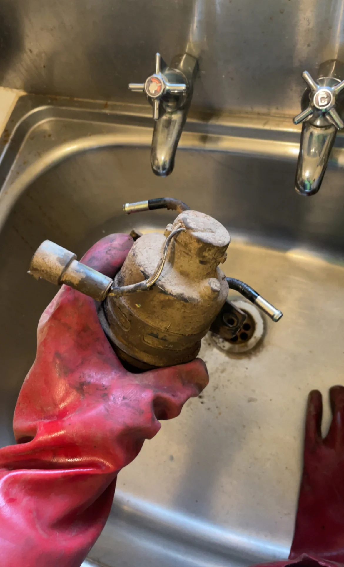

The sedimenter/water filter mounted on the frame rail is apparently often overlooked when servicing, and I’ve heard they can rust out completely. Rather than just draining it I wanted to take it off completely and make sure it was working properly (including the float sensor)
Plenty of people advocate mounting a second fuel filter inside the engine bay, but I appreciate the simplicity of Toyota’s design here and would rather restore OEM parts where possible.
It came off pretty easy - just 2 bolts and a bit of wiggling to get the fuel lines loose. Make sure you clamp these off properly or you’ll end up covered in diesel (whoops)
Pretty muddy on the outside (which we h8)…
But nothing that some elbow grease can’t fix. Still has the original sticker!
I’ll give the outside a quick coat of paint to make it look far shinier than anything else underneath the car

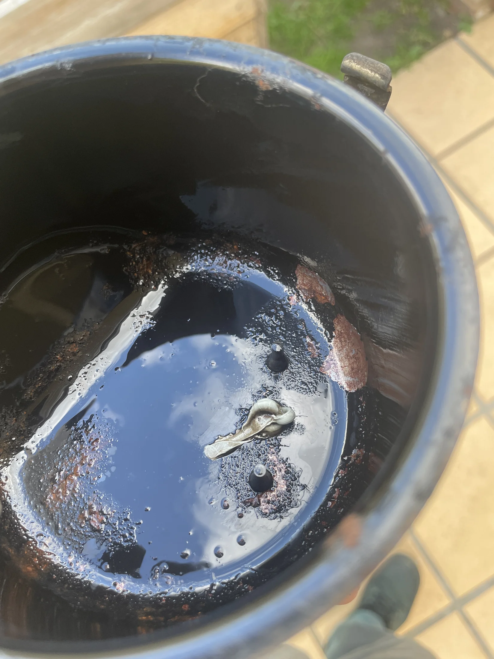

Inside had a lot of gunk, so I’m glad I’m giving it a proper clean. Don’t want that in my engine…
A quick multimeter test shows that the float is working correctly which is a good sign.
There is a bit of rust inside, but thankfully nothing serious. Going to treat that with evapo-rust, rinse it out with fresh diesel, re-install, prime the fuel pump, and should be good as new!
I’ve seen people mention that when you’re changing filters is a good time to use a fuel system conditioner/cleaner like liqui moly, but don’t have any experience with those sort of products. Is it worth it? If so, any tips or recommendations for what product to use?

Good to see your progress, I too have a HJ60 with a 12HT in it - an did the rear brakes last weekend. Be aware of the possibilitie that sometimes the rear brakes are over(self)adjusting quite often after a rebuild. It happened to years before on now again. A simple washer helps big time.
(Google over adjusting rear brakes 60 series.....) But of course - your one could be just fine... just feel your rear drums after a bit of driving without too hard braking....warm is ok but hot not. Just a hint over the ditch..

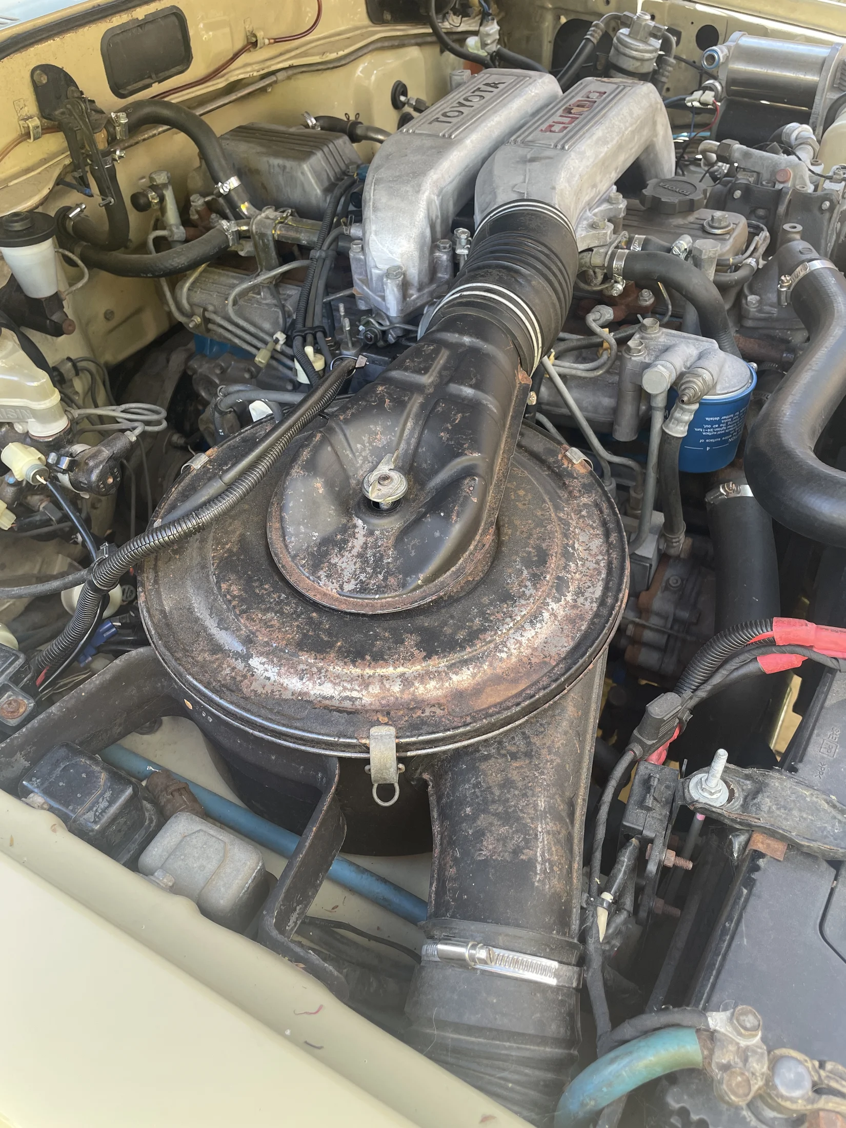

Waiting on some parts to get shipped over from Japan, so I figure while I'm waiting for things to put on the car, why not take some more things off the car.

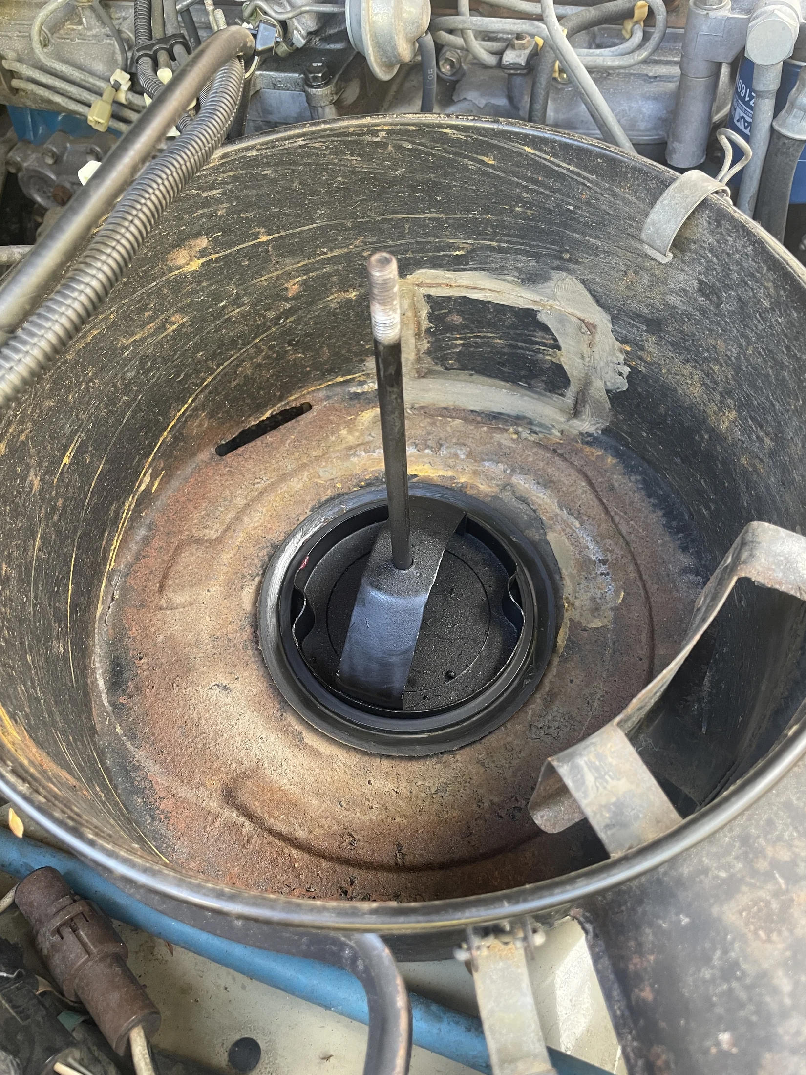

There's a bit of rust on the air filter cover so I figured I'd give it a clean and a new coat of paint.
Rust is worse on the inside, and it looks like the PO has already done a quick and dirty patch job

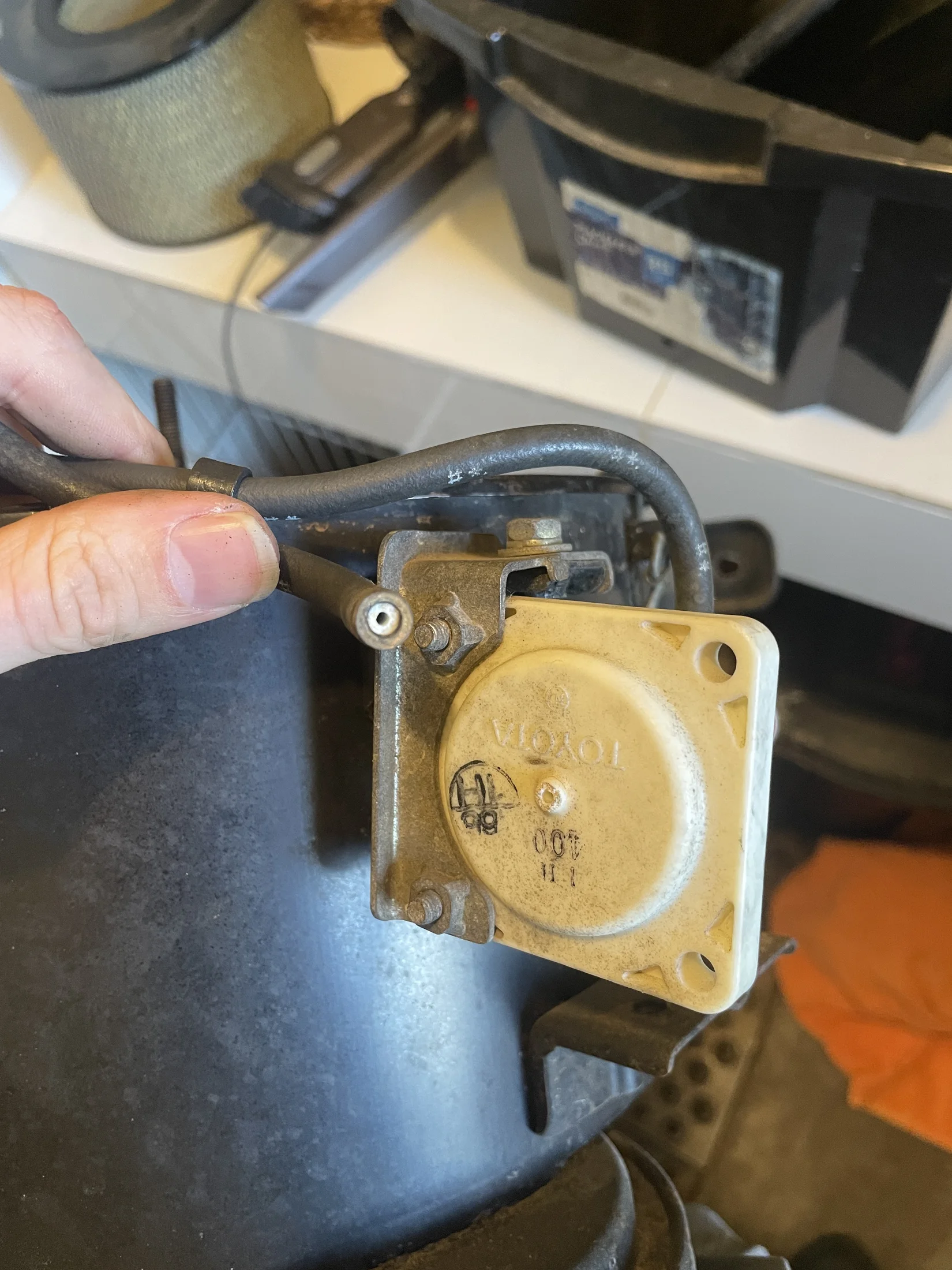

One of the vacuum lines to the air filter sensor is broken off. It's not really a vital part, and I could possibly repair it, but given that they're still available and not too expensive, I've ordered a new one.

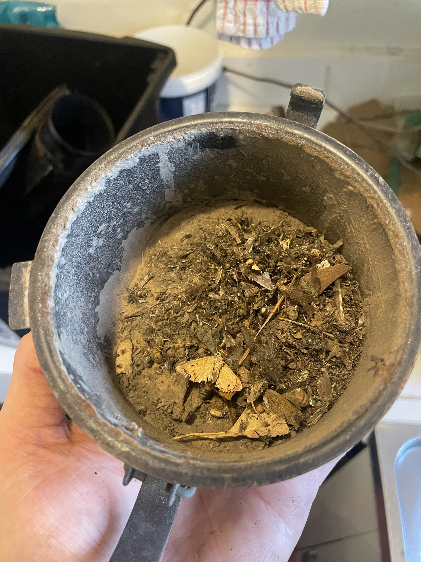

The air filter itself is pretty clean, but it wasn't until I took the whole box out that I realised there's an additional serviceable assembly mounted underneath it to collect larger debris. Given what I found inside, I'm betting the PO didn't know about this either...

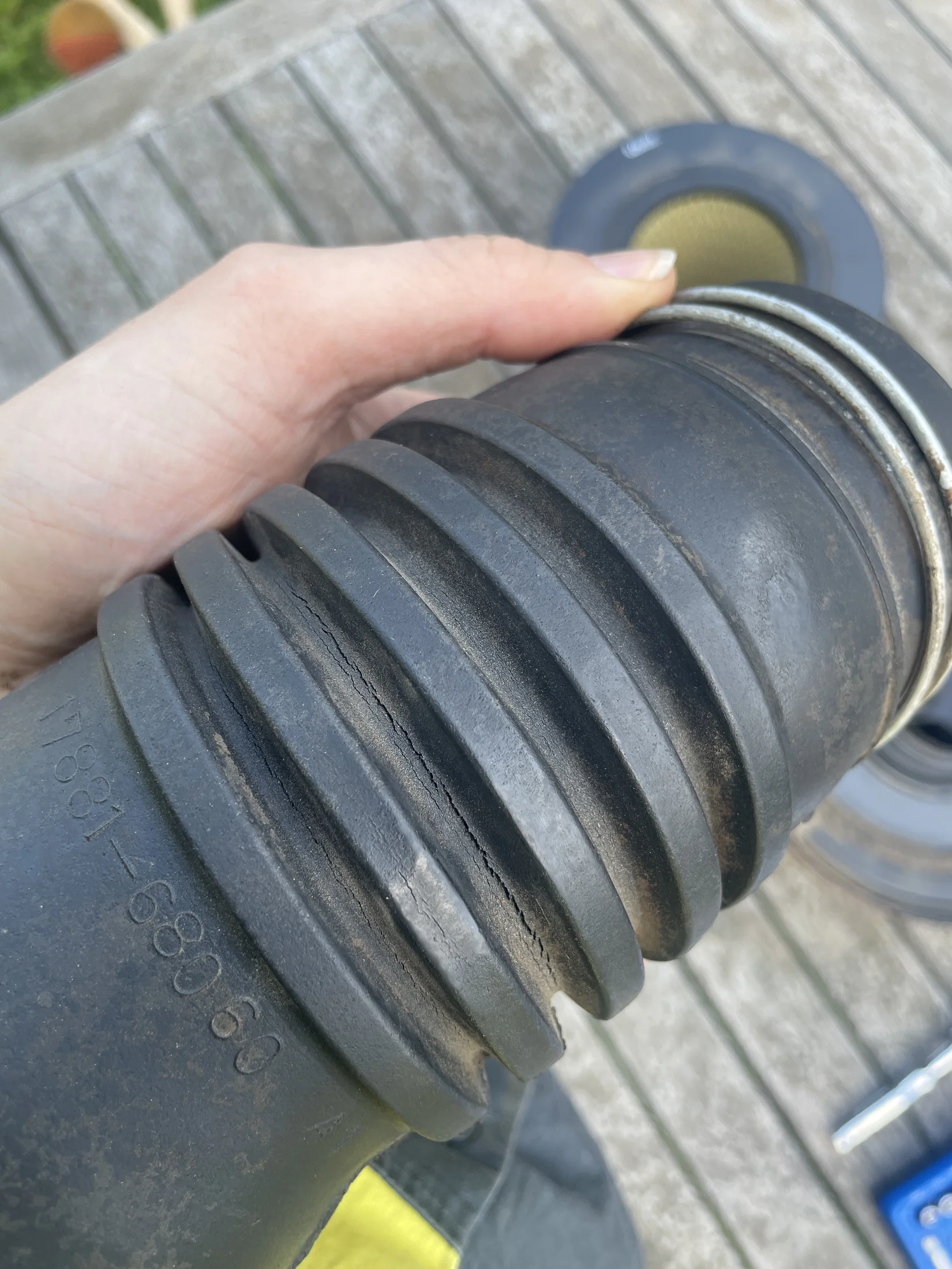

A final reason I'm glad I took this out is that I discovered that the flex hose going to the turbo intake crossover was starting to crack. Thankfully hasn't split completely yet, but a new OEM hose is on the way
After all of this I remembered that I still haven't picked up any rust treatment, which is why I took out the air box instead of re-installing the sedimenter in the first place :facepalm:

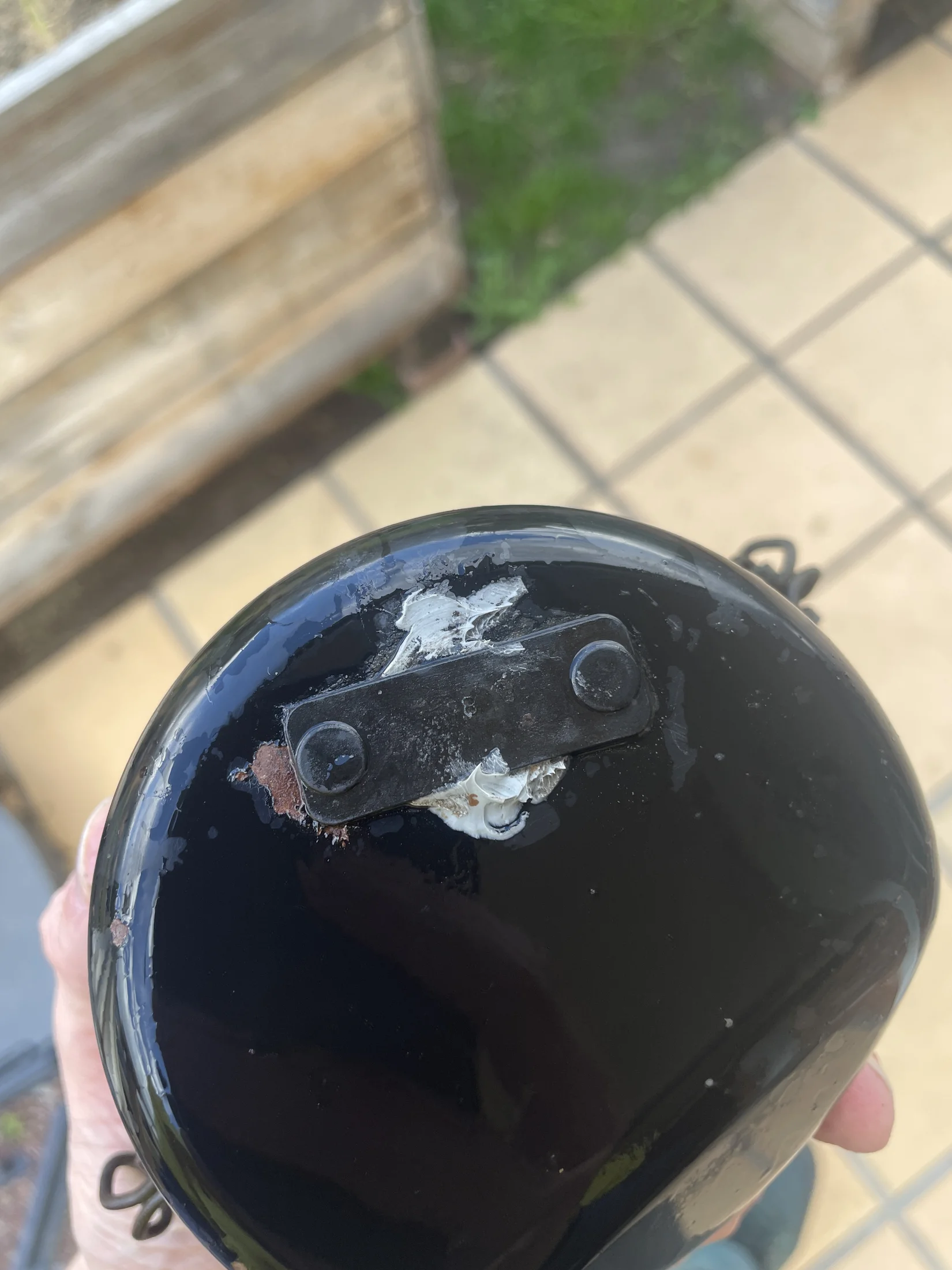

While I was cleaning that catch chamber I found this silicone mess and a little soft plastic tab
I’m assuming it’s a primitive ‘valve’ to allow water to drain? Is this silicone job the PO did a good ‘fix’ or should I clean it off?
