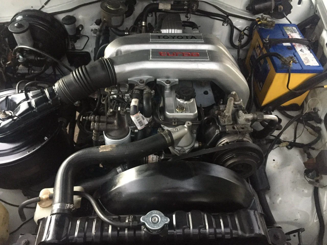

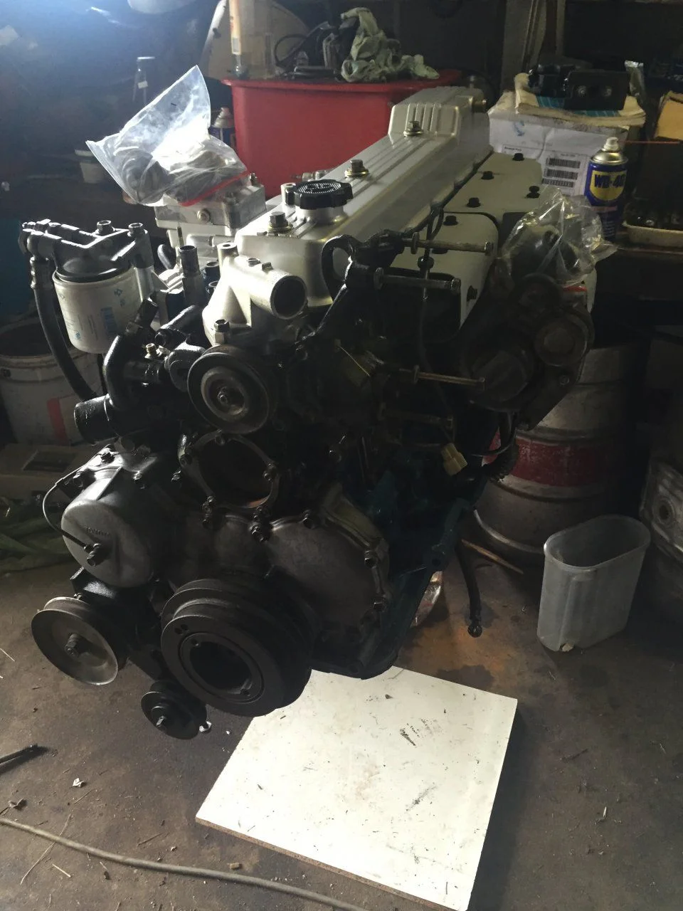

I was planing on spending the day removing the 2h from the hj75 but woke up to rain so I decided to finish the engine apart from water pump, thermostat, idler pulley, belts and hoses that are on the way. I wont fit these until the engine is mounted as I want to give the engine a good flush. The injectors and rocker cover will be torqued down once oil pressure and flow to the rocker gear is established.

That's sweet. Good work
The gasket surface where spotless after many hours labor with single side razor blade and yes I used a very light smear off sealant both sides on most gaskets.

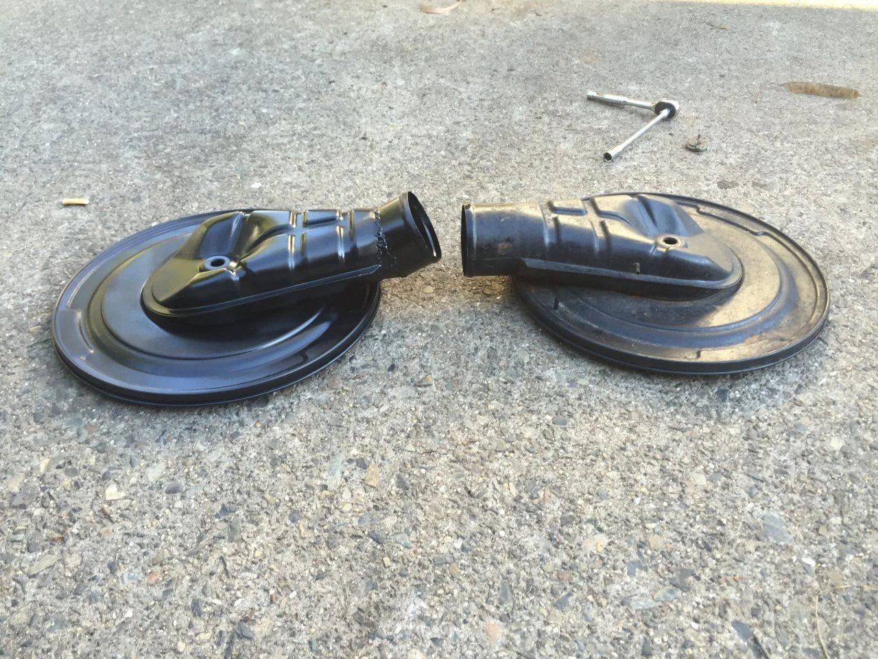

The air cleaner lid need some modification to try and get the intake boot at a better angle this is what we did.
All smiles now the truck passed the pit inspection and now has rego. :)
