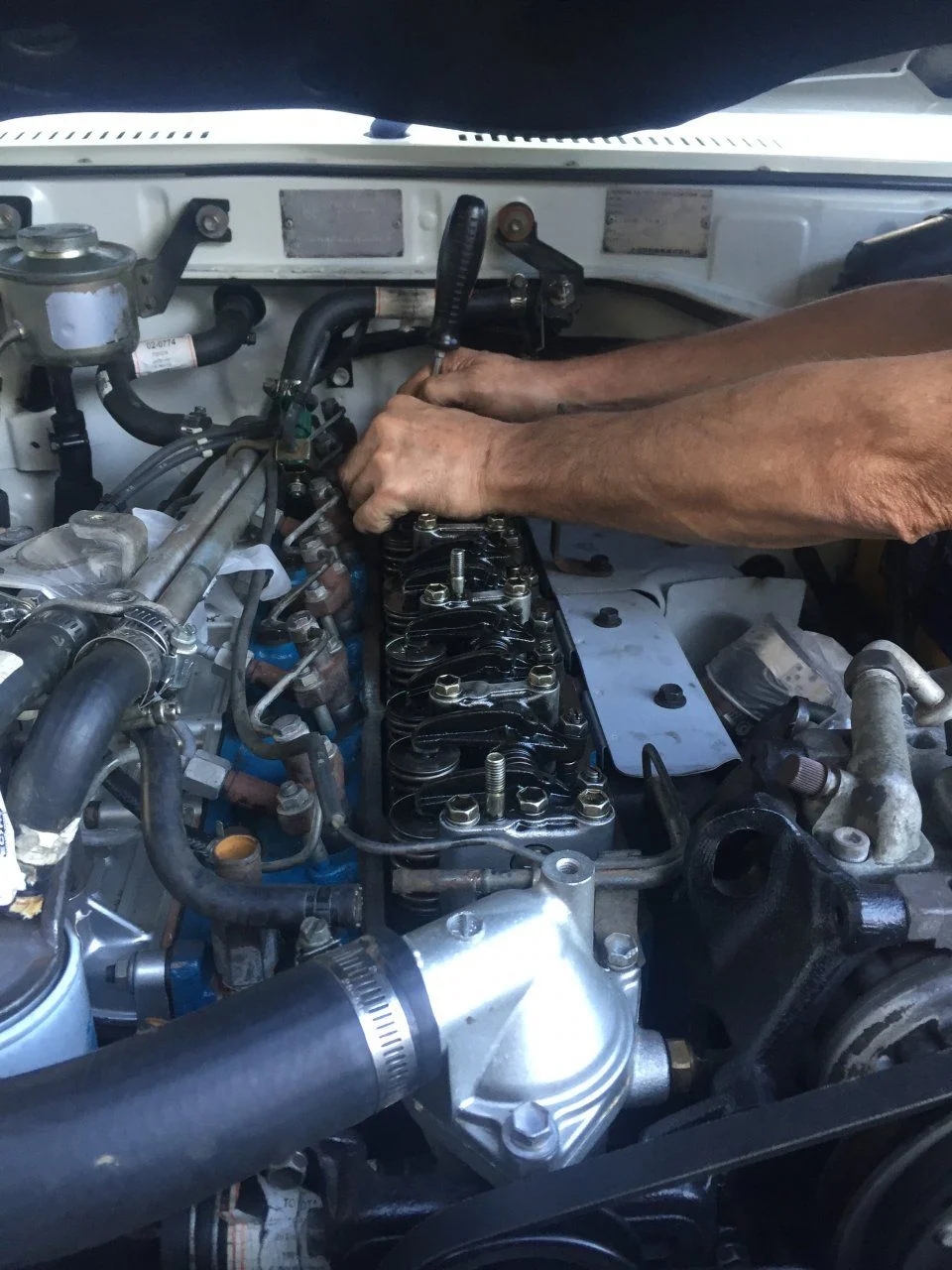

Re -torqued the head over the weekend after 2800 K and finely dumped the water from radiator to coolant. She should be good for another 500.000 hopefully.
Edit
After cracking each stud half a turn then swinging back to where started with the breaker bar each stud went with the torque wrench 1/4 to half turn to re-torque to 83 ft/lbs.
Hope this helps. :)

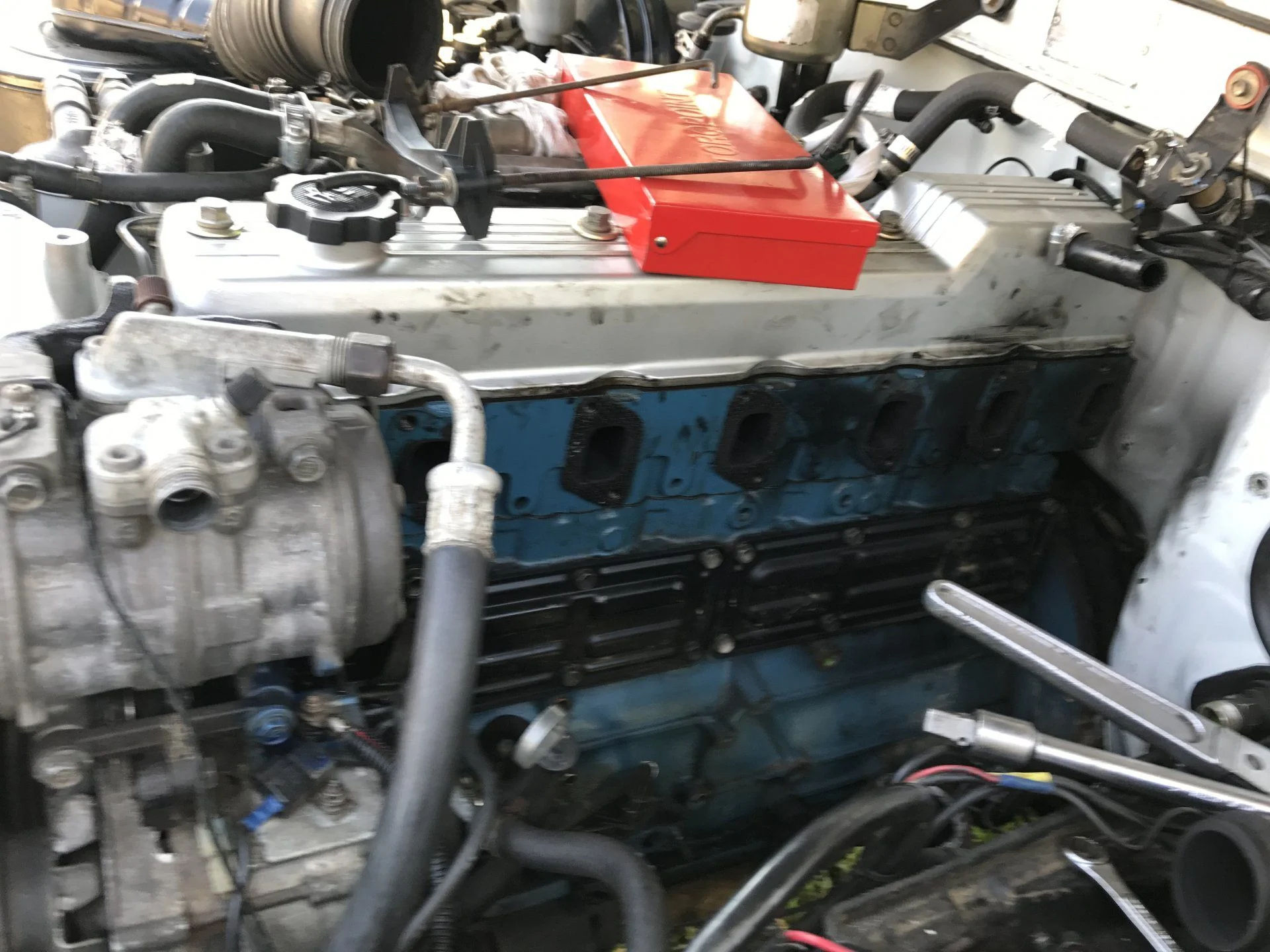

1 1/2 years 18000 K she blew number 4 manifold exhaust gasket out big job removing turbo and manifold in the hj75 lost plenty of skin in the process but it's out. This time around going to use Toyota multi layer gaskets not cheap but well worth the cost.
The factory mls gaskets are the best, can be reused again even after 500k

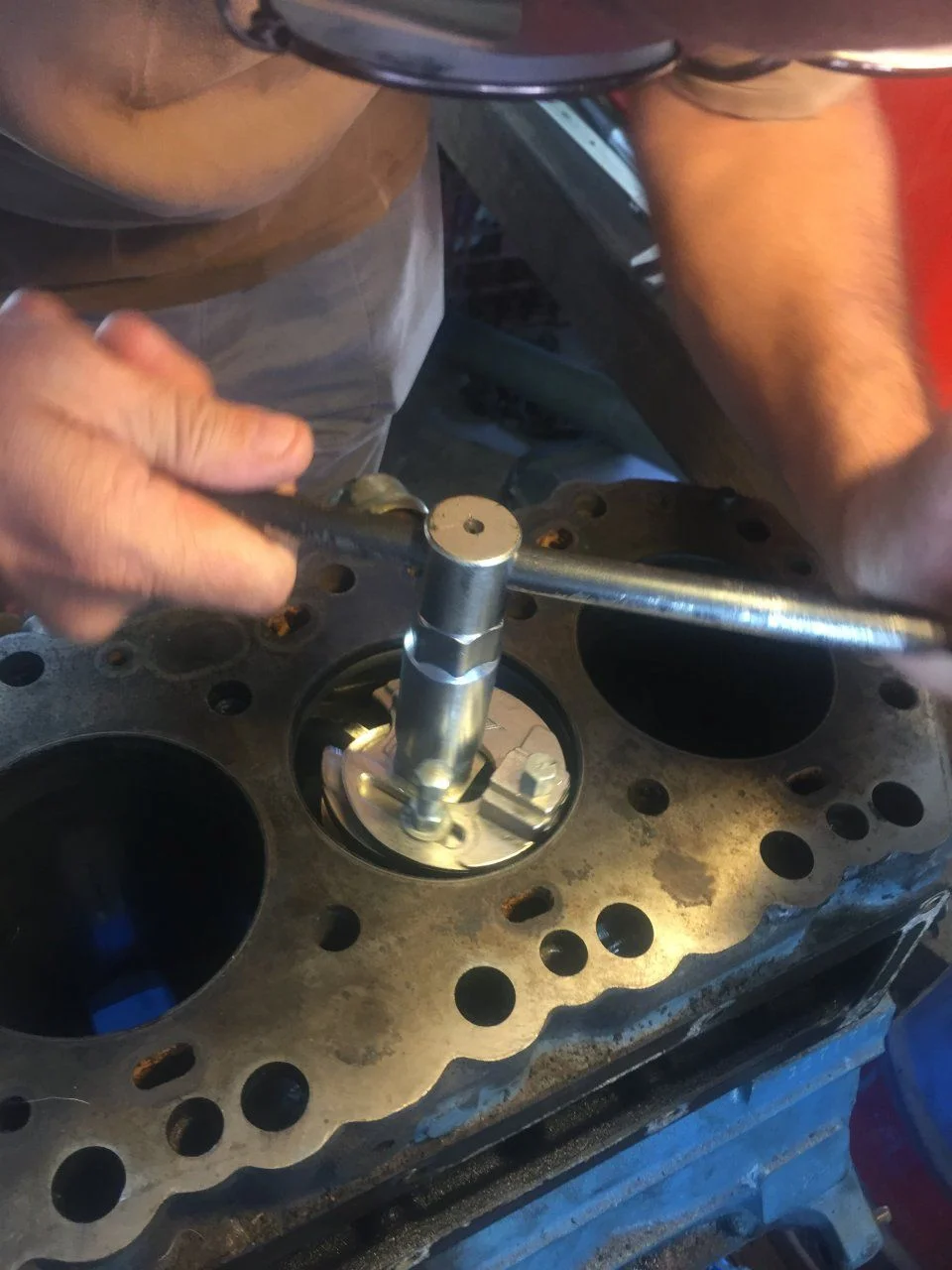

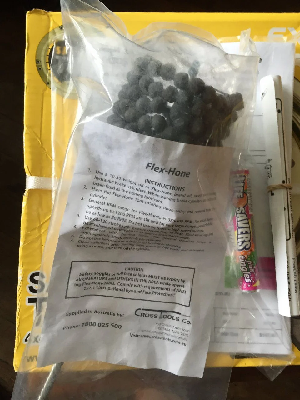

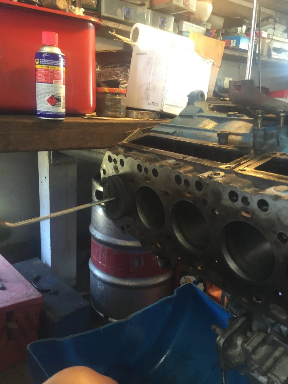

This is the flex hone where going to run through the cylinders for the 45 cross hatch needed for new piston rings.
I've looked through your thread several times as a reference for my own 12HT rebuild... first time I noticed the magic ingredient for honing..... The Fruit Tingles - Life Savers... Ironically placed where that equipment will/could save your engine... Funny stuff bub.

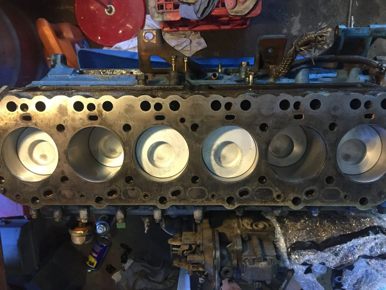

Does anyone happen to know where to order the above mentioned MLS head gasket? I am in the process of wrapping up a full rebuild (rebuild kit from Engine Australia with 0.5 OS pistons, rebuilt injectors, IP, and turbo) and my piston protrusion is .84mm and the Engine Australia max is .64mm. I am looking for a thicker head gasket to compensate for the additional height.
