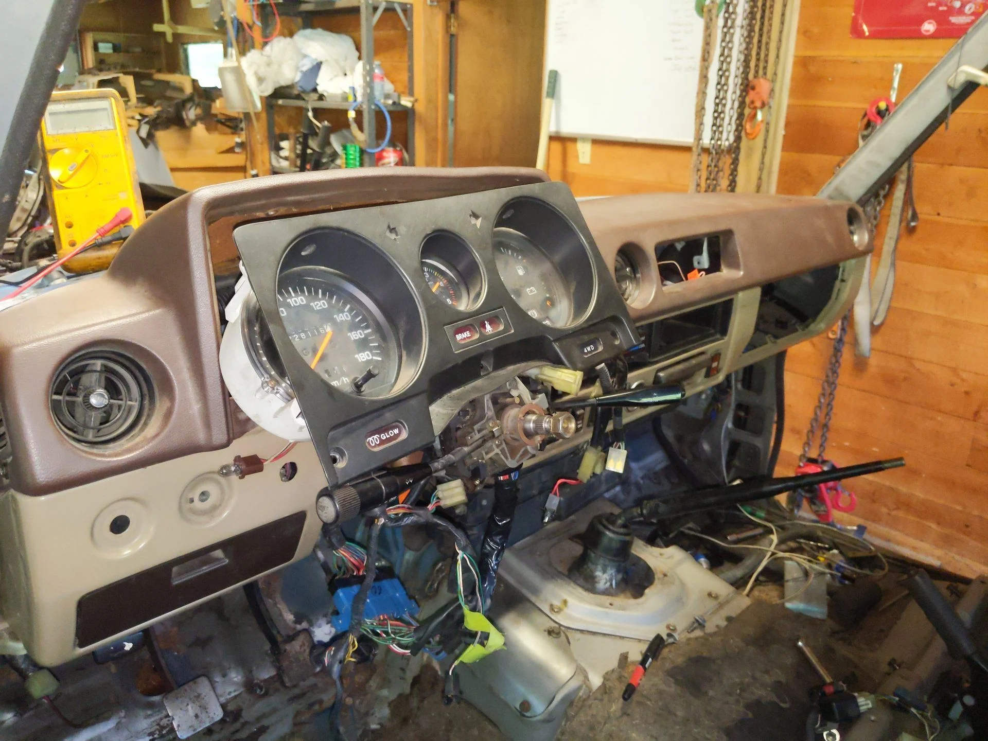

Interesting with the gauges, I think these are unhanded when the installer gets them, and he breaks off the tab that isn't needed depending on which hand drive it ends up.
OkdnMl4jua25eCPVo3a4FYteA8FwbR-ssM_dpiHAi0jd_qEvSrRK0nIc70OWkeZf4uvDktz-pa68pV5HN8FoeMCgF_Ci8HumoxWAHg9E9ZZLWgZ-HM_MCszAJX8WzYhAOXVo5XpAGcks4E_k9E_VCLuGj1OOlkH3whcWemJfAD5Wco24PzI4dJhDlZ2lHnYcHMHOv5ohiBLBihN5IhvqsdV_Lvu2SNXi-oGi69BSKyq8OCpnGs205K64uy304hhmu5wxyWWAwWJ-SH7B280MFkz_KJk8Os0BjPHb75oK4dboYcxkYbQMrDeEbpmdcGFF70RQ2bqoXg4Hs4rY_-uWEwnJJuc9ViUWpnNoPukJF6WMckqjj-GWzhxbgQh4JdxDwyfKtW3SXn9EN1sEKExMFYmTHm6Koa7QQu6mJh6rNDKW3cZRReKr2E7puNMvOuaNNw_YNfBoMovITTnsYa8_1InqkpFNP_y5l09B3rzVBksy_ZrIWffvkLmAH2YJjUR0-pj3D5upRzpu54XgP_SvAeIs3VJUdSuQIKDBQokmSVEi2KlfujrlQUnjfIX5wMzWnU7GPFk6oelo9RLyzgl_yvVMBt1AiMjNehz0JqlekStUOVg3MyUuqpQNfDlPup1_bRTozxYzDv5jky0-BuvdE8Z7P0Q2HSy6Bw8Pb5Std9zOLz4DpUm6r1wxi-33PQ=w834-h625-no
Had thought I'd have to break off the other one and then glue it somehow to hold the top in, but swapping sides works. Even when going from new dash style to old style it all fits.
Reasonably sure everything will still reach, speedo cable would be the only question, with a flipped harness, the way it was on the other side the speedo was in the outboard pod, so the wiring will be the right length.
I don't think the speedo being on the left will bother me, might bother some.
I'm sure swmbo will mention it when she eventually drives it. :lol:

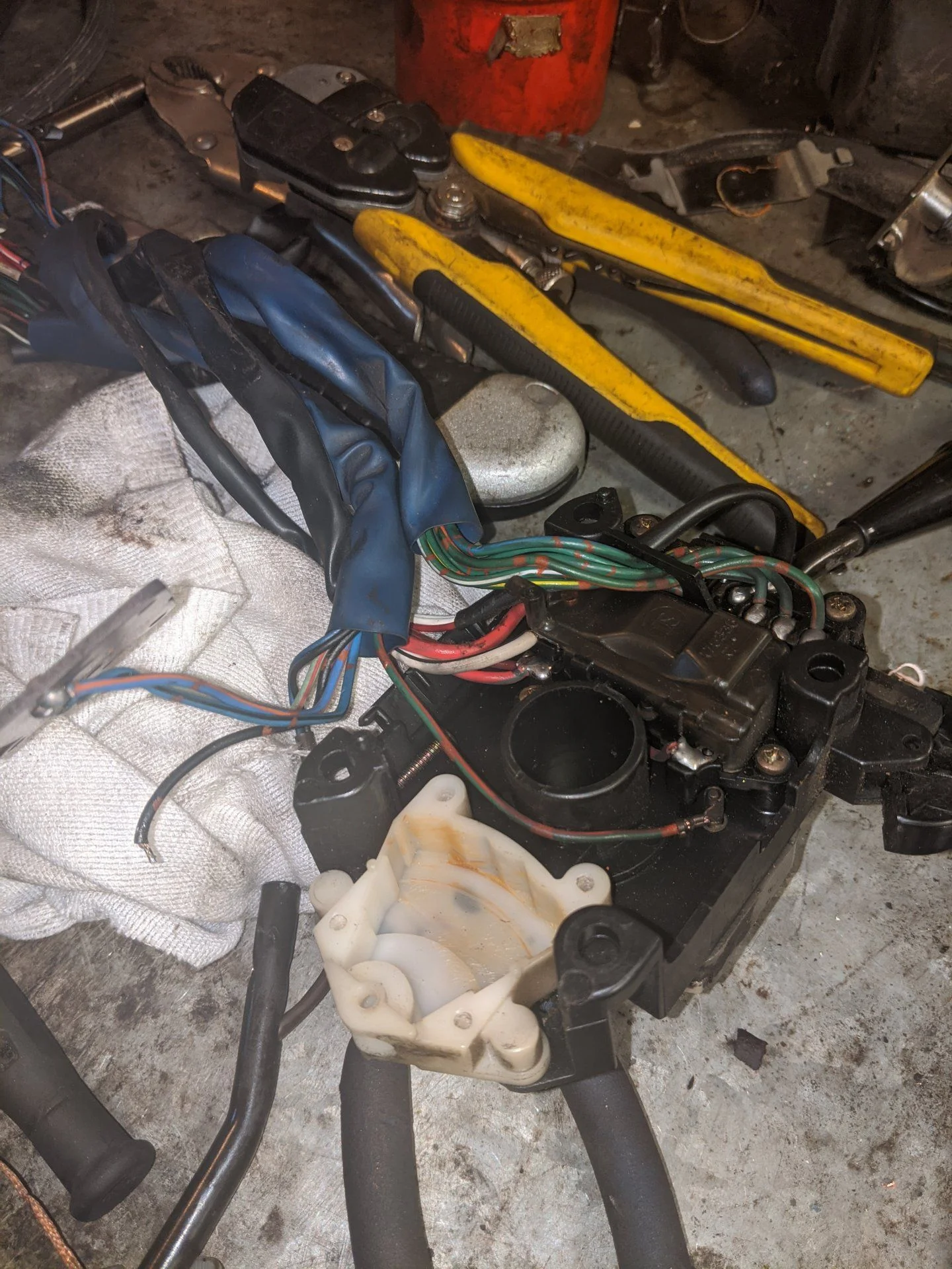

Got the clip together, put the batteries in and threw some volts around...
Everything kinda halfway didn't work on the multi switch, plugged in the original rhd switch and everything worked.
And then Alice went into the rabbit hole...deep, deep into the rabbit hole.
If you mess that up really bad I might have a couple lying on the floor of the shed
Thanks, I have a second one in case I duffed it, but seems like it's only the wipers that were different. 5 wires on bj60 vs 4 on hj.
It got intense for a while there, lots of soldering and moving contact points, but it works.
Had to swap left and right turn pins in the connector, it was blinking upside down. :lol:

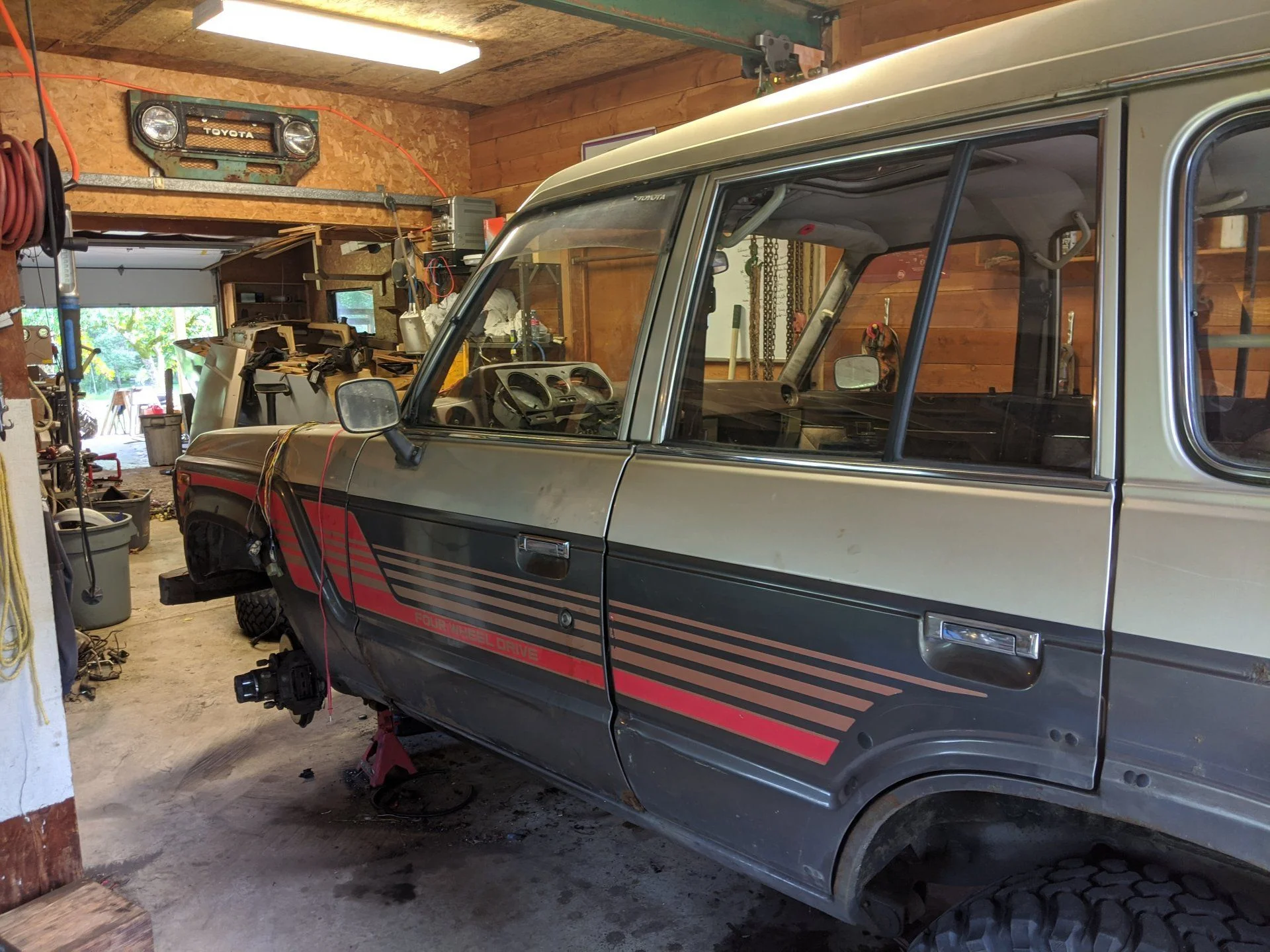

I'd almost forgotten (or blocked out) what a colossal pain in the girly parts putting doors on a 60 is.
I guess the correct procedure is to remove the fenders first but who the hell wants to do that just to take a door off???
Anyways they're back on.
starting to look like a truck again and not a basket case.
