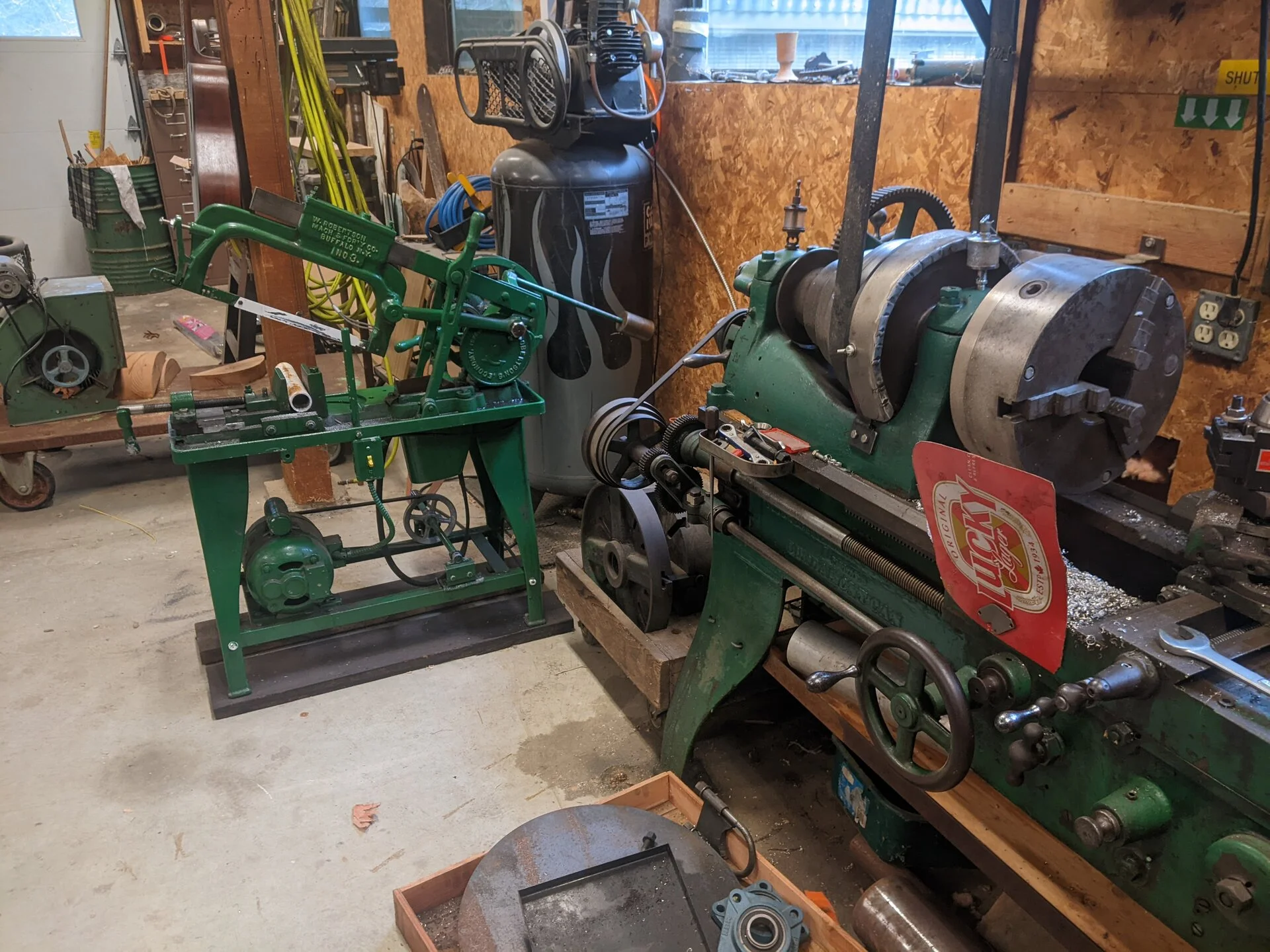

My power fist metal bandsaw I bought at princess 20 years ago has been showing its age.
So I picked up something to show it what age really is...🤣🤣
As always... alarmingly heavy. 😳

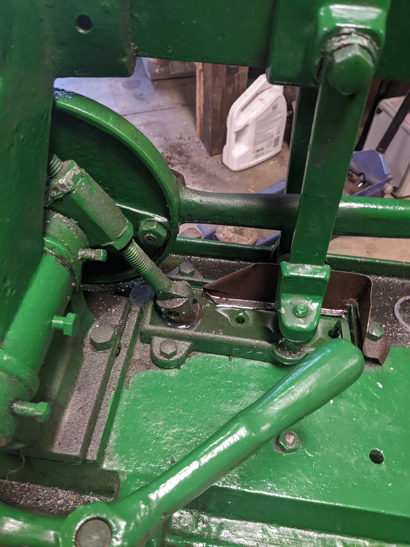

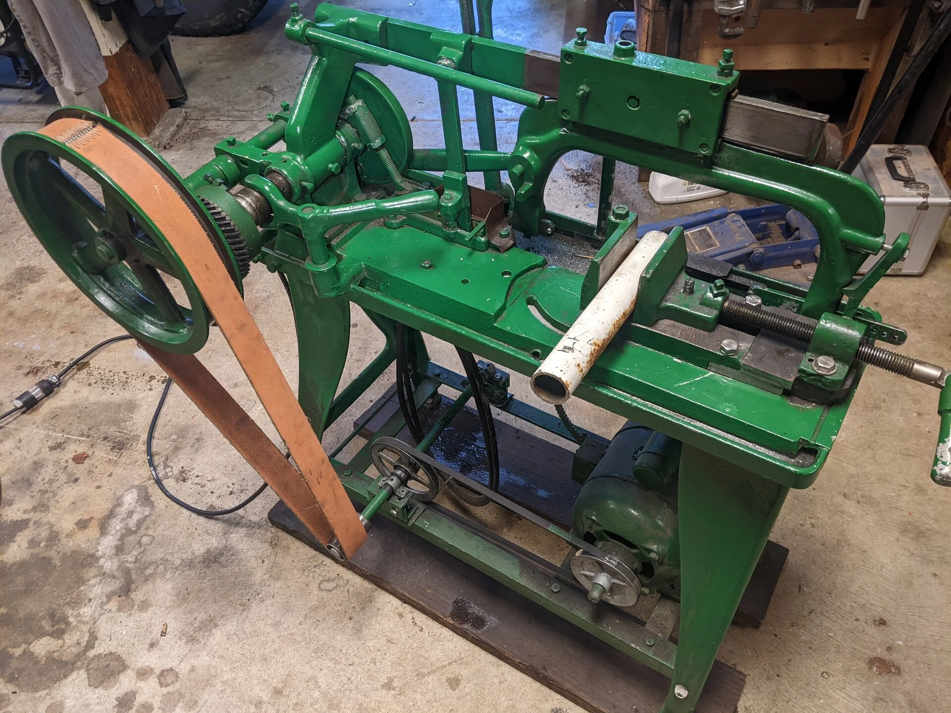

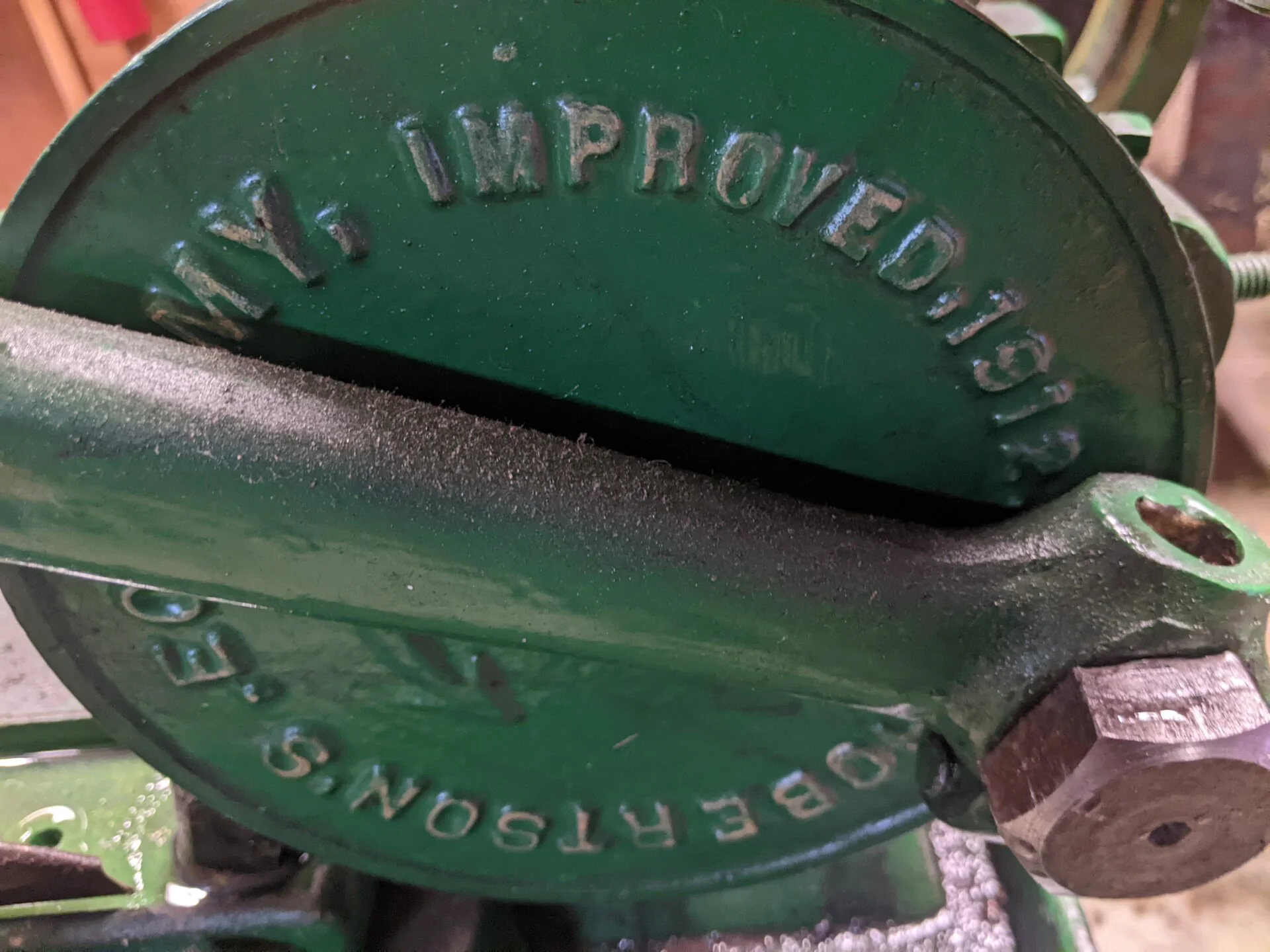

Been playing with this old thing today. Mostly bought it for fun, it kinda matches my lathe and it was cheap
The feed system is clever. There's two pistons that go into a v shaped reservoir full of oil. So as one goes in it pushes the other out. Seems to work still.
I cut a couple slices off some pipe with just a regular hacksaw blade in it and it did ok. Didn't snap the blade instantly like I expected 🤣
It's supposed to have the bigger 1" blades, but I haven't found them where the seller doesn't want 50 bucks to ship 3 yet. 🙄
I love the old stuff but I think bandsaws are much superior?
Depends. A good one is , mine wasn't particularly good when I bought it. Now it's beat to s*** and snaps blades randomly.
This is really more of a toy. But I suspect with a proper 14tpi blade in it it'll kick my bandsaws ass.
And look cool doing it 🤣
That is a bandsaw? Just horizontal? I like it.
Technically it's a power hacksaw.
I'm interested to try it with a coarse blade. This thin hand hacksaw blade is like 24 tpi so it doesn't make enough room for itself.
But really this thing was just too cool to let go to the scrapper.
Seriously it weighs like 450 lbs. It nuts 🤣
