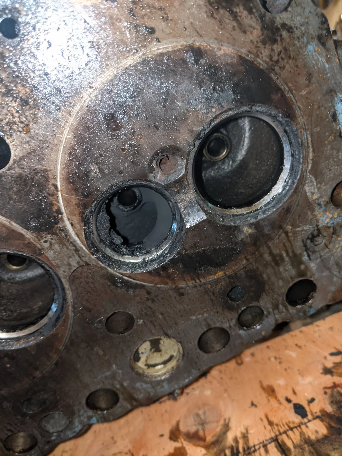

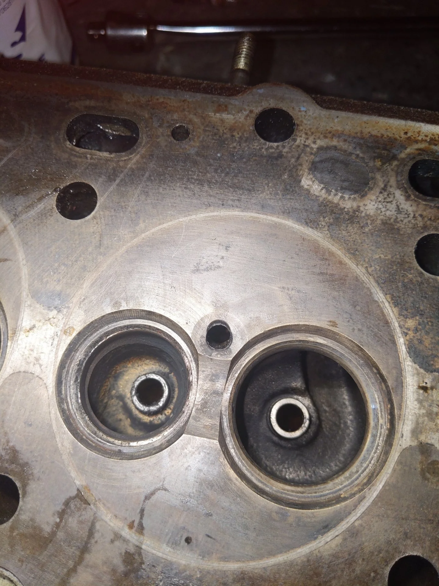

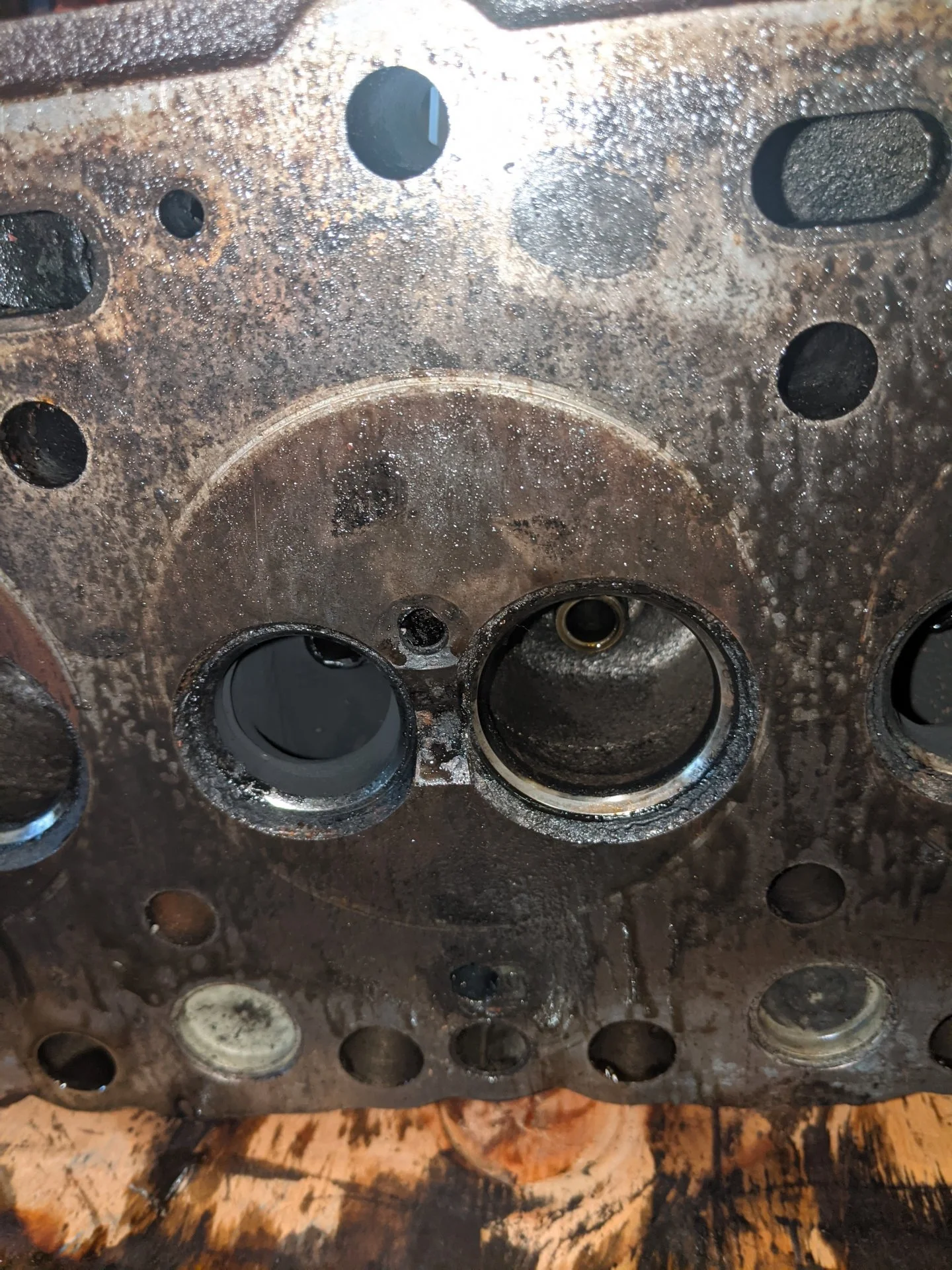

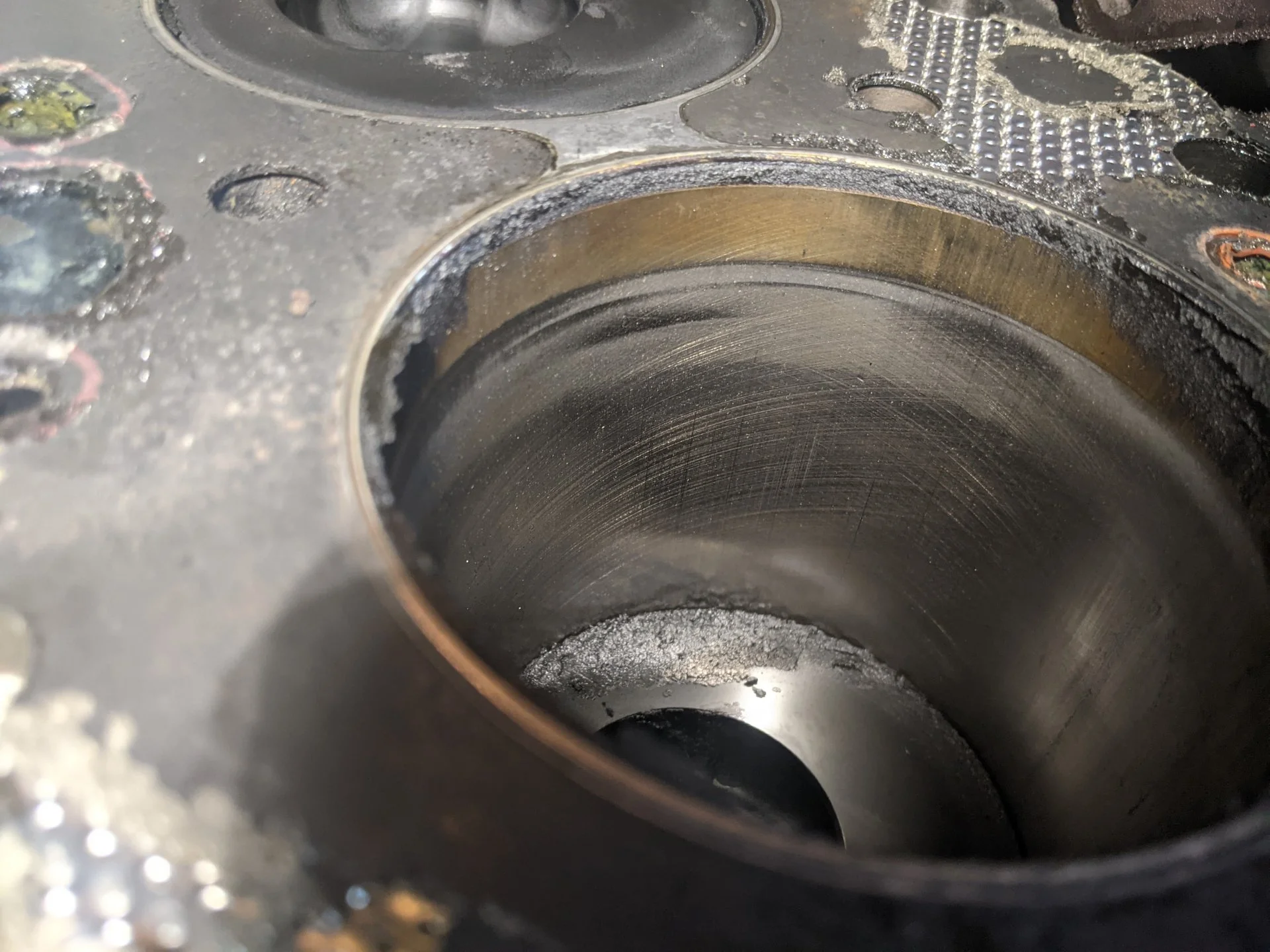

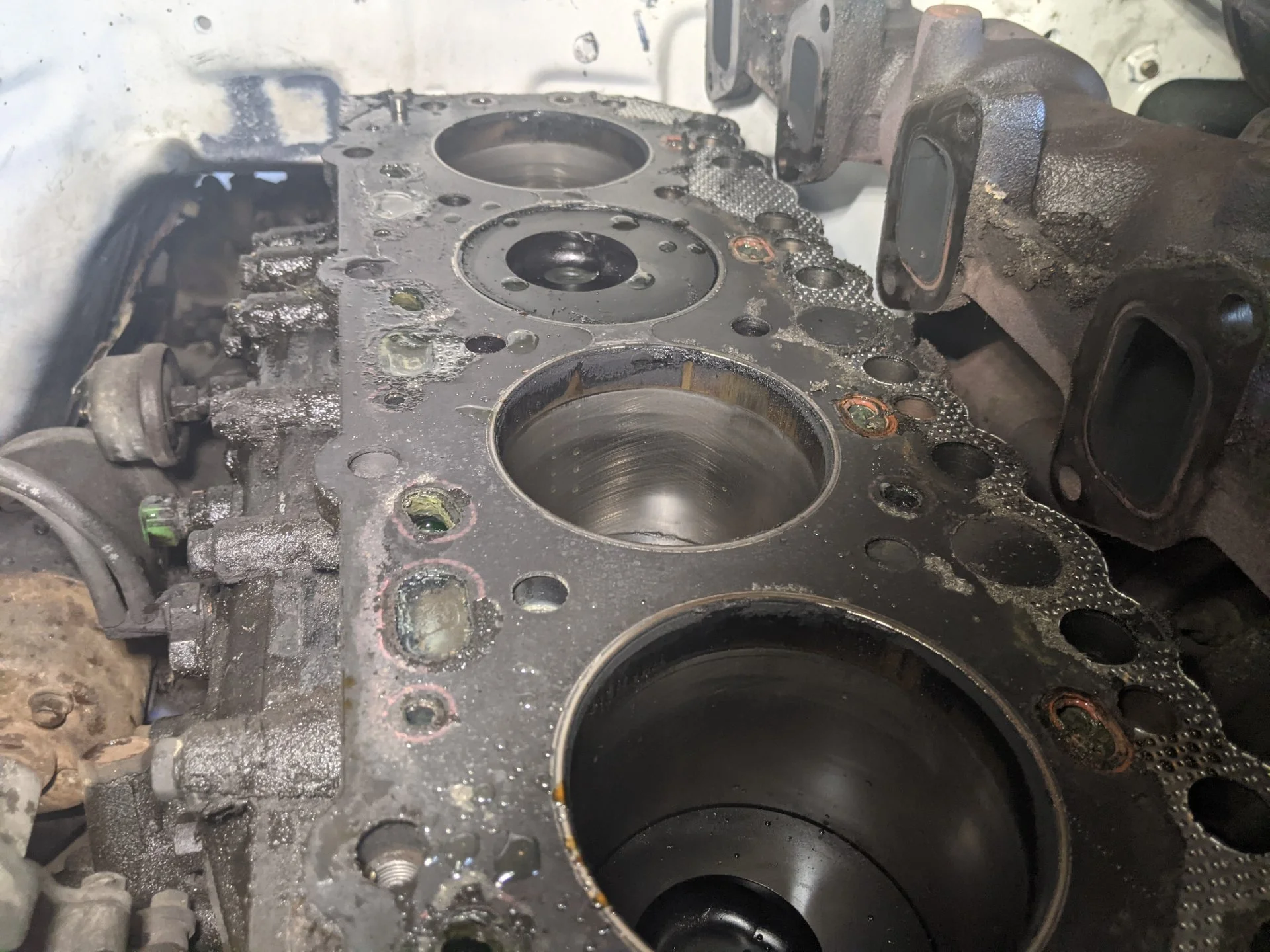

Popped the head off and got it superficially clean. Nowhere near clean enough of course.
Actually some blue paint under the mung :lol:
View attachment 2700913View attachment 2700914
Can still see the crosshatch in the holes so that's a good sign. Probably hard to see.

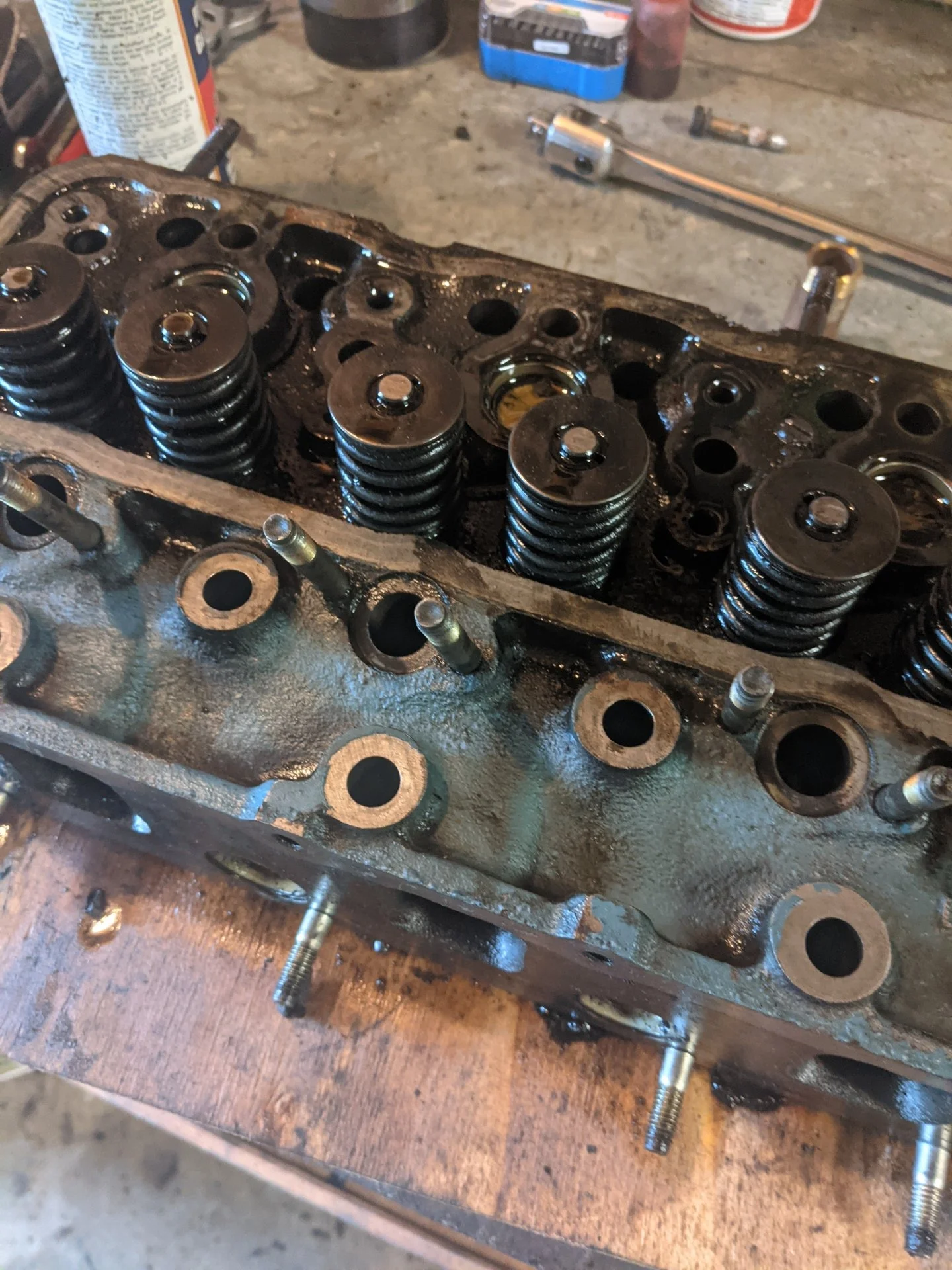

View attachment 2700915View attachment 2700916
I have zero interest in climbing underneath today. Think I'm gonna raid the cardboard bin tonight so I can cover the floor, and then give the block a good scraping before I take the pan off.
The dishwasher should make that blue colour just "Pop"!!!
Timing is everything with that step though... just saying'.

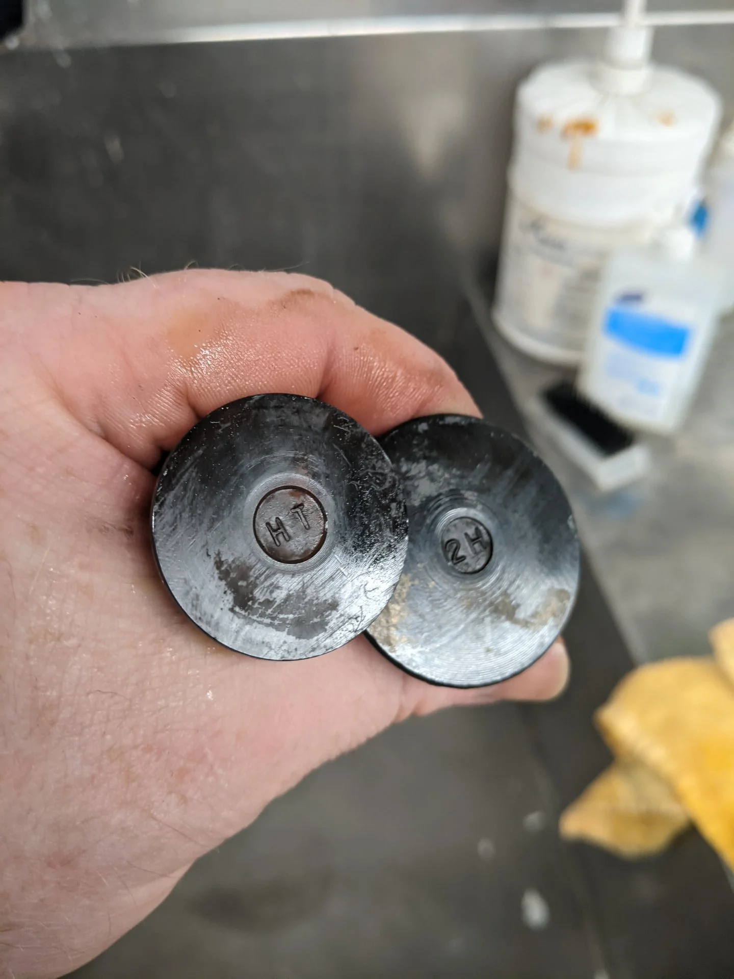

I dunno, that cross hatching looks a little too tired. I guess I could trade you a low mileage 2H for that though... 🤣🤣🤣

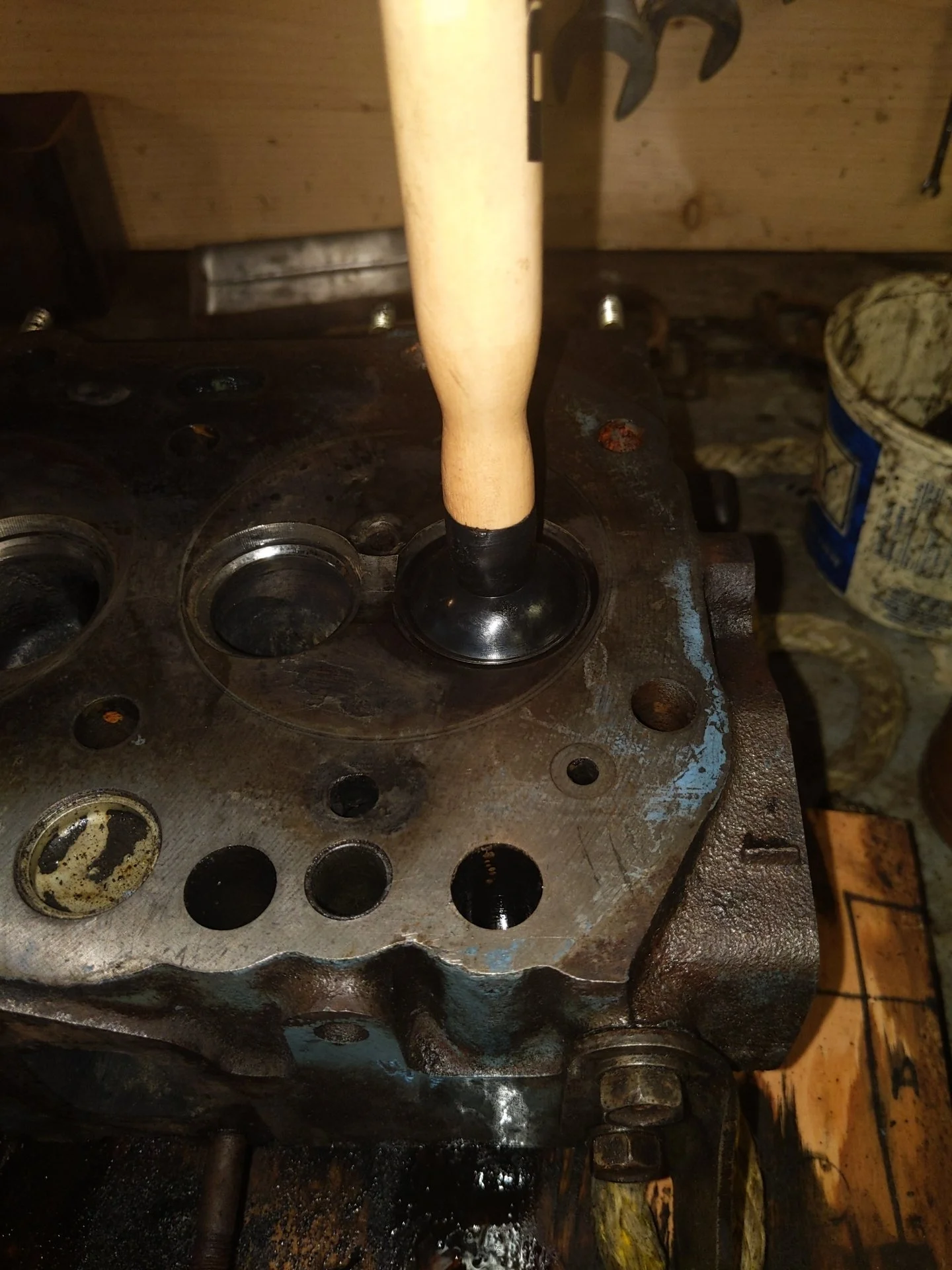

I bet you logged into the interweb this morning, foolishly thinking you'd seen the world's most ghetto valve spring compressor. :lol:
I briefly considered making more of a proper one, but this will allow all the pieces to go back into the scrap bin to be something else.
Worked to get them apart so I can continue to clean, but something a bit more civilized might be nice for reassembly.
Works because that's a slab of steel that's 2 1/4" x 10" x 48" the head is laying on.
Got it from my old creepy neighbour, he even had it milled flat.
Wasn't worried about tipping it over...I think it weighs about 400 pounds. :oops:

Much less ghetto than a busted spark plug, a brazed in compressor fitting, and the pickle fork I used the last time. :D
Cleaning valves seemed the kindof s***ty job a guy should be paid to do. :lol:
Degreaser then descaler seemed to work. Doing the head should be a treat. :bang:
Thinking of hanging it into a 5 gallon pail of this s*** because I don't have any trays it'll fit in.
Thought this was interesting...
Were definitely a few where the buildup was interfering with the sealing area, so it needed doing.

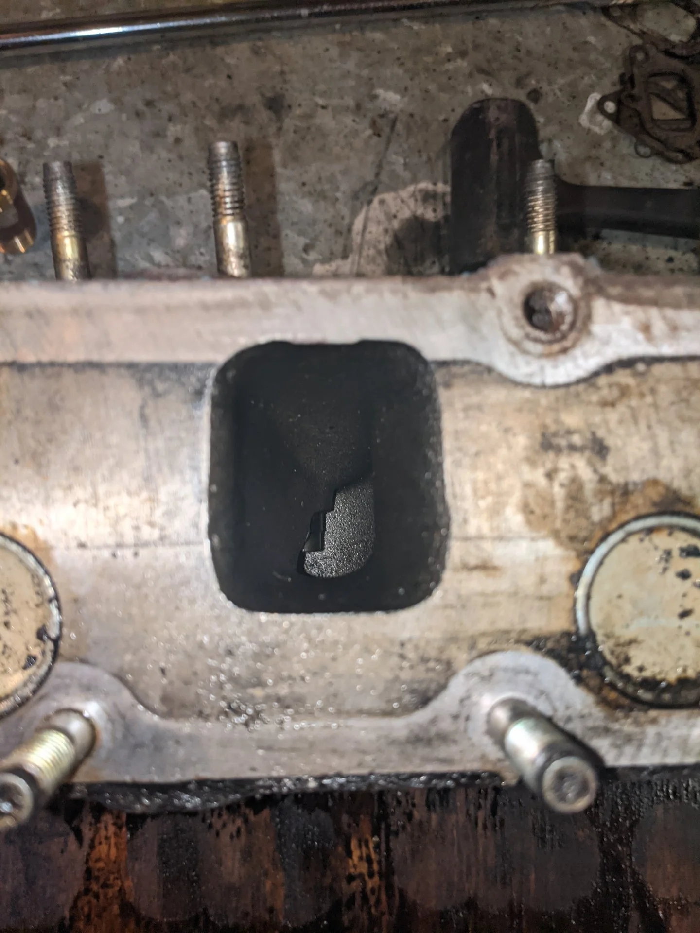

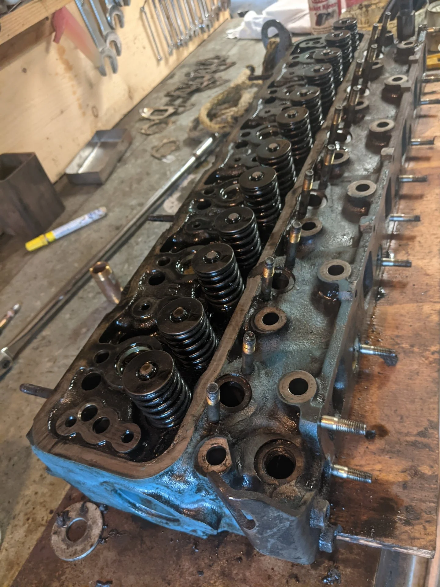

Did a little more cleaning. #1 with the turd nugget was actually the only one with any appreciable build up to scrape out. The rest were pretty much just stained. So cleaning up is no big deal.
Think I'll grab some blue engine paint tho before I'm done. Maybe the muck won't stick as well.
Looks like ford tractor blue to me. I'm going to assume that will be easier to find than Toyota 12ht blue :lol:

Looking good Ryan. Every old Toyota motor I've had apart has a sludged/coked up intake manifold and head intake ports. Sludge from crank case vent, some coked up if they have EGR. Makes for a nasty mix. PITA to clean, but worth the effort. The EGR mix is usually what is hardest to clean, so you're lucky you don't have to deal with that.
Your motor is looking pretty good so far in terms of wear though!
Looks like your intake ports have a bit of a swirl design to them? That's cool!
