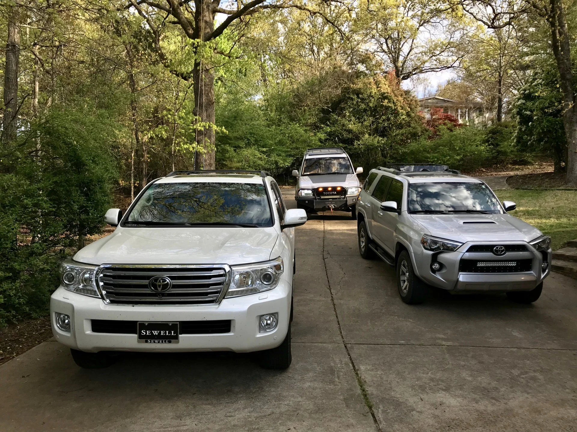

Between my father and I we own all 3 - 100, 200, T4R. Compared to the new T4R and 200 series, the 100 is a breeze to work on and relatively inexpensive. IMHO manufacturers nowadays are doing their absolute best to deter the DIYer when it comes to maintenance. One big example being the oil filters - instead of the normal canister type like you’re used to seeing, the T4R & 200 series use a special housing where you only replace the filter medium inside (as opposed to simply unscrewing the old one and screwing a new one in). This is a huge hassle and makes changing oil much messier and longer to do. Beyond that, the 200 is more expensive to have work done to it. I won’t say the word “maintain” with the 200 because other than fluid changes nothing else has been needed to keep it running in top shape. In terms of agility on trails, I honestly say the T4R wins that race. It’s lighter, has 2WD, and the shortest wheelbase of the three. However, the T4R has a much lower build quality than the LC family and they tend to use a lot of cheap plastic anywhere they can. All in all, each one is an excellent vehicle in their own regards and no matter what you really can’t go wrong with any Toyota!
