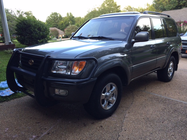

I decided to leave the flares on for now. Maybe later they will come off. I want to lose the brush guard, but can't do it by myself. It is free to a good home if there happens to be any interest. All you have to do is come help me take it off.

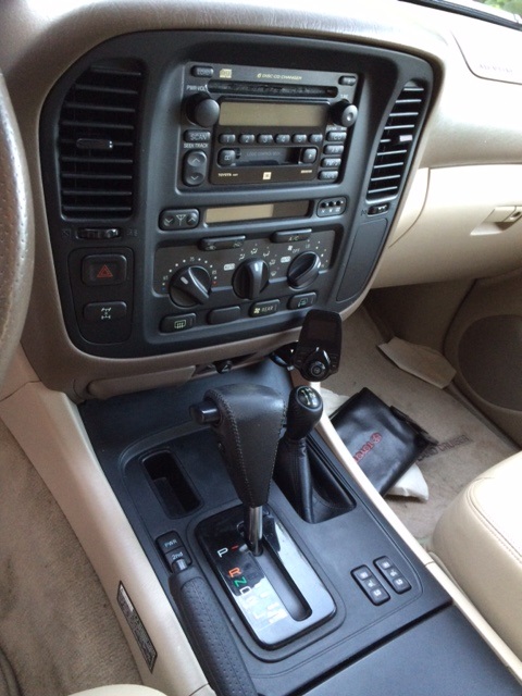

Old faded dash kit=delete.
Came off pretty easy with one of those polypropylene putty knives and some direct sunlight.

Looks much better. Damage Multiplier should only be held on by the front tow hook bolts. Throw a thick blanket over the hood and headlights and get that thing off or if you want to do something awesome, tie it off to a tree and throw it in reverse and yank it off, no tools required.
@booradley its real easy. Just a few bolts to take off. You can take off as one piece with help or remove the brush guard from the bracket and then the bracket from the frame to make it easier to lean it down yourself.
I can't tell which part is Land Cruiser and which part is brush guard brackets. I may give it another go this weekend or I may just wait and drive it to the next meeting and let you all show me. Thanks.
