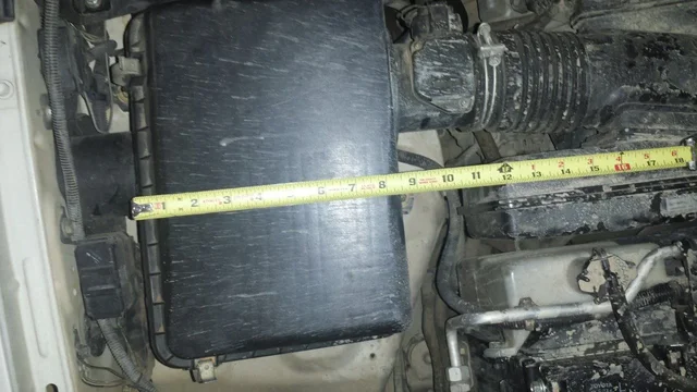

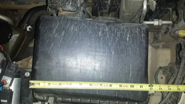

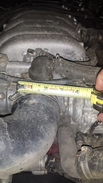

Can I talk one of you 100 Series RGANs into giving me the dimensions of the airbox & intake hose diameter?
Intake to air box or manifold?
Or both?
They are too small to fit the throttle body and MAF sensor on a Chevy engine, if that's what you are trying to do.
Pic
I figured I could use a reducer. A lot of folks run the 80 series canisters, but I was looking for something a little more compact.
Or both?
The diameter leaving the box to the manifold.
