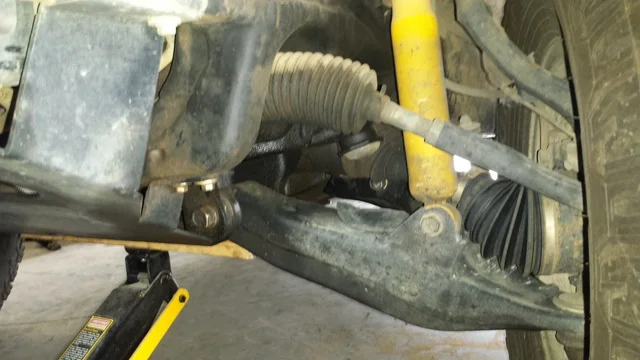

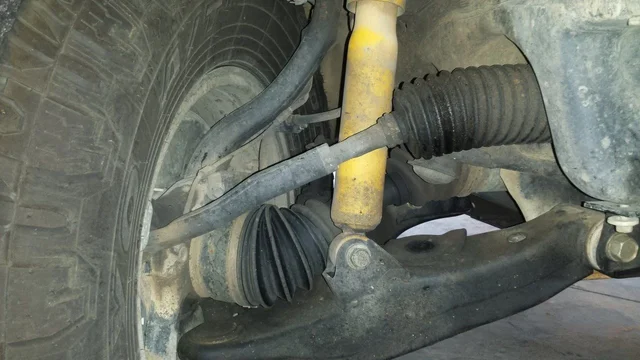

Pics of steering rack with small leak and tie rods and my new stance which looks and drives great.
Put a floor jack under the lower control arm and jack it up until the tire is off the ground. Grab the tire at the 3 o clock and 9 o clock positions and check tie rods for slack. Repeat on the other side.
Yep, got a very small amoubt of play.
Should there be zero amount of play?
Is it the inner tie rod, outer tie rod or the rack and pinion bushings? Also grab the tire at the 12 and 6 position and check for slack. If you have slack there it could be your wheel bearings.
I did that earlier too. The play there was like less than 1/4"... I would believe wheel bearings is the issue at "play" here
