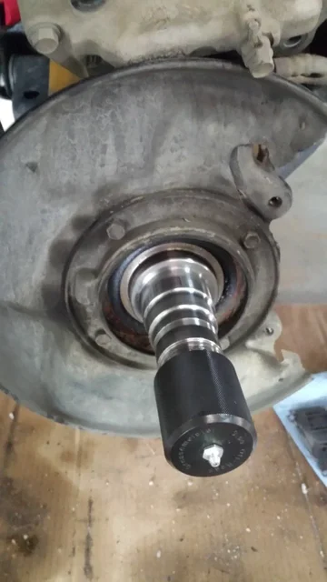

On another note, I replaced wheel bearings (inner and outer) along with new OEM front rotors and pads.
I also picked up this spindle grease tool from Slee. http://www.sleeoffroad.com/products/products_grease_tool_detail.html
I have not been checking this spindle bushing/bearing for proper grease and it was dry as can be.
FSM requires NLGI Grade 1; I used this mobil grease (orange color) http://www.mobil.com/USA-English/Lubes/PDS/GLXXENGRSMOMobilgreaseCMSeries.aspx
(CM-W) which is made to resist water in the mining/construction equipment. (probably complete overkill but worth not having to screw with it for a long time)
Also used mobil 1 syn grease (red color) for the bearings and hub pack(NLGI Grade 2)
https://mobiloil.com/en/synthetic-grease/mobil-1-synthetic-grease
The front end is very smooth and quiet now.
No more play in the wheel like I felt before, but there is some play in the 9&3 although not hub related.
This is so small I wonder if it's just part of the normal front wheel tolerance.
